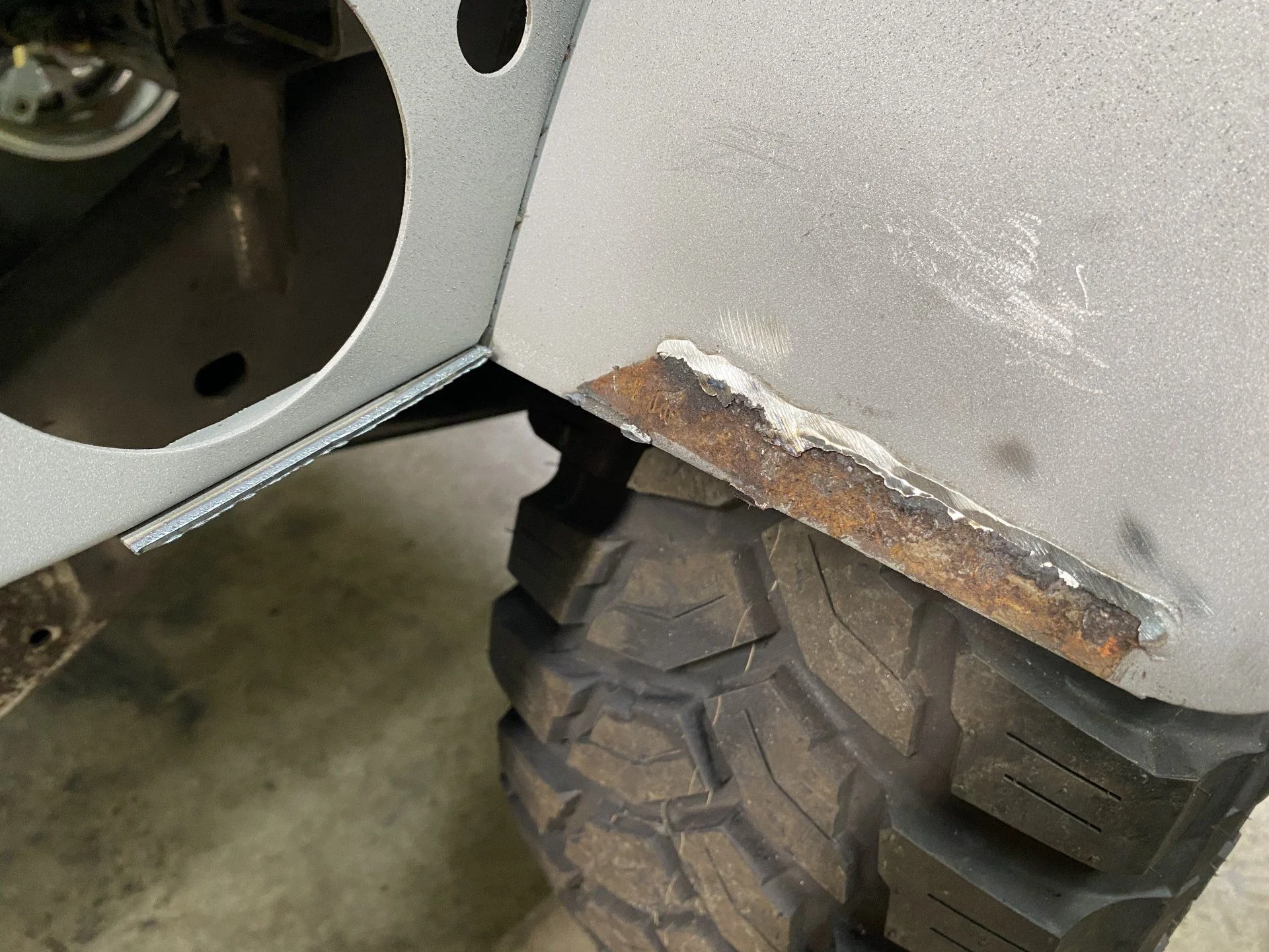

And this one broke. Obviously not enough booger weld

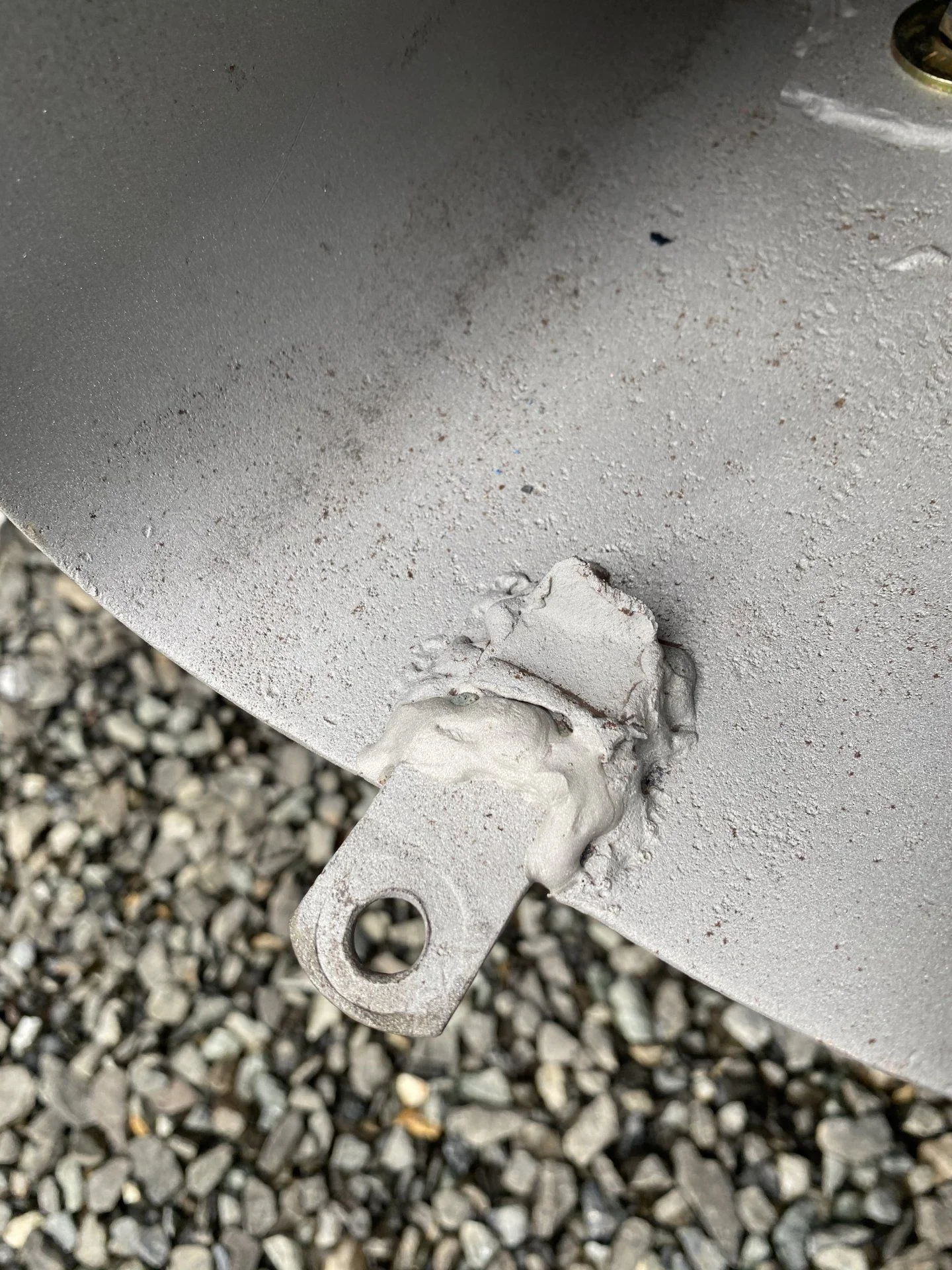

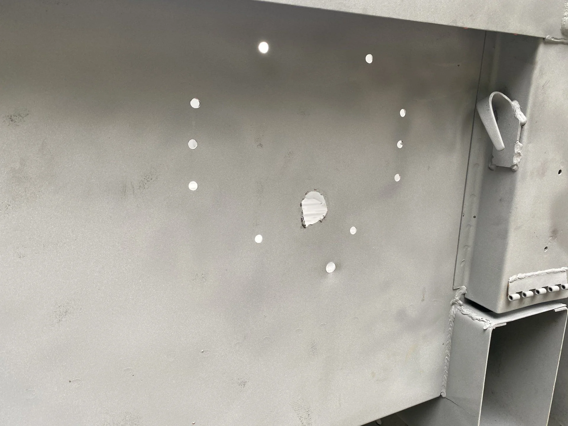

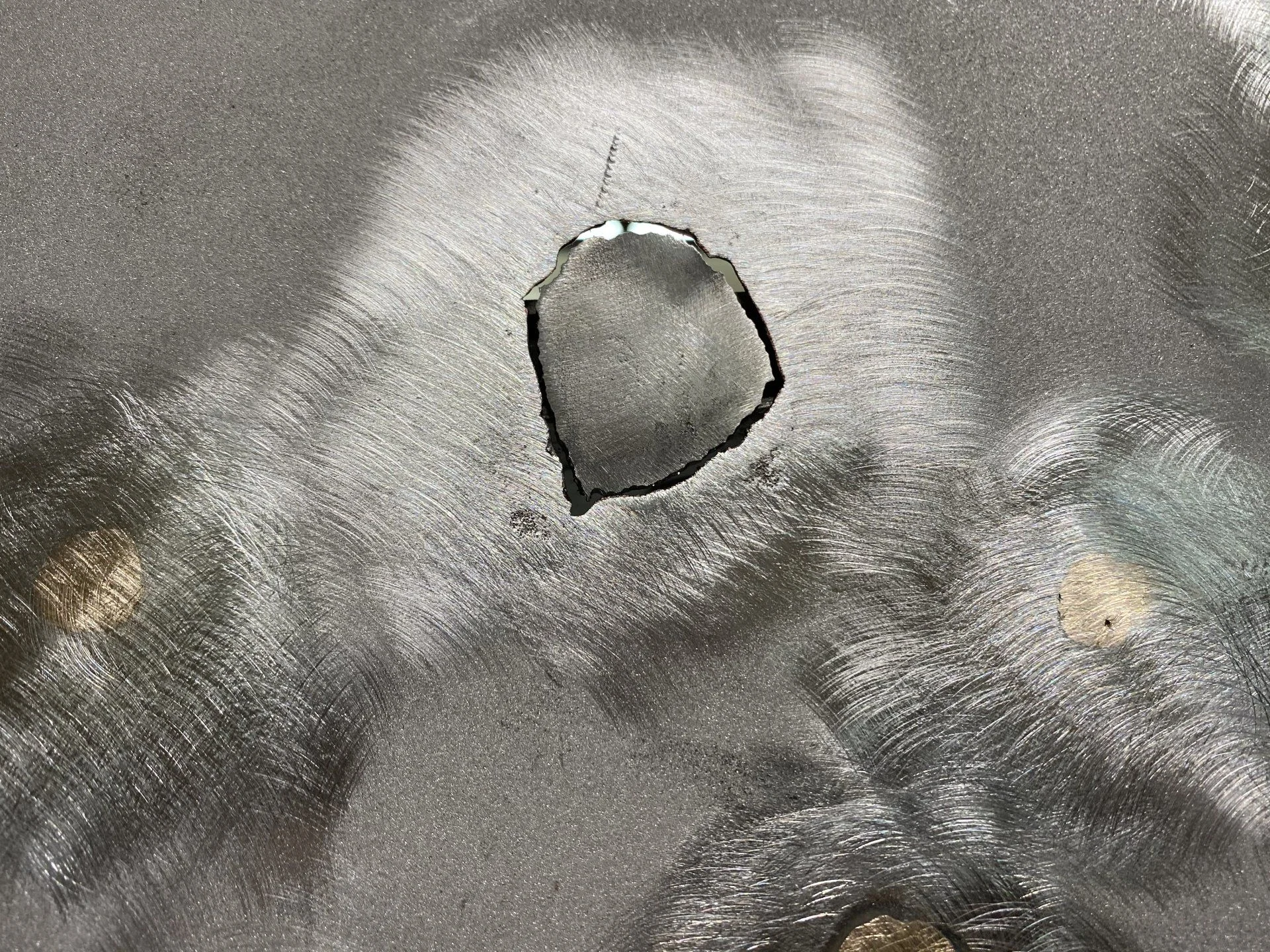

Probably a jerry can mount gone totally sideways... please appreciate the far from round torched out hole. Nobody ever bothered to even clean up the slag

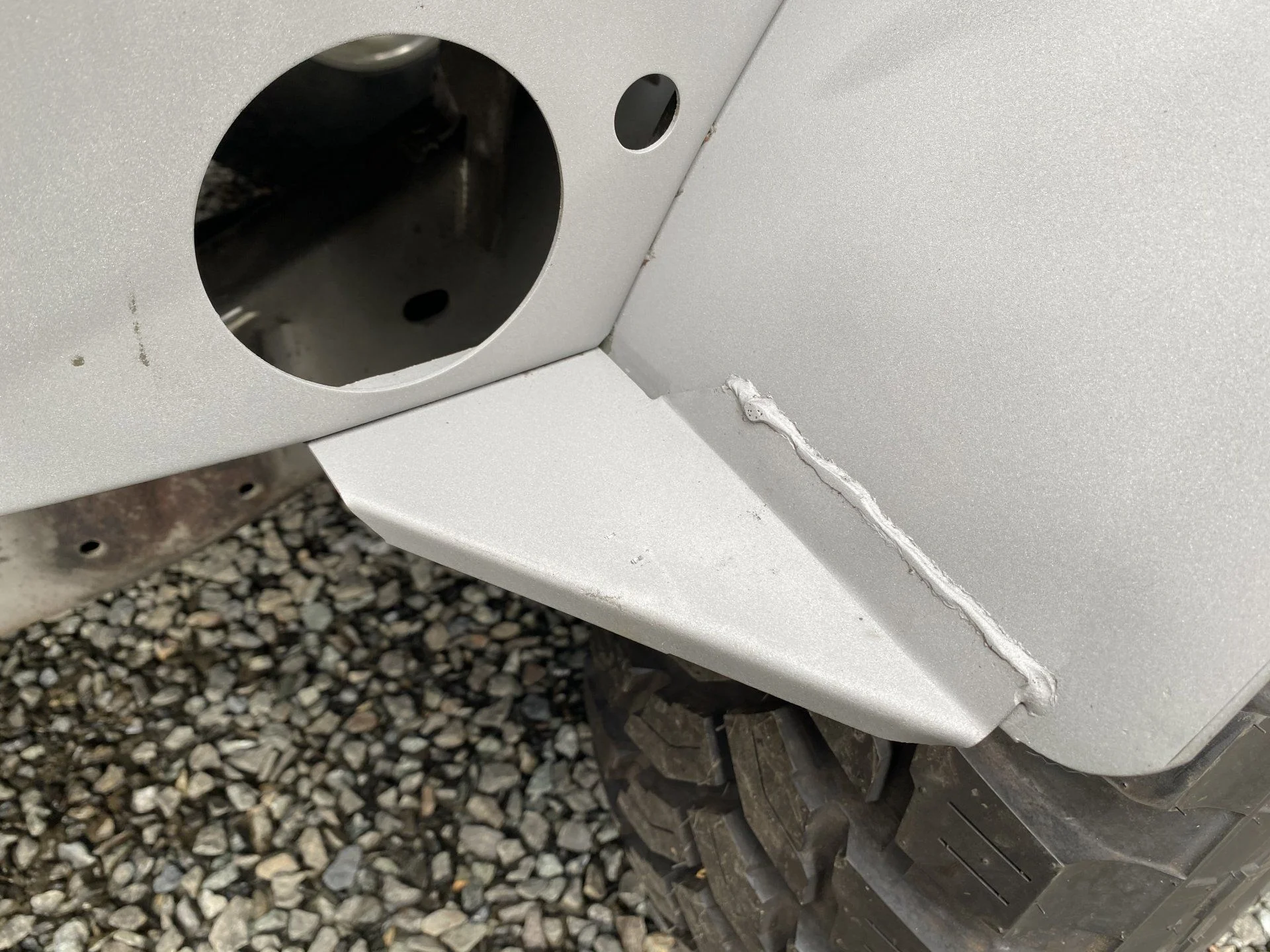

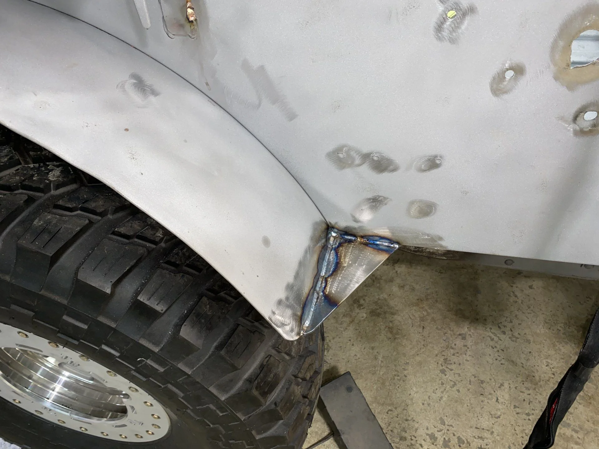

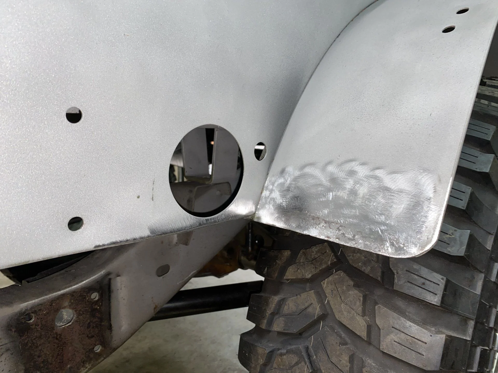

Old bed fender gussets

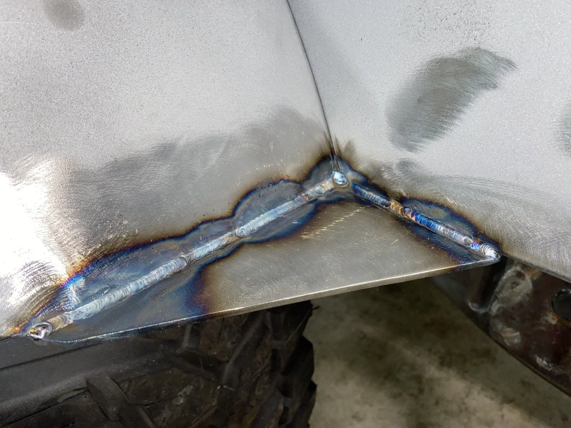

New gussets. 3/16” cold roll plate

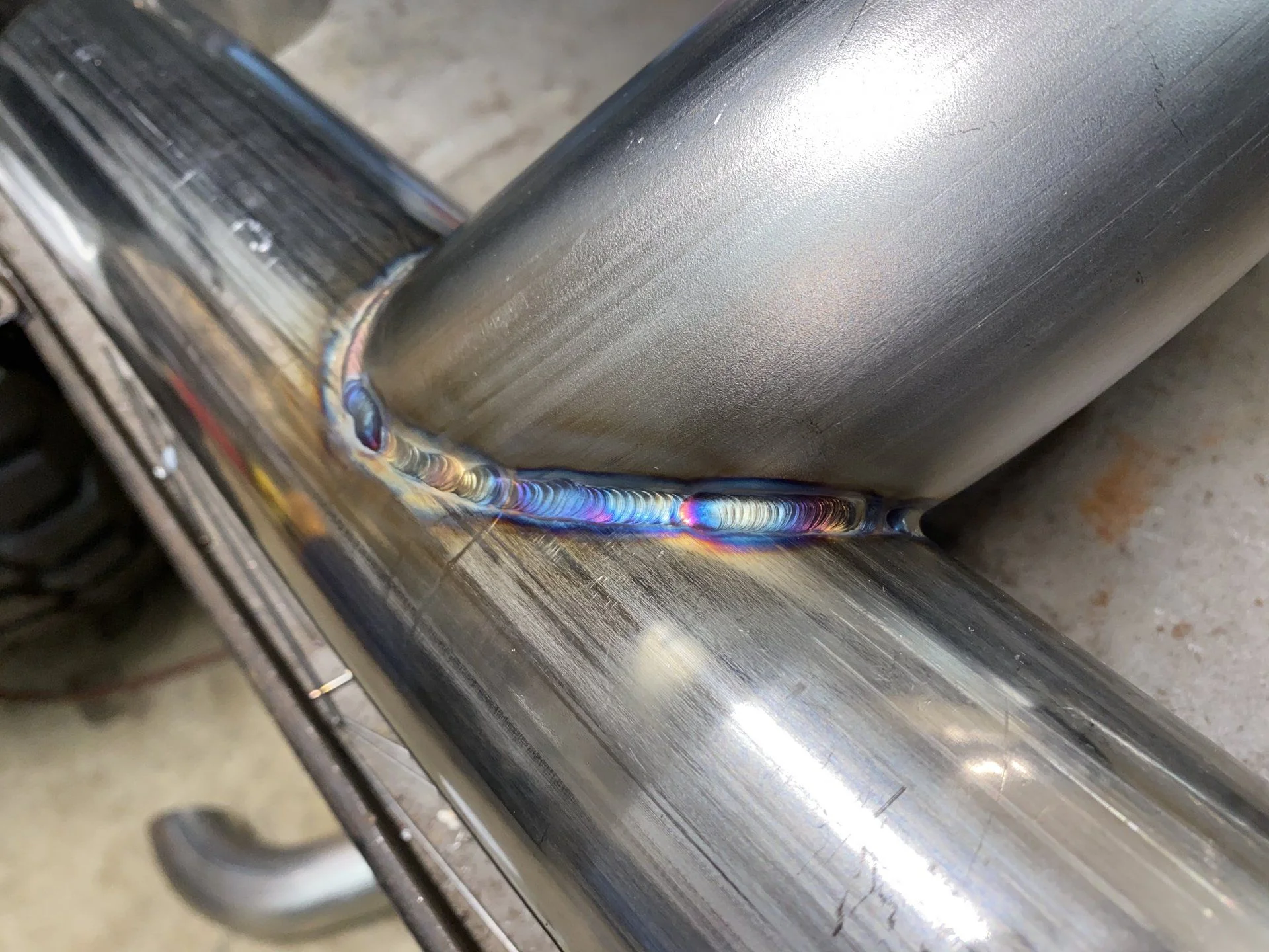

Gaining skills... Goal accomplished. Your Tig welding skills look great! That bed seam looks pretty dang straight.
Thanks! The bed is very solid overall. I was expecting to see a lot more rot after getting the 4-5 layers of paint blasted off of it. The metal is also 16 gauge which I'm sure helps. But picking it up? That requires a tractor or a engine hoist, it's that heavy.
It DOES have a lot of metal fatigue, essentially all the upper corners are badly cracked. My guess is that it did many, many miles on rough gravel roads with stake side boards rattling around like crazy. Definitely fixable tho

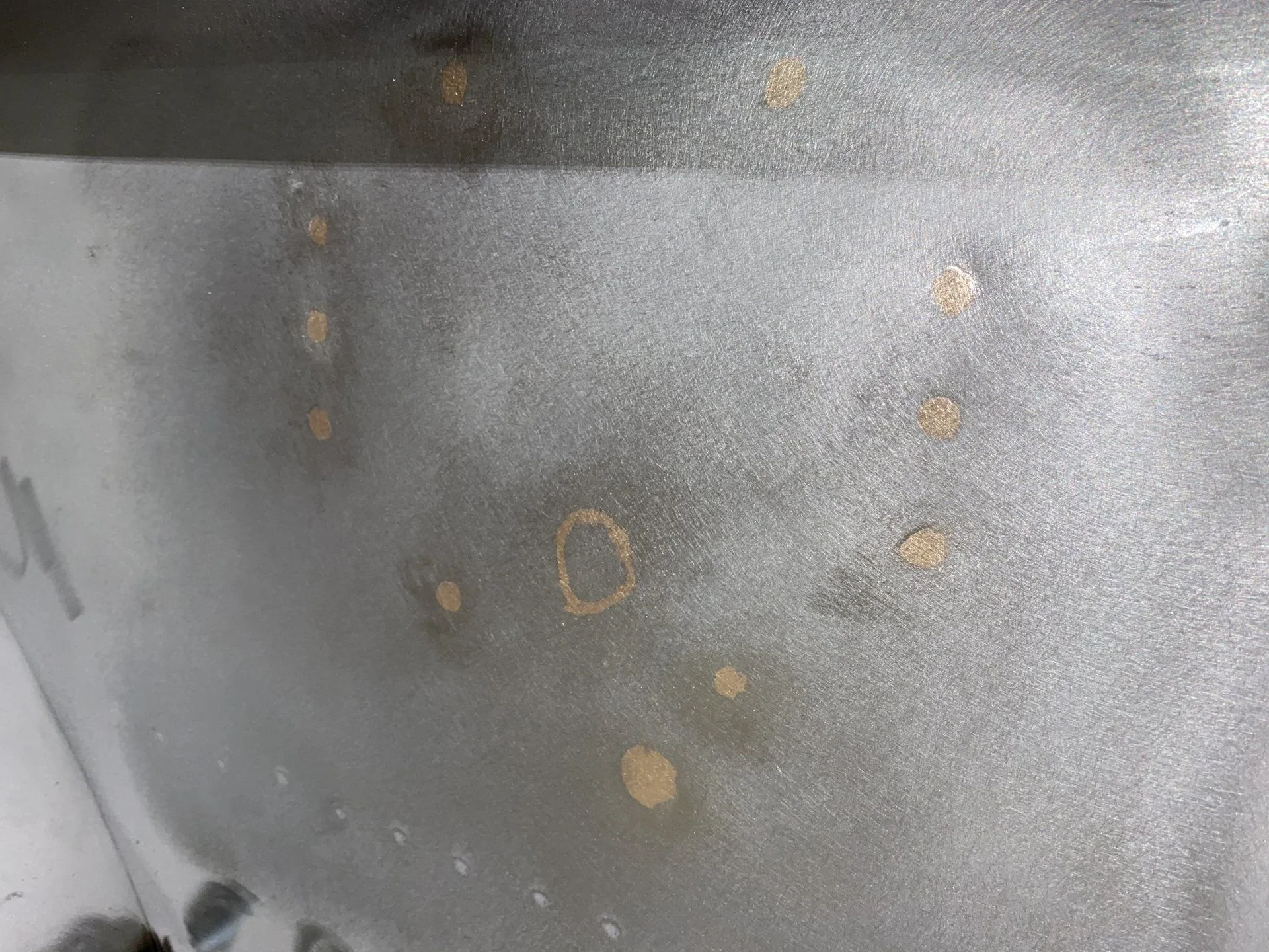

Correcting all the nonsense...
silicone bronze in the small holes
Super sweet custom jagged piece that perfectly matches the torched out nonsense

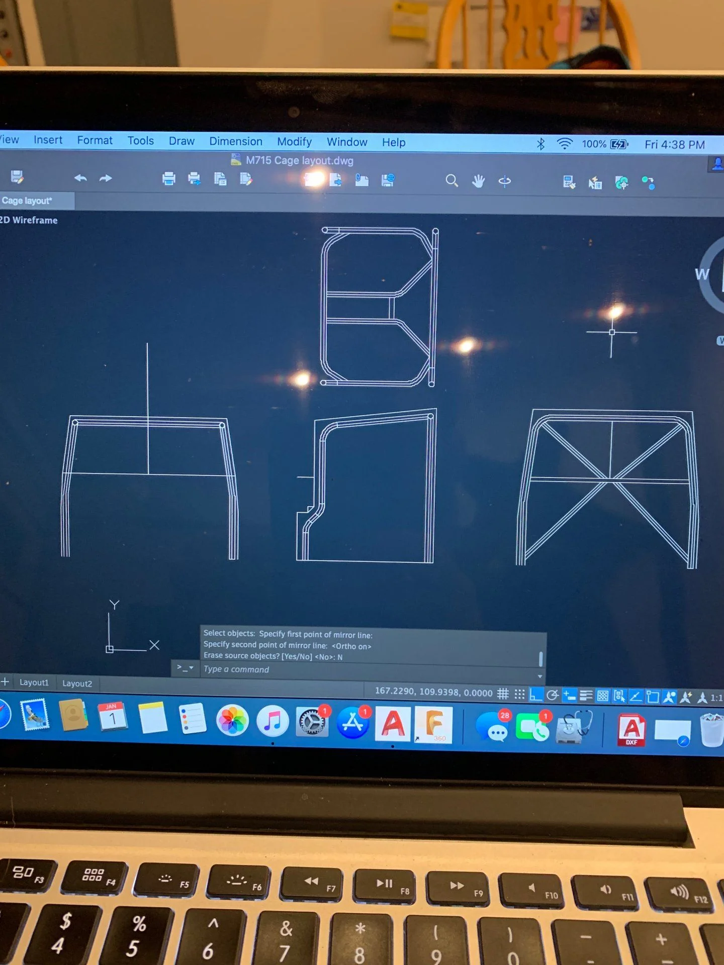

Cage has been drawn up on CAD :)

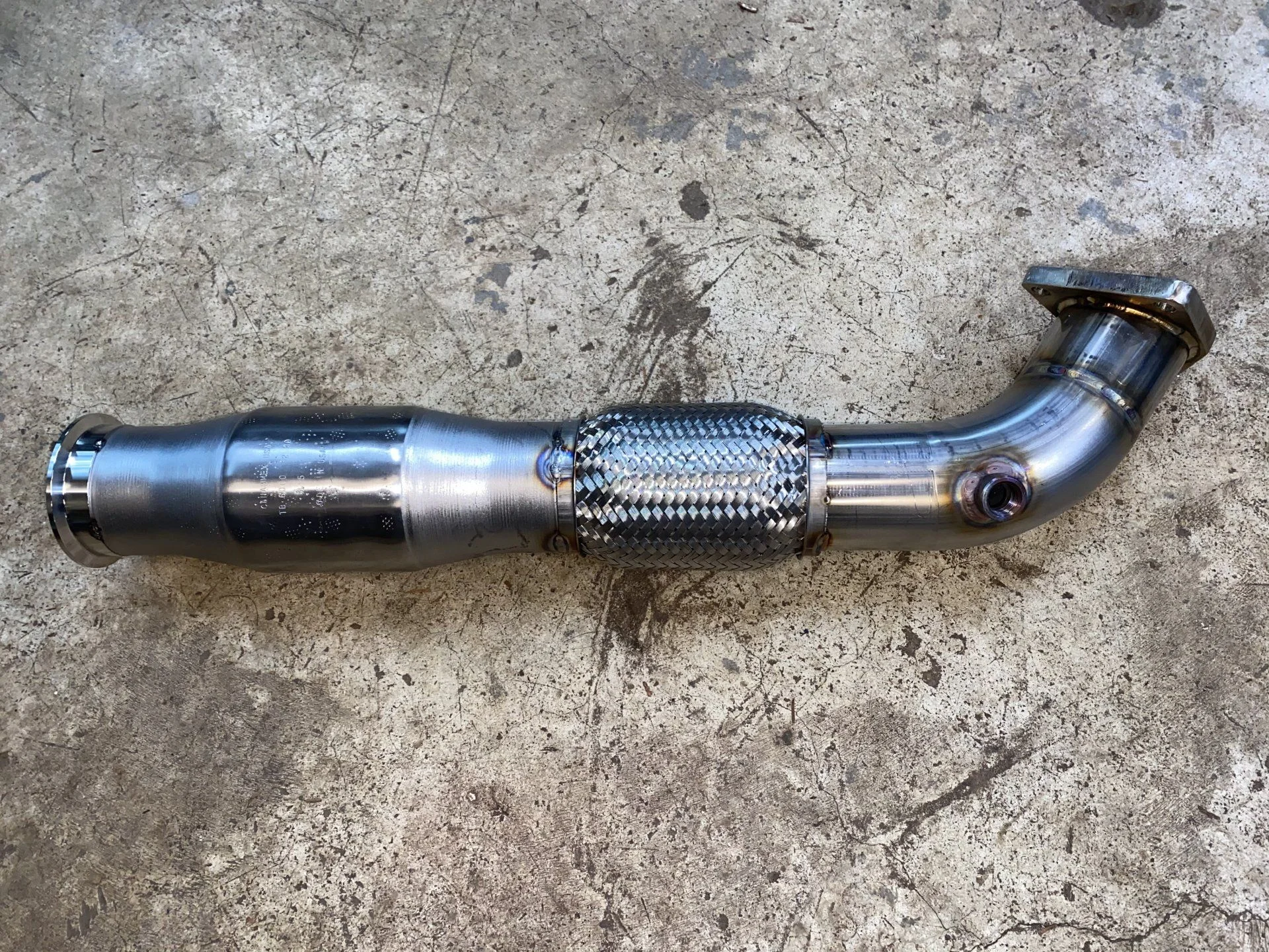

Fun with exhaust bits...

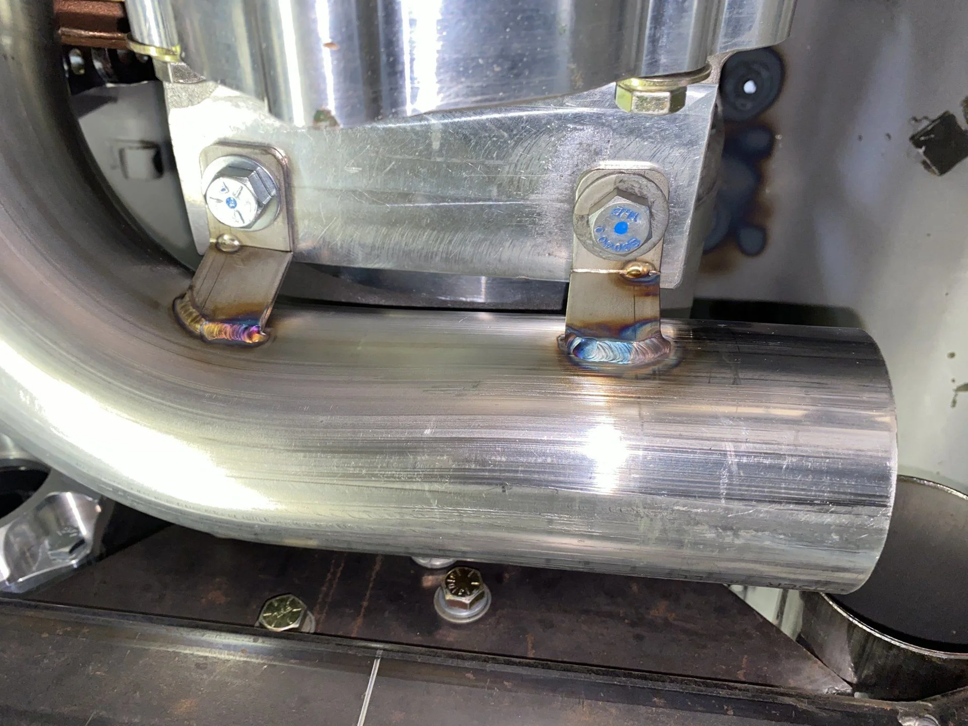

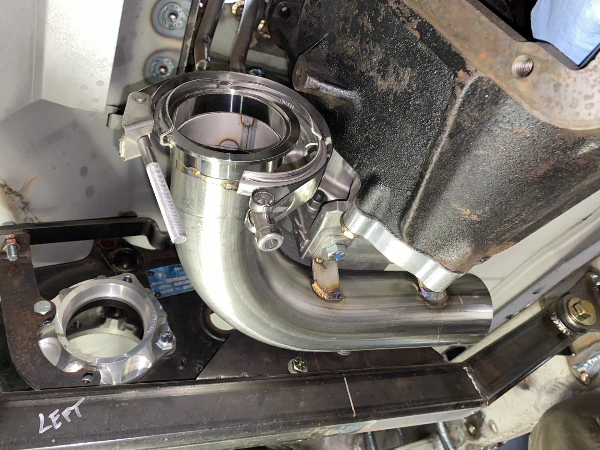

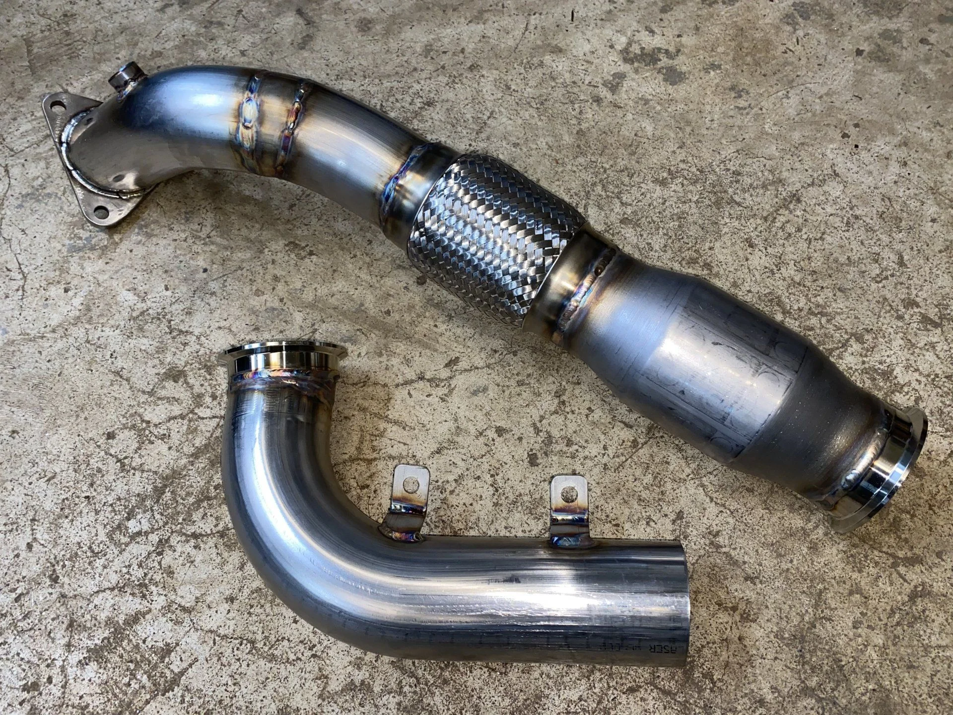

Both crossover tabs welded in

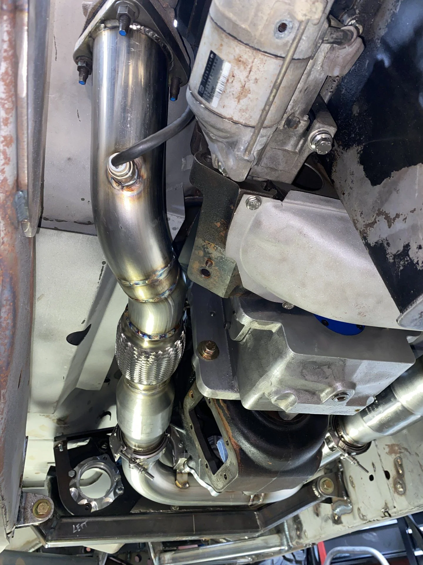

Welded on the exhaust down pipes pretty much all day

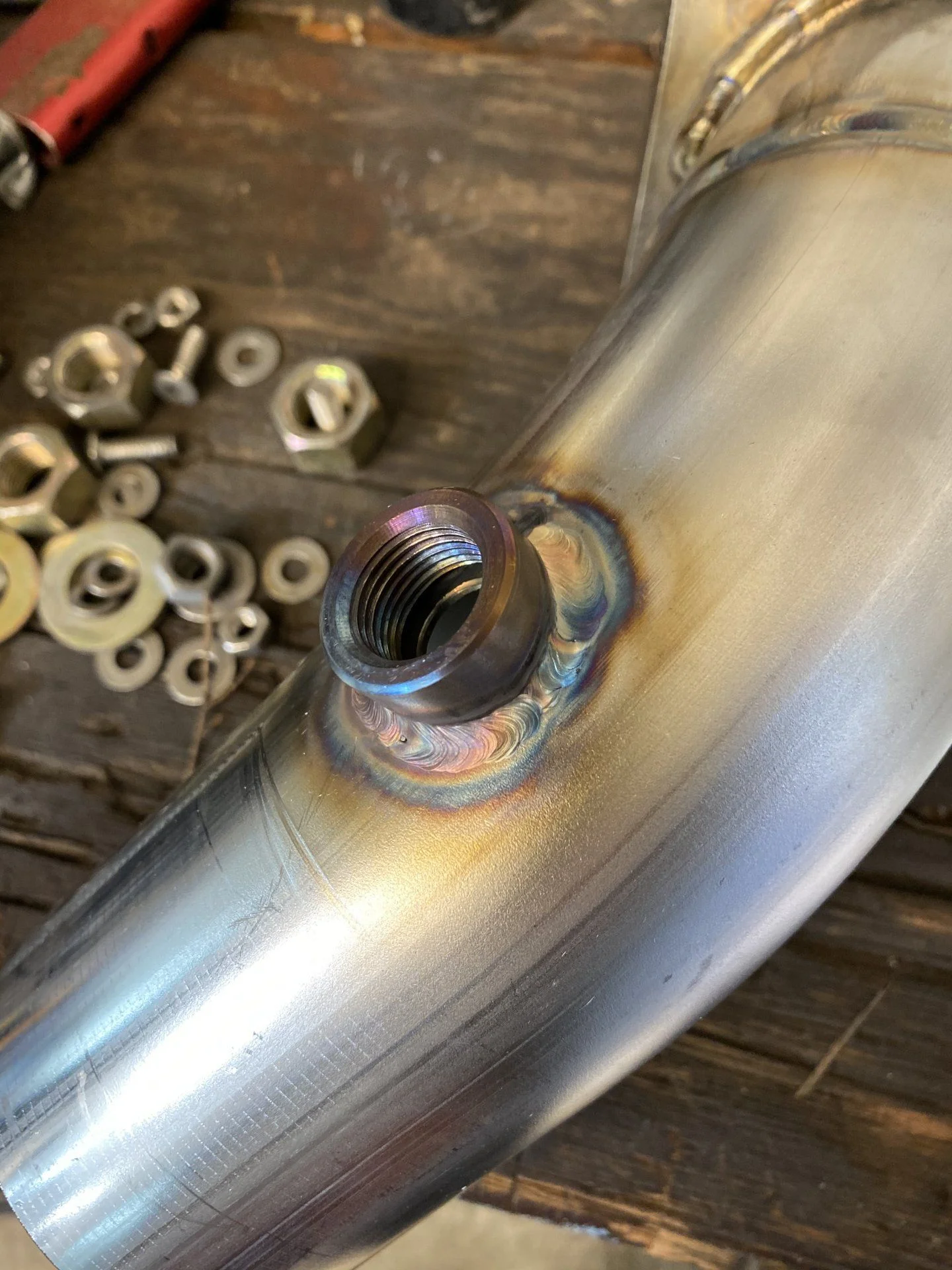

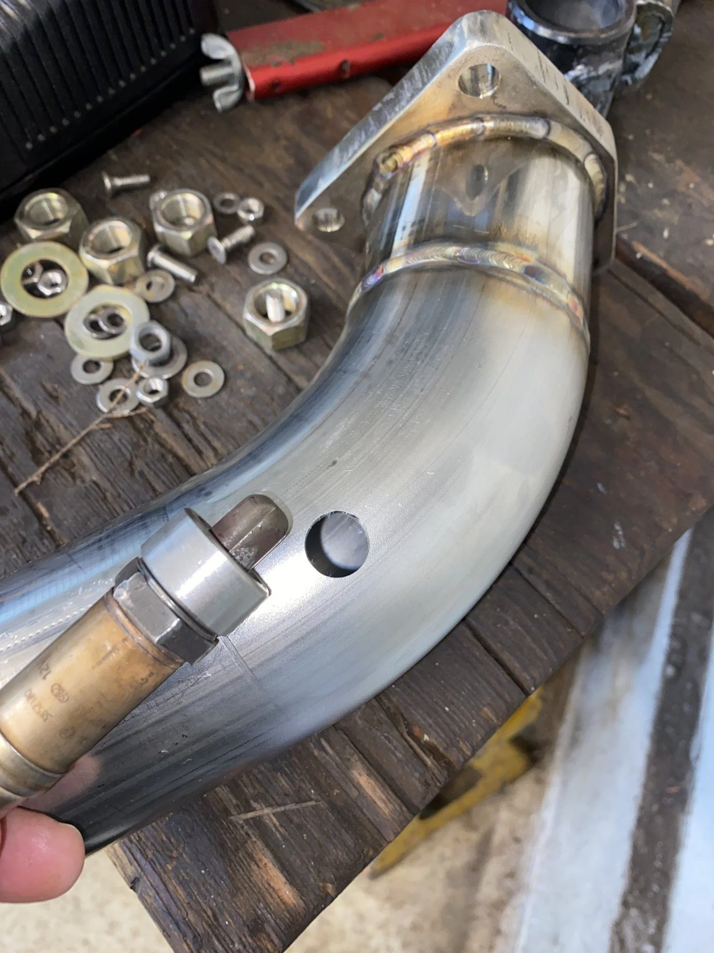

O2 bungs

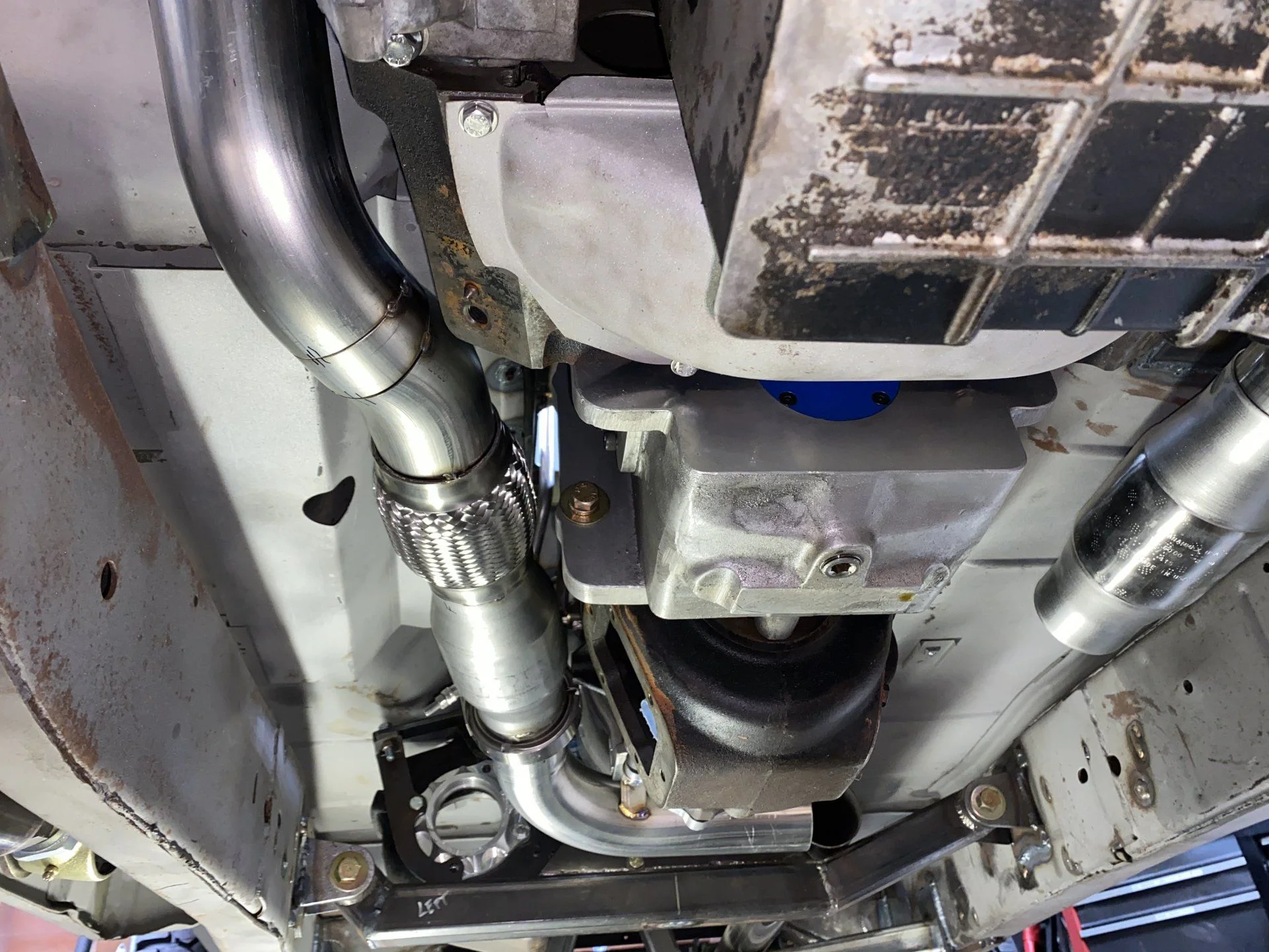

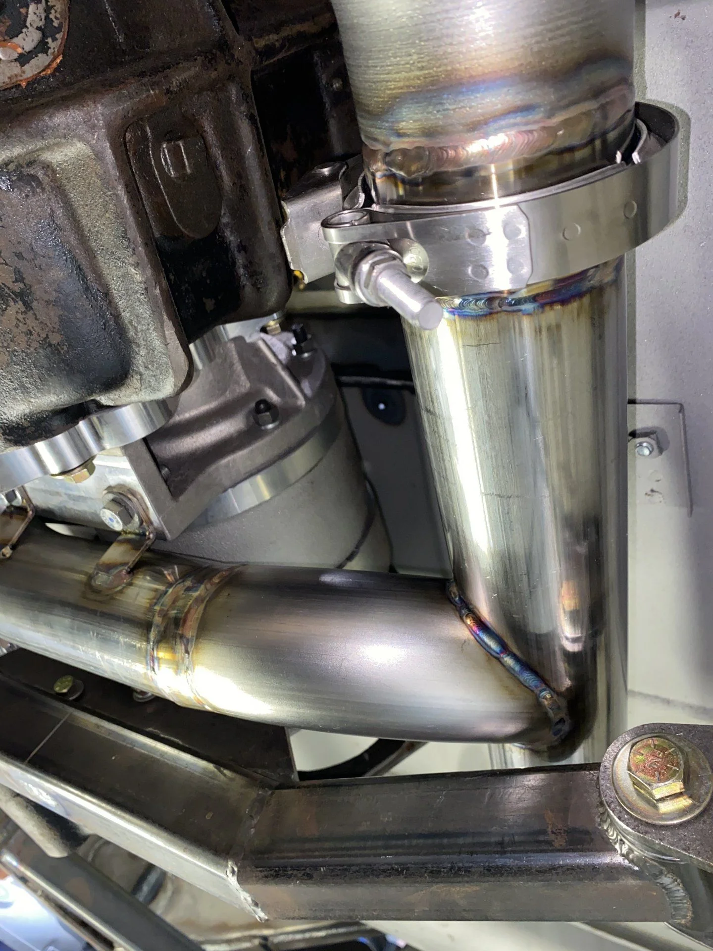

Assembled drivers side
Fully welded passenger downpipe and crossover. Using stainless clamps, fairly slick and easy disassembly

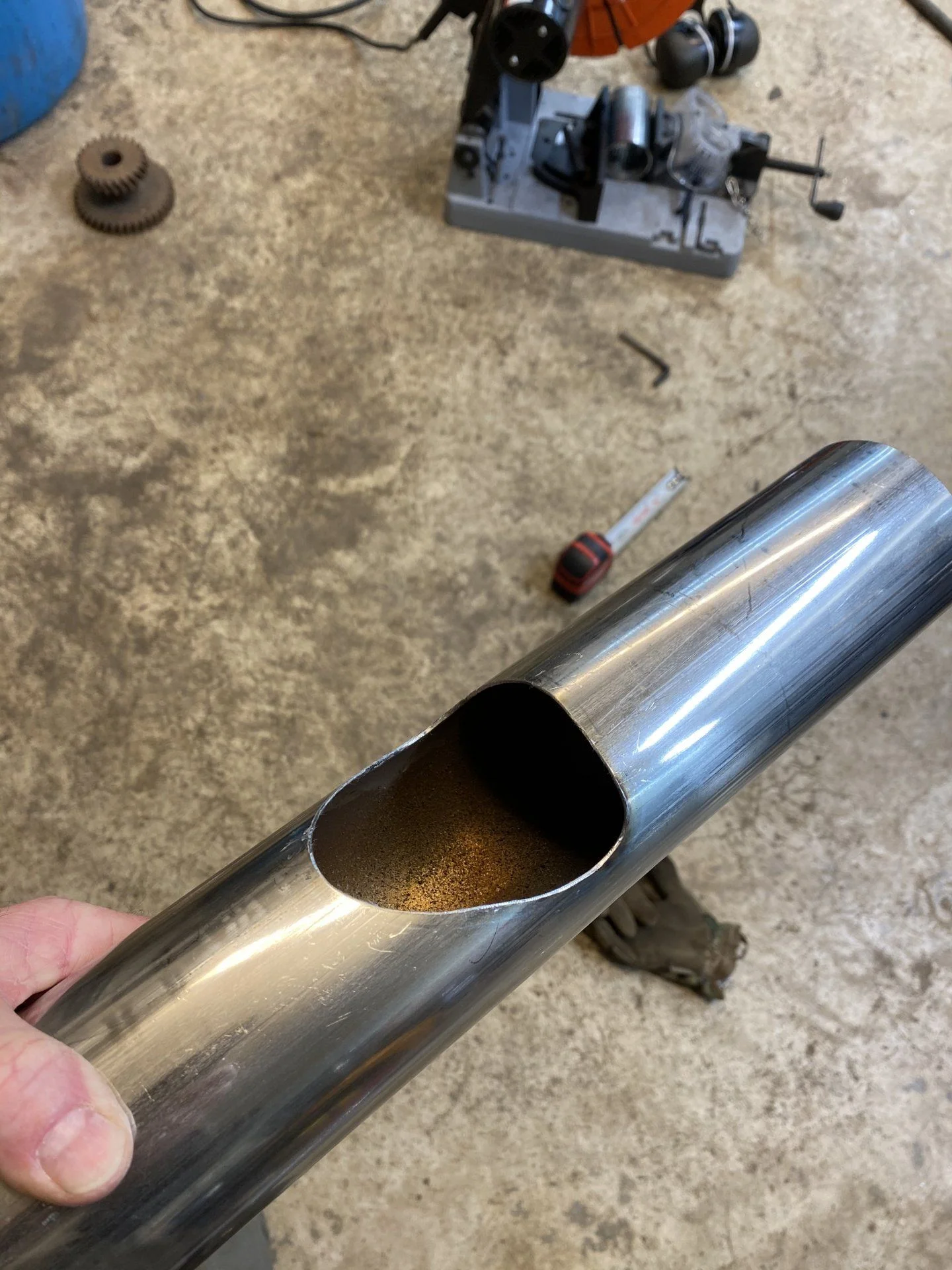

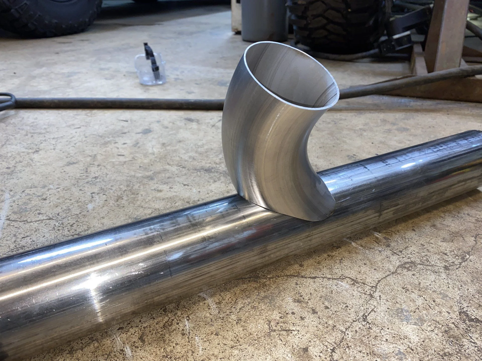

This is the coped crossover bit. The passenger side will single up into the driver side

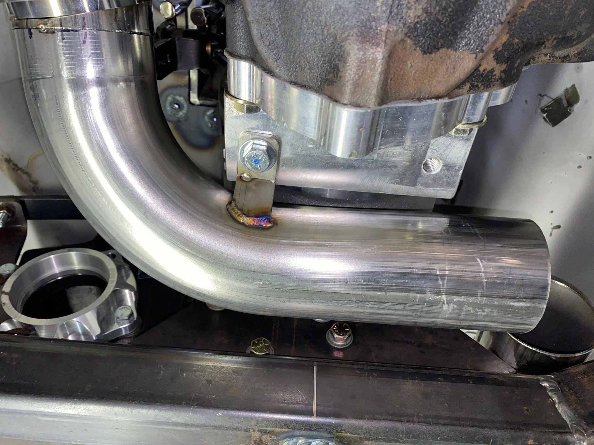

Crossover...
Welded flange
It’s all welded and in place, good grief. 2 days of solid TIG
