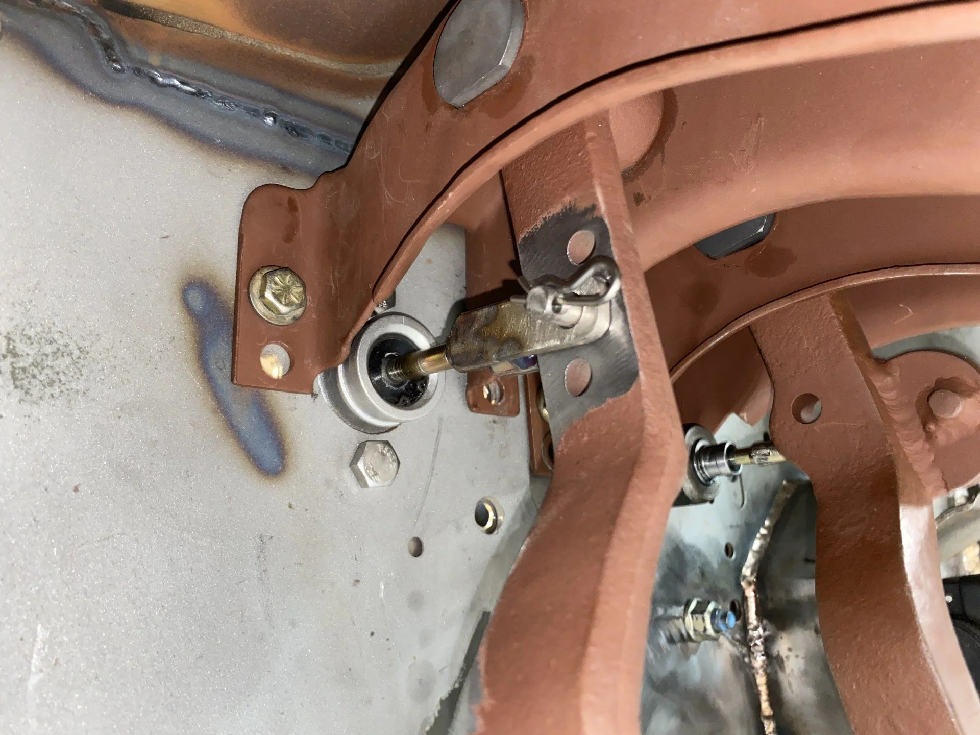

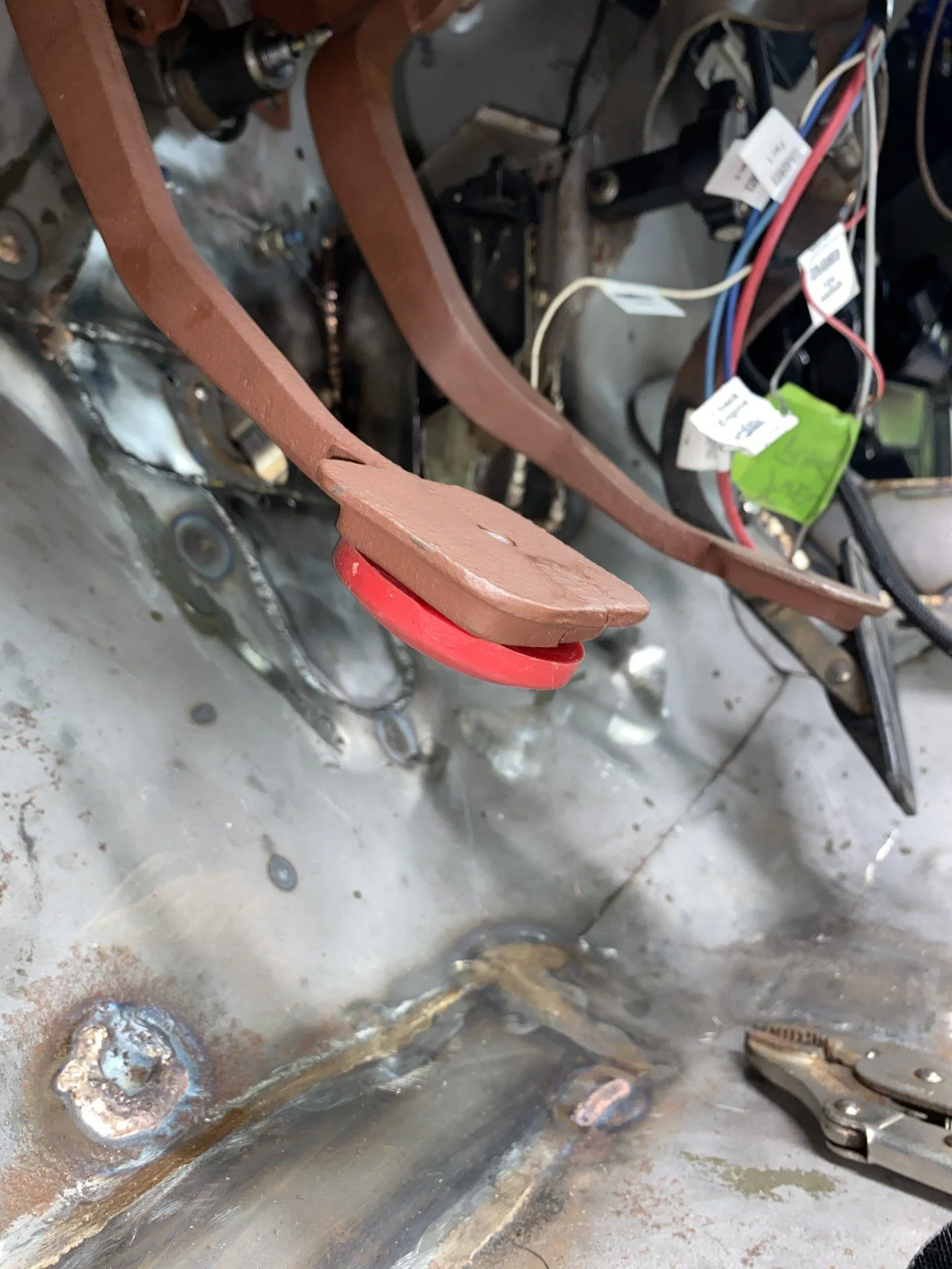

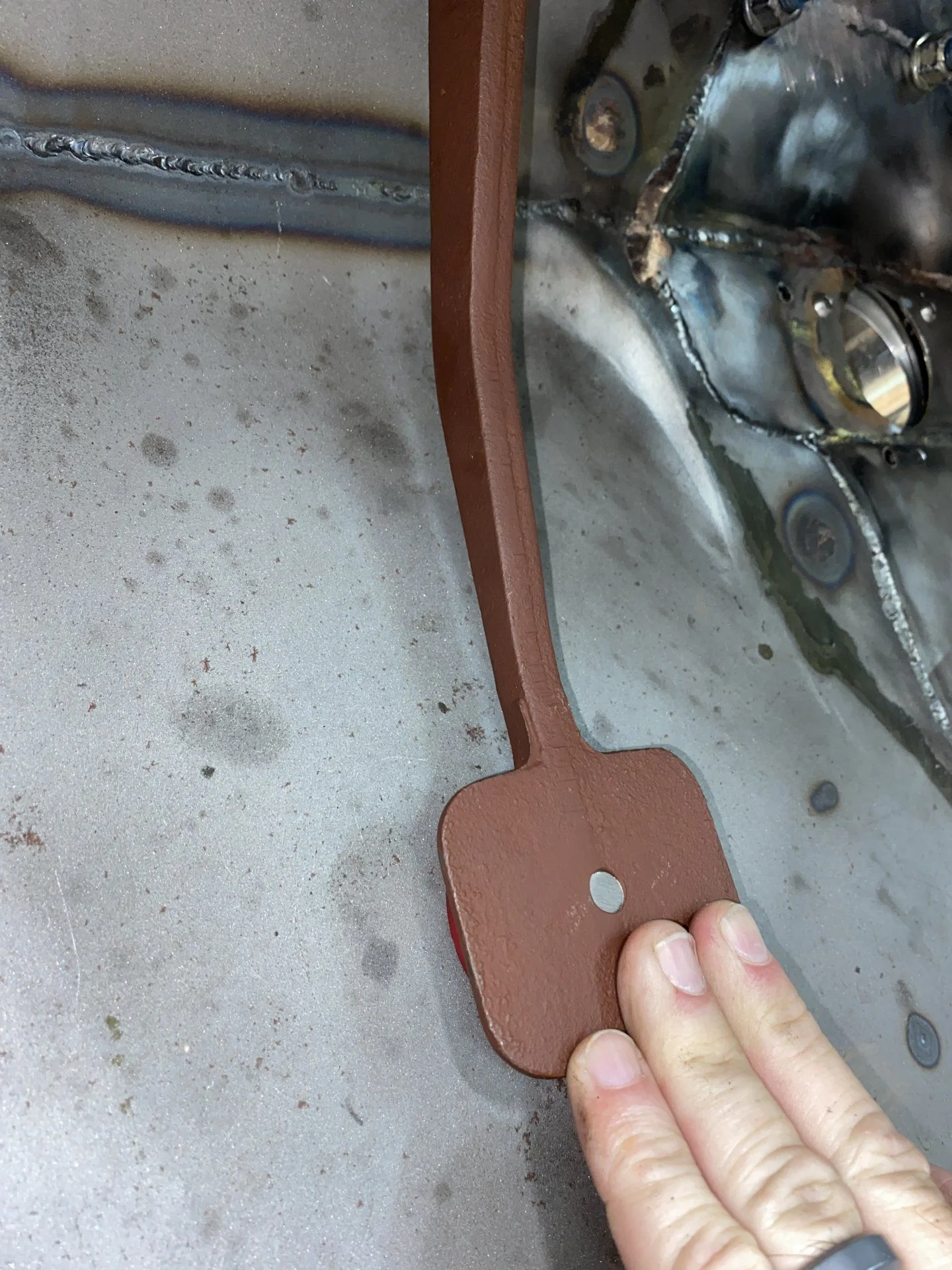

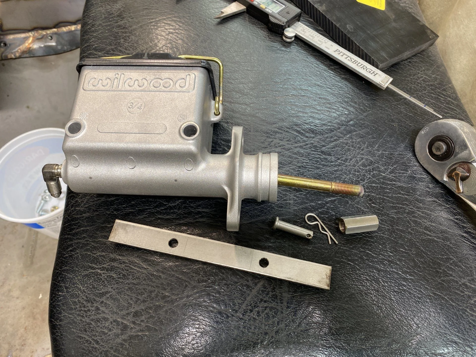

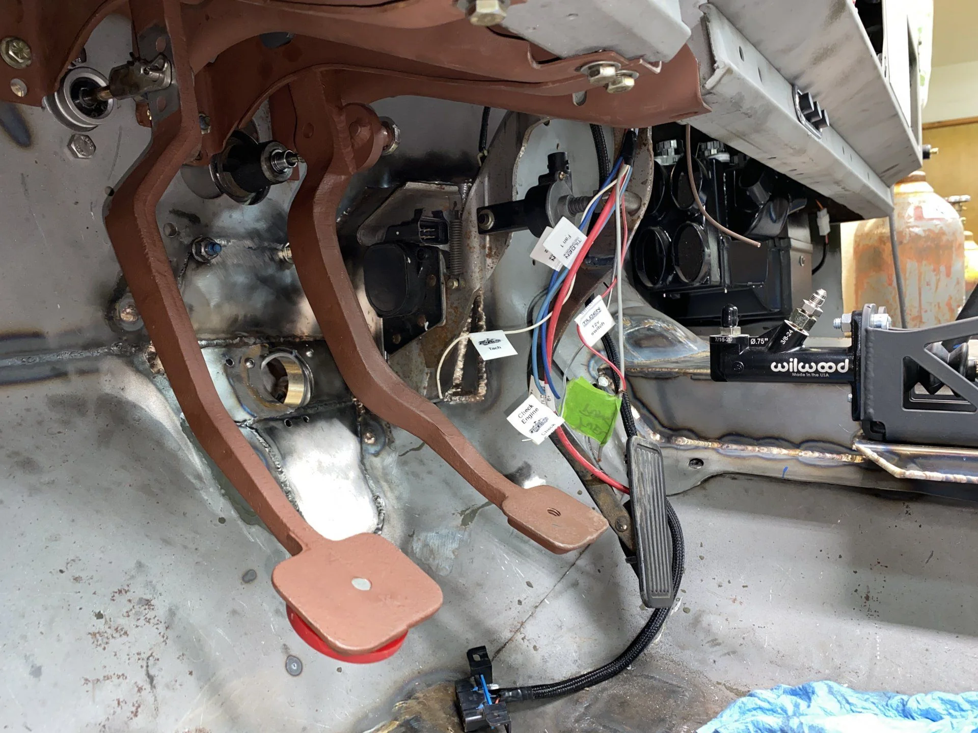

Clutch master and pedal retrofit
Clevis made out of stainless bits
Pedal alignment
UHMW spacer for the master
Added a rubber pad
Bottoms against the floor

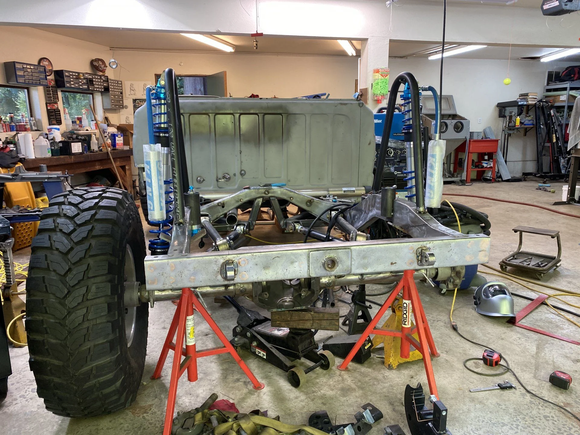

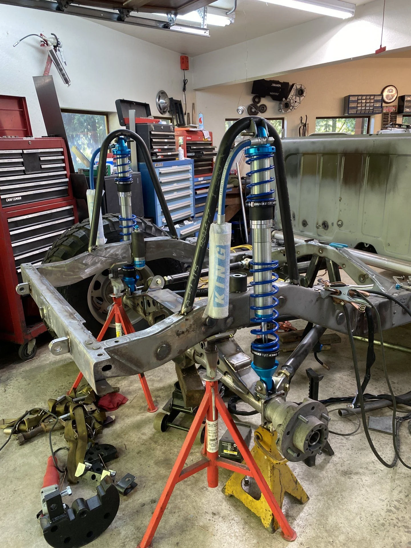

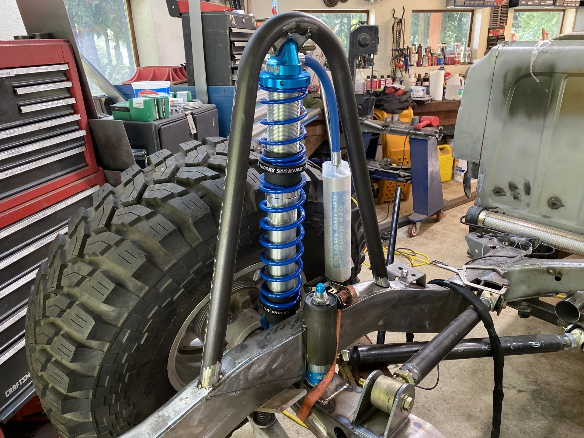

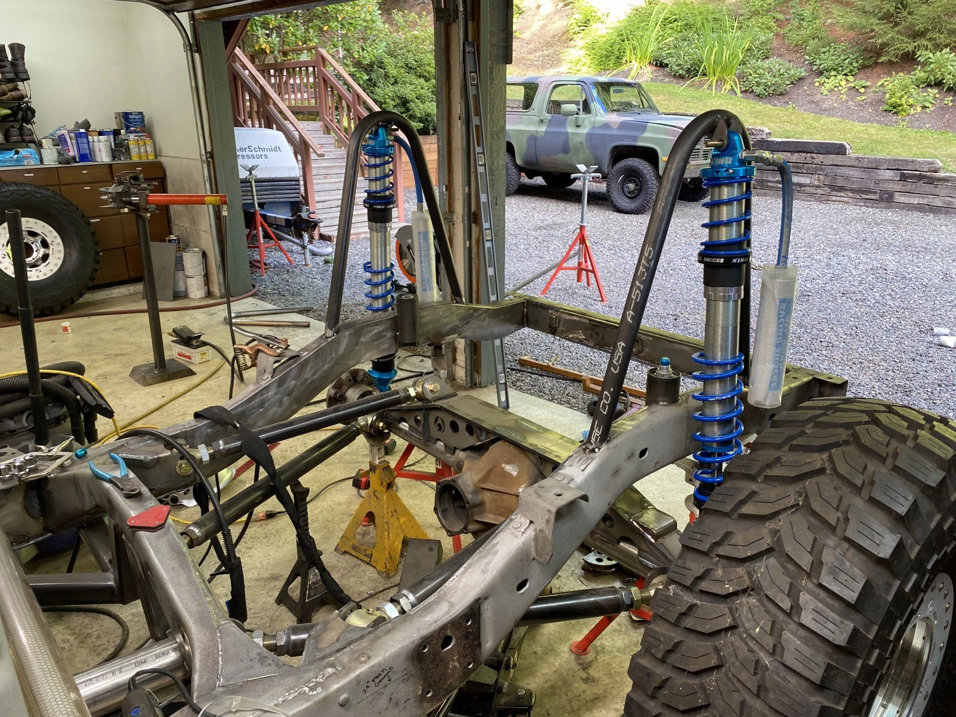

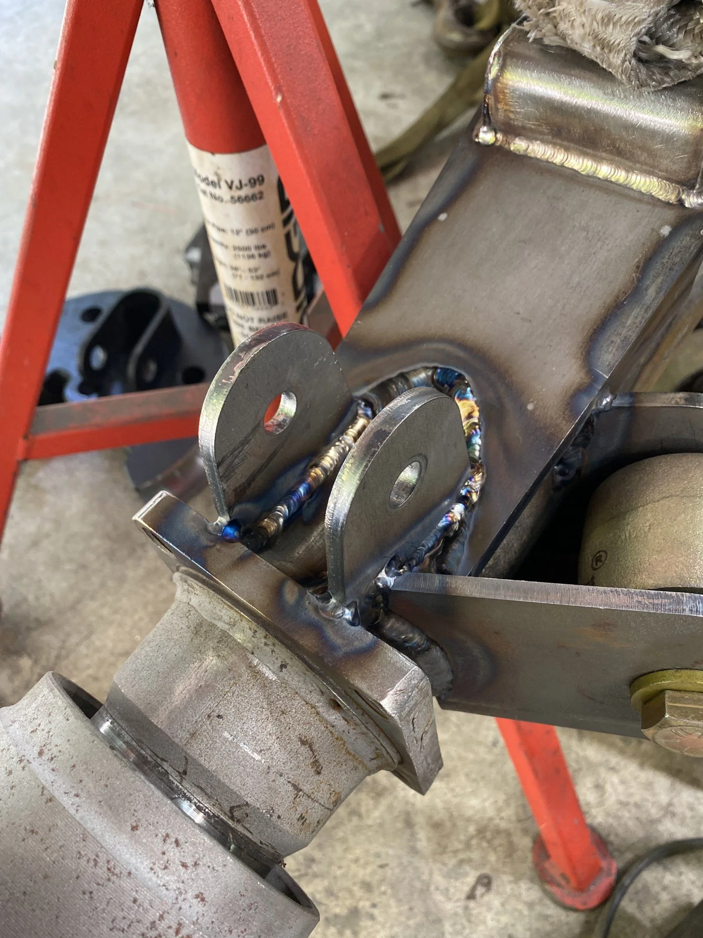

Working on the rear axle shock mounts

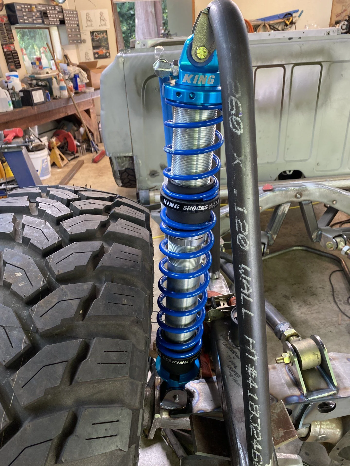

1.5” DOM mounts. These are King 2.5’s with 16” of travel. Rear are triple rate
Full bump driver, full droop passenger

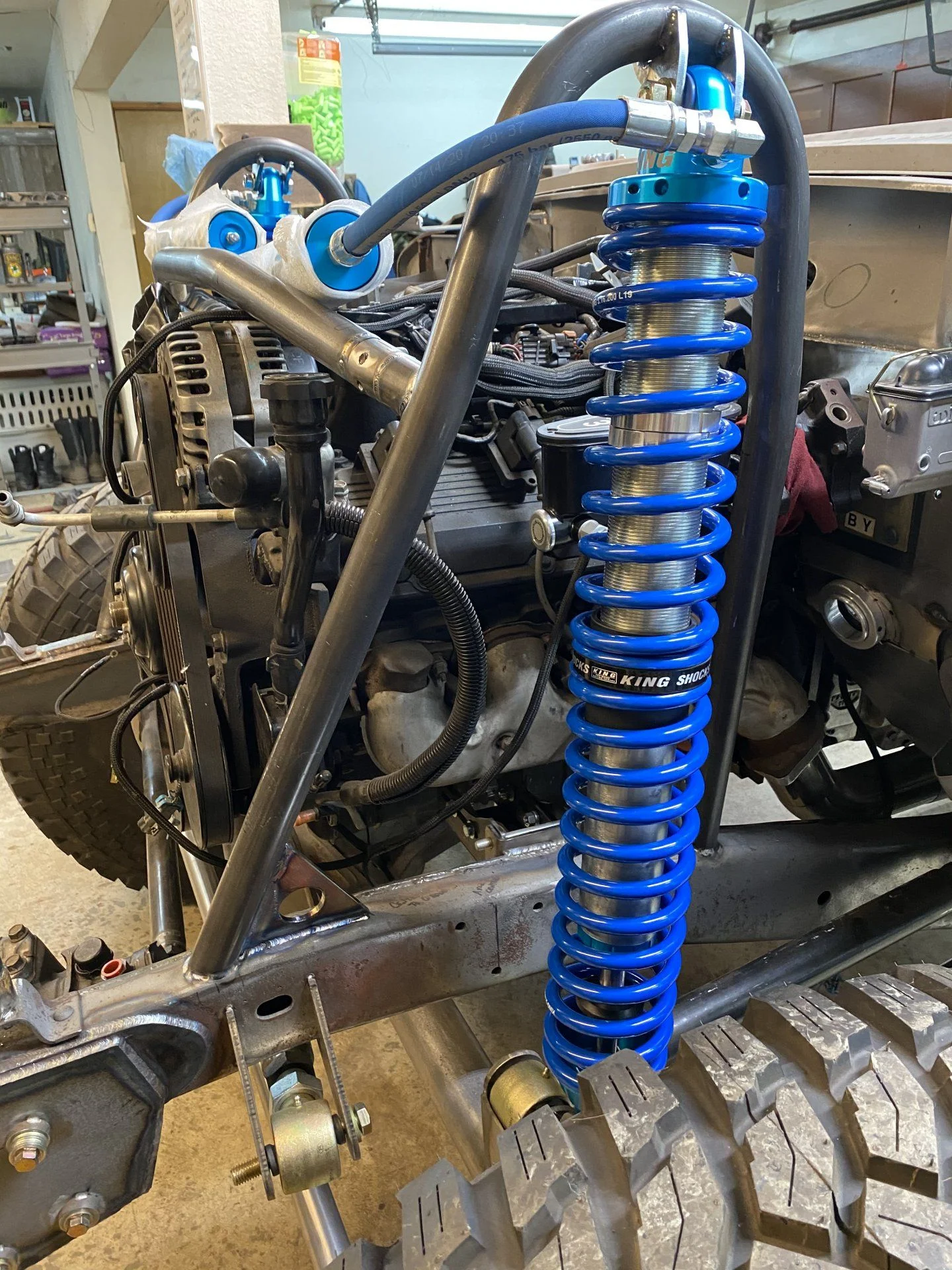

They are big hoops but I guess that’s what you get when you have 16” King’s on a truck with nearly no lift

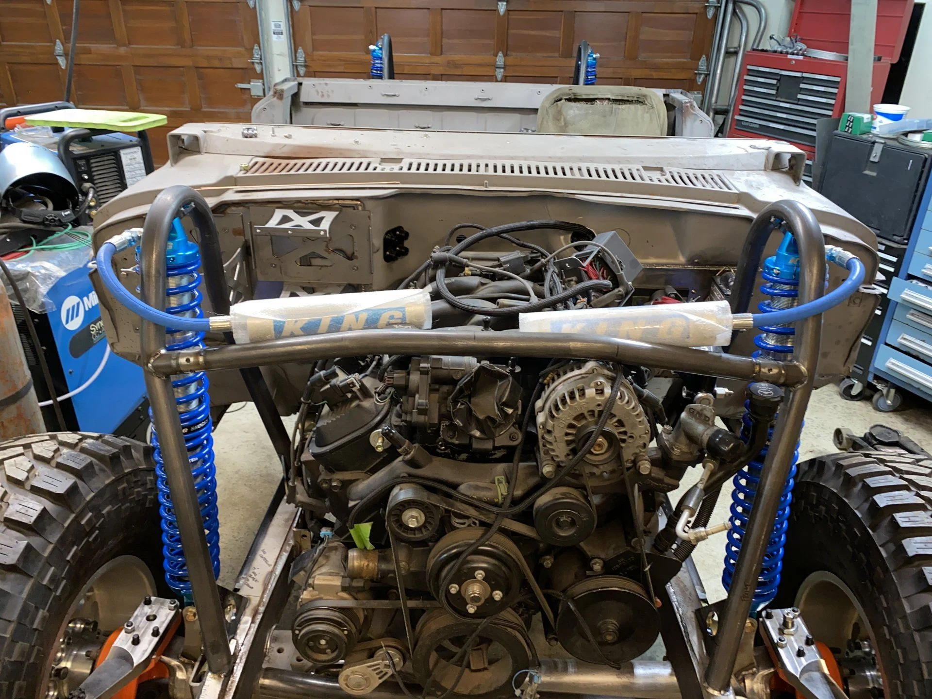

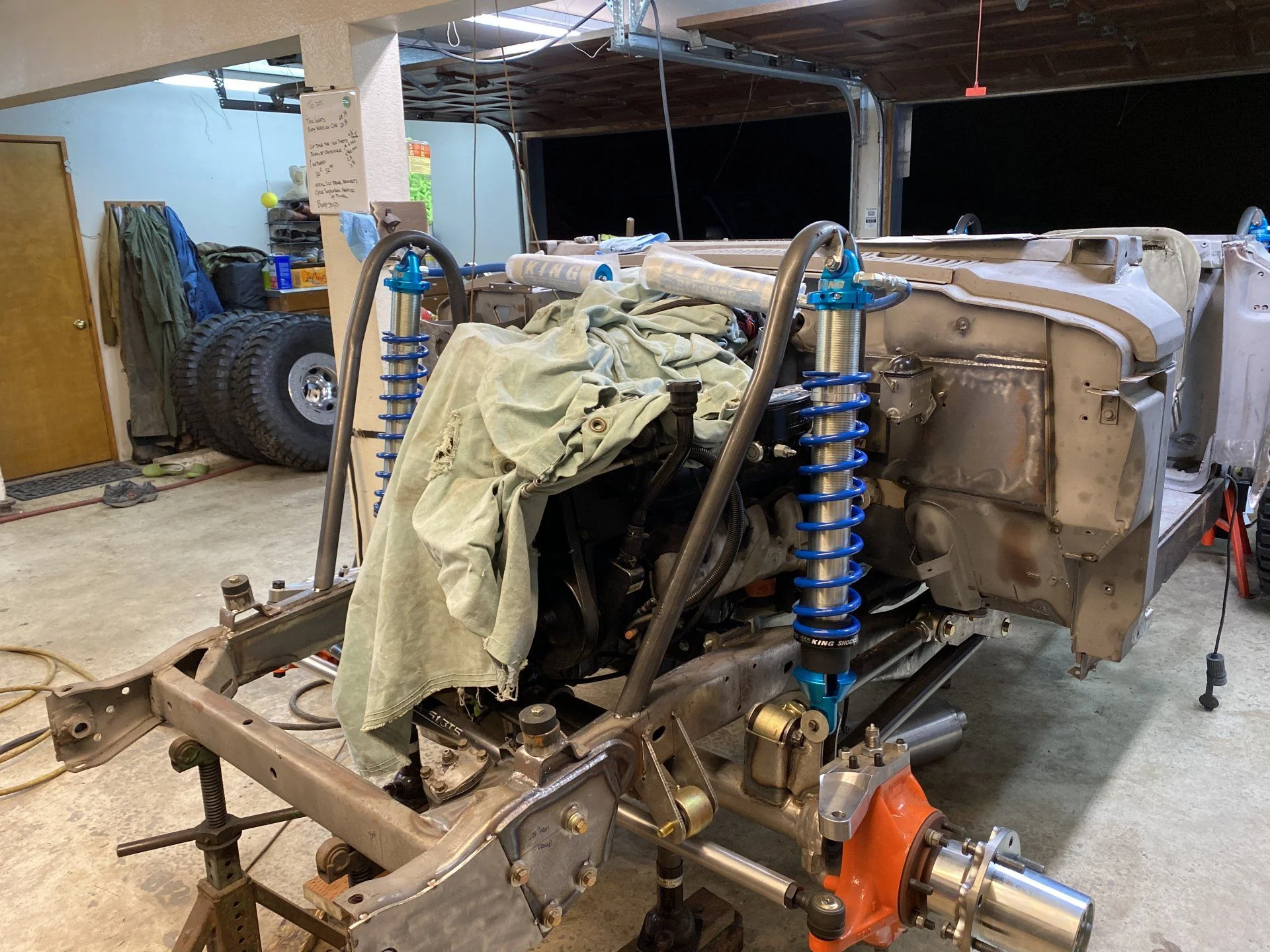

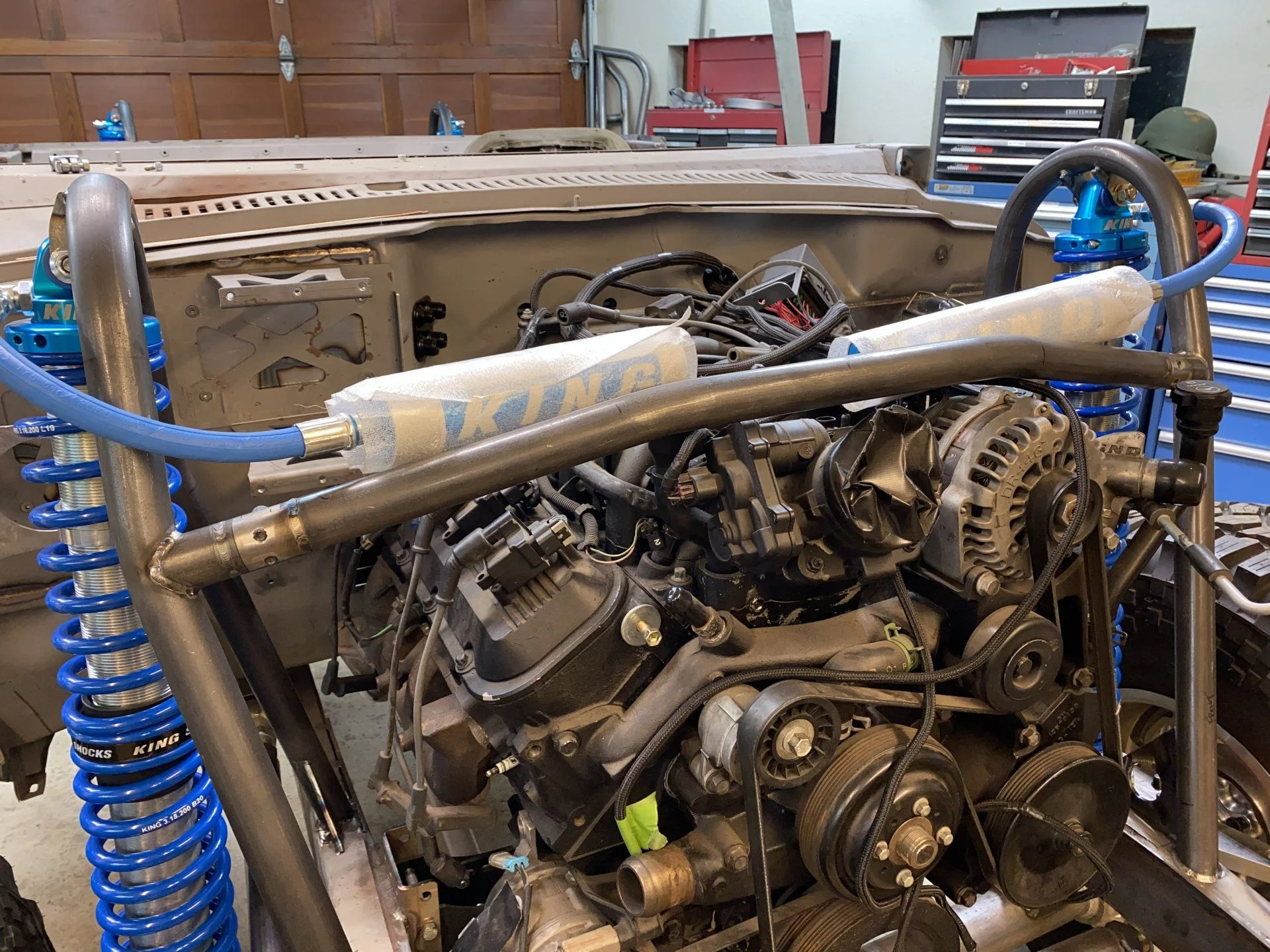

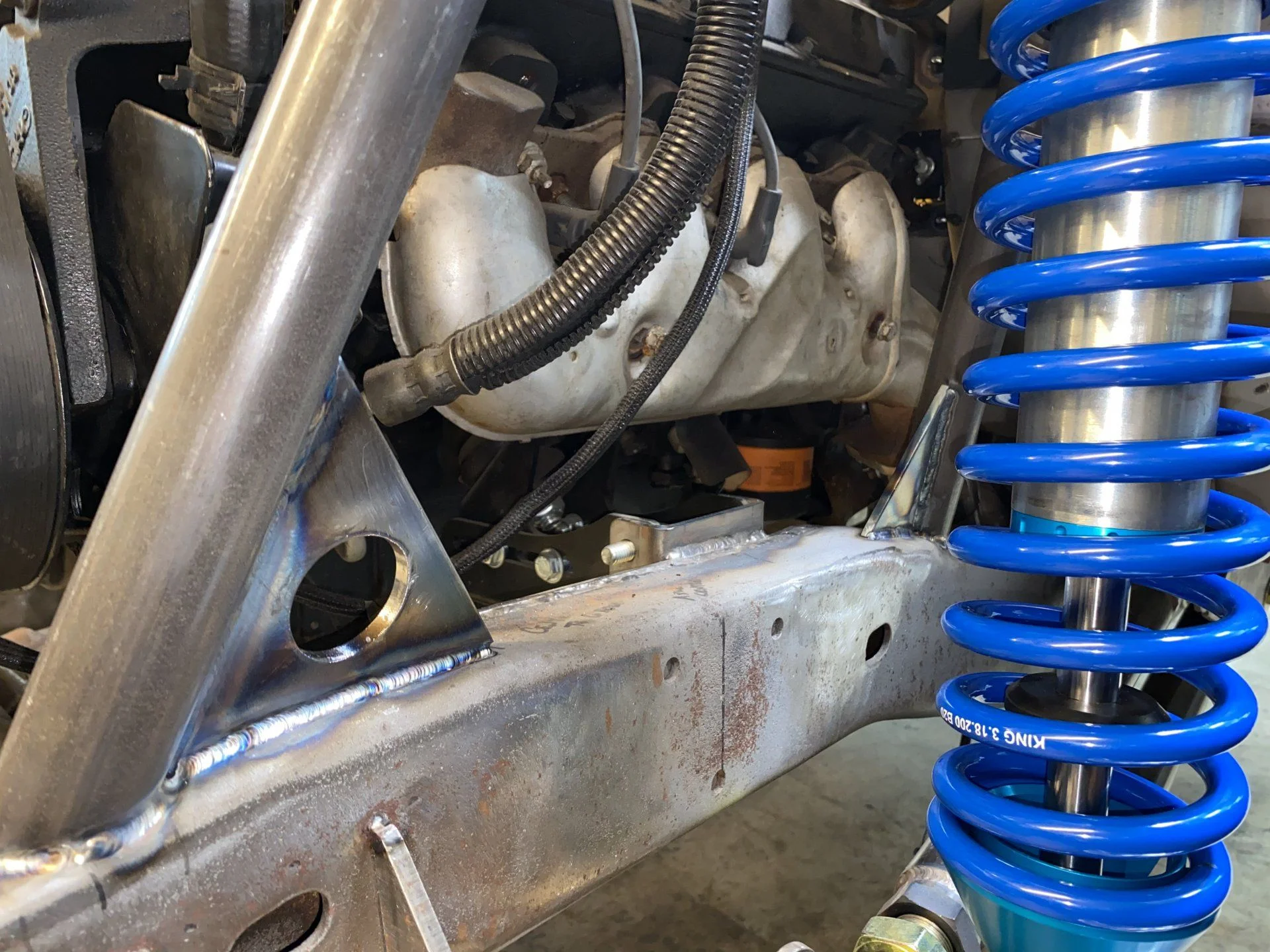

Front King shock mounts...
Cross bar...

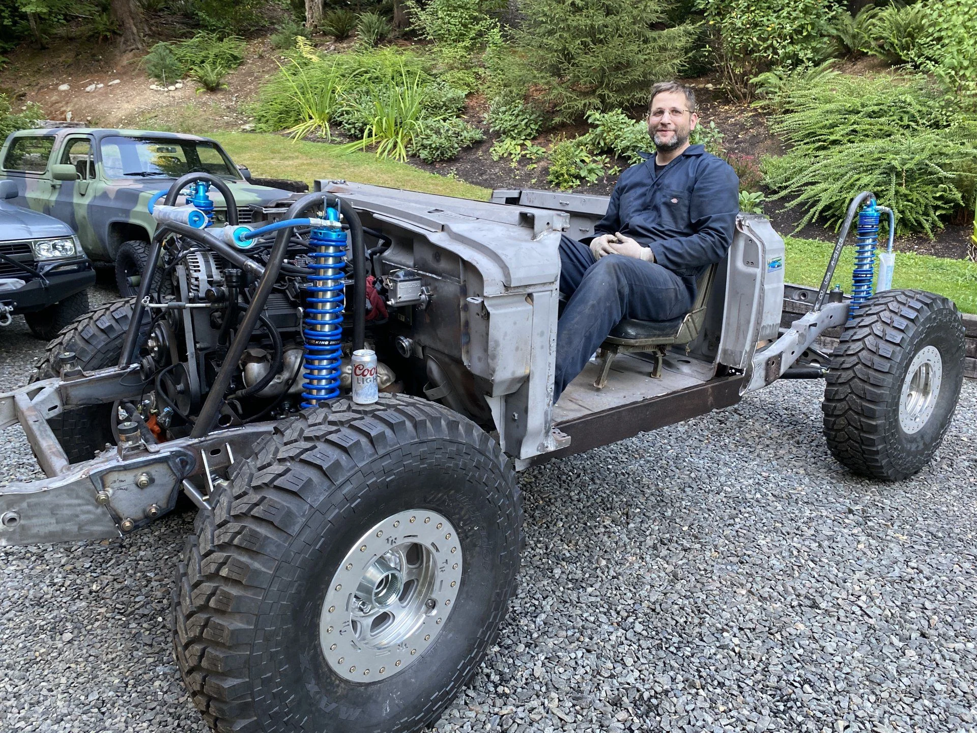

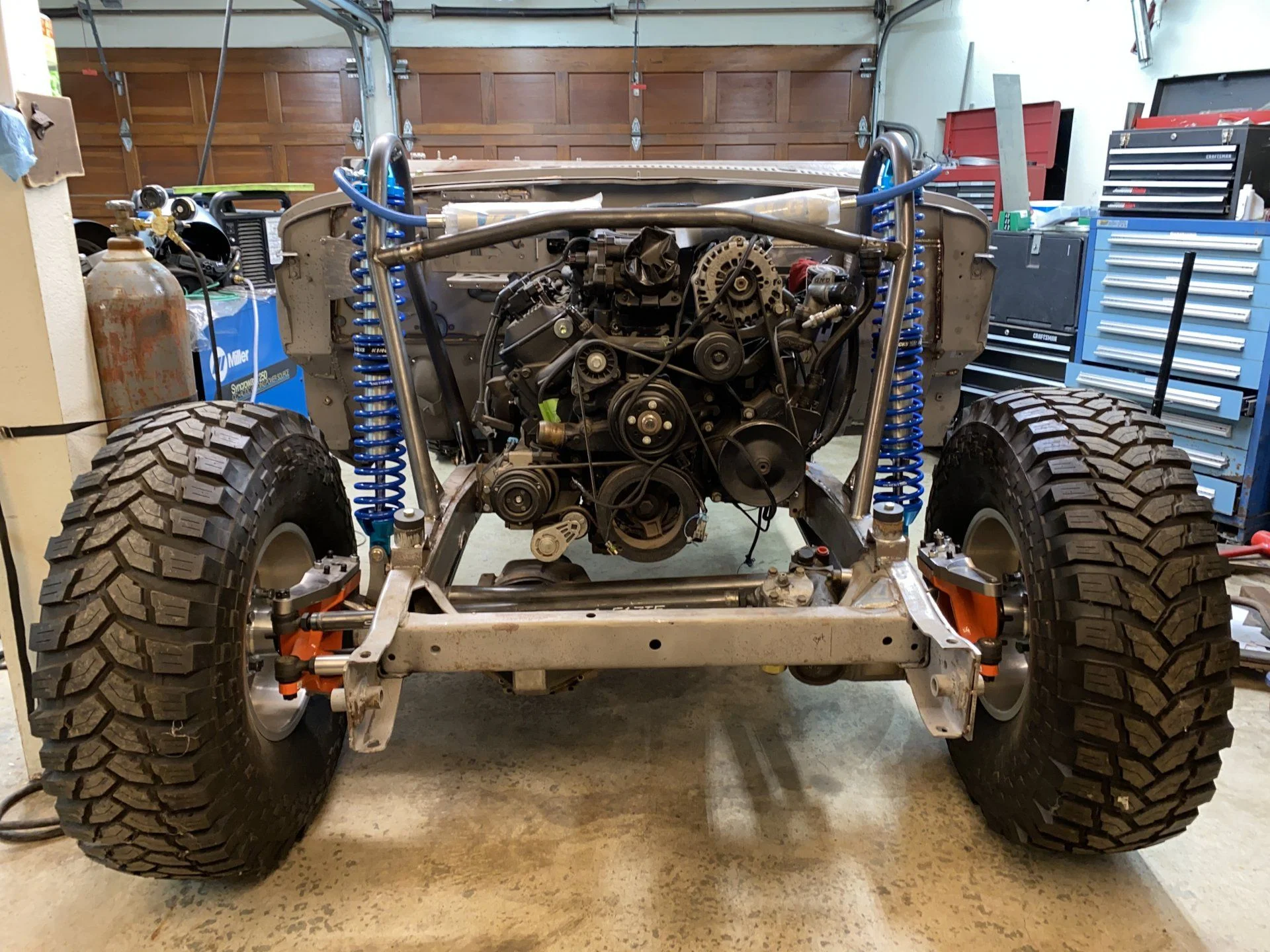

And after about 2 years, it’s finally rolling

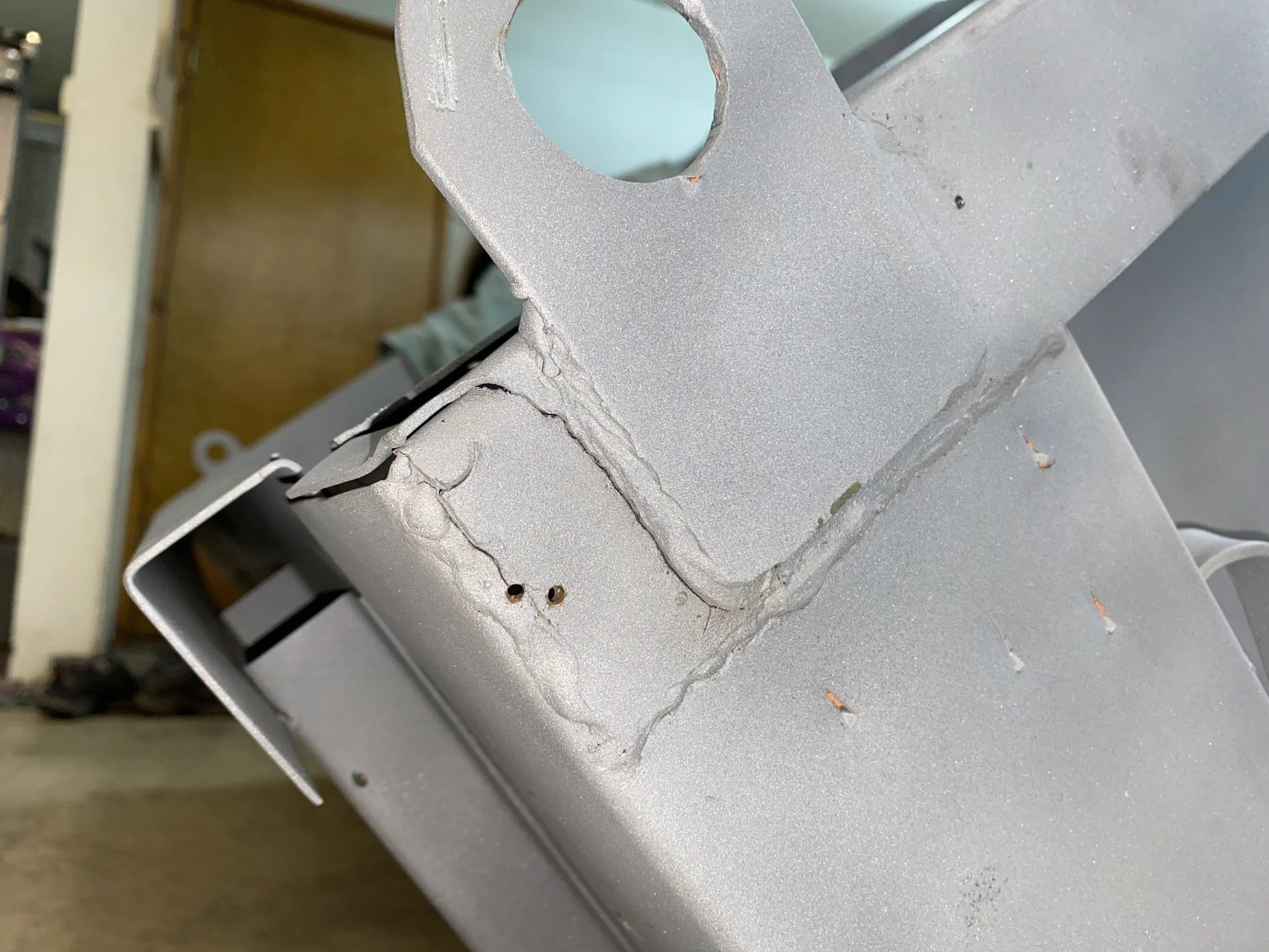

Completely broken up bed corners

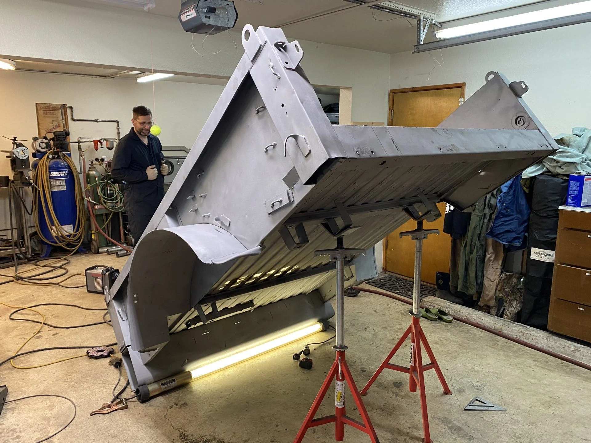

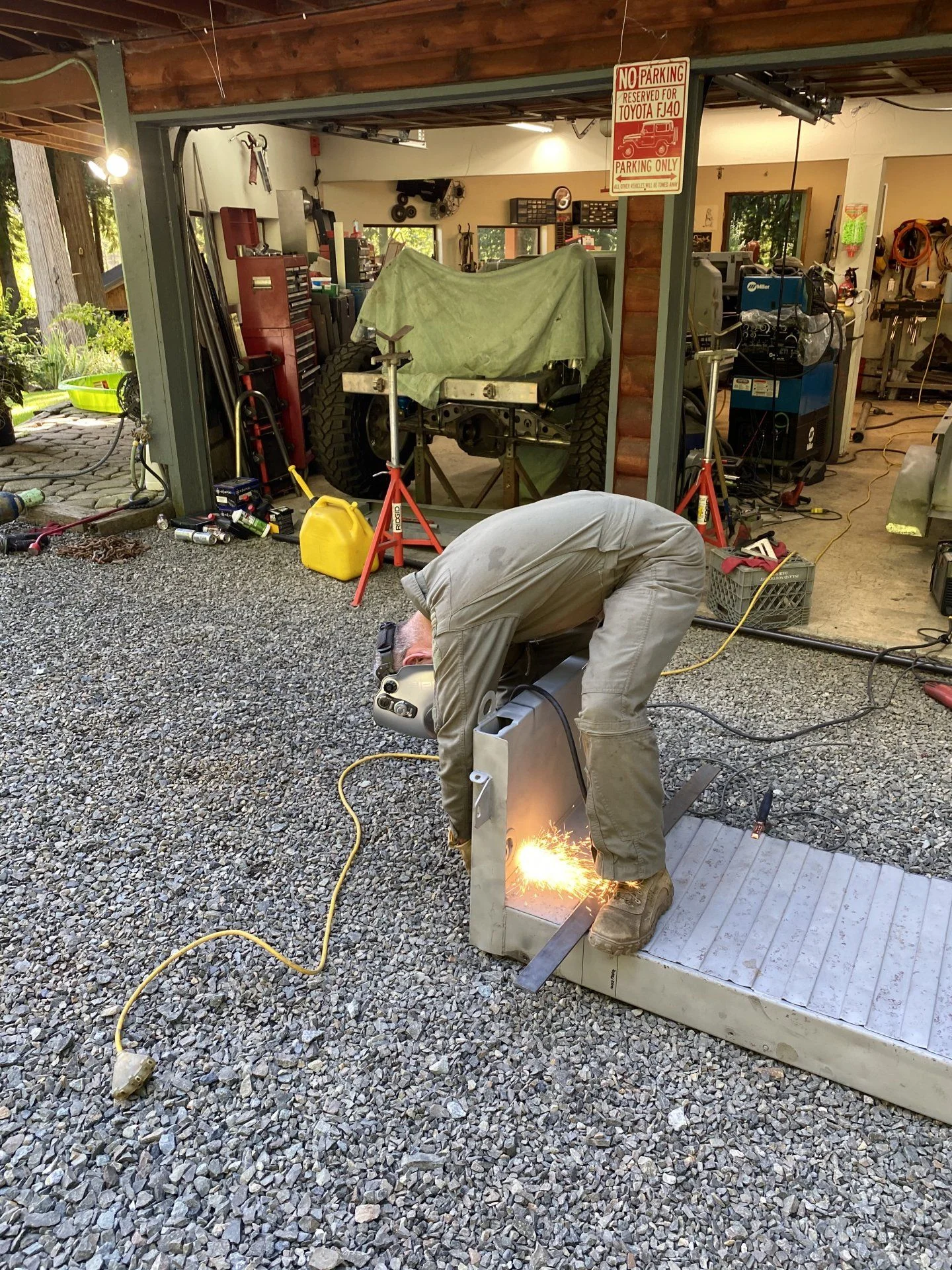

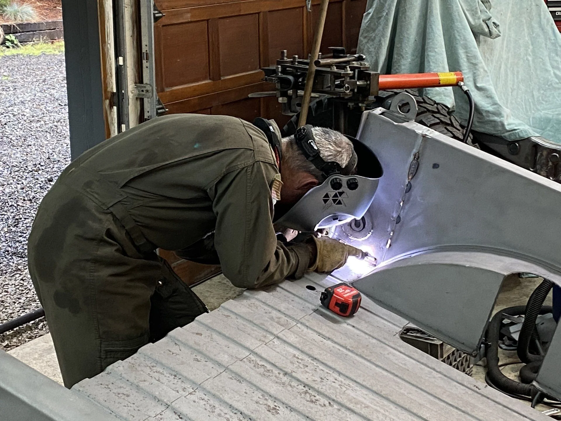

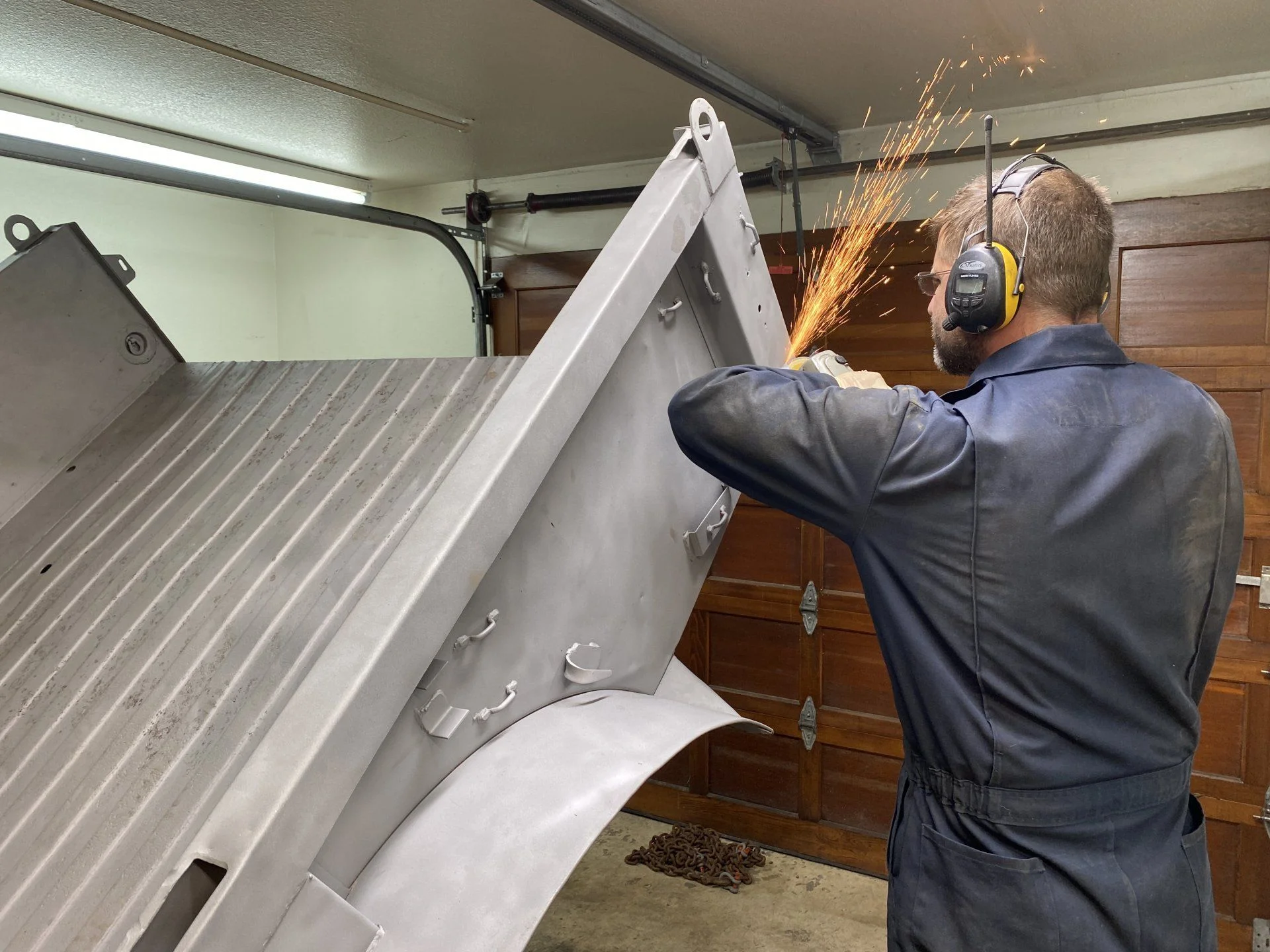

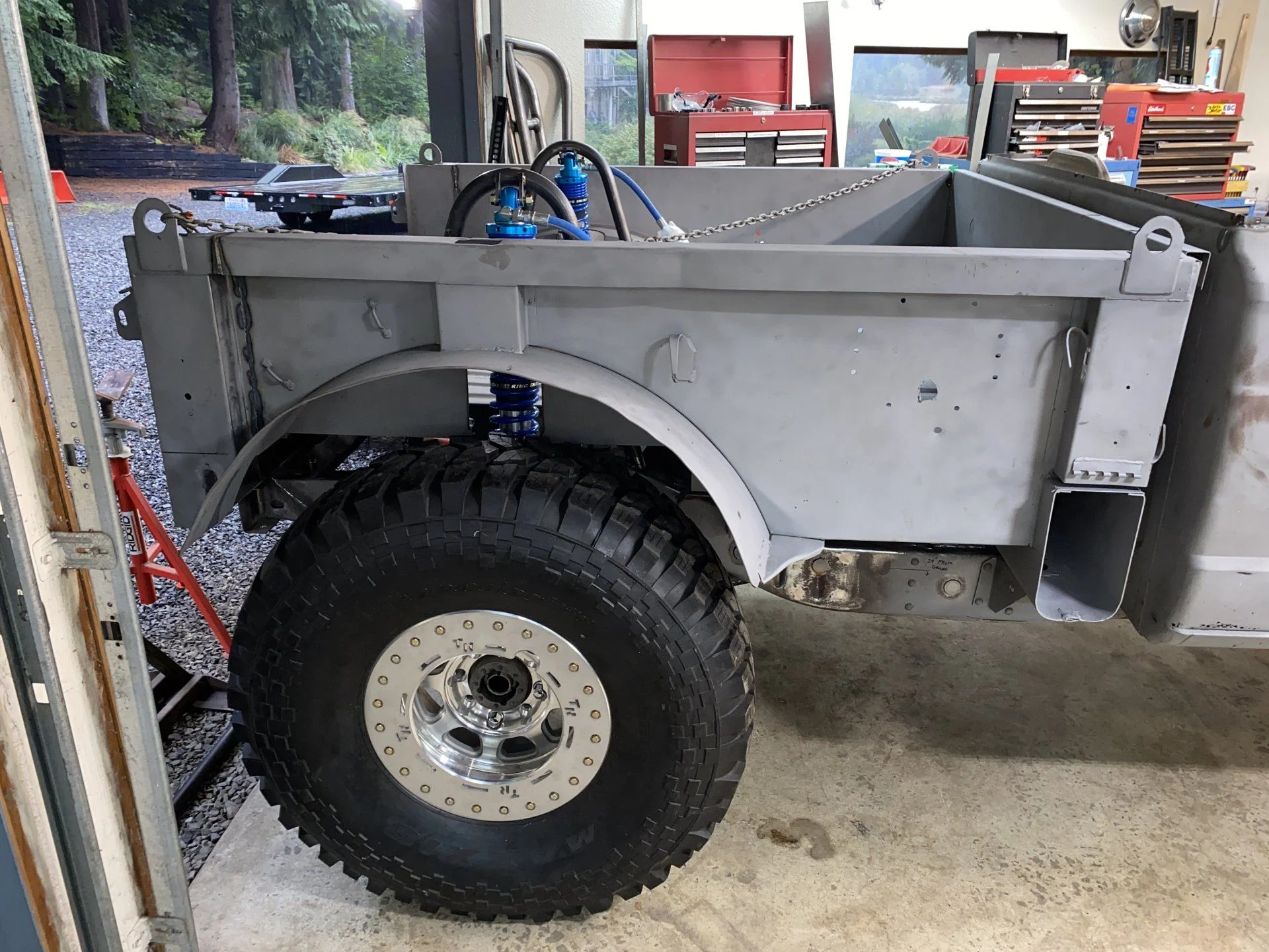

Cutting the bed for the coil overs...

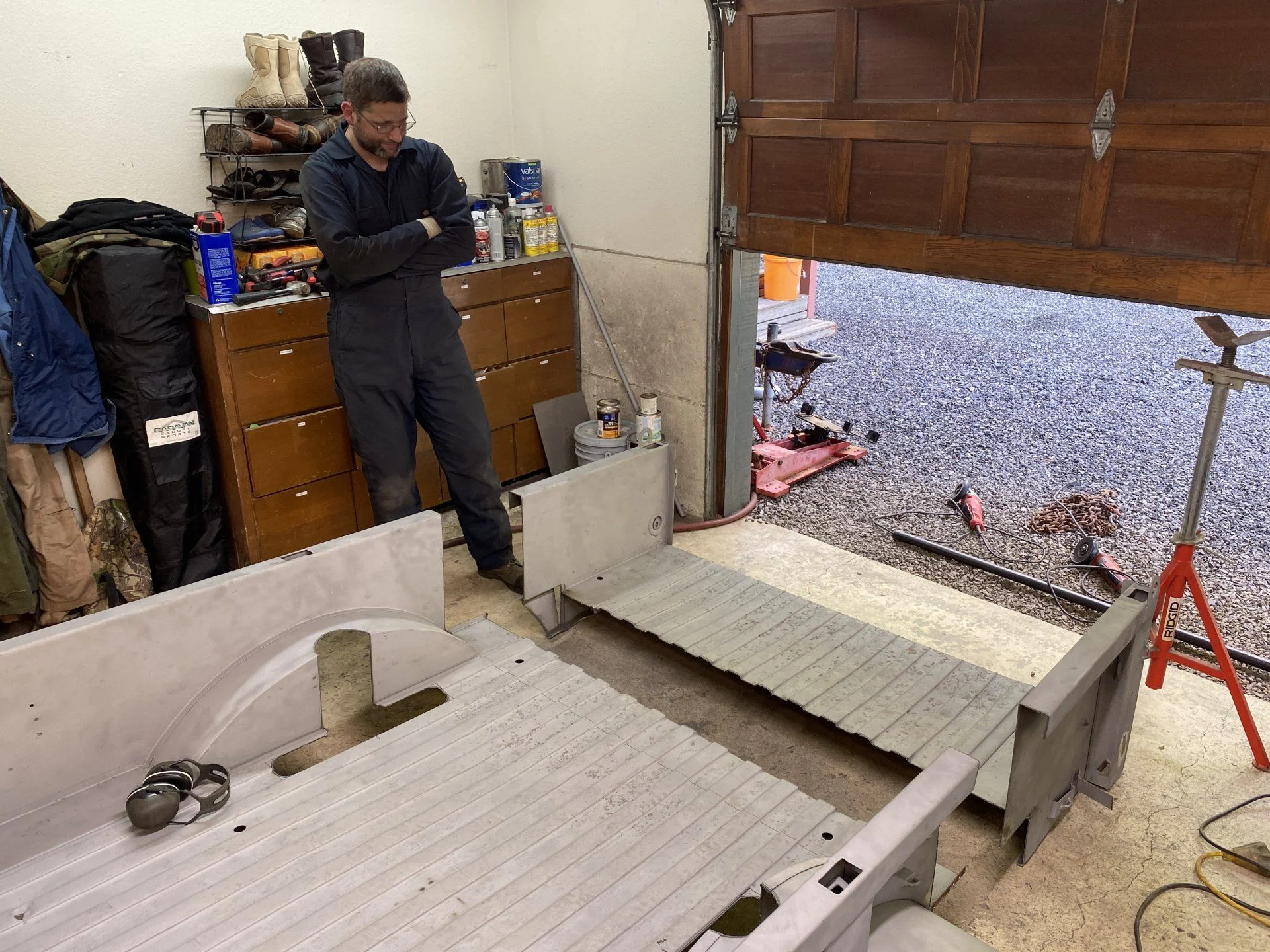

Marking the rear of the bed to bob it. Shortened it 22.25”
Removing all the extra bits that were in the way...
Marked for shortening
Off it goes

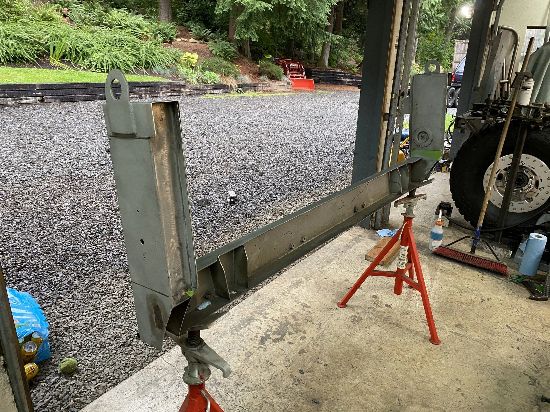

Cleaning up the rear crossmember

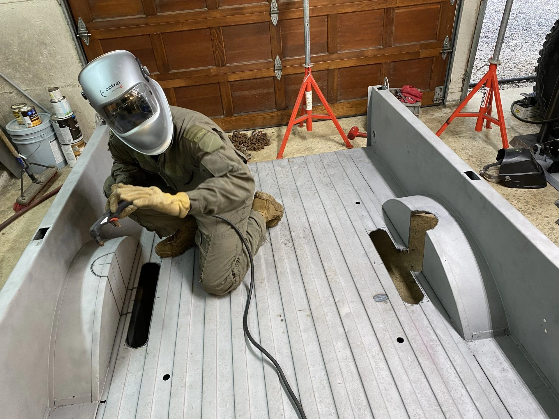

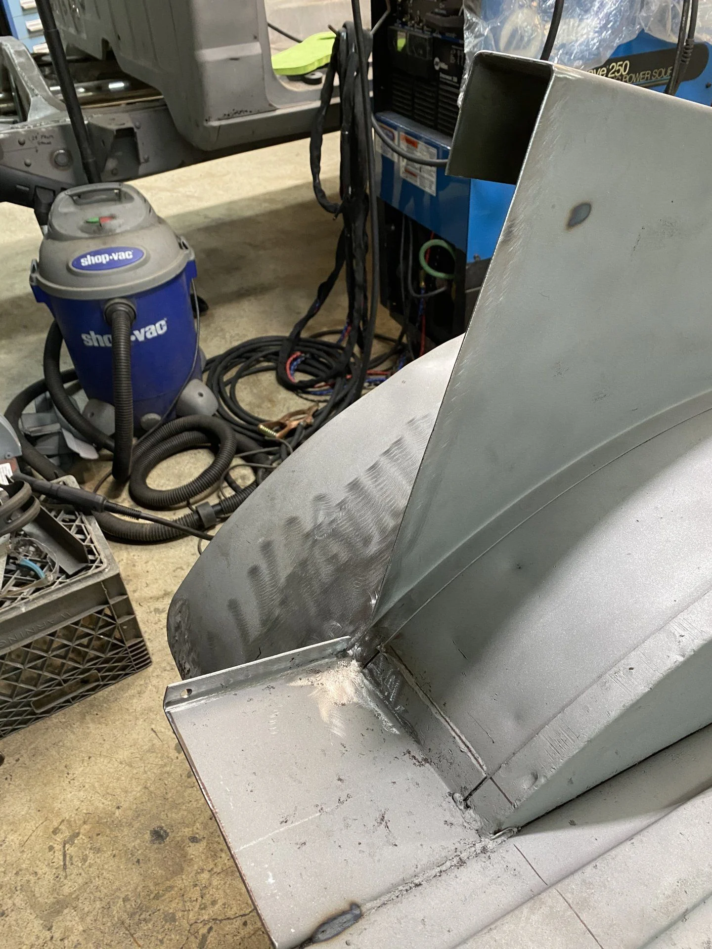

Bed splicing....
Rear section

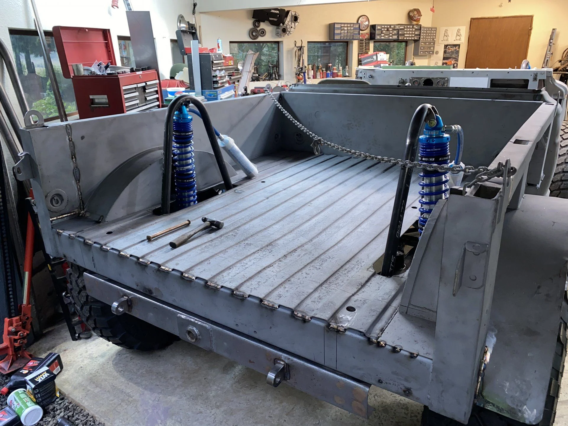

Putting it back together...

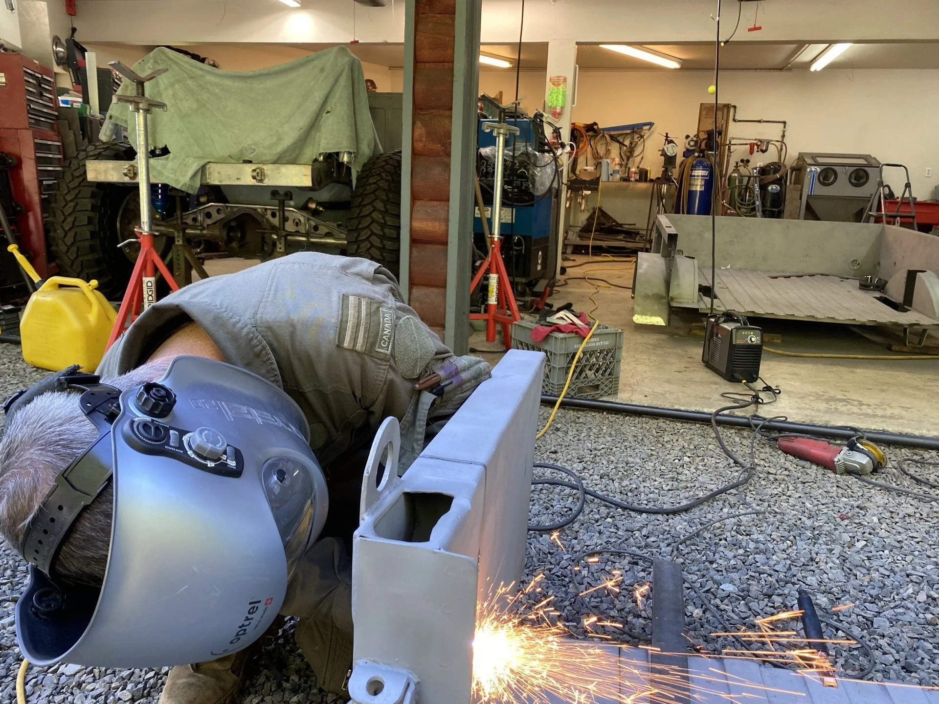

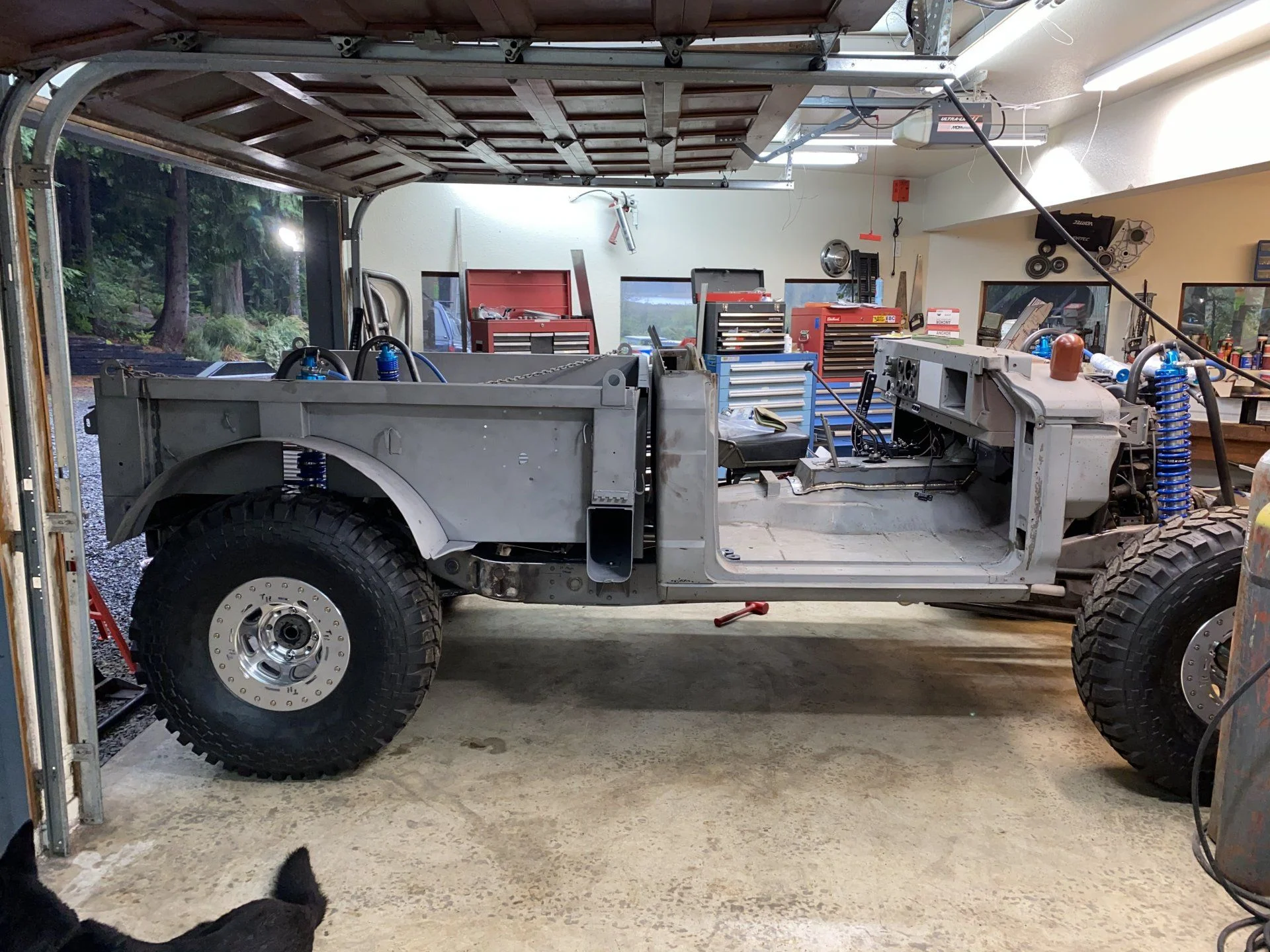

We’re at the end of a 5 day wrench fest, 12 hour days on this, pretty tired

P.S. You know you could make even better progress if you didn't TIG weld EVERYTHING on the truck?.. :hmm: :lol:
THANK YOU. Yeah the TIG is slow but I’d never done it prior to this build. Part of the goal was building skills. And any weld just about beats the factory ones from 68’ good grief. They look like they were done in a Friday afternoon by someone who’d been drinking on the job

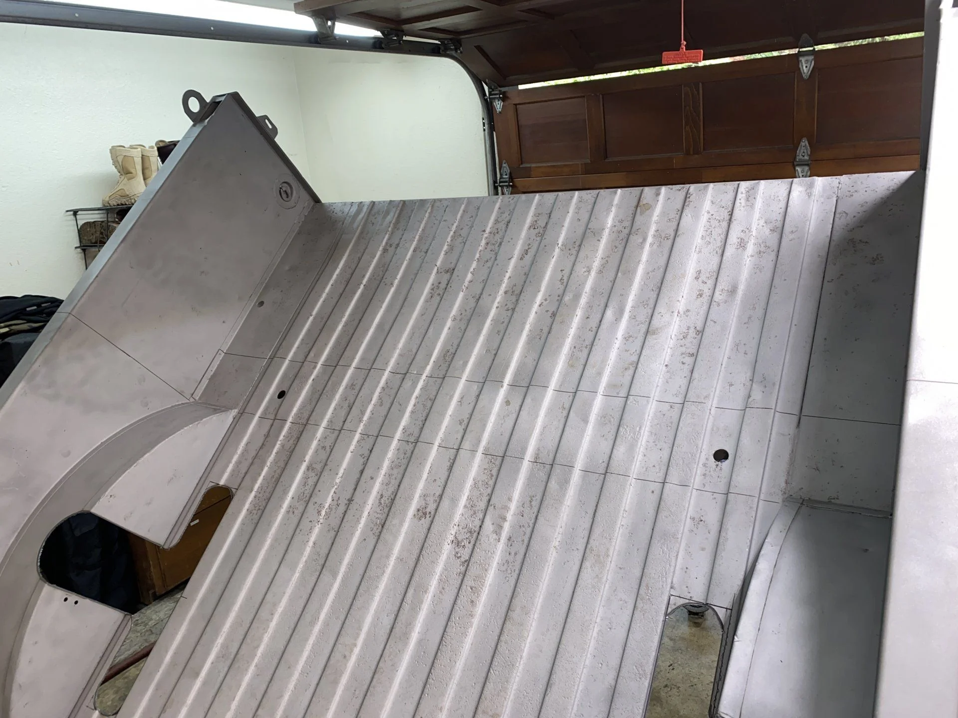

Here’s a better shot of how we married the bed after shortening it. Inside cut eliminated the need to splice the horizontal bed surface. Pretty slick

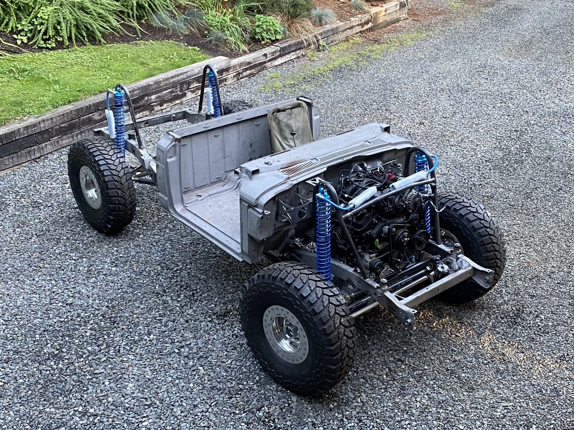

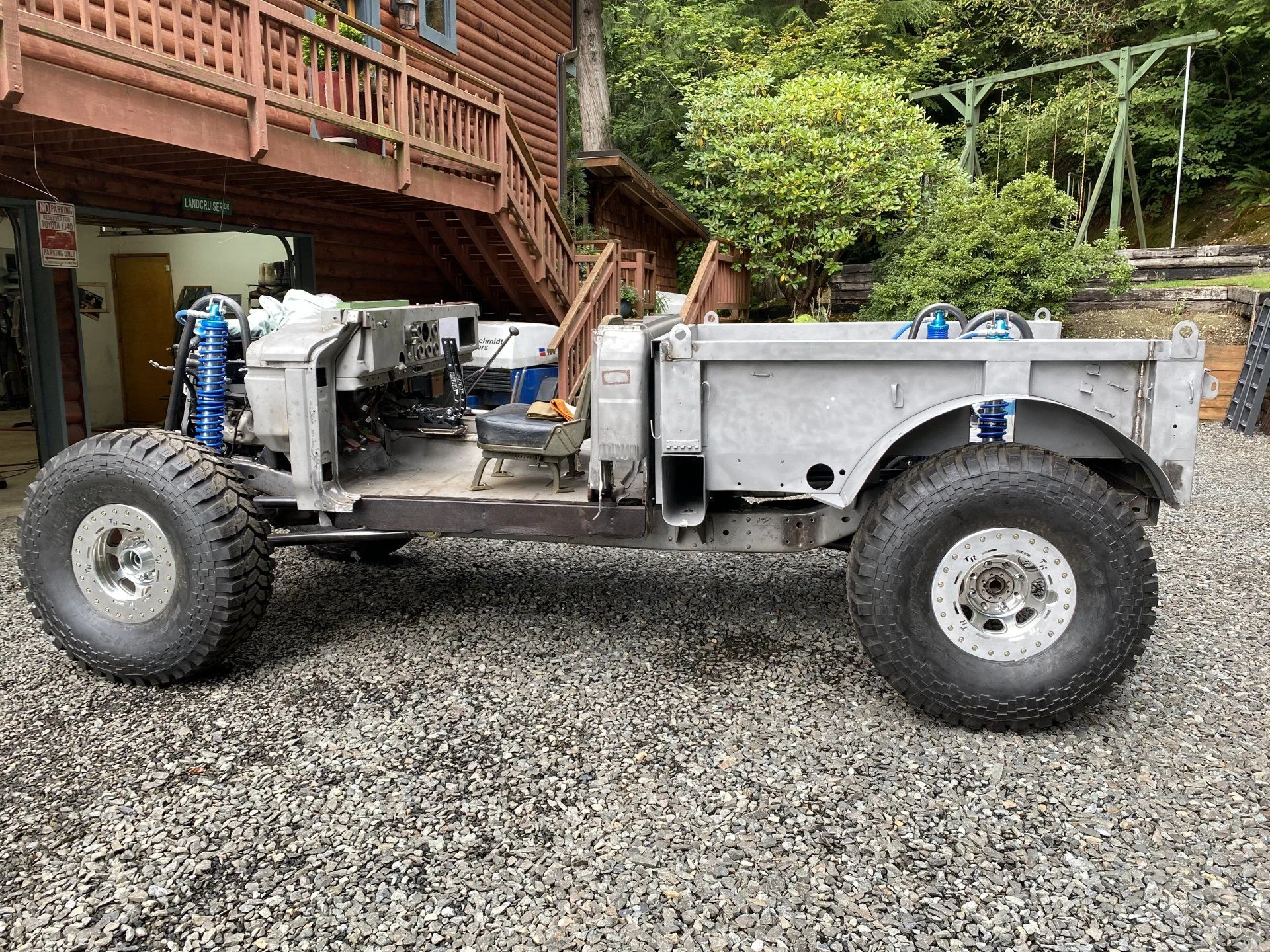

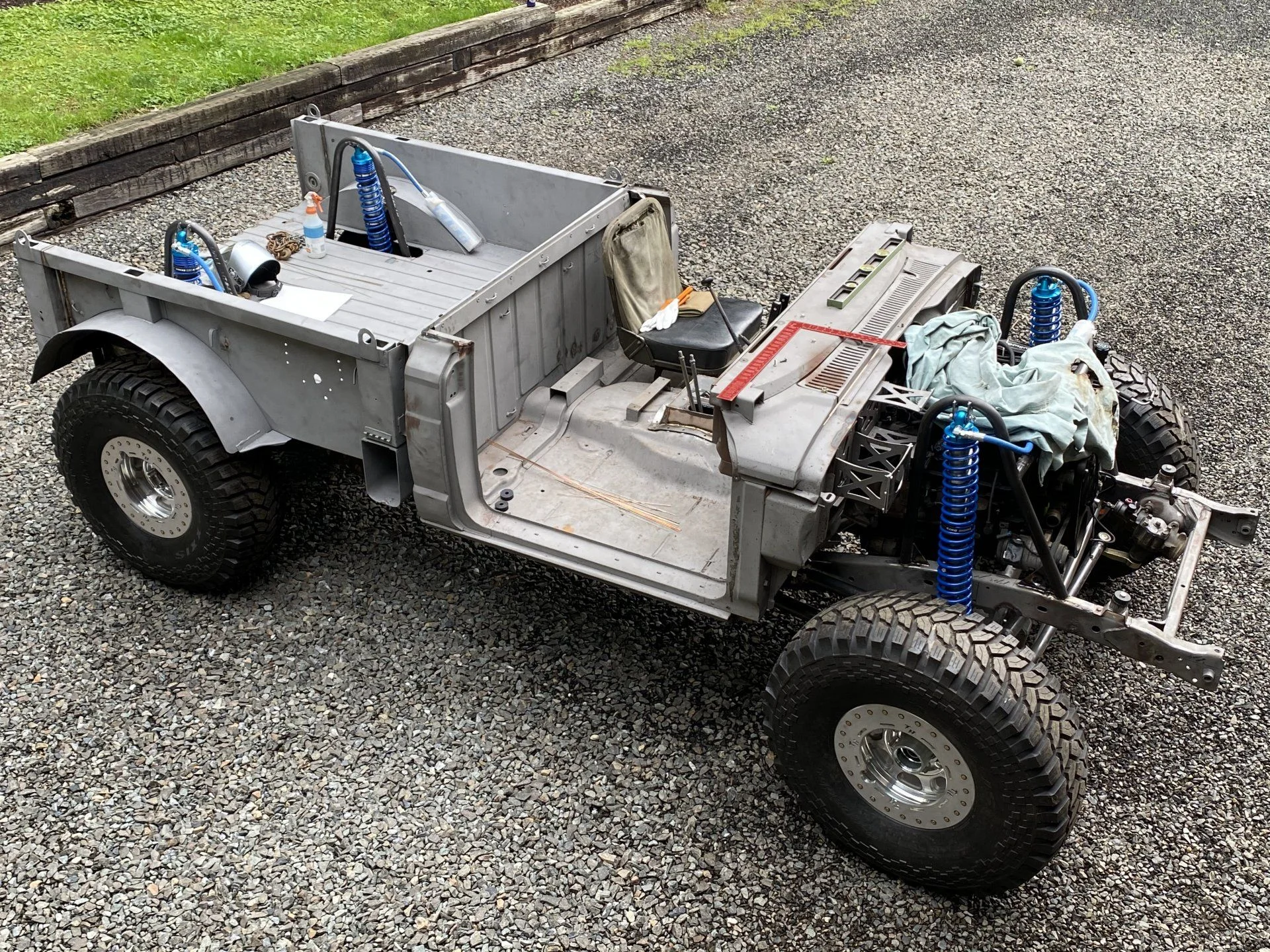

Finally quit pouring rain this afternoon so I was able to push this out of the shop for some better overall pics
I suspect this will be a very good hill climber. Overall wheelbase is 124”
