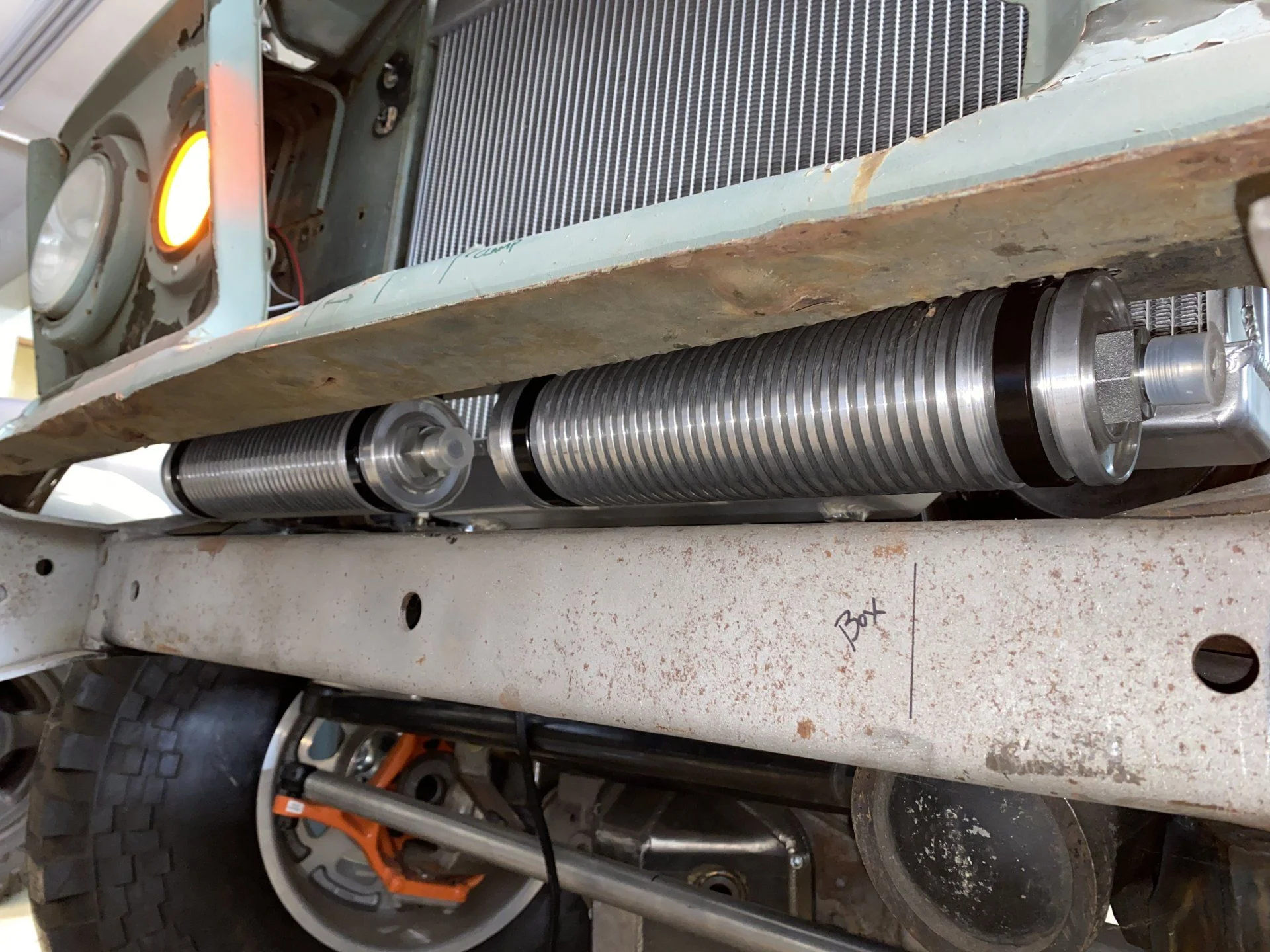

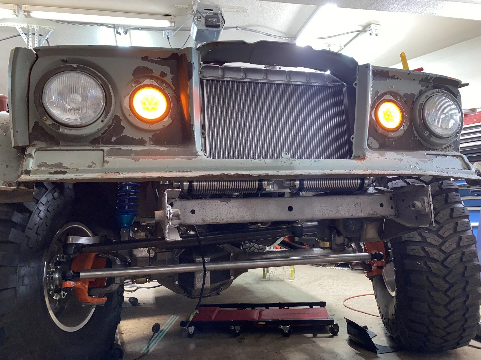

Steering coolers from Howe. If Trophy Trucks run one then naturally the 715 needs to run TWO. Gross overkill

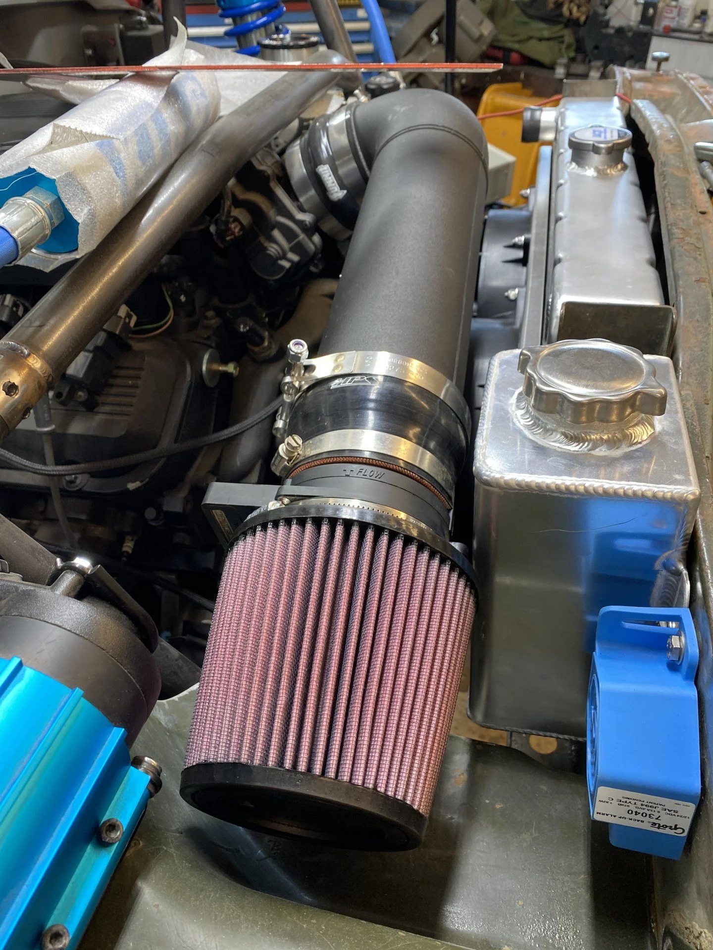

Tucked up nicely but plenty of airflow
K&N filter

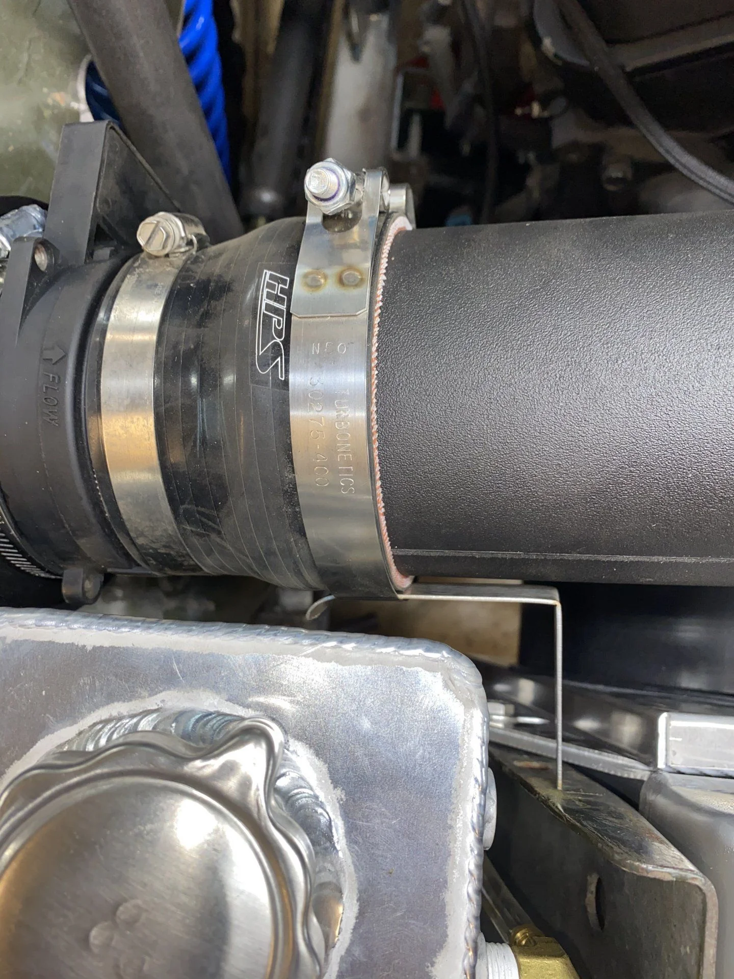

Made a support out of scrap stainless. Just enough to support the filter. Fits good

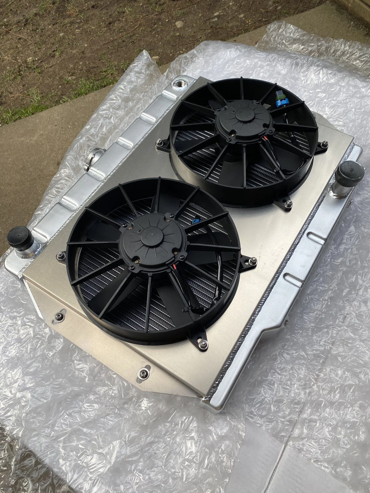

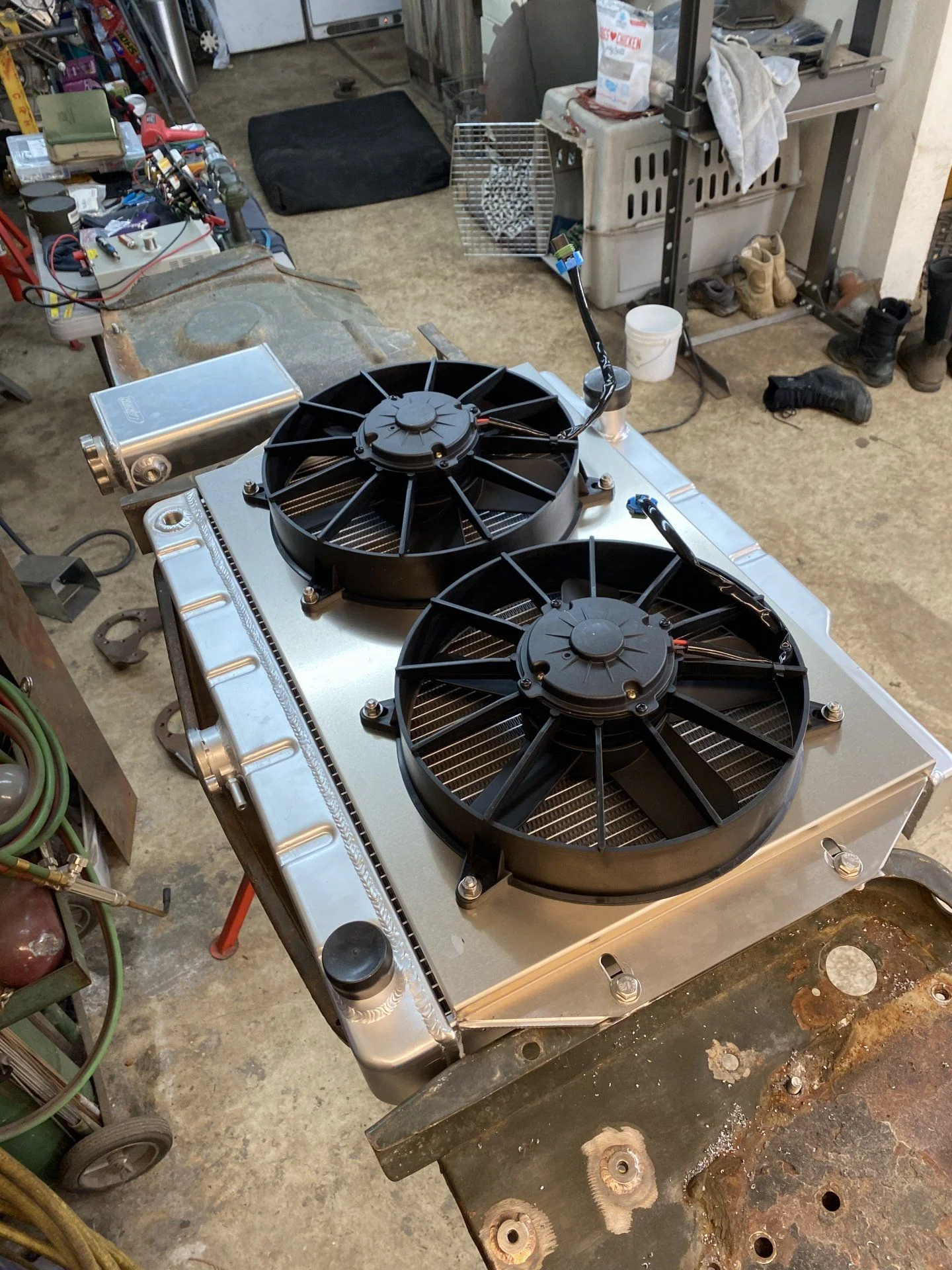

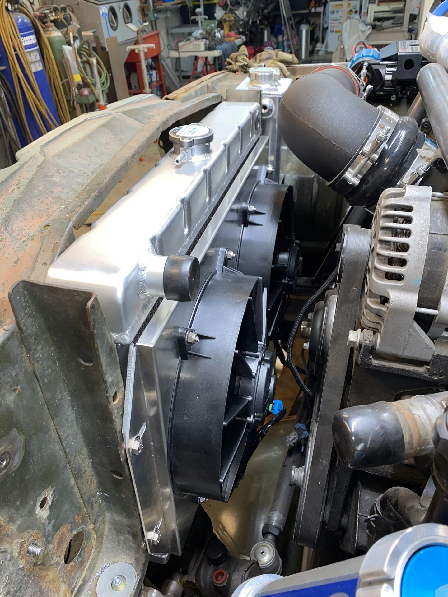

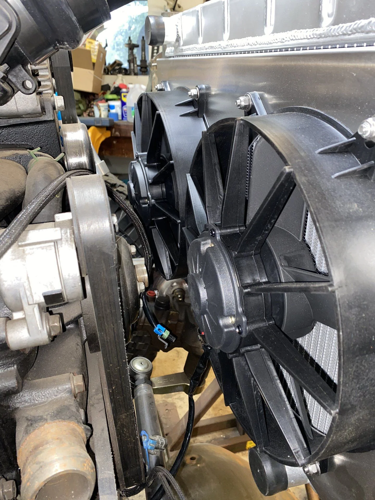

Radiator from Entropy Radiator. Will ultimately be mounted on flex bushings but you get the idea. For a CJ. Pretty close to a direct fit

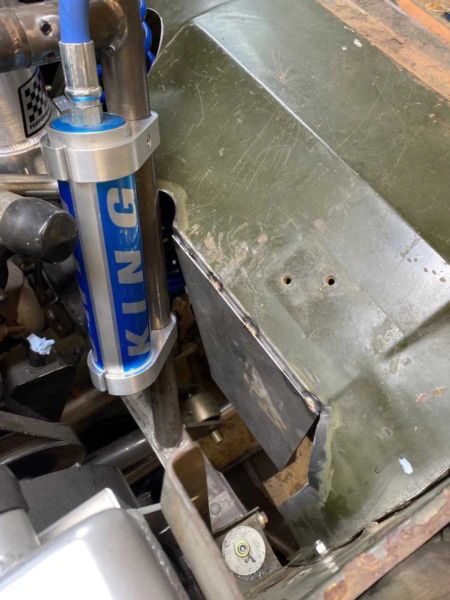

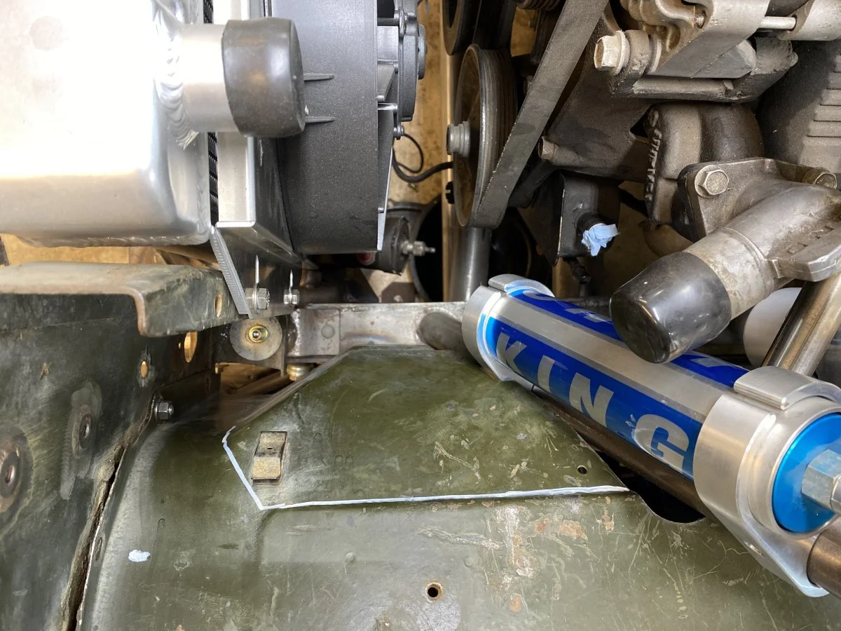

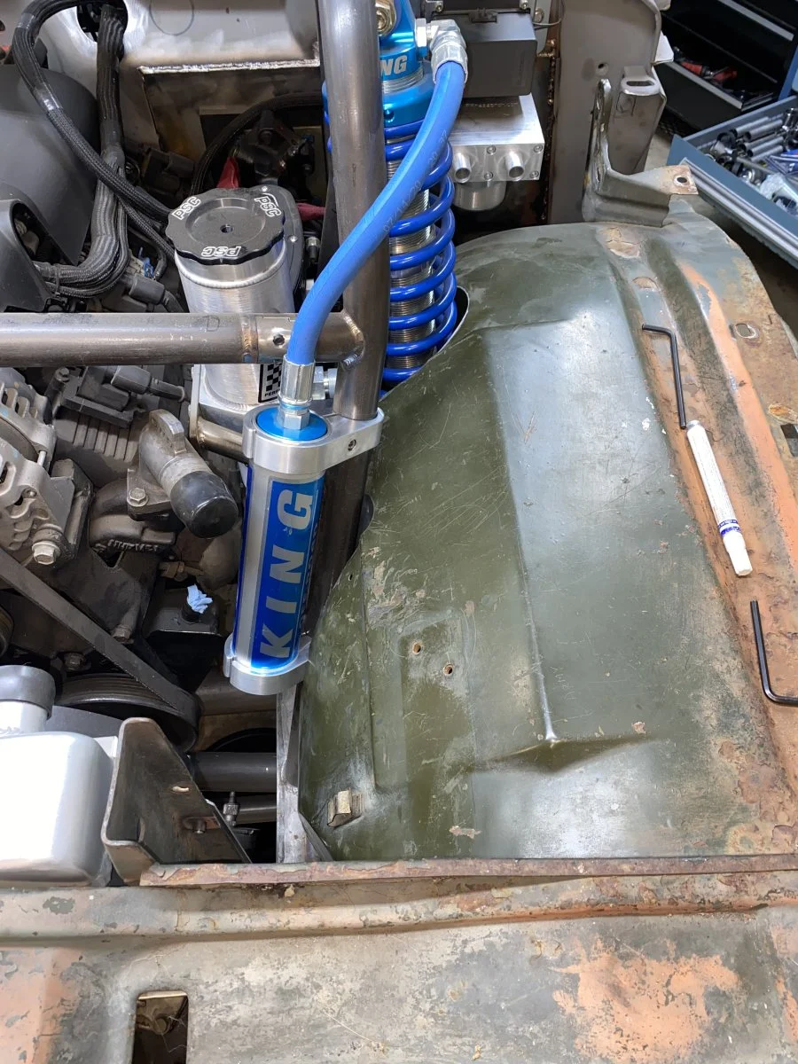

Cutting up the driver side inner fender to clear the coil and tubing

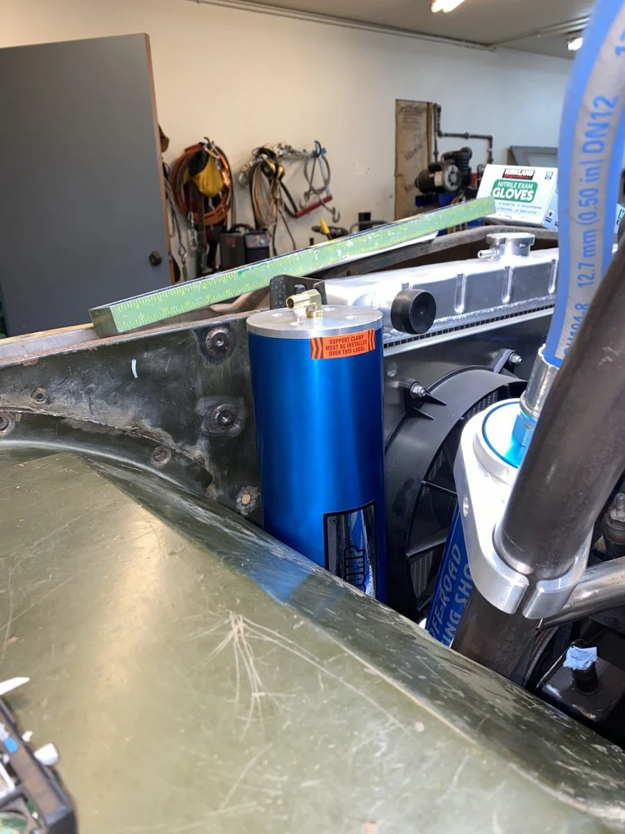

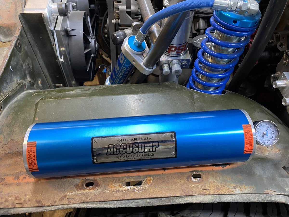

Need to find a place for this 3 quart Accumulator and the engine bay is rapidly running short on room!

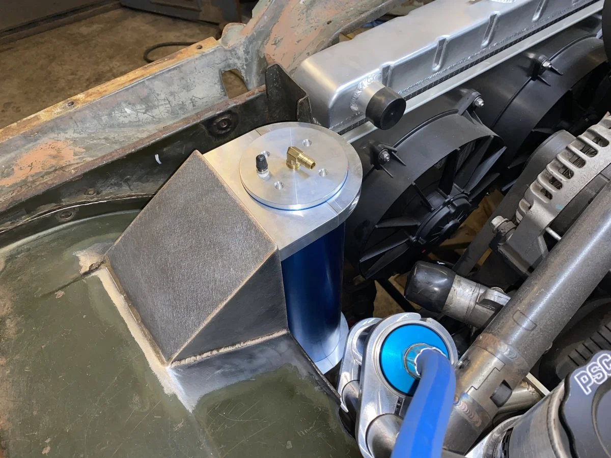

The only place is next to the radiator standing upright. However the inner fender is in the way….so cut this chunk out

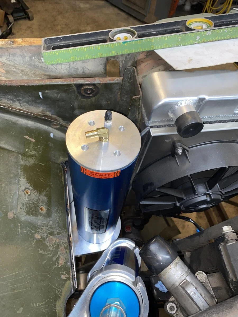

Looking downward prior to making the cut. This is where the Accusump will go

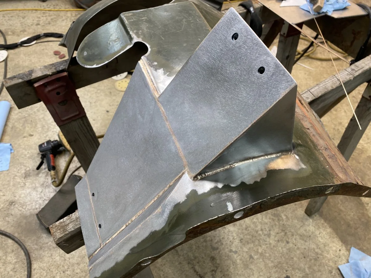

Rebuilding the inner fender to fit the Accusump, using 16g plate
Just tacking it in place for now. Lower clamp mount is installed, I’ll finish the upper mount portion tomorrow

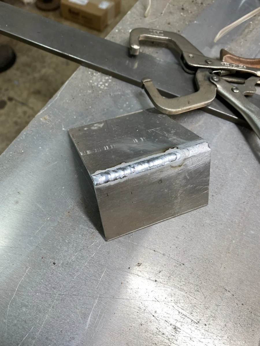

Hammered out the rest of the Accusump mount
Upper mount portion, fully boxed for rigidity.
Welded and sanded

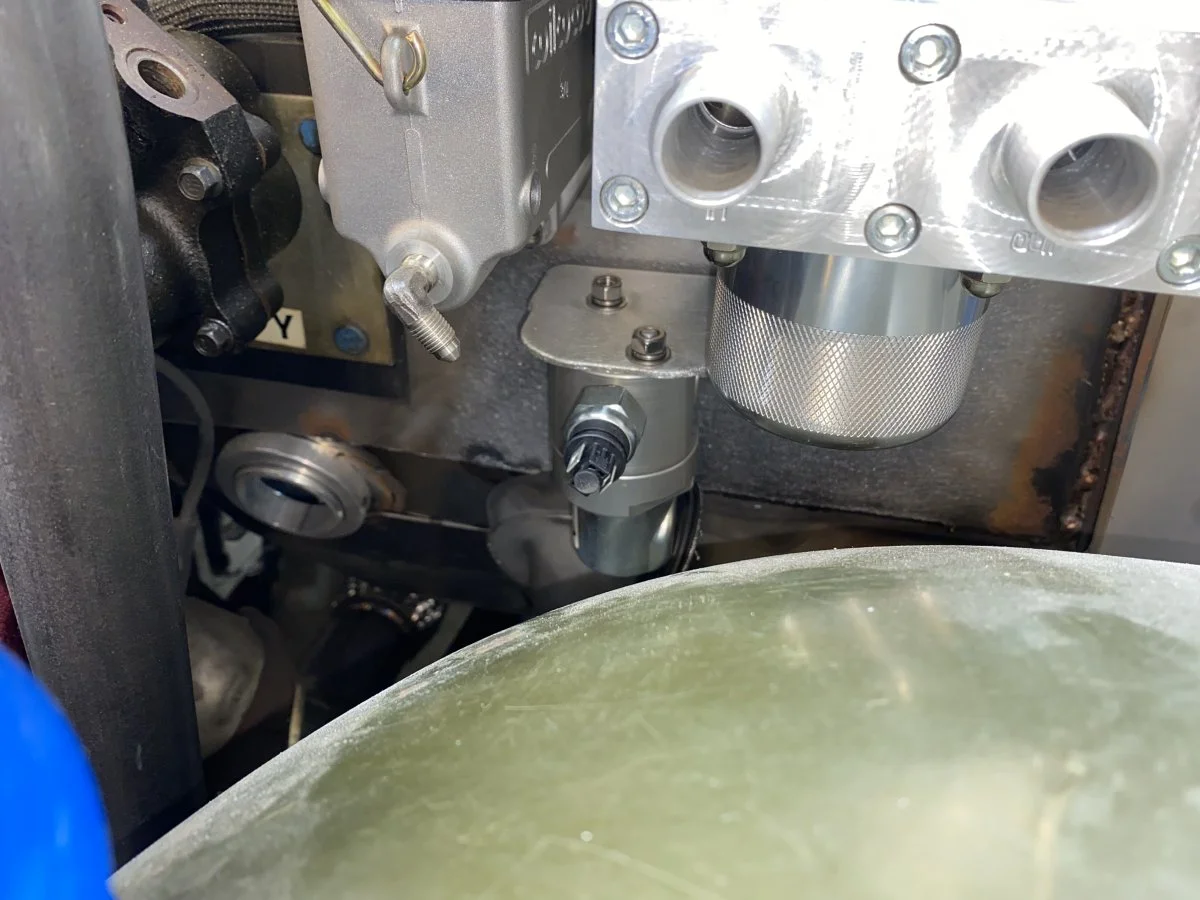

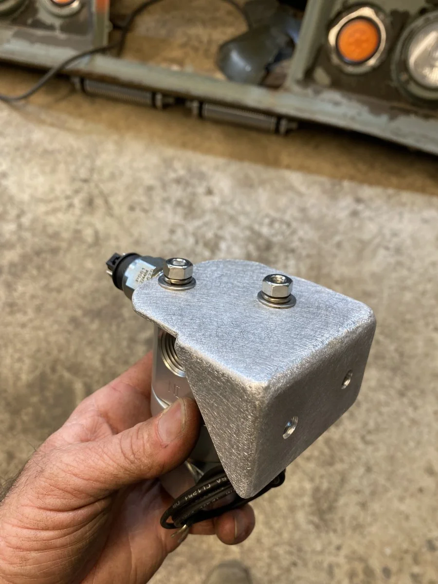

Fabbed up a quick mount for the Accusump solenoid out of some scrap aluminum. The solenoid will release up to 3 quarts of oil into the engine in the event of low oil pressure

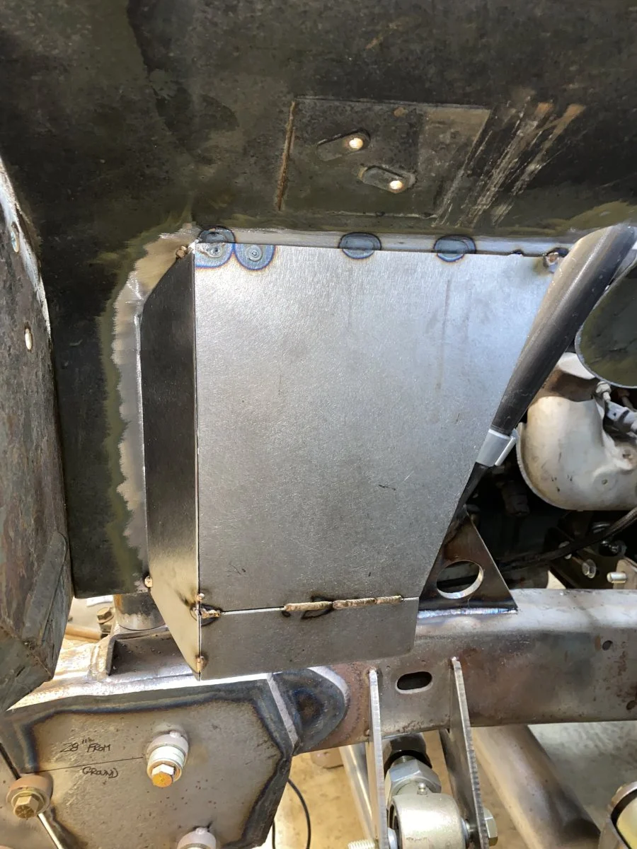

Fully boxed and sanded

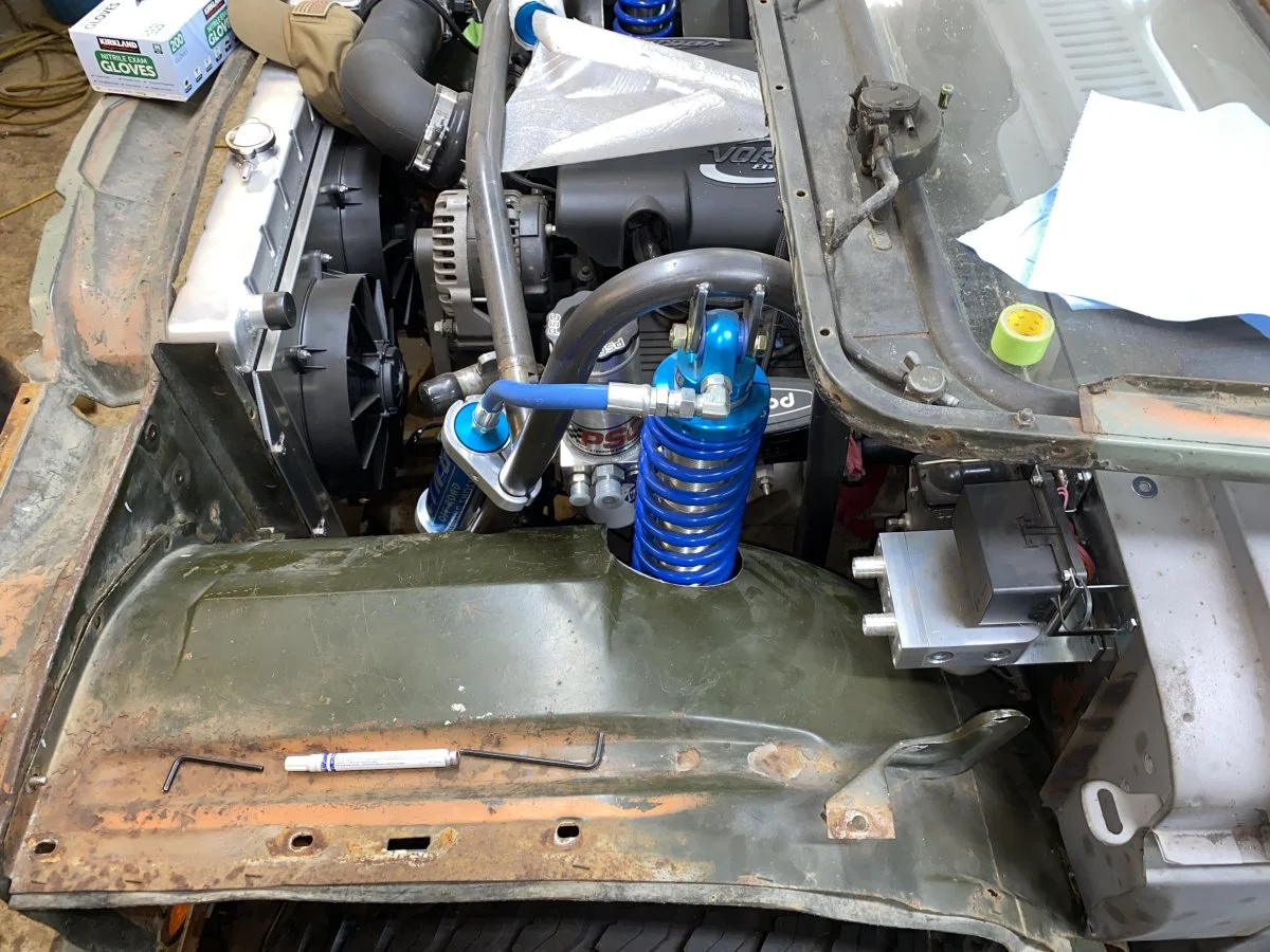

It tucks up between the coolant filter and clutch master

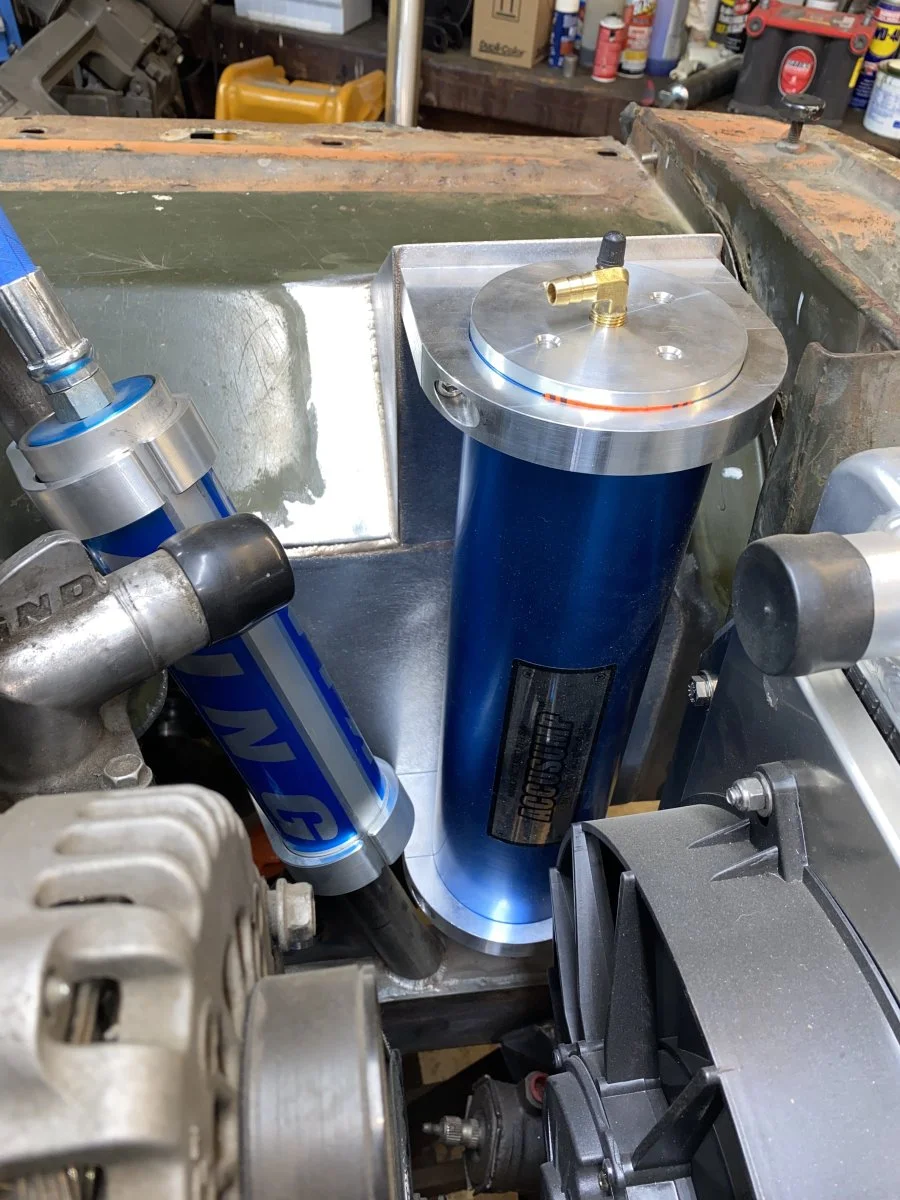

And here’s the fully mounted Accusump. I’ve probably fitted the fender on/off 50+ times, hopefully won’t have to screw with it for a bit now.
It’s kind of a FrankenFender now, ha!

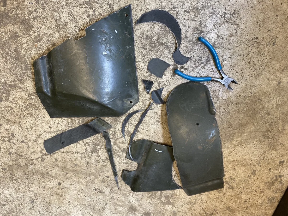

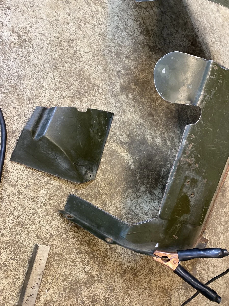

And here’s the pile of old bits. Quite a bit of original fender got chopped off

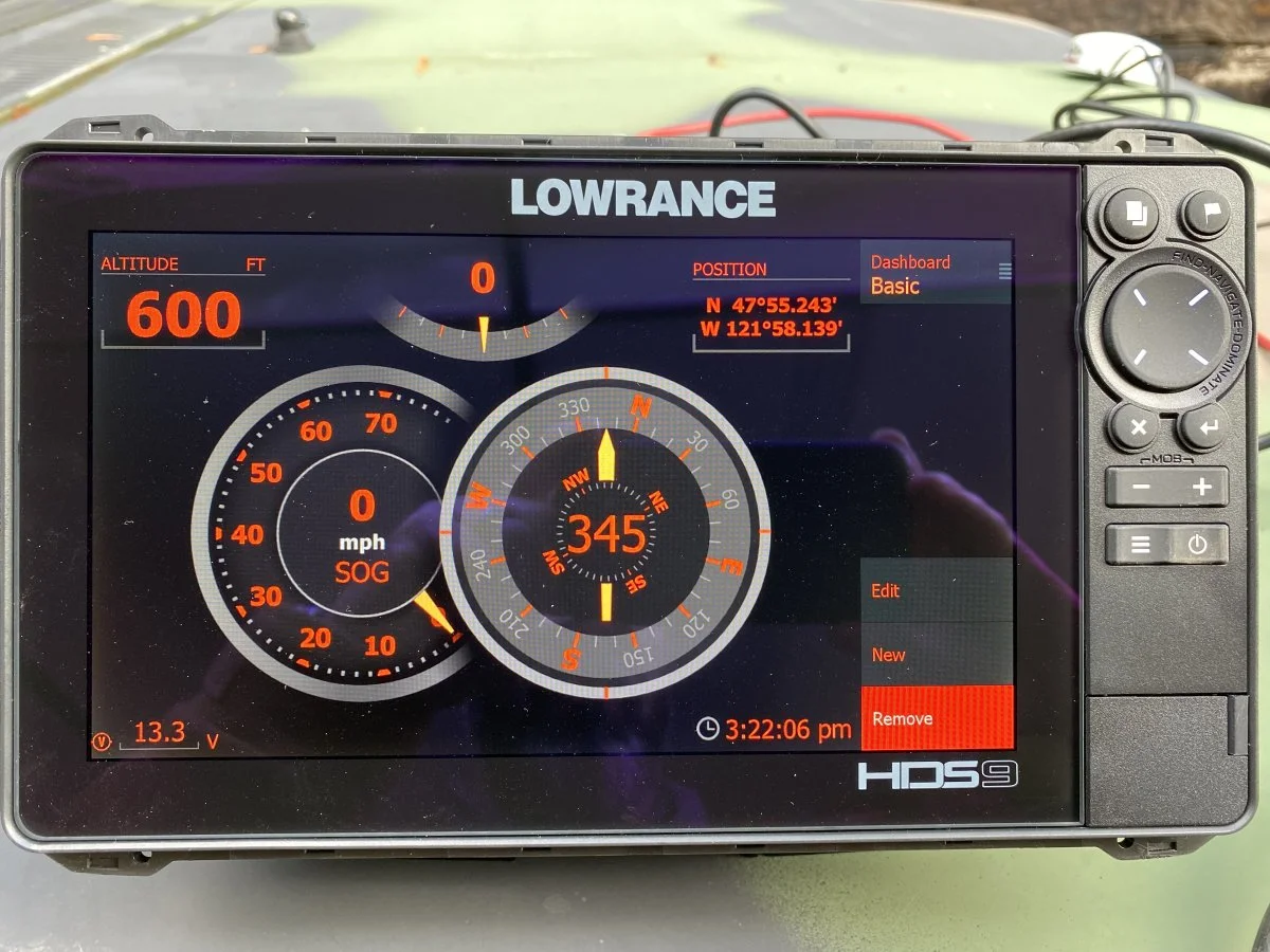

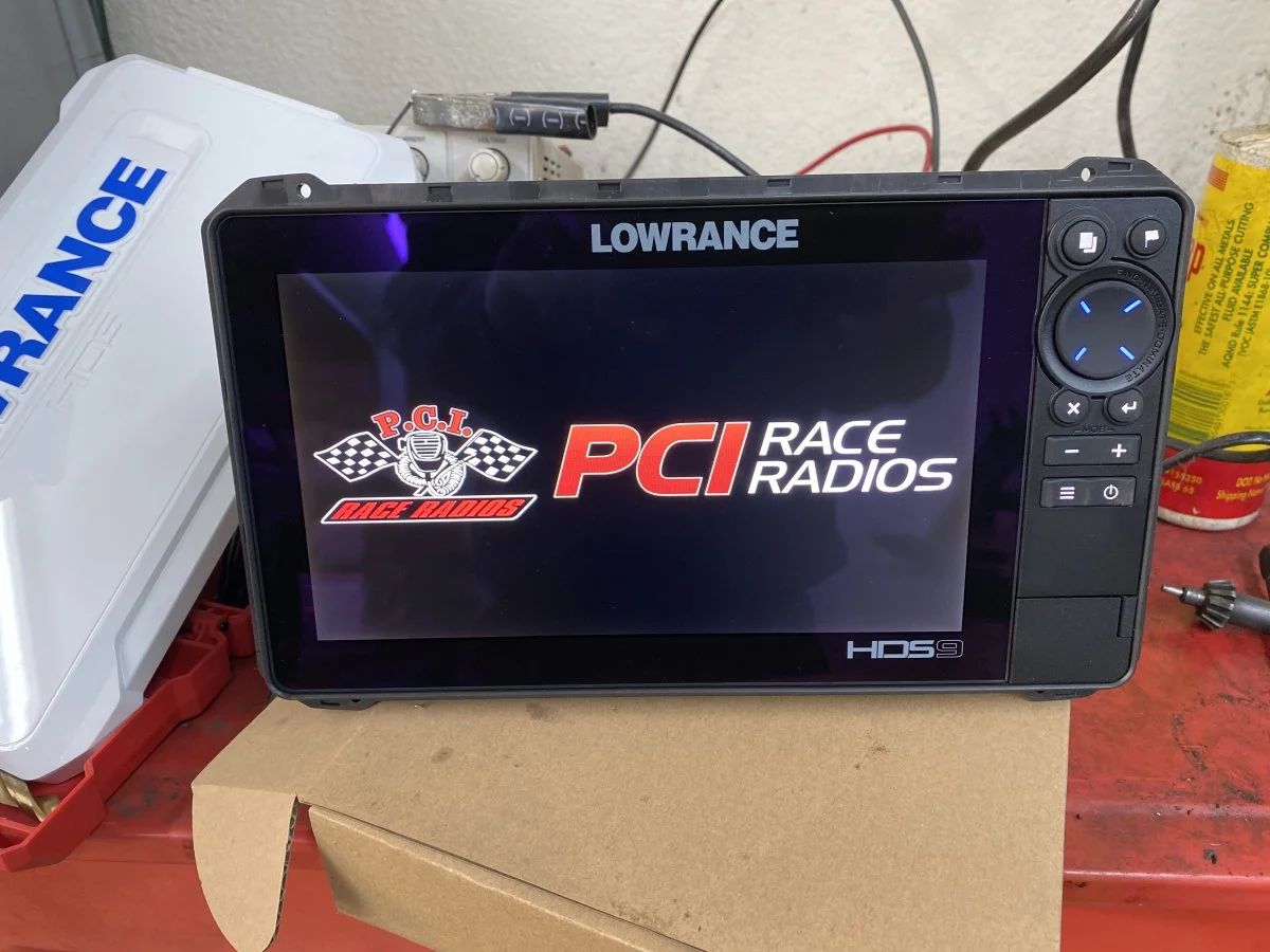

This showed up along with the PCI radio 😄 It’ll be inset into the dash in the next few days.
