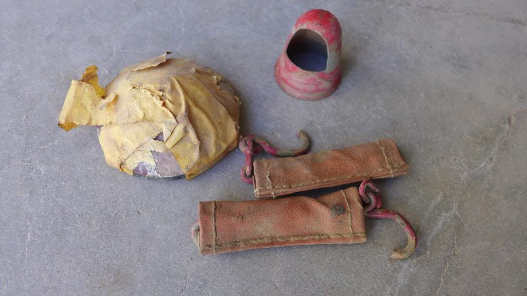

We did our own repairs on the Toyota, so when the dealer went out of business, the owner offered us the shop tools for rebuilding transmissions and engines.
OEM small tail light lens. Door stops and master cylinders.

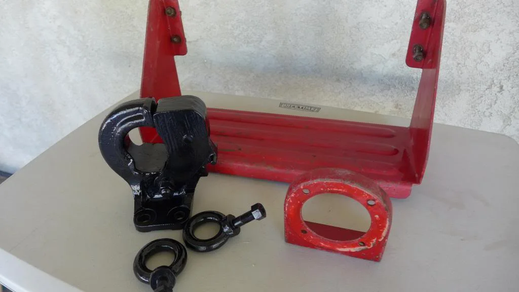

I have the bumperetts and the trailer light plug also. We used a pin hitch, so we took this stuff off right from the get go. The pintle hook and eyes are repainted but the step and trailer light plug bracket isn't.
Not saying this is definitive proof. But it's something.
Step was hard top only and could have a pintle. My 1964 step is black and the bumperettes are body color. Looking at the literature, the early corrugated hard tops, with the tall post, had a step that matched the body color. Short post and later had a black step.

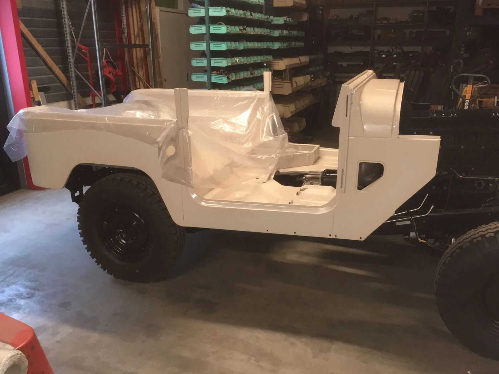

Agreed. I'm happy I found this out in time. Would have painted it black without thinking. But then my dad said: the rear step has to be body color right? "Nooo, or...., well, would it?"
It is on the frame now with white primer and it looks very cool indeed.

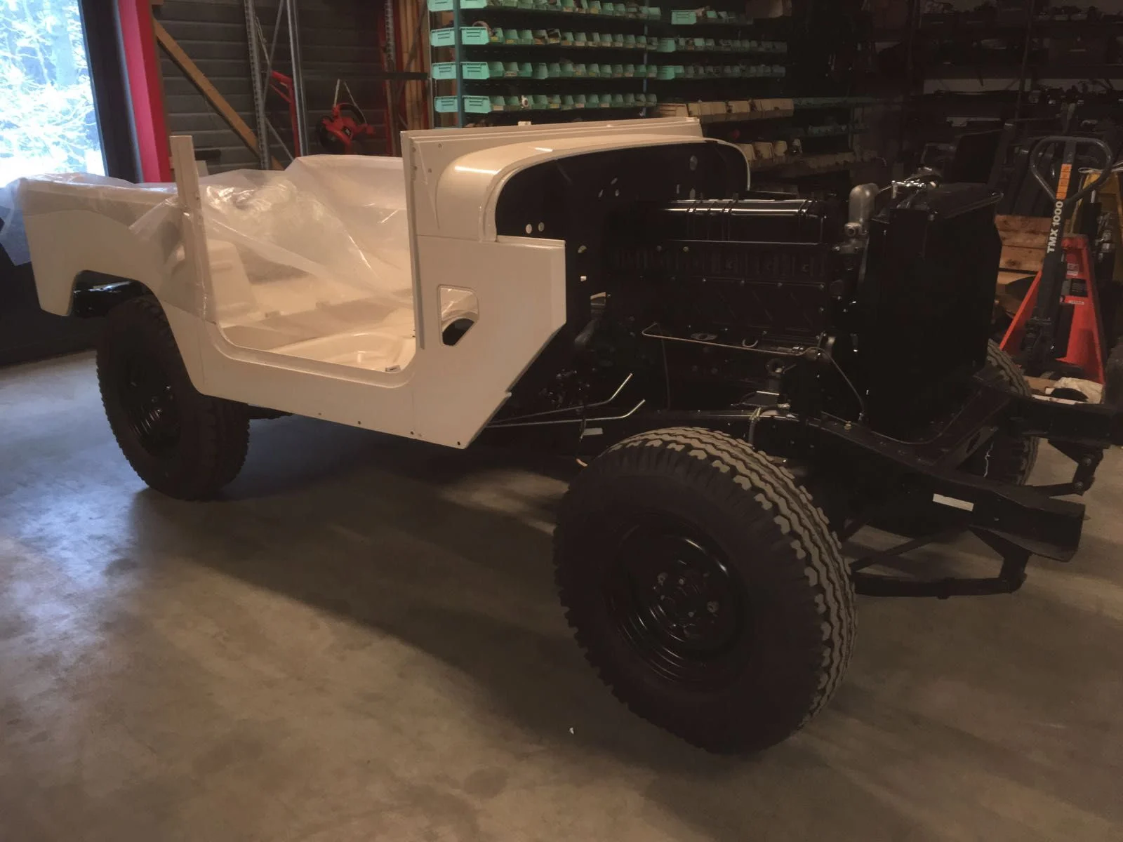

Yeah big steps. While I was busy with the kids at baseball training (yes indoor, snow today in holland) and swimming lessons my dad mounted the tub on the frame today. Didn't see it yet but got this pics from him and had to post it immediately.
Looking Good Paul. Really Good. You must be getting pumped up. Are you going to put in the replica 62 battery and I forget, did that cruiser come with the original front blinkers? Dave
Yes the plans are to mount an old style battery when we are that far. Think I can get that locally.
And we're still looking for dual sided turn signal housings. We do have replica lenses.
