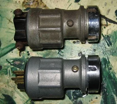

Dean, I usually just get the later whole switch, and pull the guts from it. I think it's cheaper than the guts alone. There is a trick to it though. Or just use the whole switch and change the ring terminals to spade, or find a later model ignition pigtail.

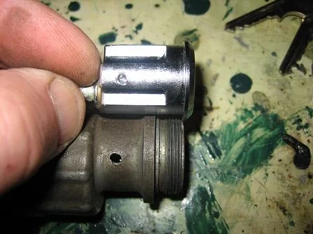

OK, here's some pictures, I didn't look up the numbers. The switch is from SOR so it must be available from Toyota too. 95% it's the '70-72 switch, for $34. The cylinder will swap, but you need to drill a new hole for the retainer screw to match up with. The pictures show the difference. When you take apart the cylinder, make sure you cover the springs for the tumblers, or you'll be spending the rest of the day searching for them.
Don't know if this will work for this switch, which is what I originally intended, but just used a switch in better shape. ;)
