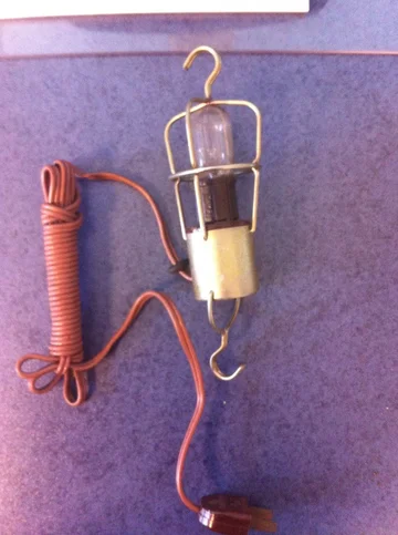

And I bid on a early inspection light on ebay and won :bounce:

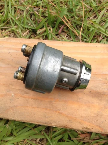

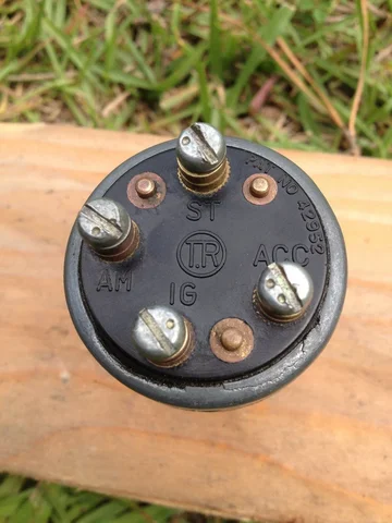

How did your ignition switch wires attach to the ignition switch? Were they attached with ring terminals? Or did the (bare) wire ends simply attach through holes in the sides of the switch terminal posts just as they would on a light switch and wiper switch? Any photos?
As it is now, the switch I have will require attaching ring terminals to the wire ends, which isn't a problem, of course. Or I could drill holes in the sides of the terminal posts and tighten the wires in place with the screws to mimic the method of attachment on the light and wiper switches. Haven't made up my mind yet and thought I would ask how your ignition switch wires were attached before I decide. The picture of the switches from the '62 shop manual you posted in westaussie's thread is causing me to question my switch---as if obtaining another one is really an option!
Thanks. Here is the switch I have. No holes in the terminal posts.
How did your ignition switch wires attach to the ignition switch? Were they attached with ring terminals? Or did the wire ends simply attach through holes in the sides of the switch terminal posts just as they would on a light switch and wiper switch? Any photos?
annie's switch had the wires going into the copper posts with a screw holding them in. no terminals iirc
