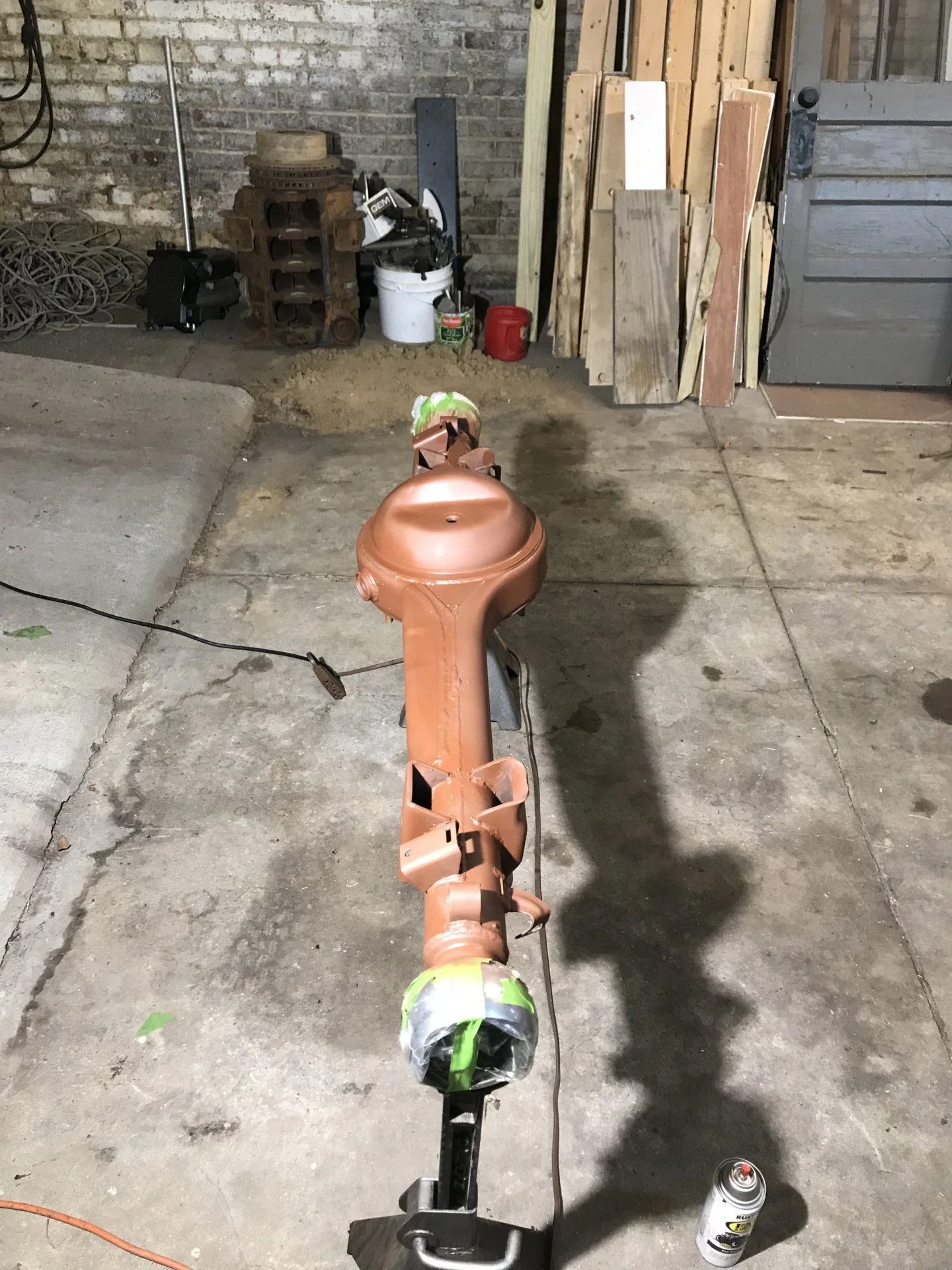

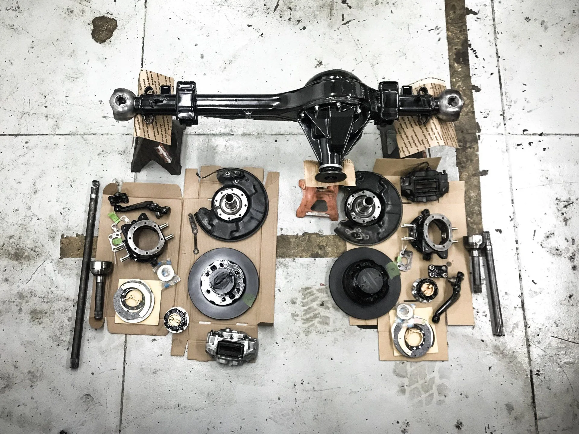

front axle primed and ready for paint.
In the future you don’t need to separate them to grease the birf.
One way to get the birf off without killing that ring is to drop it on a pipe that the inner axle fits into
Slip axle into pipe standing up and drop the two from as high as the axle will allow.
The pipe method is how I separated them. I used the pipe on my 80 series birfs and the ring didn’t break. Guess I have bad luck.
How do you grease the birf without separating them?
You just push grease into them. People make WAY too big a deal over grease and birfs and mixing and this and that.
I hand push grease in until it is full.

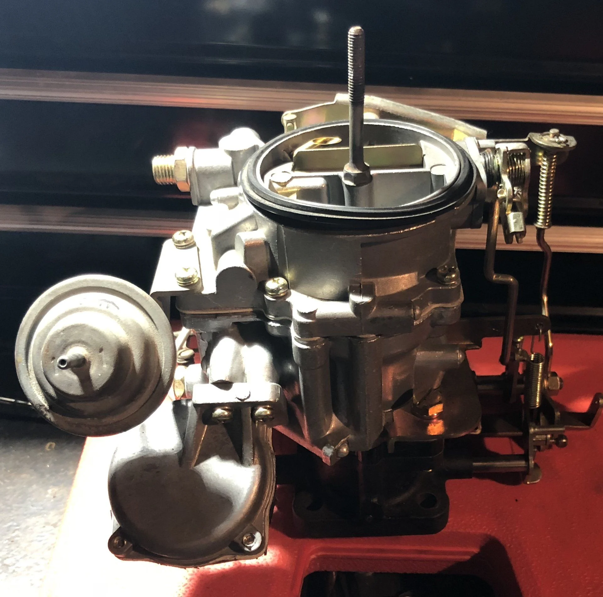

1) City Racer Carb $200

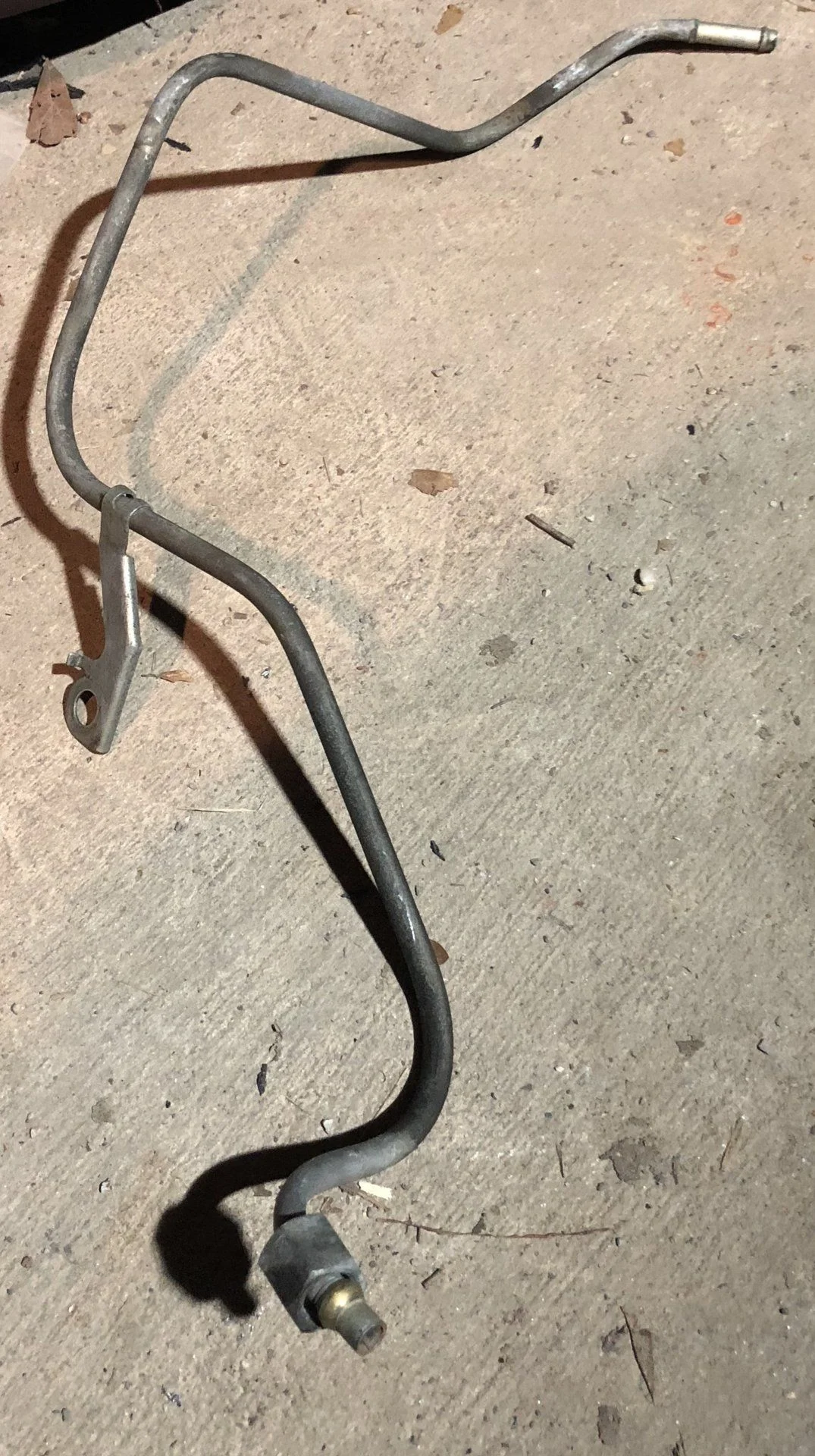

5) Hard fuel like that wraps around valve cover $50

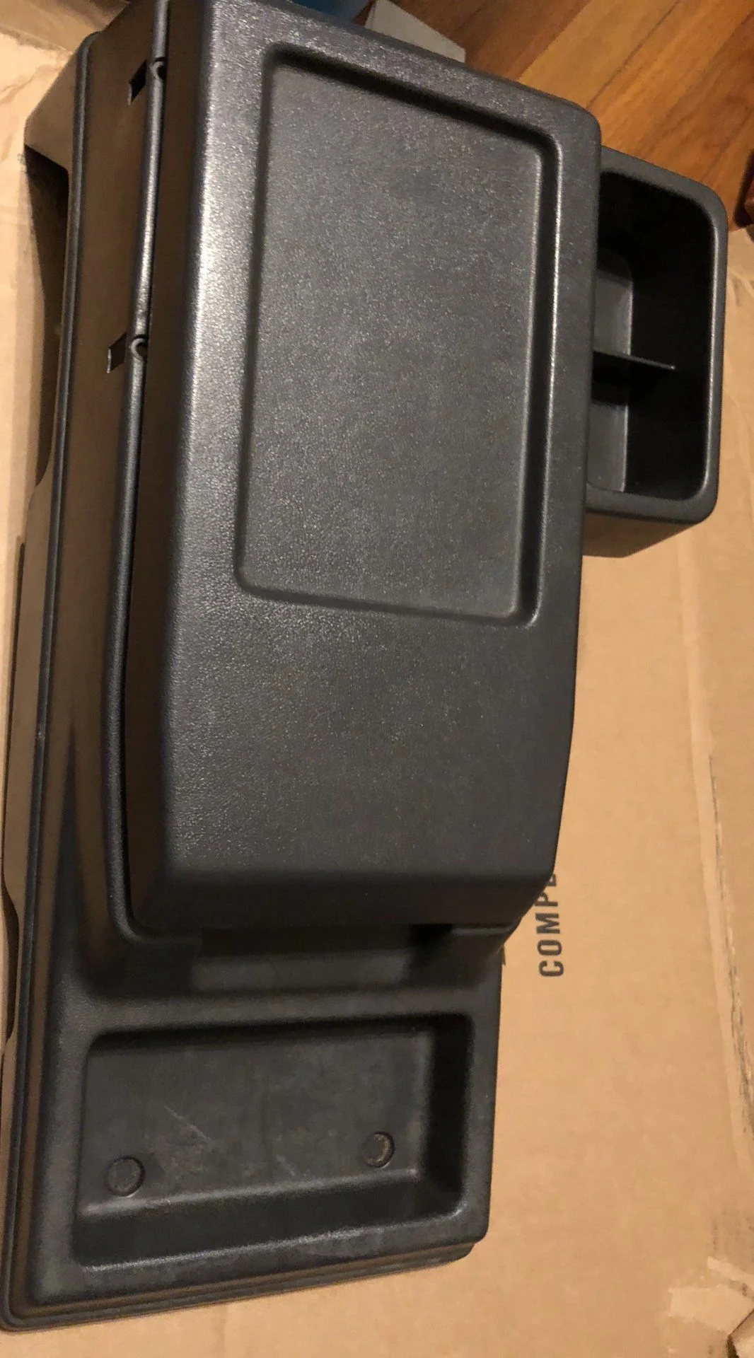

6) crazy clean oem gray center console , no cracks no fading, with cup holder. $175
Fuel line

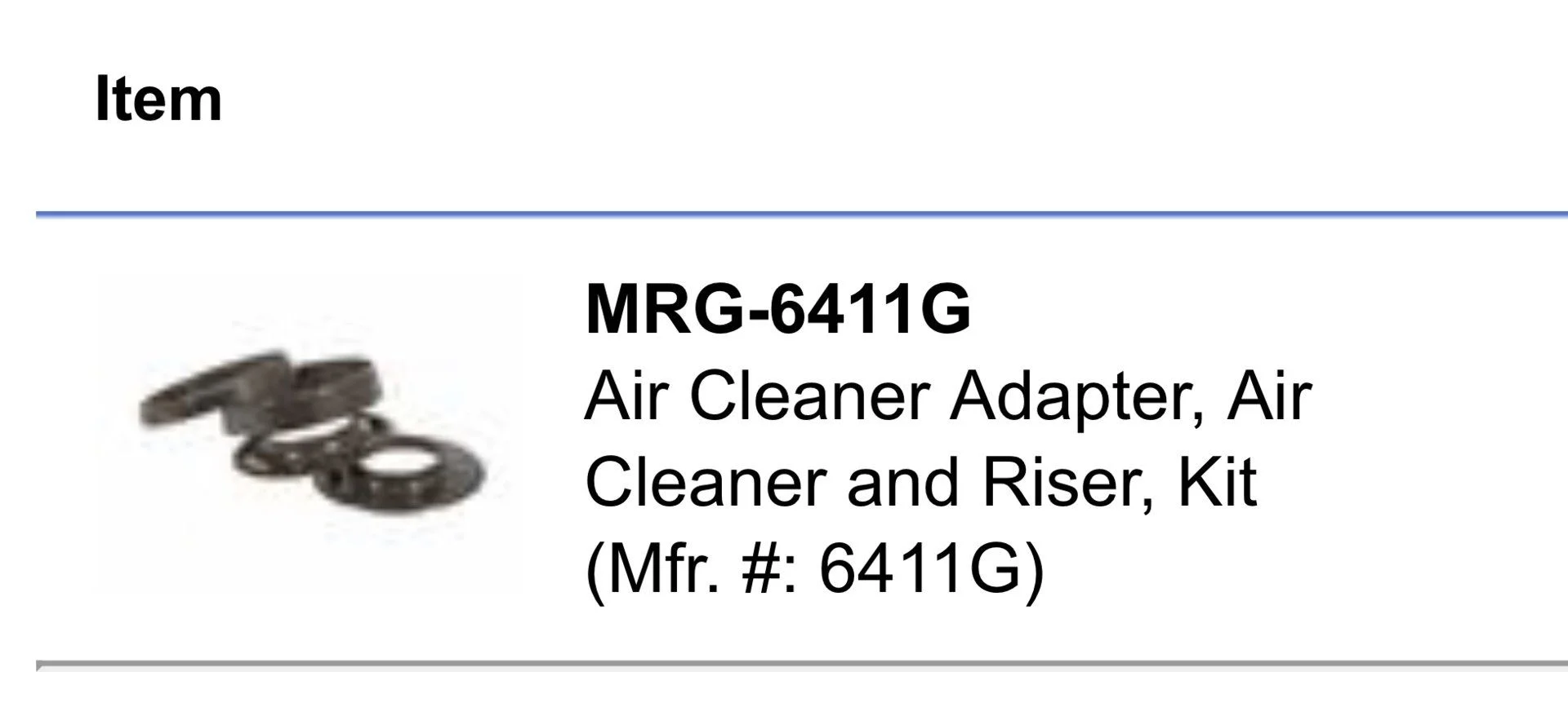

Build thread coming soon, but got the Holley Sniper mounted up and even got the factory air cleaner hooked up! Yes, @wngrog it will get cleaned and painted. 155 miles into the efi and love it!
Used this Mr gasket adapter then had to remove rear and front mounting brackets. Used rear bracket on front and plugged back mounting bracket hole.
