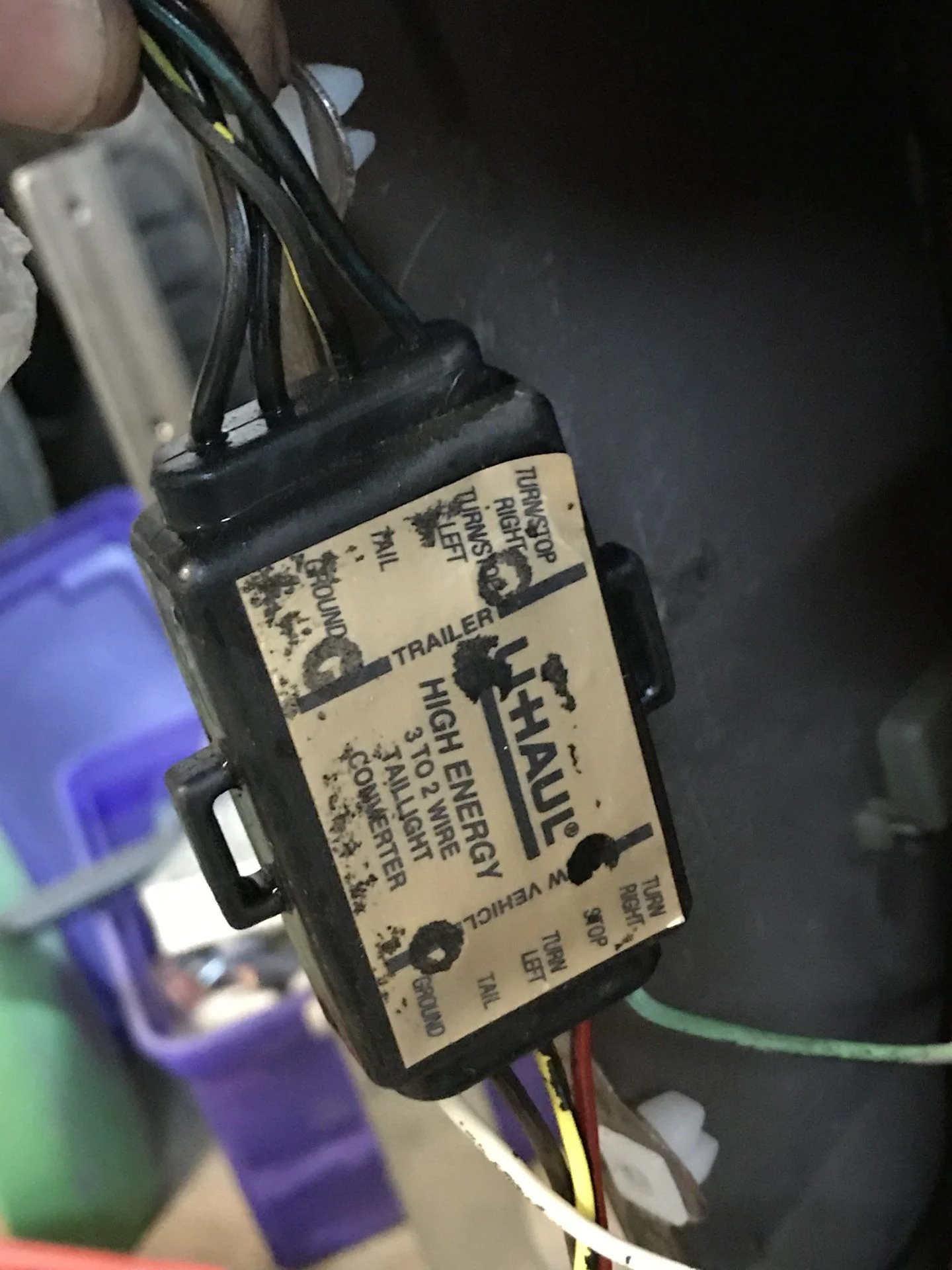

Those that have installed trailer light harnesses into your 60, how did you wire it in to the factory harness? Mine has a wire harness one of the PO’s installed but it’s not working correctly; only the tail lights work, no brakes or turn signals.
How it’s spliced in at the driver side tail light:

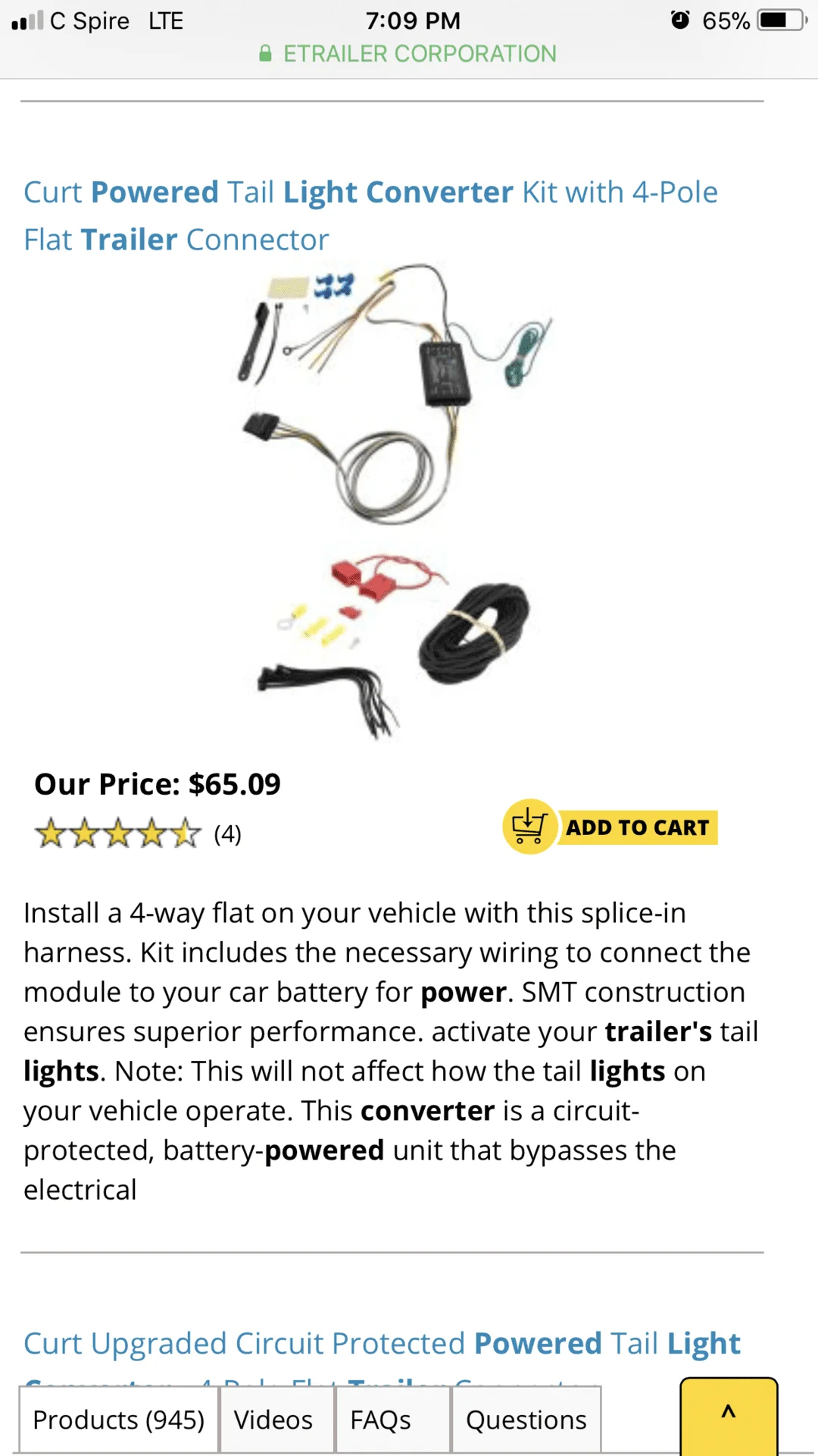

Are you using a tail light converter? If not it’s not going to work properly. I recommend using a powered tail light converter like the one in the pic below. I use them on all of the older cruisers as it is completely stand alone and doesn’t put a strain on existing wiring. Still needs to be spliced in to activate. Install is pretty straight forward.
Yes, it has a tail light converter. It a u-haul one but looks pretty much the same. I have a pic of it but keep getting error msg when trying to upload it.
And I have tested the trailer on another vehicle to rule out that.
I searched all 4 auto parts stores in town tonight an none had a converter that had a dedicated 12v power supply.

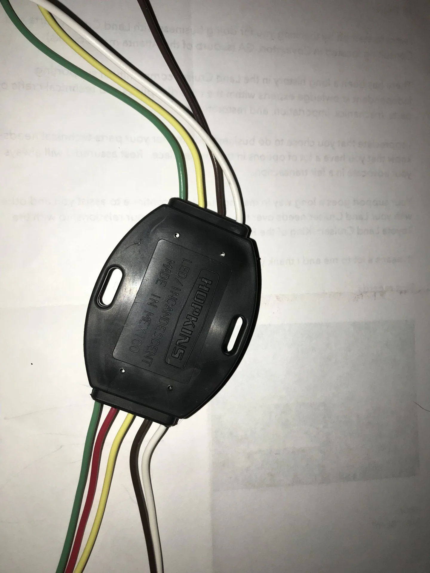

I picked up this cheap Hopkins one to see if it will work. I’m trying to get the trailer lights working on my 60 by Sunday when I leave on a trip in it pulling a trailer.
My guess is the one I currently have has just gone bad: as I’m getting power from it, it’s just not sending signals.
