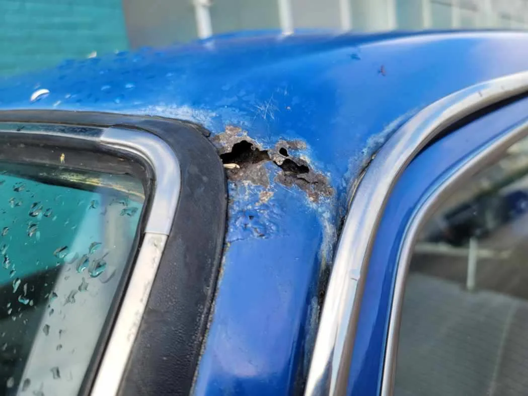

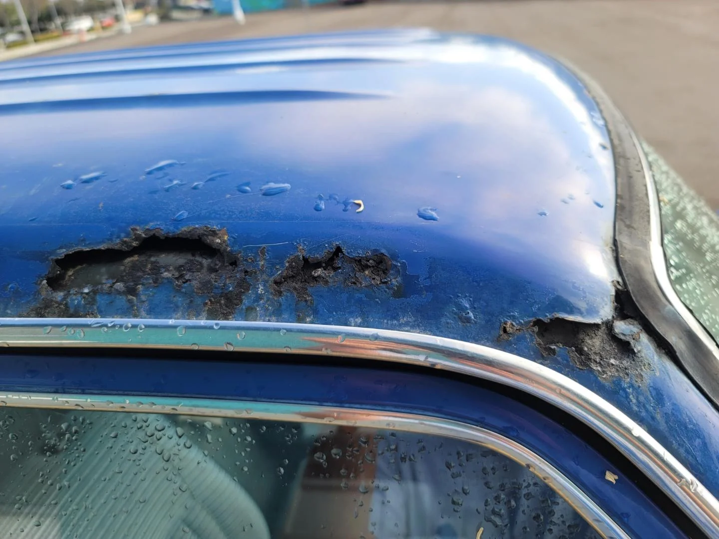

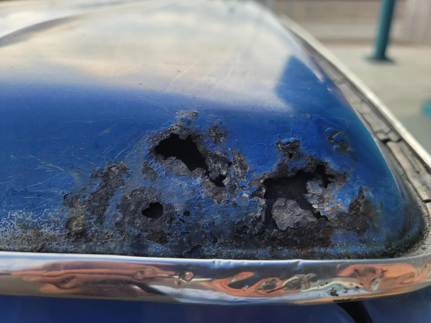

Found an FJ60 locally for a great price. No rust except for the roof. How expensive is this repair? Is it even worth it?
You have a couple options to choose from. I would say the rust/holes in the roof go far beyond what the eye can see especially if it has been left out in the rain. I would find a good body shop close to you and have them look at it to see if they could give you a rough estimate on what it would cost to repair the rust. Another option would be finding a donor FJ60 that has a rust free roof and have someone cut your existing roof off and replace it with another one that is free of rust. Your third option and most cost effective is treat the areas of rust yourself and just patch it up and drive it as is. What you really need to ask yourself is how much are you willing to spend and proceed forward after that.

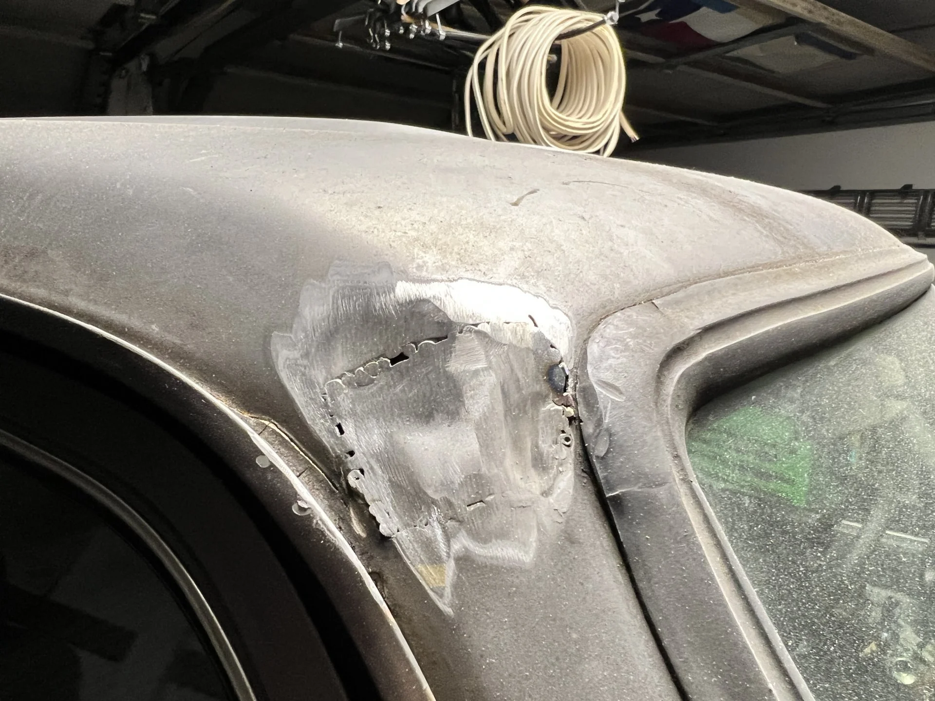

I fixed mine myself with very little welding experience.
A little 153 rattle can action and it’s good as new.
If I cut the roof off of my truck, there’s no way I would have ever finished it with the amount of little things you have to do.

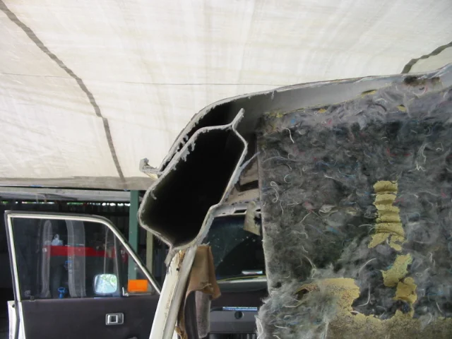

I vote for fixing it yerself. We can't see the extent of damage to the outer gutters though with the chrome strips on. They did this repair in Nepal.
You’ll notice the guys in Nepal removed the headliner and insulation. That’s an absolutely critical step to avoid the high risk of burning your cruiser to the ground. That insulation is very flammable.

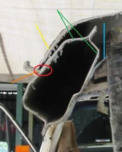

For info, here is a pic of a cross section cut of a 60 series roof. This cut is through the rearmost side window area.
Rust here usually isn't from failure of the external gutter seam-sealer (though that won't help), but from moisture settling onto the unsealed/untreated metal inside the roof section where there is a sandwich of at least three pieces of metal. Sweat, moisture from your breath and condensation drip down into the area marked in red (humans are filthy creatures......).
Orange points to the gutter section which is a separate piece of steel inserted and spot welded in place.
If you are squirting in a rustproofing agent, make sure you get it into the right place. I've seen a few where the gunk was only applied over the lip shown in blue. From memory that's only there to hold the headliner tensioning wires.

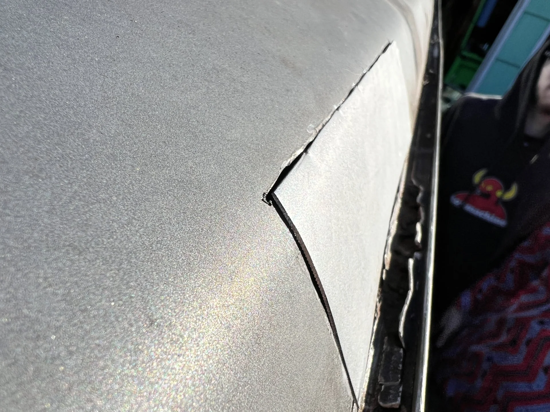

And when I had my 60 repainted, I had the shop cut a piece out of the roof gutter at each rearmost corner to help with drainage when parked slightly nose-up. It was covered by the chrome strip and probably completely unnecessary given what I've written above........:)

Ahaa….there’s the pics of the roof cross section!! Been looking for those forever and couldn’t find.
Thanks for posting these.

what a huge design flaw and why we see soooo many 60s with roof drip edge rot. Nice detective work!

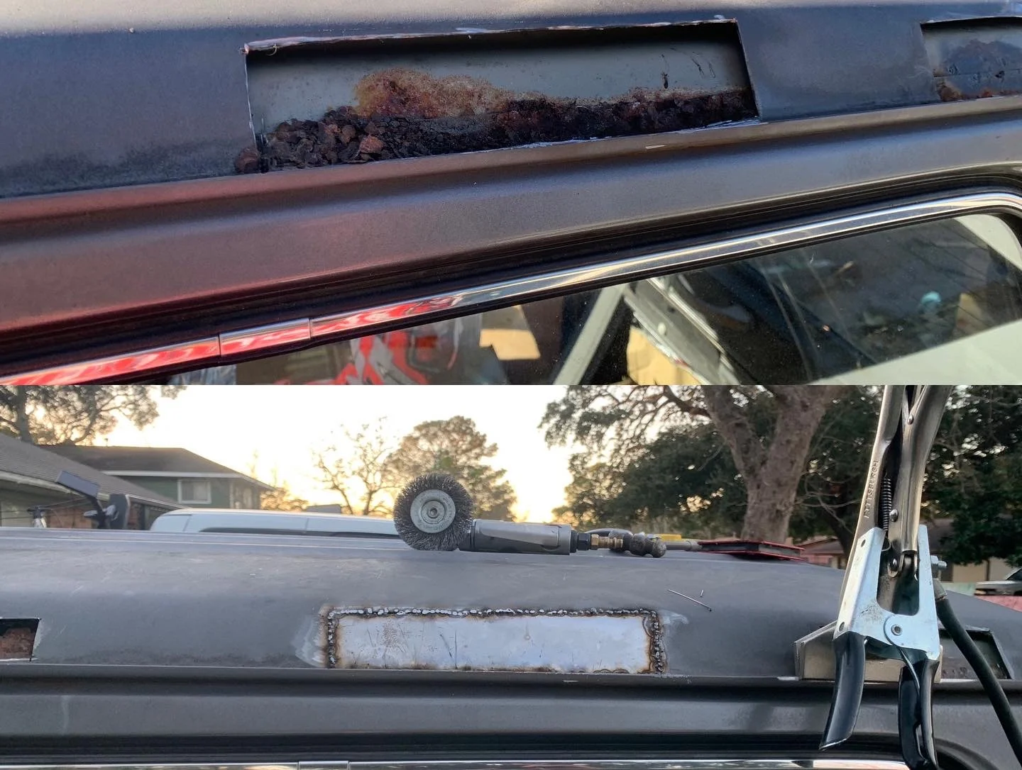

That is a huge job. What you see is most likely the tip of the iceberg - the real rust issue is between the gutter rail and the box section on top of the side members, and fixing the roof skin in patches from outside is tnot going to help that. Have a careful look all round under the gutter / drip rail and if you see rust coming up alongside the seam sealer... you are in for a lot of work.

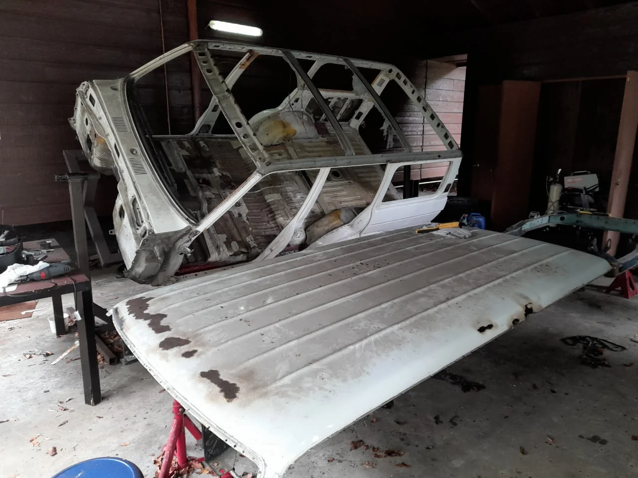

If you have that degree of rust, in my opinion there is only one way to do it properly (my picture). I had two small holes in the roof skin along the left-hand gutter, but also two rot holes under the gutter. above the rear left quarter window.

I think stripping the roof skin off and getting all the areas that were untreated from the factory and patching all the sheetmetal that is already too far gone is the way to go too. Even on trucks not yet showing external rust damage, it seems this type of work will be needed at some point due to the shortcuts taken during the initial manufacturing process. Great to see more people doing this level of work and pioneering the path for those of us who will need to do it in the future.
