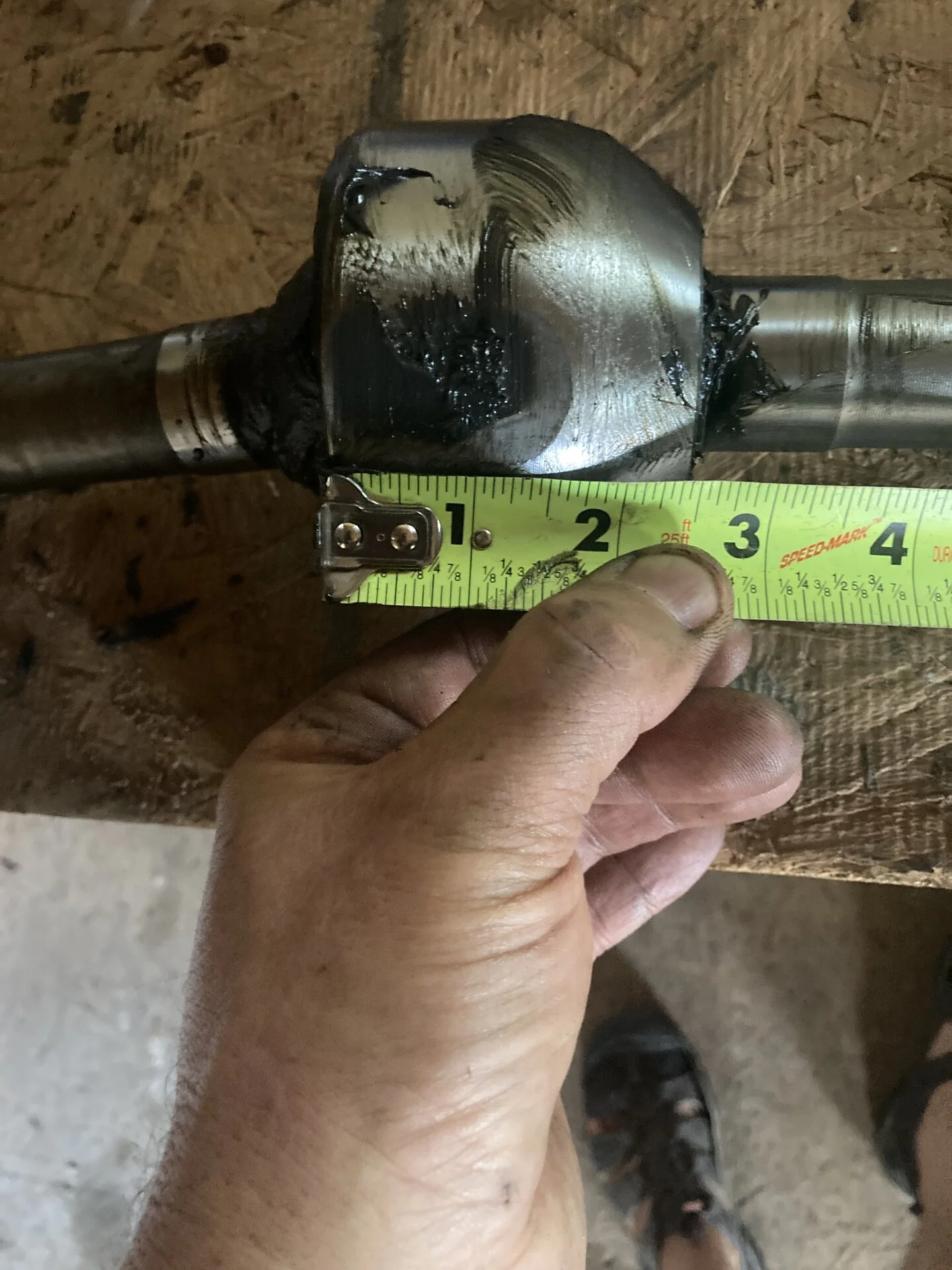

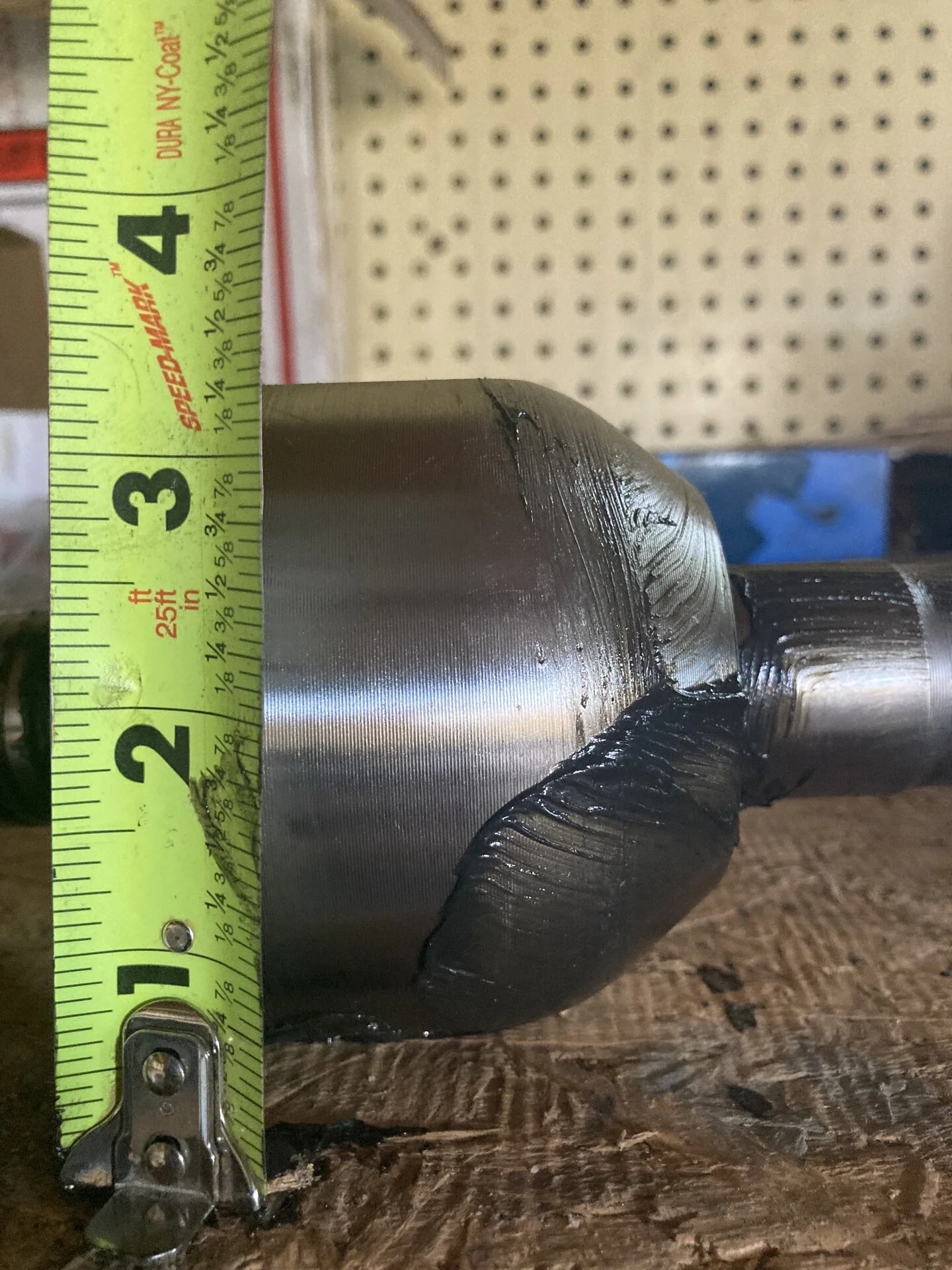

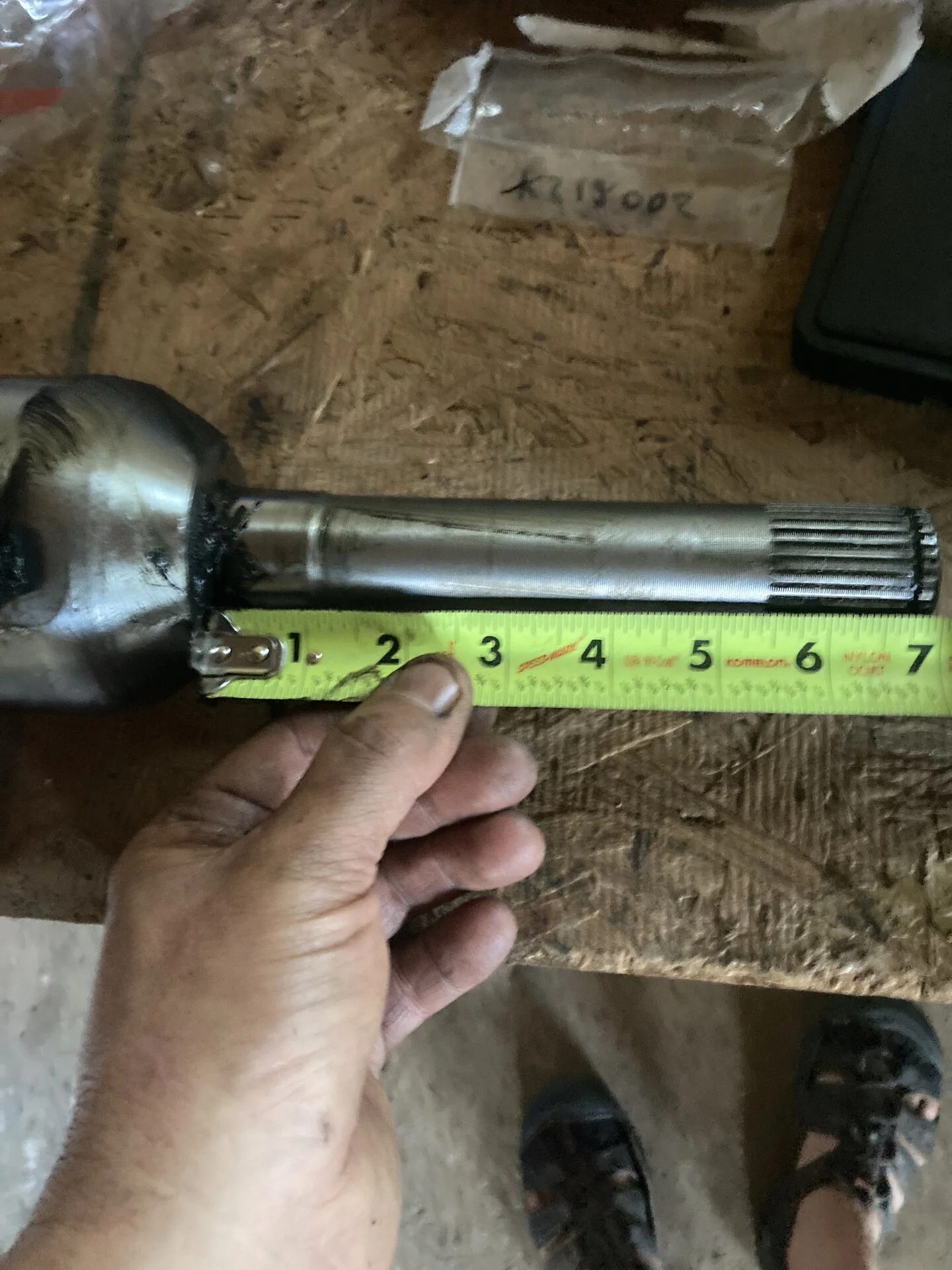

I have a passengers side spare, but I’m not sure if it’s for a 60 or late 40 or if there’s a difference between the two. Can you post or PM me the diameter of the joint and outer axle distance out from the joint?
Post up the length.
These are the ones I have. I could measure with calipers this evening if necessary.
I will pull the short driver side axle later today once I get over the grief of my mistake. and all of that well placed grease and torque that needs to be redone.
The FJ60 Birfield should be the same across a number of vehicles. According to Yota Masters, it should be the same across a whole series of vehicles.
10 × 4 × 4 in - 27 spline at the birfield end, 30 spline at the differential end (how you count these I have no idea)
4Runner 1984-1985, Hilux / Pickup 1979-1983, Hilux / Pickup 1984-1985, Land Cruiser FJ40 1969-1984, Land Cruiser FJ60-FJ62 1981-1990
