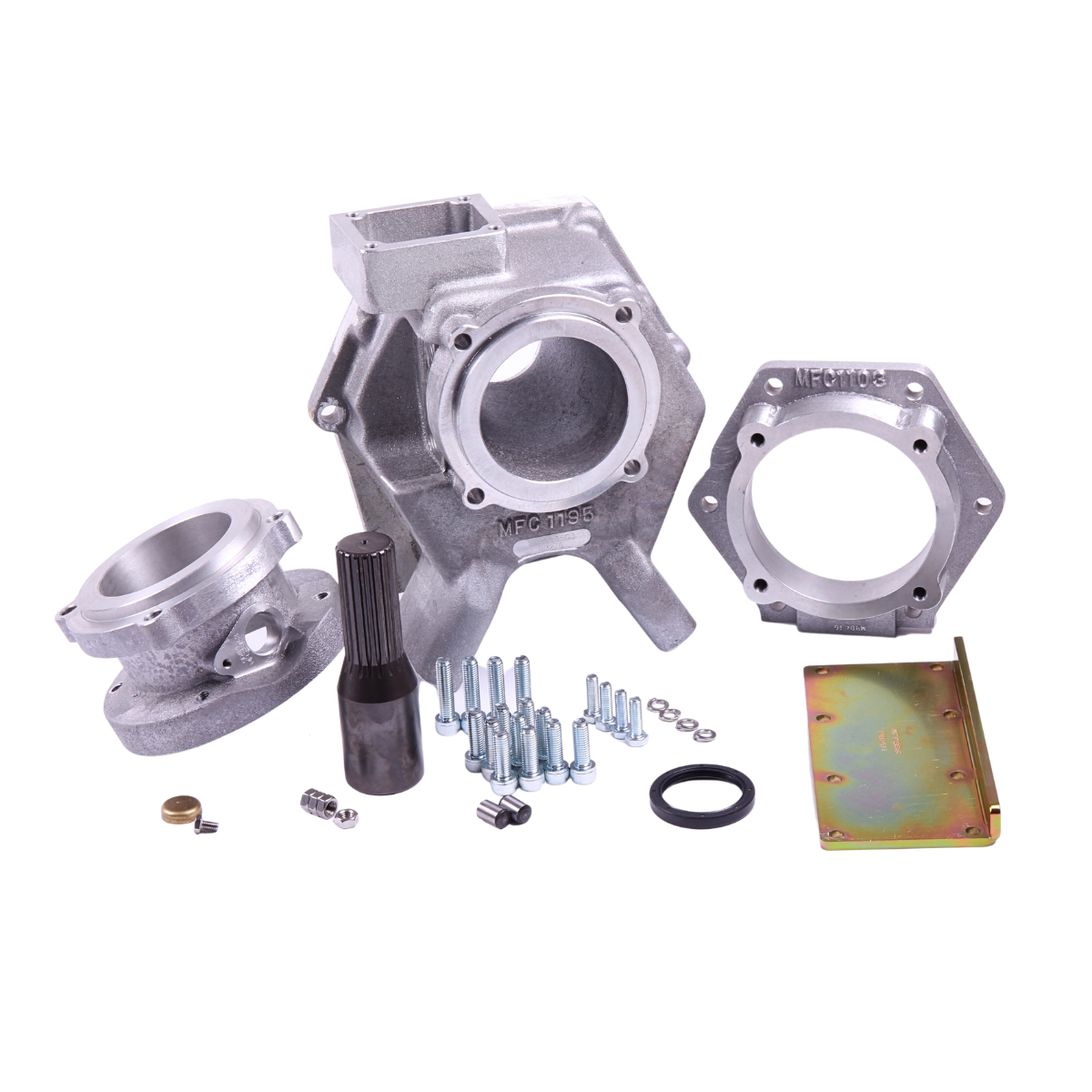

I think the design of the AA adapter is wrong and either the spud shaft deflects too much or somethings not lined up. @Dubs2017 and I have found nothing but people with the exact same problem as me. Whining over 25mph accel/decel. Mine is really loud and also makes like a chattering noise. Mike Burroughs from stanceworks even posted here in 2017 with the same issue with his set up

So. Something I noticed. I pulled the marks adapter kit instructions and the advance adapters kit instructions. It looks like the marks kit comes with shims and also a shiny metal ring that the AA kit doesn’t come with. Also the AA instructions say to press the adapter bearing into the Tcase housing. The marks kit says to put it into the tcase side.
I’m thinking that advance adapters instructions are wrong. And also they aren’t supplying the full kit from marks.
Yeah dude the bearing goes into the tcase not the adapter. The AA kit is missing a spud shaft spacer and a shim for the spud shaft. It’s also missing a spacer for the Toyota bearing on the end of the tcase input.
AA is literally ****ing us all over. Bad instructions and missing parts
I’m going to try calling marks to confirm before fully calling an AA failure but dude all signs are pointing that way
The adapters are machined differently. AA machined to remove the need for the spacer and shim.
Look at the 6/4 bolt adapter. AA has internal machining for the main adapter to recess into. Two different animals, I went through this a couple years back. A few I know in AUS have whine issues as well.

Ahhh yeah im literally on the phone with them at marks now. We looked at both the advance instructions and theirs and the spud shaft cut off length are the same so in theory flipping the bearing on the Advance adapters wont cause any spline problems on the spud shaft.
He was saying they provide a bunch of extra shims in his kit to get the preload and backlash into spec that advance doesnt include, and his trans mount bolt holes definitley line up unlike the AA kit. Theyre definitely different castings. I think i saw Cameron Mosley pressed his adapter bearing into his tcase side as well at some point before i did my swap. I wonder if flipping the bearing would help or hurt anything.
The guy on the phone from marks thinks that it sounds like my tcase is tryng to pull its self down off of the adapter under power.
The reason i started looking at all of this is because i was looking at 4l60e output shaft cut off lengths for the 80 series case adapter.
Unfortunately if i want to use that adapter and case, ill have to get a new transmission because the outputshaft from the 4l60 needs to be longer for the 80 adapter vs the 60 adaptaer

You can just buy a new 4L60 output shaft too.
I looked back, looks like Cameron got a Marks kit from AA. I guess they were selling Marks kit a long time ago. Looks like that rabbit hole is a dead end
HF2A is the way to go. I too had the dreaded split-case whine behind my 4L60 and AA adapter. I rebuilt the case and it was still there.
Finally went with a 6L80, Marks adapter and HF2A and it is silent. It has a part time kit and uses the center locking actuator for 4wd/2wd. Works really well. I would imagine it would be the same deal behind a 4L60.

I think way down the road the plan is to swap to a 4l75e. I guess HF2A is the move. The advance adapter kit just isn’t designed right the the 4l60 and split case. I talked to the marks off-road folks and their kit comes with shims to adjust valve lash and what not so it doesn’t whine.
So are you not running the spool in the hf2a?
I am running the Marks part time kit. It replaces the differential in the t-case with a spool so the frond drive shaft isn’t engaged anymore during normal driving (awd functionality is removed). With the spool in place, the center locking diff actuator will bring the truck in and out of 4wd. It’s a pretty slick setup and had been around for a long time now.
