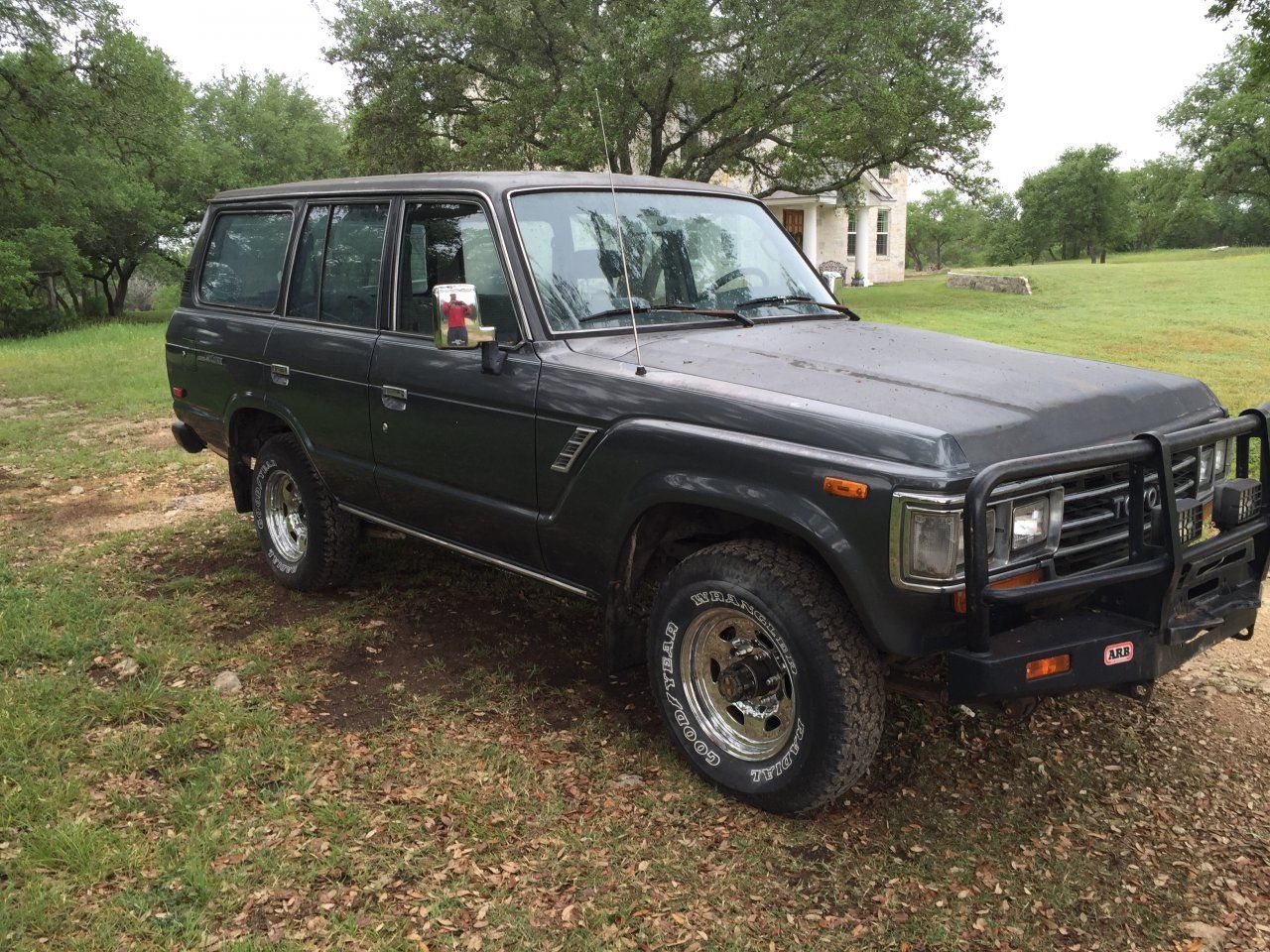

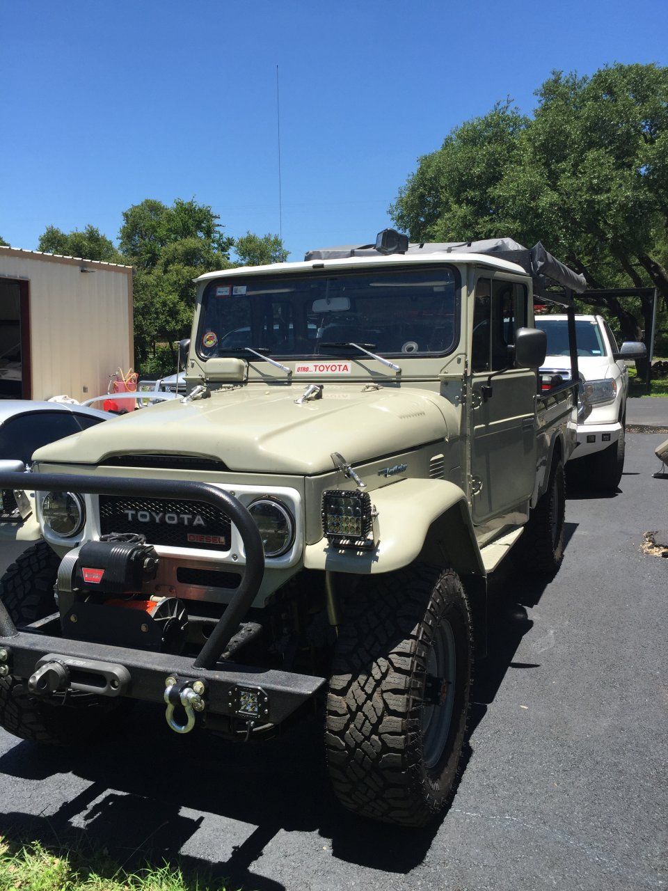

So I've come up lame on the 60 build yet again. The truth is I've never said I would finish this project in record time. As mentioned above, my brother @kmj64 bought the 62 and we've had a blast working together the last 5-6 weeks (weekends) getting it up to speed. Trying to finalize a 5-speed conversion and installing an OME lift. Will be putting in a sweet new OEM dash as well. Outside of paint, this rig is turning out great. Kevin even power washed the underside and the frame is near mint. Maybe 5% of the frame has surface rust. Mainly under the radiator which was replaced by the previous owner. To boot, my addiction continues. I recently picked up a 78 HJ45, 83 BJ60 and some sweet HJ61 axels (hub to hub). Met a really good cruiser head out of Boerne (don't have his MUD name) and worked out a very fair deal. He has a Bad Ass HJ45 that he built with a 12HT and I plan to do the same (two projects down the list). J's 45 is the tan one in the pics. And he's a great resource due to his build experience and location. So basically we are getting some diversity into the cruiser mix.
Here's the spring job on Kevin's 62 and the BJ I picked up. Needs a whole new tub (Canadian rust). It may be a parts rig or I might put another tub on it. Have a good candidate sitting right next to it. Check out the side exhaust. Never knew that was an option :). Did a POR15 job on the 62 axels. Turned out really nice. Hope to get back on my sons build in August. Still need to paint the doors and finish the assembly. I'm just way too distracted.

Yes, diversity is very nice when it comes to cruiser saving. Crazy to think this whole collection started when we received my rig from gramps a good 10 years ago. Then @CenTXFJ60 said, "Only 60 series, I am not a fan of the others.." Few years later, "Only an 80 or two but they have to be 3x locked and killer deals.." Fast foreword a few years.. "Man, I cannot believe that I got a 40 series, this wasn't supposed to happen.."
Oh and BTW the 45 is going to disappear for a few decades so that you forget about it and I'll sneak it out of the back 40 ;)
That bad boy is going in the shop once I clear some room. Can't risk letting it out of my sight!
