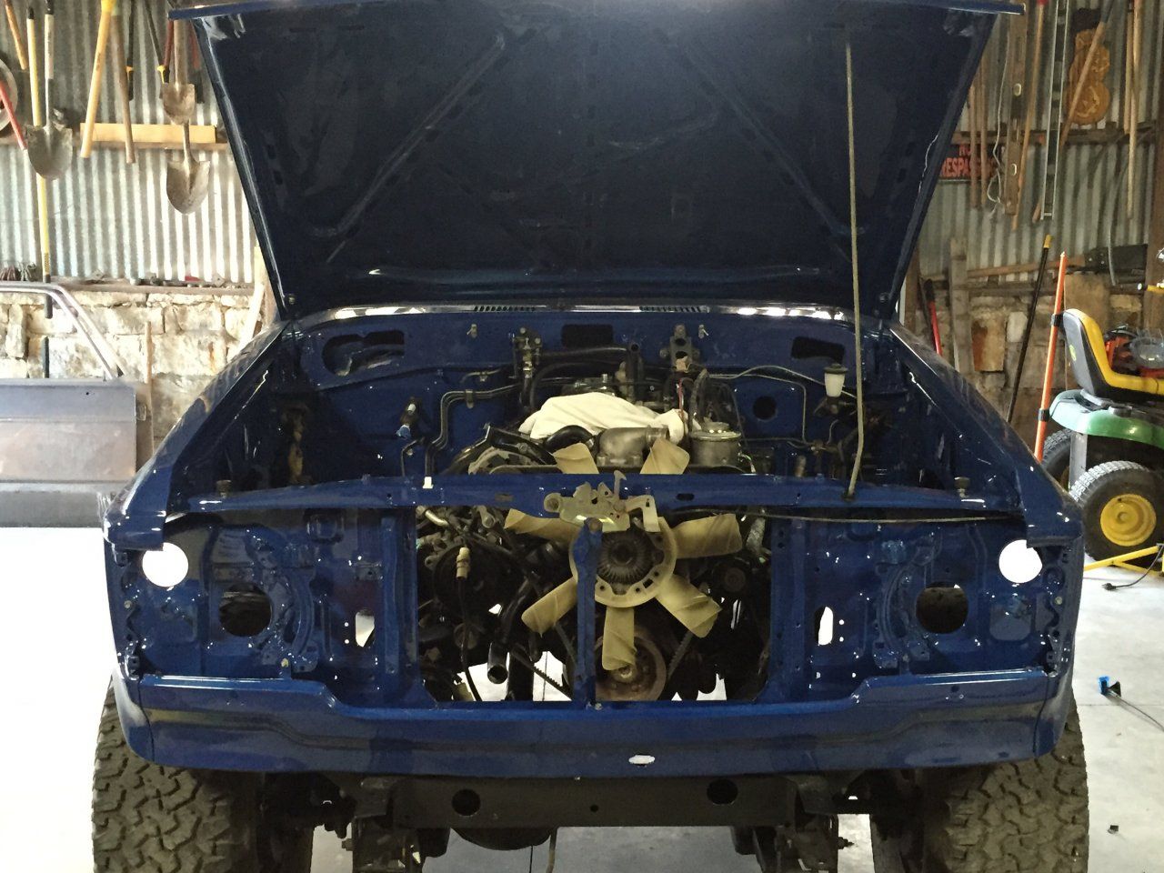

alright...it's been a while since I've worked on this rig. Work is getting in the way and we helped McGuire get settled in at school. I did paint the Core support and also redid the hood. Had to fix a few dings I missed the first go round. Spotted with some color and cleared it again. Started putting it back together today. I may be in the minority, but I'm struggling with MUD via the Internet. I've used the phone app 99.9% of the time. It's not available anymore and the internet version seems foreign. Traveling all week for work, but looking forward to next weekend. At this point it's exciting cause everything I put on is clean and new looking. Once I get it running/stopping, then I'll tackel the doors.

I have not been doing much work on the Frankenstien build, but do have a some updates. I'm one of those that depended on the MUD App and since it went down, I've been struggling with the Internet version. I use my phone 99+% of the time. Anyhow, the cruiser is running, but needs some brake work and the exhaust hooked up. Next stage will be to get the doors painted and then start rebuilding the interior. I've created a bit of a delay as I picked up a 62 last month. Big thanks to Jeff Monroy who lives on the other side of the lake from me as he put my brother on this opportunity. I'm not into 62's, but my brother wants it so I bought it since it was 15 miles from my house. Unfortunately his better half is giving him grief and won't let him take it until he sells his 03 duramax. Since I laid the cash out for this ride, I need to get it running and in his hands. It's an original clean (rust free) 174k 1990 model. Been parked since 2006 due to a kickdown cable issue in the Trans. Hopefully my brother and I can get this going quickly. Back to my build...here are some recent pics with the front end coming together. Well screw it...I can't upload pics via my phone. I miss the App. Will email pics to my laptop and post another update
