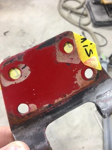

Damn, if i would of known this earlier, haha. this hinge was pretty hidden from the elements, so i already had paint mixed to match.

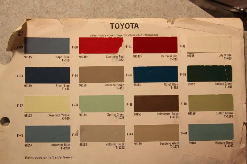

It doesn't matter so much what the name is since you already know that you have the correct color. But I wonder if that is Seminole, or Carnival there?
What a find... Especially original to N Florida.
Paint looks more Seminole than carnival to me.... They're close.
This is a great sample of original paint! Under the hinge. There seems to be an outstanding argument what the original color was- either Carnival or Seminole for these early years. What some have done- is take that part to a place that has exact color matching and get that paint (what was done on mine). Based on what is known to have been used on the Toyopet in 1958, I do believe with confidence the original color was Seminole Red- T332.

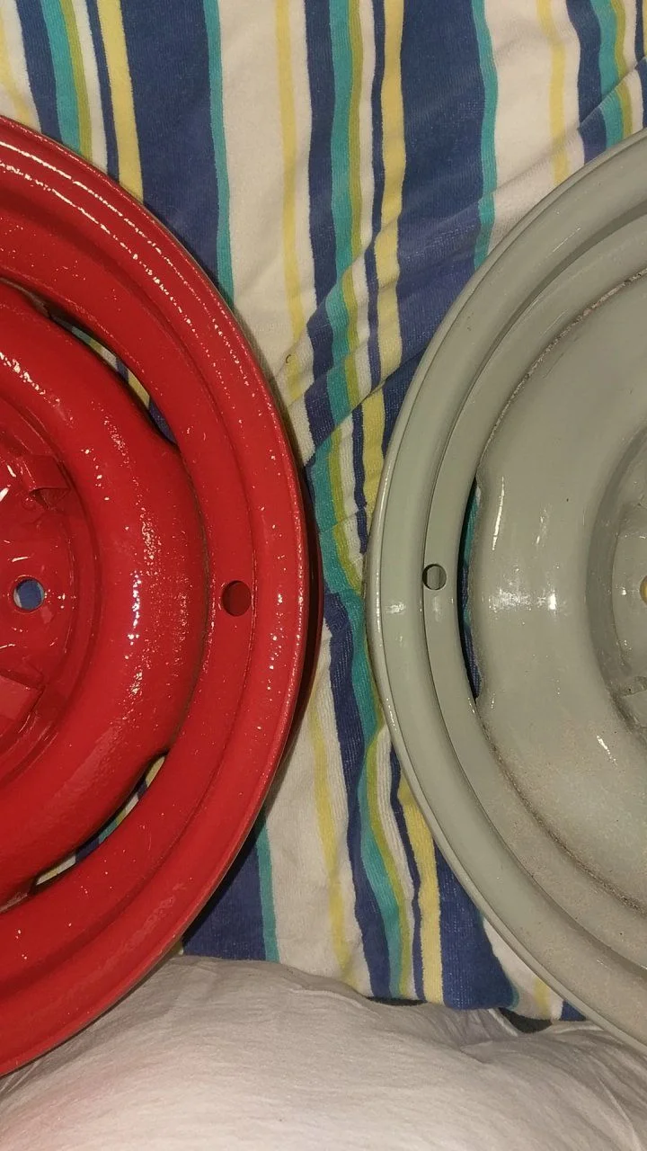

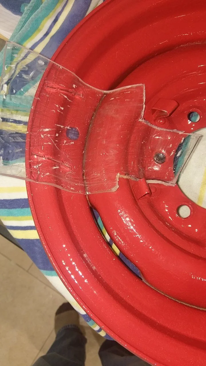

I had the hinge color matched. im trying to make the wheel brake inspection hole tonight. tahoe40/45 sent me a template. i had some thick clear lexan. Hard to mold but learned alot. Check out the diference between the red early wheel.

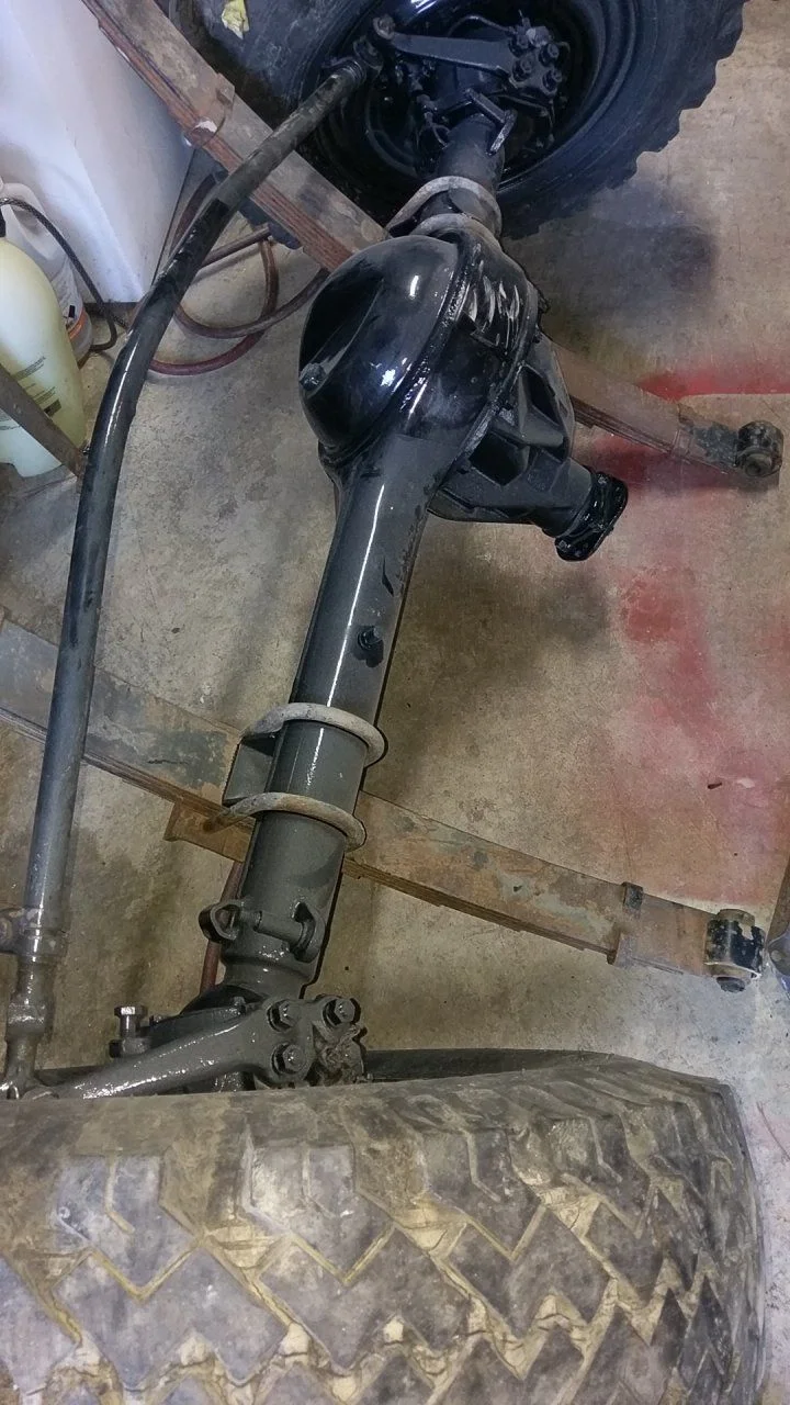

Started to organize today. front axle had springs. Not sure if they are 25 springs.

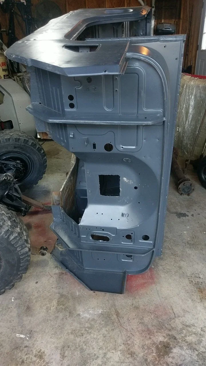

Looks like the firewall was cut due to a bad freeze plug. its bad to say but i cut my 1st 40 like this:bang:
Looks like a FJ40 Axle. 15" wheels will not work on a FJ25 front axle without spacers. I hauled a set of welded disc brakes wheels and tires all the up to Oregon from Arizona to flat tow a FJ25 back. Ended up using the old bias tires and original rims on the front.
