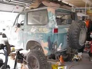

Going to spend some time inspecting what's left of the '71 donor, that is the proposed pork chopped pig, primarily to see what options there may be for removing the roof skin only, from '71, for '72, and leaving the substructure, intact.

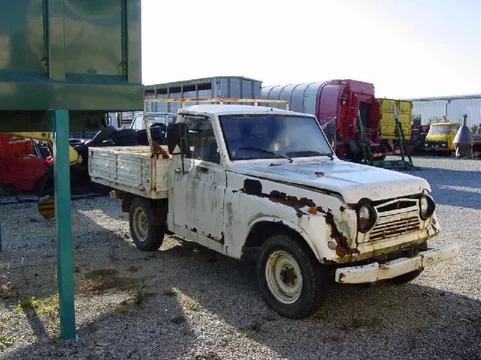

Trying to find more info on, but someone has a head start.
hey- that's NOT my truck...where'd you find that? my rig looked just like that for about a week...only blue
Though this was how I landed there...
All in collection of Pigpics on a Russian 70 Series page. Google won't translate all, but the caption on this claims it was "original".
