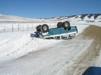

I'm really not trying to argue here, but since we are talking specifically about the 55 ... this slow-speed snow bank rollover resulted in this:
attachment.php
attachment.php
That made a lot of us pig owners re-think the safety of the stock a-pillar, I'd rather bump my head on a roll bar than have it crushed. To your other point, no idea what kind of wheeling you guys do up there ... but locally it's either rock crawling or long range expedition type off-road driving. I will assure you those guys in serious rock crawling buggies with full cages are ALL in 5-point harnesses and racing seats. I don't see an interior cage being a negative in either of theses uses for Chris, I've got the old SOR cage in mine (b & c pillar) and am planning on adding an a hoop -

This was not a roll off a snow bank, we were driving to the sand dunes in Walden, CO to do a photoshoot with one of the few FJ Cruiser prototypes. I was in my 40, right behind FJBen in Pigtastic (I liked to call it Pigzilla). The road was icy and he got sideways on the road. The front passenger tire went off the road and encountered the volume of snow filling the drainage ditch off the road shoulder. That tire stuck and the Pig flipped. Was not fun. Ben was a trooper. He ducked when he realized what was happening. The windshield was out, but we righted the Pig and pushed the roof panel back up. Pig started, so Ben kept going to the FJ Cruiser photoshoot. Toyota put out a little magazine for a few quarters when they launched the FJ Cruiser. Photos from that day made it into print. My 40 is in it, and there is a group shot, including that Pig.
Look up FJBen if you want to read more about that wreck. It was below 0 that day, all day. We just left all the Cruisers running. Ben was cold with no windshield.
He parted it out (the front axle and hood are on my Pig), and then he never found a Cruiser he kept after that. Haven't seen him in here for a while...
The windshield was out...
Precisely.

well, you could try and jump out of your 55 at 30 mph and let us know if it feels slow or not.
but 5000 lbs at 30 mph being forced to come to a complete stop will generate a lot of energy that needs to go somewhere ... especially when the impact is the front roof.
i used to have pics of a BJ60 that went off the road in winter at a 'T' intersection and endo'd at about the same speed.
the results were quite similar. we pushed out the roof and the kid drove with ski goggles on.
the A pillars did their job, it is the weak sheet metal roof that is the issue.
doesn't the 55 have the double "lip" in the sheet metal above the windshield, kinda a horizontal U shape, the top of the U being the roof, the center of the U being the lip for the windshield and the bottom being the second level about 1.5" below the roof? could you not for a piece of 1.5" square or round tube to fit inside of this reinforcement to allow the A pillars to stay vertical and the roof flatter?
remember the roof sacrificed itself to allow the energy to be expelled, possibly preventing a further barrel roll senerio ... no?
