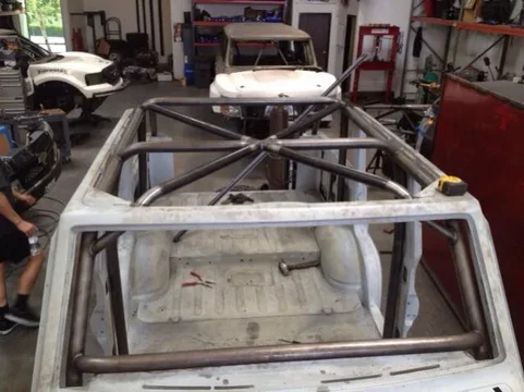

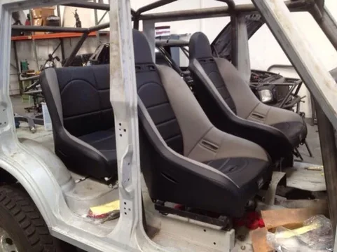

Thinking it'll need a longer rear, for the purpose of accommodating a cage and rear seat, plus offsetting the pork in the front.
It's a Pig, so a small, skinny ass just isn't fitting.

It's illogical, I realize, and I'd need to acquire a lot more skills than currently professed, but have a lot of Pig left in the titled '71, enough to get most of the way there (after chopping out the rear of the '76 and using what's left of the '72 roof).
If nothing else, it'll be a cool future project that saves another Pig from completely being scrapped....

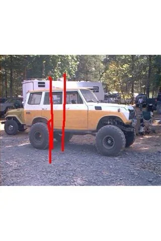

Trying to figure out how to achieve a 91-93" wheel base, without lengthening front door or an oddball transition to the rear quarter.
Wish I were better at Photochop....

I'm not a fan of the four door bobs. Why shorten the wheelbase? Lots of 40 guys looking to extend to 100 or so. The pig is perfect.
40 - 90"
70- 91"
55- 106.3"
In my uneducated way of thinking, don't see any other way to cleanly transition from the front door to the beginnings of the rear wheel well, without shortening the wheelbase,
Have hunted documented rationale behind the 90-93" wheel base on a 40 that was running 60 width axles, and can't find anywhere......recall it making sense, but again, uneducated, so they may have baffled me with BS, for all I know.
IF, being operative, your goal was to transform a 55 into something similar to a SWB or been a MWB (101") 70ish appearing, how would you go about it?
