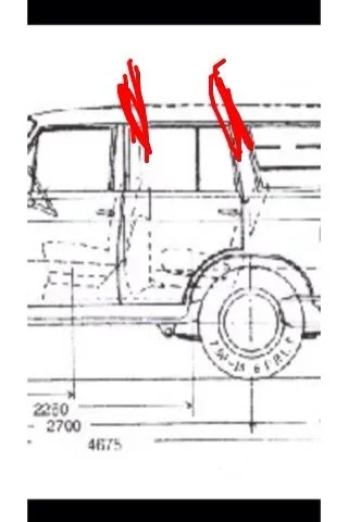

Getting very close to an 80 WB.....
All things considered, if maintaining the wheel base with intentions of a wheeling Pig, would almost be of a mind to consider a body swap, even consider widening the body, but shorty is intent and shortening a 55 frame looks like child's play compared to shortening an 80 frame.

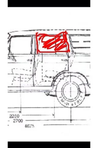

Only way to achieve is lengthening door, or pushing the entire body aft on the wheelbase.....if aesthetics are a concern. In this case, would like it to look as if originally intended.
Going to input and clean up in AutoCad next week....I hope, but for clarification, so pardon the crappy pics.
If I had to chop some out of the frame and go 90-100" I would take 24" out of the bottom below the body line behind the rear wheels.
And 10-15 out of the bottom of the rear door being sure to leave the hinge area for a smooth transition to the front door.
Then I would take 34-39" out of the top of the rear door and slide the rear window section forward to meet the front door.
Then chop 34-39" out of the roof and
10-15 out of the frame.
Just assuming those numbers would work without a full pig and tape measure in front of me at the moment.
I've watched too many reality TV shows, but thinking tape and tape measure may be in order for me to visualize.
Had not given any consideration to the door following the wheel well arch, but appears they took that route on this.... Looks like the rear door was sliced to the front.

after toying around with the tape and Chris's request for a photochop, I'd have to say- without loosing some WB, it is going to be one funny lookin summbich. with a 10" reduc in WB, then a full 36" could be chopped w/o looking like a cheap chinese counterfit russian 4X4...pregnant roller skate... kankles...w/o that big ol booty on it, the pig might suffer from overly obtuse front butt...
