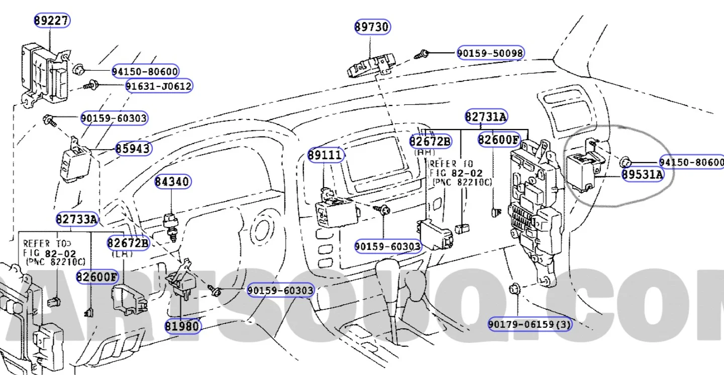

Unfortunately I ordered the internal wiring harness, not the external one I'd intended to. I'm going to install this relay control module and see if the harness is still necessary.
The module I'm replacing is circled in the diagram below. I pulled the glove box and this module isn't immediately obvious. Any chance one of y'all knows where this thing lives?
