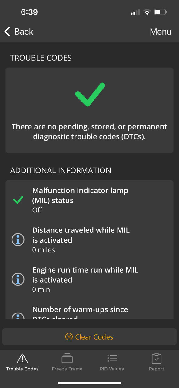

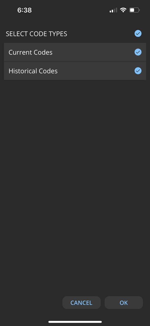

I’m not familiar enough with how the transmission works. Sounds like it’s not getting the speed signal. I’m surprised you’ve not gotten any codes. What code reader are you using, and does it have the specific add on for your truck? I have OBD Fusion, and when I read codes I have to specify which channel it’s scanning.
I run a scan gauge II full time and have another hand held unit as well. Both go through the obd2 port.
I’m not familiar with those scanners. Our trucks have multiple diagnostic channels, and you should get, at the very least, historical codes, given you’ve had lights at least a couple of times. For OBD Fusion I need to select the channel or channels I want to scan, and I do need the Toyota / Lexus plug in for the specific vehicle.
I'm not sure how they compare. The ScanGauge, to my knowledge, should read any codes that come up in real time. But maybe there's another layer of diagnostics that isn't read through the OBD port?
