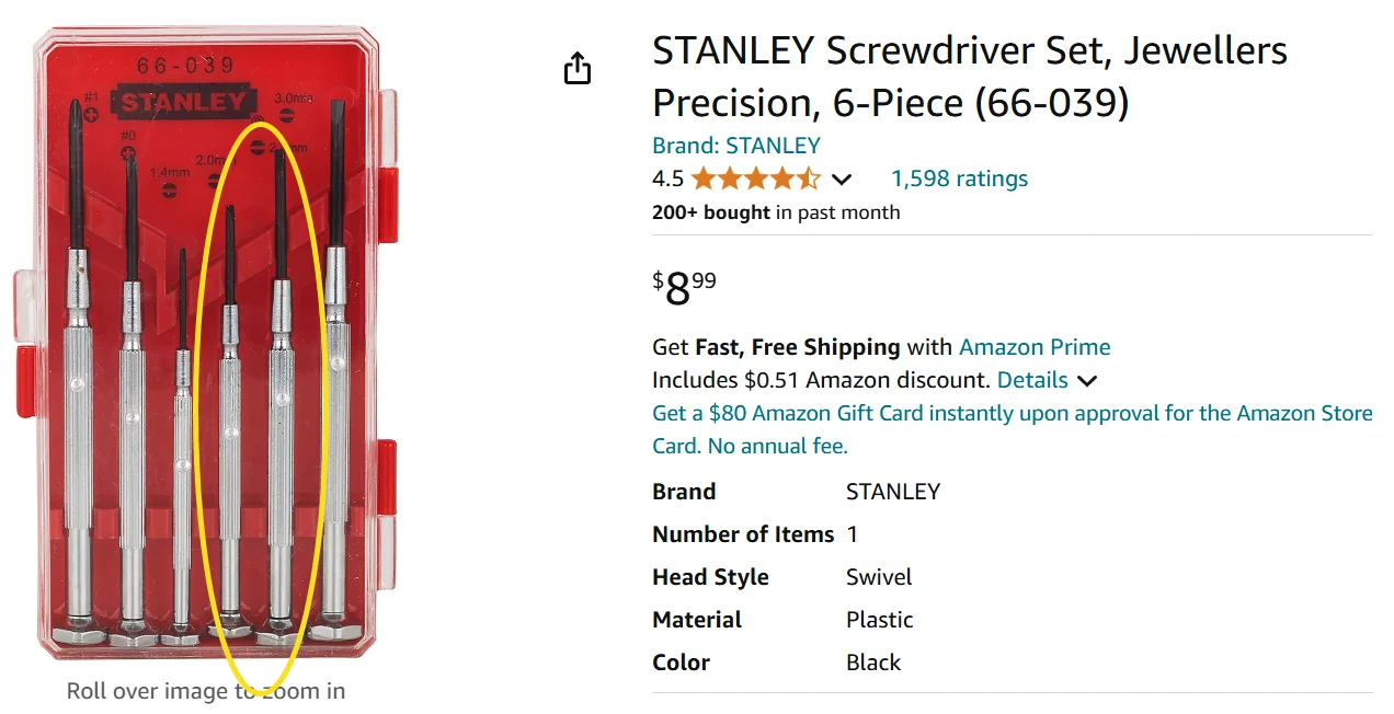

I can try this. In lieu of an actual depinning tool, what's a safe way to do it without damaging the pin or connector?

Either one of these will work:

I didn't find my tiny jeweller's drivers, so tried a paperclip to depin instead. No luck, clip didn't have the rigidity to move the lock on the pin (yes I did release the locking bar on the back side of the connector) . I'll get a depin tool kit to be safe, I can easily see screwing this up without the right tool.
