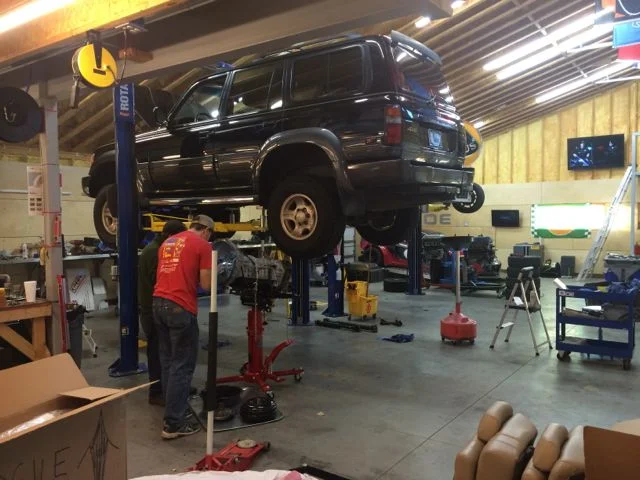

Well, we'll probably pull the trans tomorrow late in the day after we're all done adding about 100hp to cjmoon's rig :)

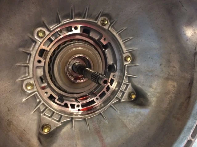

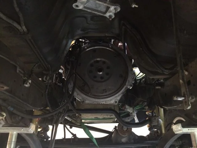

Anyone put money on the issue? Cracked flex plate? Ballooned torque converter? Loose flywheel?
Seems the TC must have something broke inside. No significant metal shavings. Trans looks very clean. Trans oil was clean. Inspected the pump and clutches.
Flywheel is tight and flex plate looks sound.
So the question: Who's making a good TC for this trans behind a diesel?

We did check the engine thrust with a dial indicator, as that occurred to me as well. It's dead on at .010, which is middle of the spec from what I've seen...
The noise is independent of load and trans engagement, speed, etc. So the noise should be possible to be coming from the trans. Since the FW and Flexplate check out, we're only left with the TC... I agree though; When I've seen them die from power, it's usually a ballooning scenario... ?????
