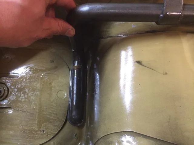

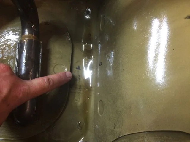

Pull the pan. It needed to happen anyway to clearance it. Learned some new things. As mentioned prior, Duiser didn't clearance the pan for the connecting link. This resulted in the connecting link hitting the pan hard enough to "smile" the connecting link and bend the pan a good bit. Turns out the oil pick-up is directly above the oil pick-up. When the pan was bent, it smashed against the oil pick-up resulting in a good bit of the oil supply being blocked from the pick-up! Oops! lol
I also pulled the thrust bearing (part of one of the #6 main bearing). It was broke into 3 pieces. It's a 3 piece bearing in assembly and then brought together, however it was beat to hell and back which broke into 3 pieces again. I think I found my huckleberry! Obviously the loose FW caused this. The mains and rods look fine otherwise. I'm here, so I'll replace the rod bearings since it's easy and I have a good discount with Calico for coated bearings like we use on the road race motors.
