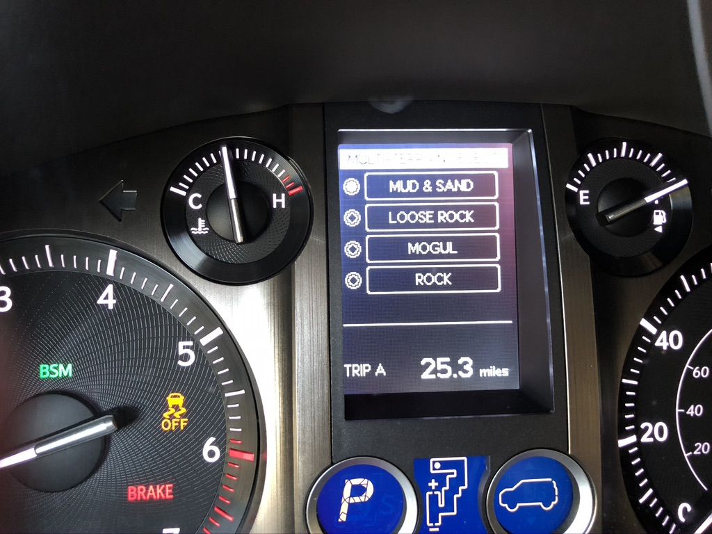

mine is installed,
Big thanks to the OG of this post ! Also to everyone who provided input on this subject.
Very impressive!

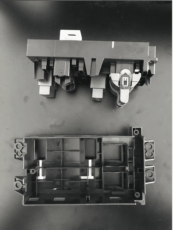

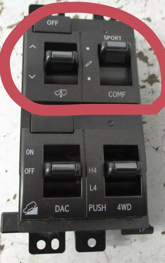

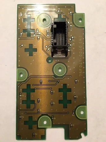

Not quite the same thing as this threads intention, however my question should fit in here.

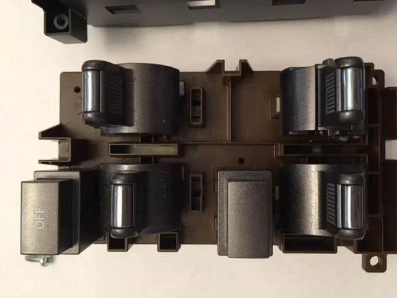

My 460 has blanks on the top two switch locations but I want to install the one with sport and height control—mainly for the sport/suspension switch (*see below). Is this plug and play in my 2010?

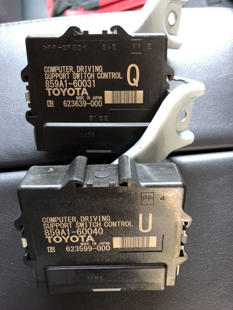

Just ordered my parts for 2017 GX460
MTS Module: 859A1-60040
Crawl Control Switch: 84970-60090
