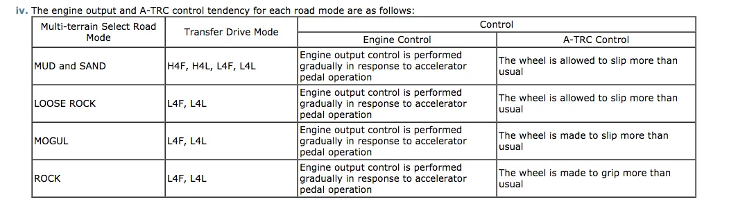

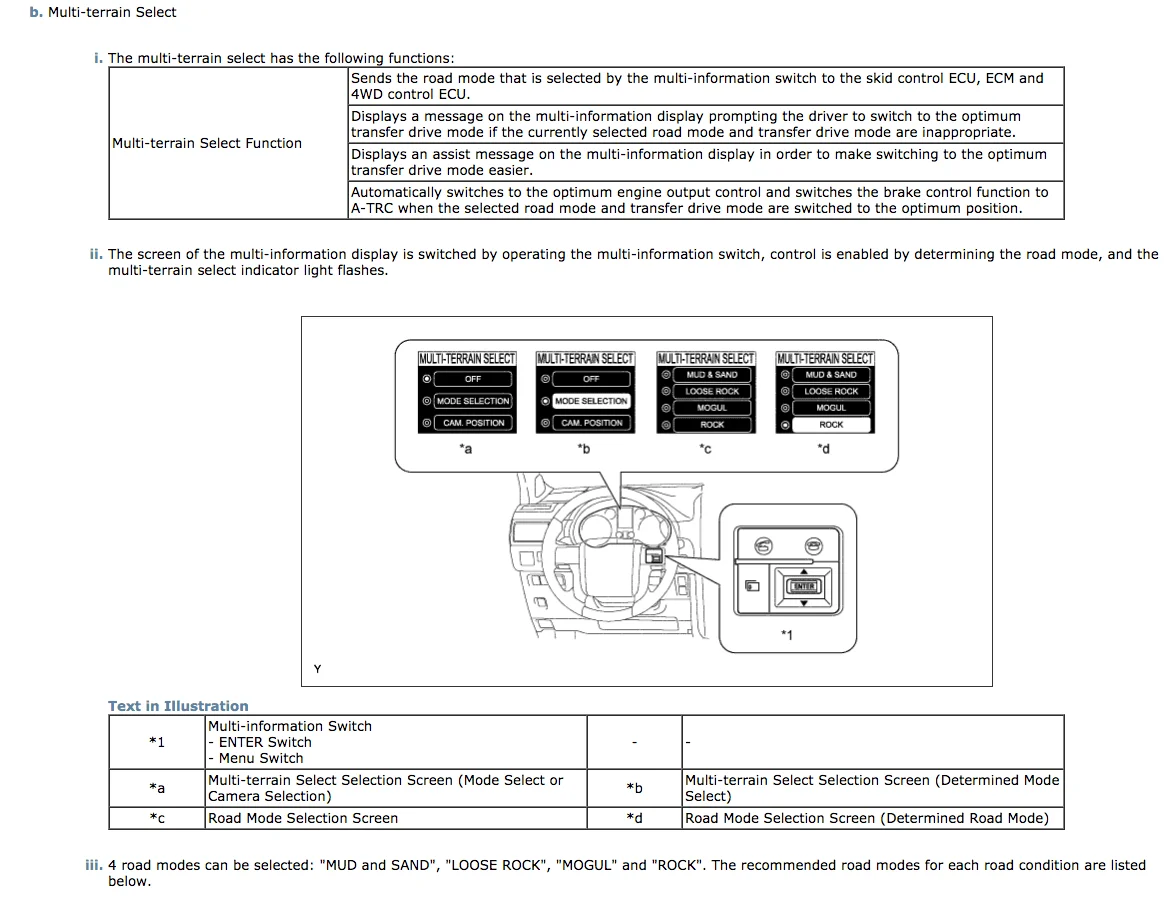

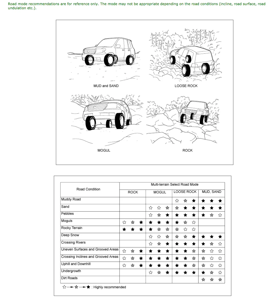

Crawl would replace DAC. DAC is a functionally limited Crawl.
Crawl pros: Can work uphill, also controls accelerator and variable speed

Yes. You can install either one of them without the other.
Only thing is that MTS is literally plug-n-play. Plug it in and you'll see it right away on your display.
CC, you'll have to reprogram or do some wire jumping. Not hard, but also not plug-n-play either.
