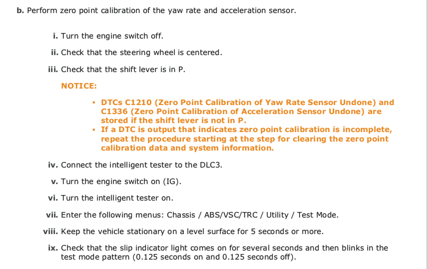

So the first part is to reset and then the second piece sets ZPC.
Notice above was Reset Memory and now below it is Test Mode.
Trying hitting crawl button at the end of these steps before turning off
Great Sucesssssss
Awesome thanks, had to do the test part. I threw a code too bc I didn't do the test part. Now all is good

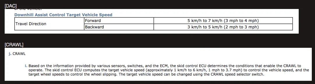

DAC is really just neutered crawl. DAC only does brakes but Crawl can operate accelerator as well. Both can work in forward/reverse
Fixed speed with DAC and 5 speeds with Crawl as seen below.
Speed limits
