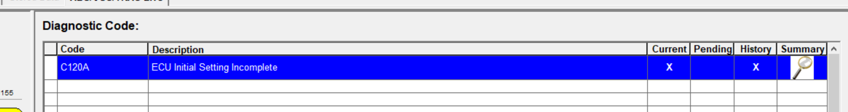

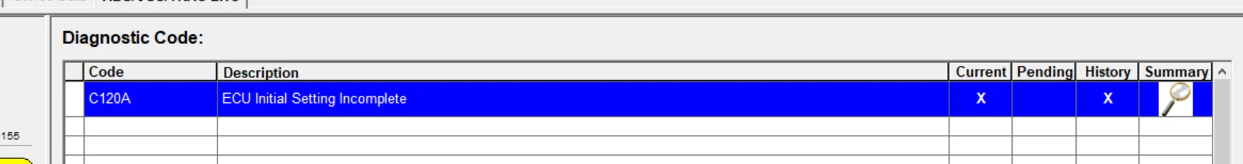

I looked into DTC codes and found out every time I reset the memory, the C120A (ECU Initial Setting Incomplete) error code shows up. It doesn't clear by the software, and it doesn't clear by crawl control ZPC. I have to connect the down-hill assist and perform the ZPC to erase it. The emergency brake and other functionalities also come back. I repeated the memory reset and ZPC three time but the craw control switch does not erase this error, i.e. the ECU calibration remains incomplete with the crawl control console switch.
Now I suspect maybe the ECU doesn't recognize this new console switch at all. Because I don't see it in the crawl control parameter in the Data List. It only has the down-hill assist. This image is for the second page. I lost the screenshot from the first page, down-hill assist was there.

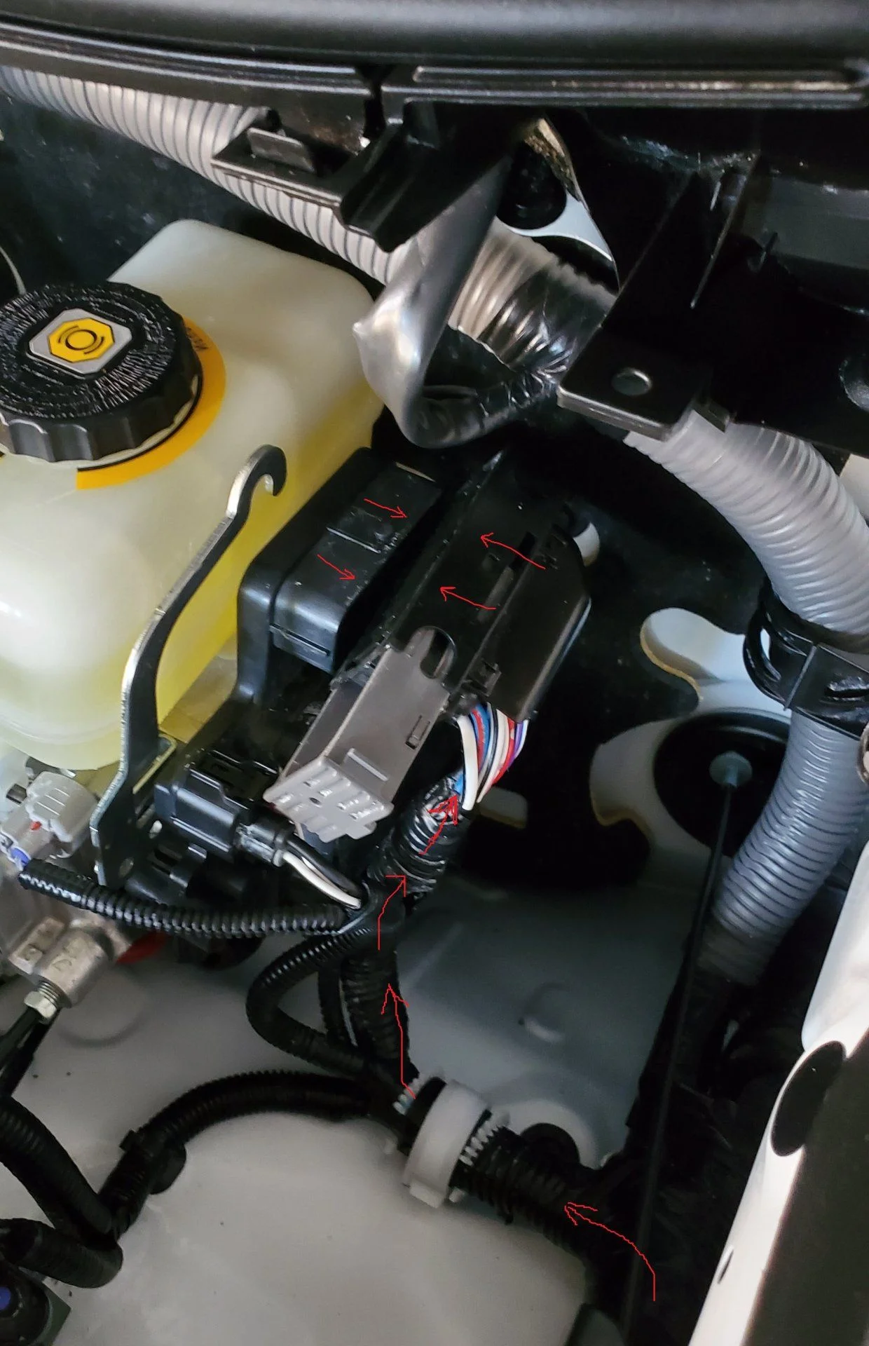

The Skid ECU is attached to the brake master under the hood. I was just wondering if the proper wires are going to that connector.

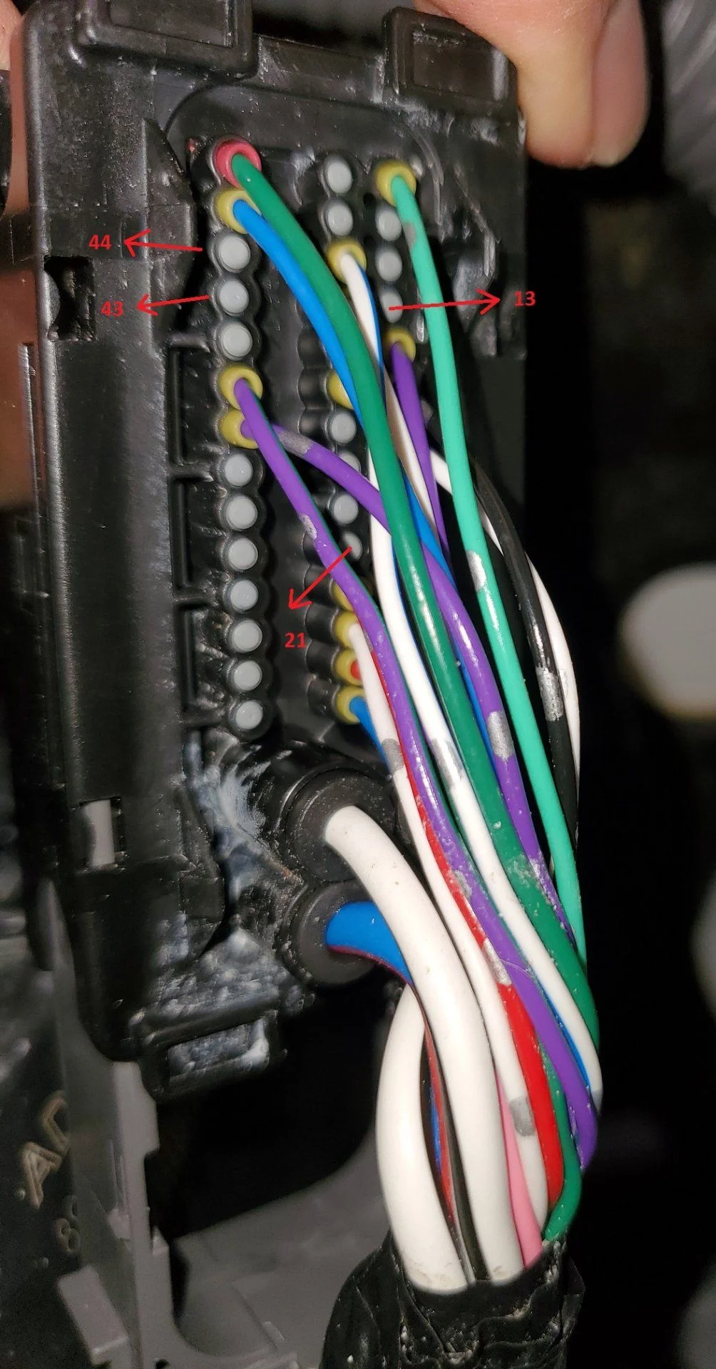

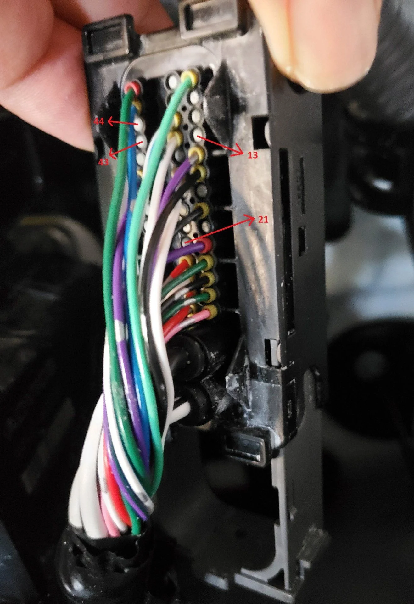

As @OCGX mentioned the CC switches are wired directly to the Skid Control ECU in 2020. I looked into the skid control ECU connector today to compare it to the 2020's crawl control wiring diagram. To my understanding, all the pins for crawls (on/off, down, up, gnd) are null in my vehicle. Meaning that there is no wire from crawl control switch (in the cabin) to the skid control ECU.
Pictures from two directions and pin numbers are: PIN43 (ON/OFF), PIN44 (DOWN), PIN13 (UP), PIN21 (GND).
Yeah... Lexus is badly saving on wires this year...

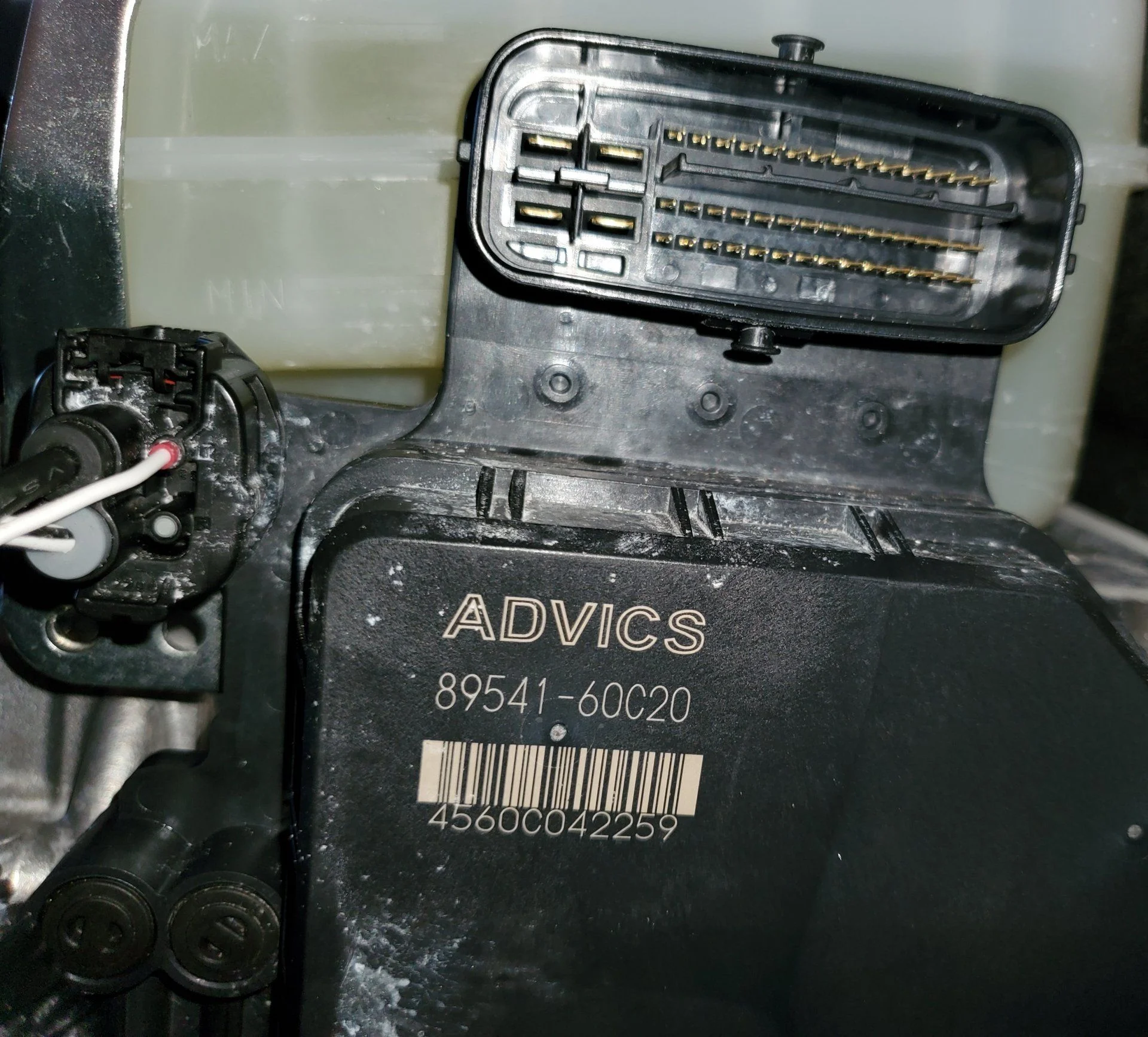

I'm thinking about finding a fully-wired ECU connector for replacing/testing. Don't know the part number, though. Might be the same as 2019 model, can anyone share a picture from their skid ecu connector of 2014-2019 model? Also, the skid ecu part number?
