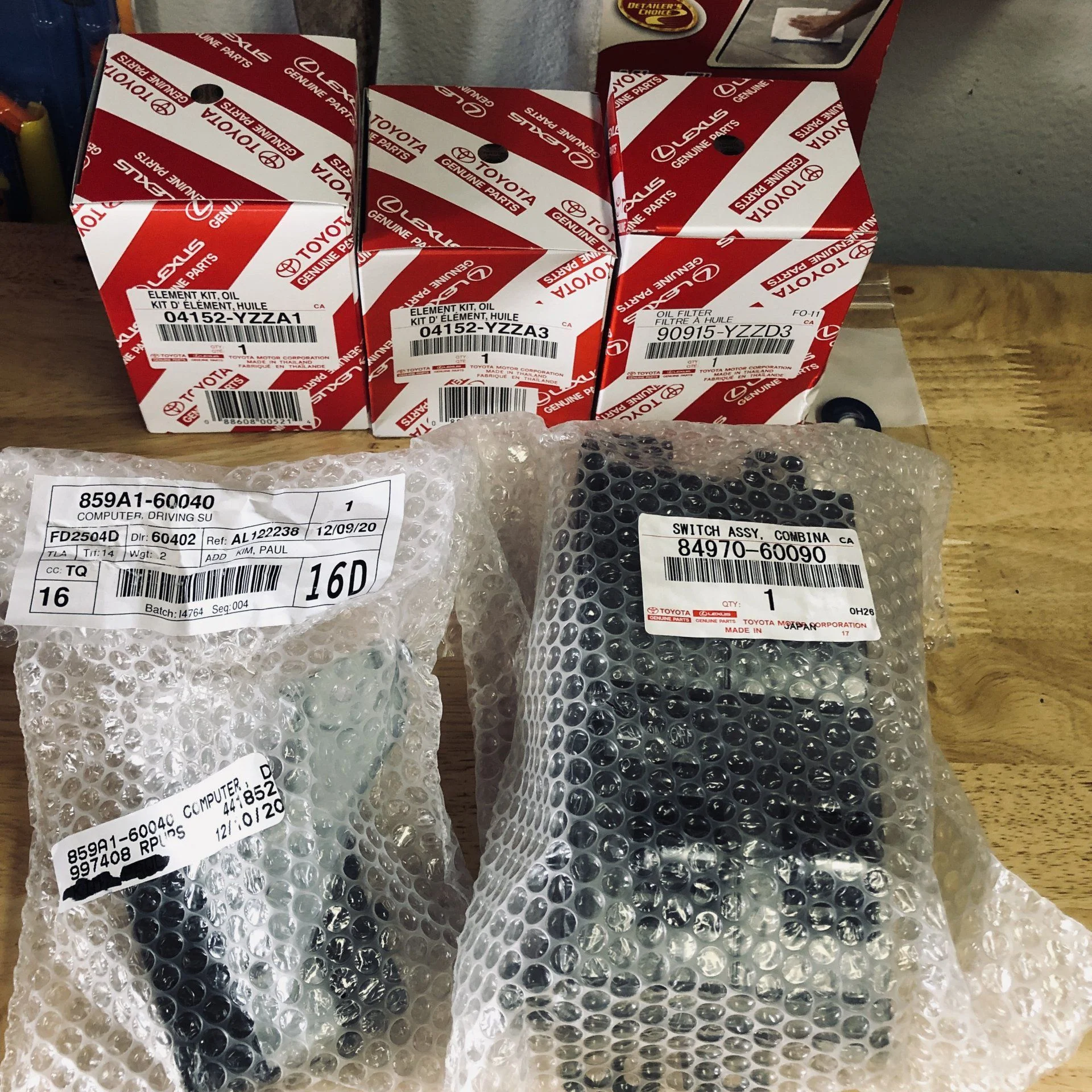

Here’s my lot ready for install

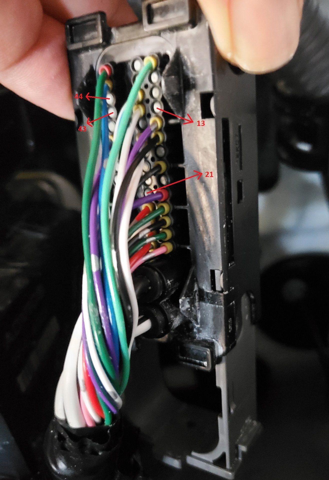

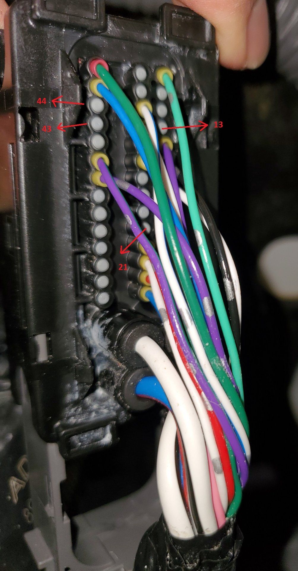

If someone has a 2020+ Luxury model you can help the effort to bring Crawl/MTS to non-equipped 20+ models by posting some pictures of the wiring connected to your skid control ECU. At this time it would seem wiring is missing from a Base/Premium. We do not know if Luxury lacks the wiring.
••It would be great to see wiring of a Luxury with Off-Road-Package as well.
Thanks!
As @OCGX mentioned the CC switches are wired directly to the Skid Control ECU in 2020. I looked into the skid control ECU connector today to compare it to the 2020's crawl control wiring diagram. To my understanding, all the pins for crawls (on/off, down, up, gnd) are null in my vehicle. Meaning that there is no wire from crawl control switch (in the cabin) to the skid control ECU.
Pictures from two directions and pin numbers are: PIN43 (ON/OFF), PIN44 (DOWN), PIN13 (UP), PIN21 (GND).
View attachment 2328145 View attachment 2328147
Yeah... Lexus is badly saving on wires this year...
1-jpg.2328145
2-socekt-jpg.2328147
