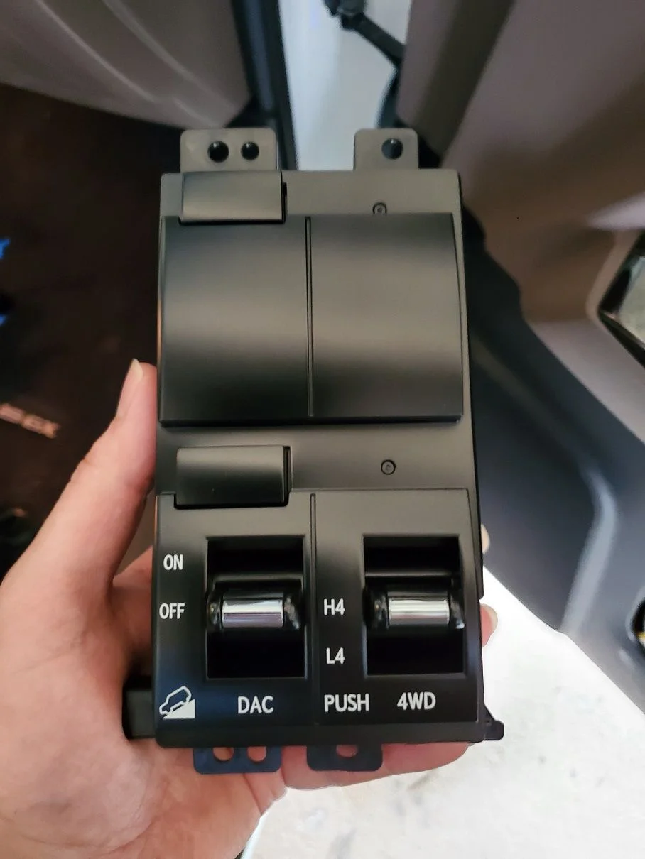

I'm very interested in getting CC/MTS working on my 2020 GX460. I mistakenly purchased the parts for the 2019 thinking they would work on a 2020. Then I found this thread and realized that there are significant changes to the 2020. I had the 2019 CC/MTS switch panel but sold it in new condition... The switch 2019 CC switch is a different type than the 2020 switch, plus with the changes outlined in the wiring diagram, I was certain it would not work.
I purchased the 4 switch panel for the 2020 Luxury model with CC/MTS and air/dynamic suspension switches. It's still wrapped up new... I was hoping just the switch was needed, but again, it looks like some additional mods will be required.

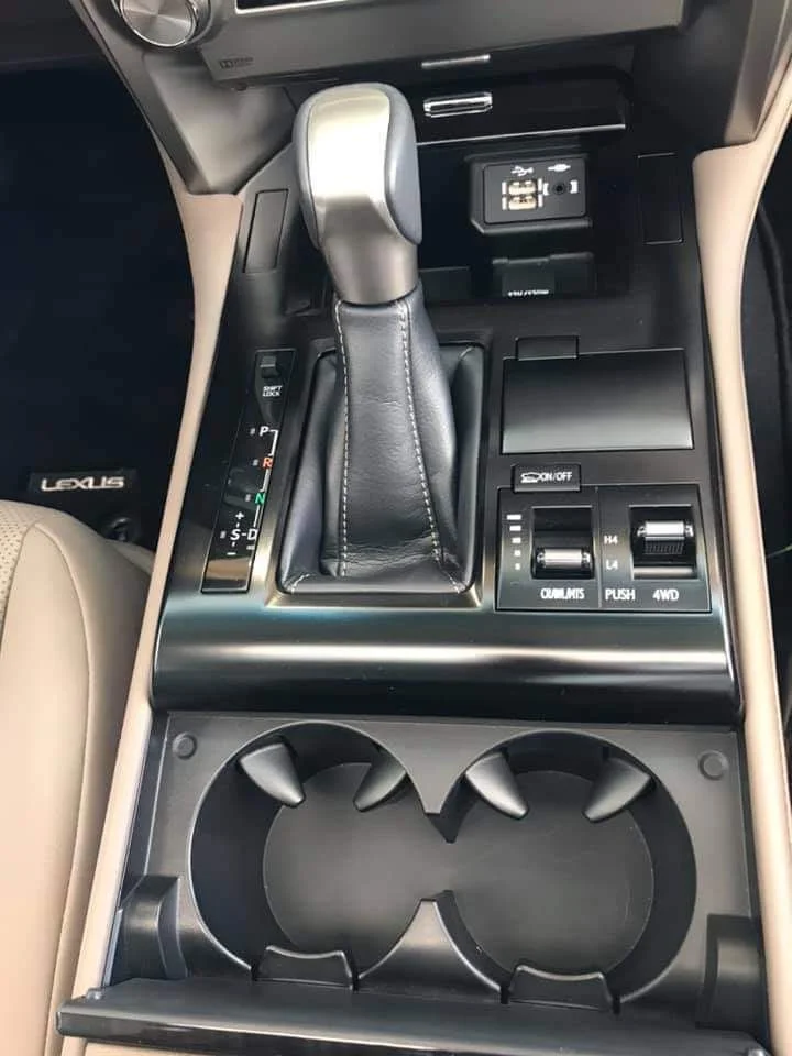

I happened to find this 2 switch panel from a 2020 Premium model that was sold overseas in the UAE that is called the GX460 Off Road Edition. It does not have all the additional options that are included in the US version of the GX460 Luxury with Off Road Package.
Hopefully somebody will be able to help find the part number. It also give me a little hope that it will be possible to add CC/MTS to a 2020 Premium.
Here is a link to the YouTube video of the GX460 Premium with Off Road Edition that is sold overseas...

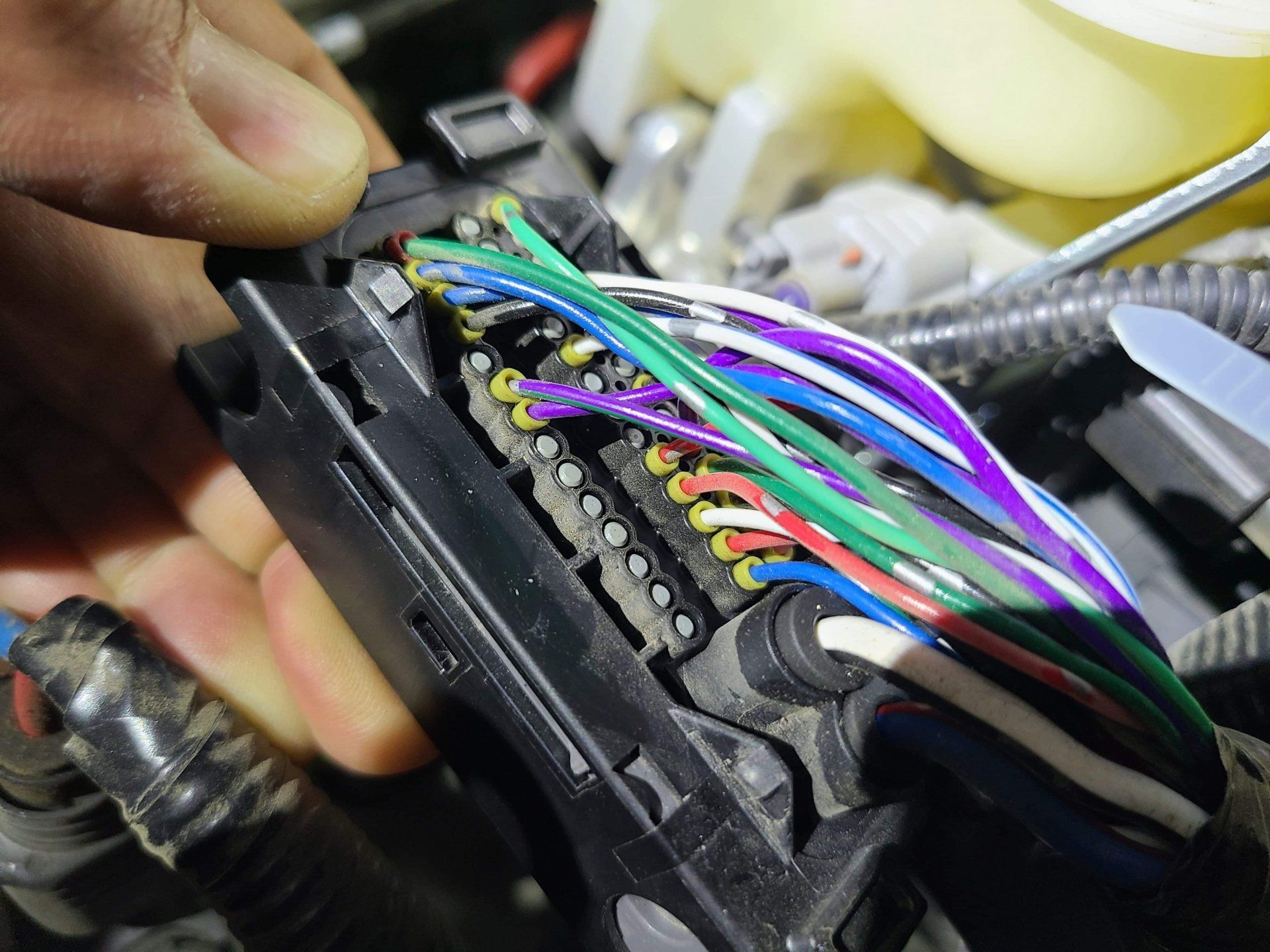

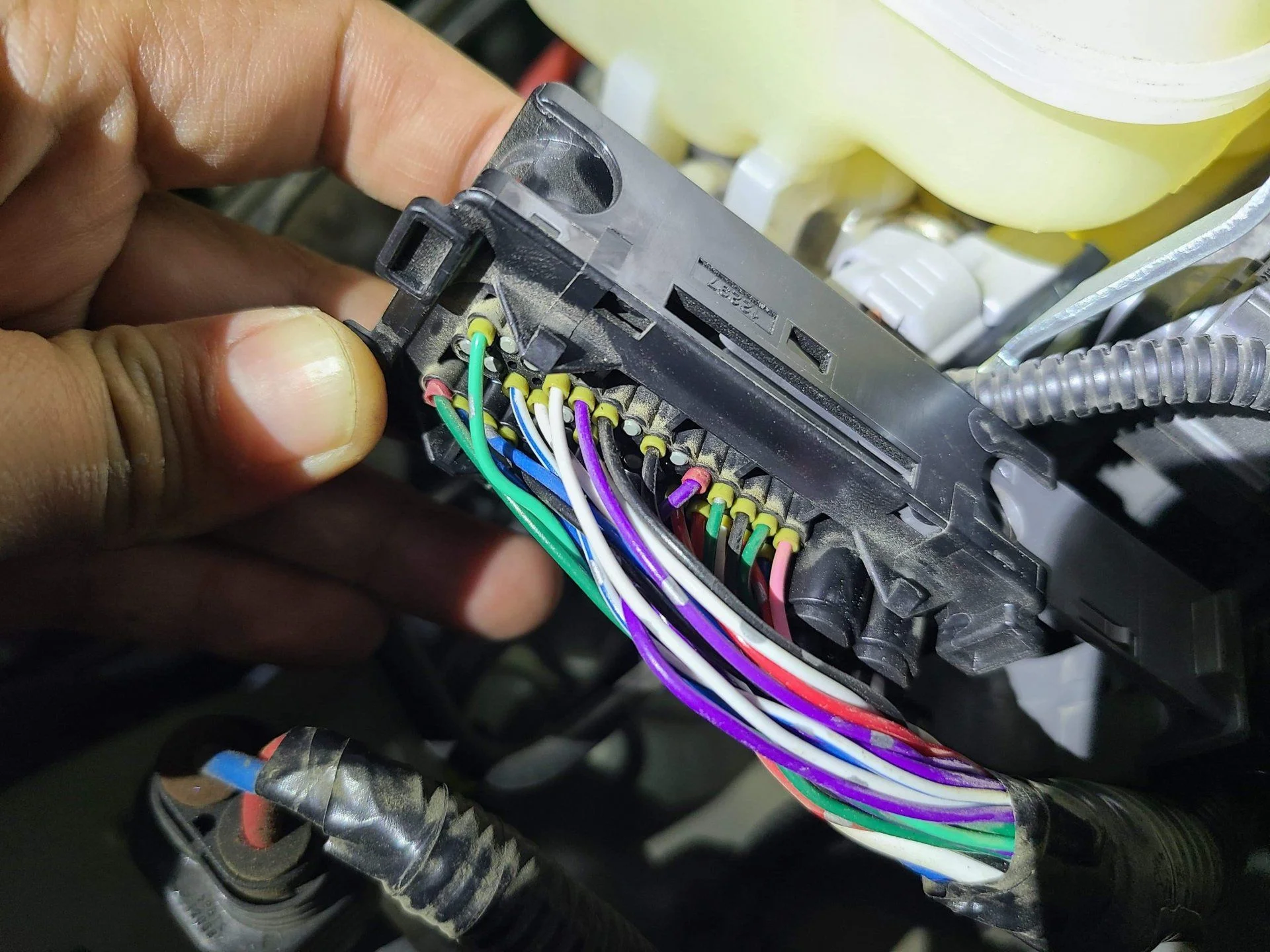

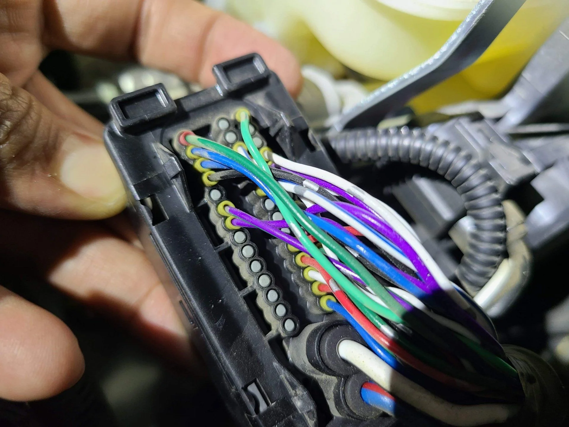

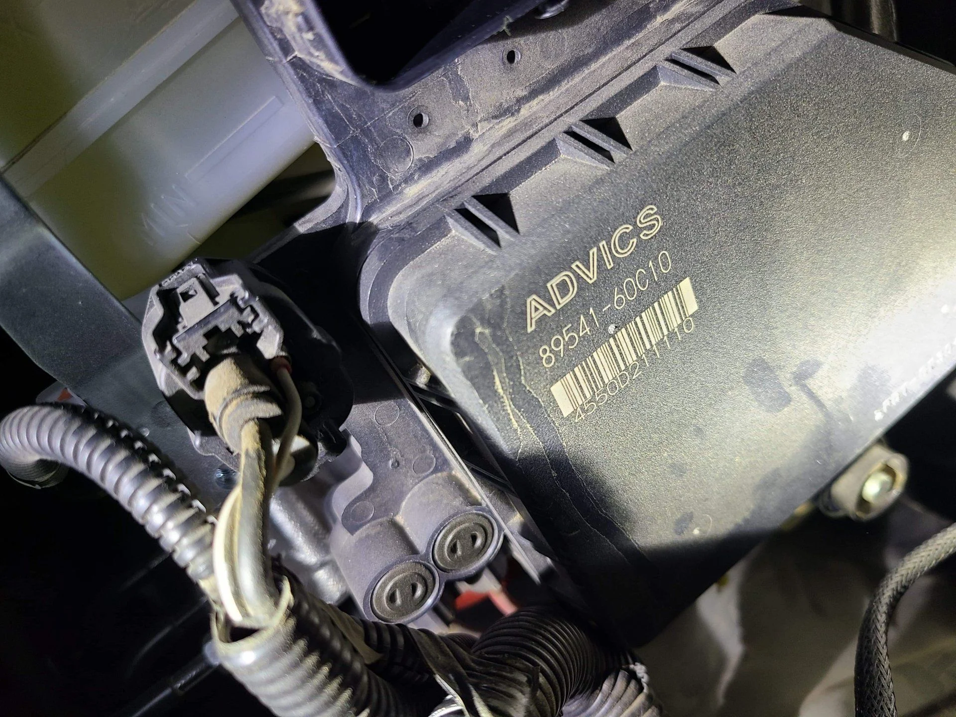

Here is an example of a '20 Luxury w/off-road package. Necessary wiring is there but skid control ECU number is the same PN as other trims.
We still need to see if '20+ Luxury without off-road package has this wiring or if absent like base & premium
CL member with a 2020 Luxury without off-road pulled back the wiring on skid control ECU... same terminations as Luxury w/off-road. Strong chance a 20+ Luxury without off-road can be modded with switch.

20+ no longer uses the MTS ECU of 10-19.. It is bundled with skid control ECU.
