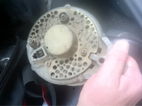

There was no voltage regulator that I could find looking around in the engine compartment. Where would it be? I am assuming it would be near the alt. The alt. plug in wire (as in DSRTDRs post) did not have a voltage regulator attached to it anywhere near alternator. Would the VR be on the frame or firewall somewhere?
This is the one I used. Makes no ref. to internal VR.
Ultima 14131 - Alternator | O'Reilly Auto Parts

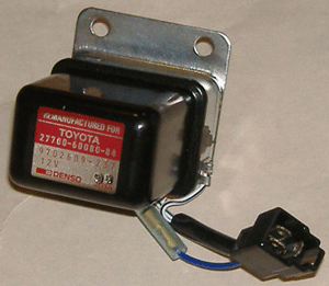

location of an external regulator would be on the firewall under the master cylinders
according to Specter Offroad's site, the breakover from external to internally regulated alternators was 1/79
take a pic of what you had and have now - since O-Reilly's lists other alternators specifically as externally regulated, I am taking a wild animated guess that your new one is internally regulated

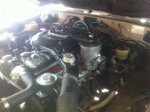

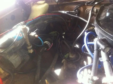

I put the Affordable Fuel Injection kit in my truck a few weekends ago... if any of y'all get sick of the carb, I give this kit 2 thumbs up! I found a slightly used kit in the classifieds, so the cost wasn't too painful.

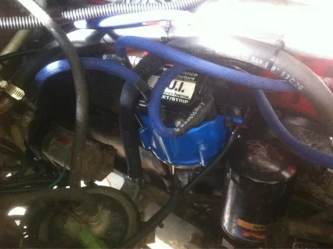

It came with a computer controlled DUI dizzy, which got rid of the coil and igniter. I would have preferred the Toyota dizzy that now comes with the kit, but I didn't want to spend the extra $400 to replace this.

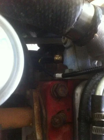

The temp sender screwed right into the thermostat housing...

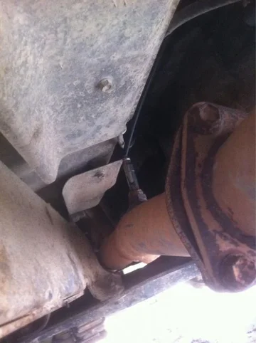

Weldered in the O2 sensor...
Put a 'lectric fuel pump in (disobeyed all the rules of inljne electric pumps and stuck it on the fender)

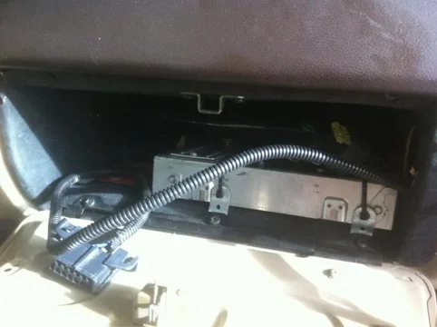

Mounted the computer in the glovebox...
After everything was hooked up, she fired up on the first try! Set the timing and she was purring like a kitten!
The carb was running like a champ, but this is so much smoother. Much better response in the low to mid rpm range. Not any more power at WOT, but definitely has more power off the line.
My engine bay smells alot cleaner now. No lingering gas smell. I haven't run a full tank through, so no MPG calculations. It'll probably go down, 'cause I've been driving faster!
