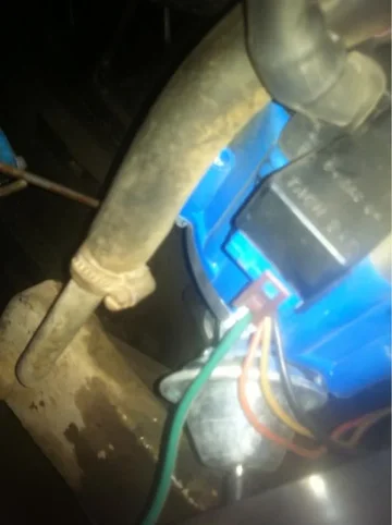

I'm also still trying to figure out where VR might be. This cruiser has a DUI distributer. Could it have a built in VR? The wire coming off ALT has a shoot off that goes to a small box that is attached to the DUI distributer. It's in pic below.
this is the shush installed ignition system
http://www.performancedistributors.com/toyotadui.htm
MEMCruiser said:
That box in pic, I was thinking might be the VR. Guess its the tach output?
No, that's just part of the distributor. Battery in and tach signal out.
If there is no VR what would symptoms be?
There is a regulator somewhere. Your test above proves that out. You had just over 12v at the battery then it increased to over 13v after start up. That's what the vr does. I can't tell you if its internal or external but the parts store you bought it from should be able to tell you. I suspect it is external any you just have not found it yet.

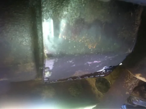

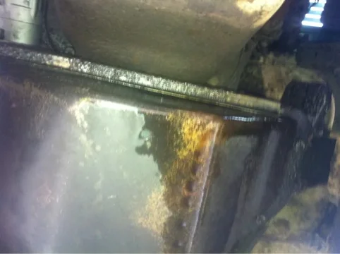

That's just a cover over the clutch and flywheel.
Could be the rear main, but probably the oil pan. You can *gently* snug up the oil pan bolts and see if that has any effect.
Works most of the time. If not, I have a gasket I'll send and trick to get pan off.
