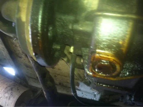

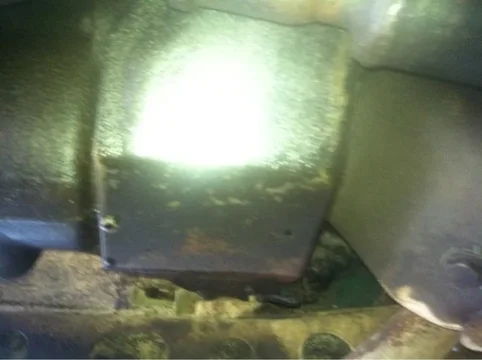

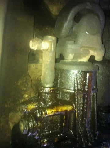

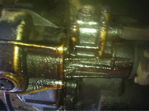

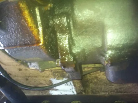

What I generally do on these things Mike is pressure wash the Tcase so you can get a baseline and see where the actual leak is coming from.
Looks like nose cone seal (easy fix) but it is hard to say.
Get some good degreaser and some dirty clothes and head to the pressure washer.
Lucas stop leak works good to seal up old seals if you don't want to dump $ it while waiting on Orion.
Thanks. As soon as I get the new alternator in that is what I will do.
Will simple green work as a degreaser?
Looks like every old 40 I've ever seen. Do like Nolen says and then get the seals to fix it. Marlin seals!
