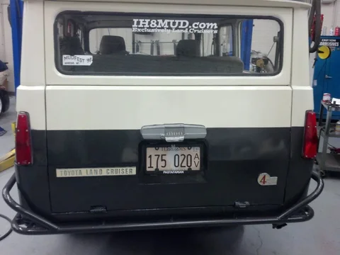

Epic ceremonial road trip today. The PO said I could have the big repop tailgate badge when it was done. I set done as being able to drive the 60 or so miles to his house under its own power.

In the end it made it up and made it back. The engine and drivetrain performed flawlessly. I now have a new list of things to work on. I got the finishing touch badge, and scored a light to fill the last hole in the dash.
Congrats on your trip. Too bad you got some road gremlins. I lucked out with mine and it goes down the highway pretty good. I have done 80mph with my old F155 and rubber overdrive. Cruises 70 no problem. Yours should be even better once you get it dialed in.
Now post up some pix of the sticker

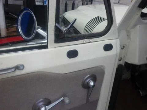

I also drew new window vent bolt access covers and sent them to the 3D printer. I embellished the design a little.
If you are going to make these pls let me know bc I need four of them as well. Would be happy to contribute $ to project.
If I make another batch I'll let you know. The ones I made so far would not clip into the holes. Melting the ABS so that it can be deposited by the printer head makes it brittle. Getting the tabs small enough to bend, but not break is going to be very tricky. I ended up making them too thick to bend and having to cut them off. I glued the covers into place with a little RTV. I still have to trim some of the excess away now that it's dry.

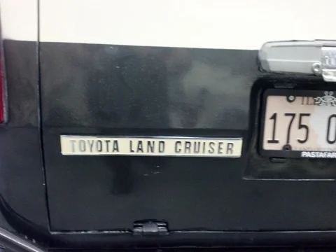

The emblem went on just fine.

I considered re-fabricating the hole size to some standard round plug size that is commonly available. Still may do that.
FWIW mine are all intact on my LV... they might not be when I try, someday, to remove them to prep for blast and paint....
