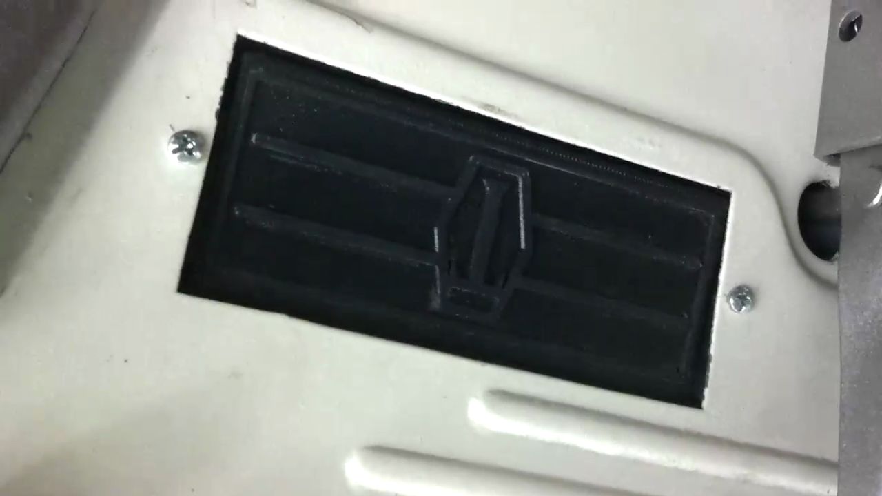

I ordered up a 4.5" x 1.5" OBDII monitor screen to put in the stock radio slot. I think. I'll try to 3d print/build a radio delete plate garage door for it.it will be nice to dial up any OBD PID any time and be able to monitor it.

It was a struggle. The Scangauge is very tight to the stock radio opening. modifying the opening is absolutely not an option. The first door had ABS sides. They were too thick and thin enough would not be strong enough. So I cut the sides off and made a sheet metal plate for the printed face place to mount to. The tabs I printed to pivot the door off of worked fine. The little side pieces to go over the screws didn't look good.
The delete plate door face came out nice, but the raised lines coming out from the diamond in the center were too fragile and were breaking. I'm going to re-print it with thicker lines and have the lines taper wider at the bottom for strength. I'm also going to print a bezel to go all the way around the opening with the screw holes. Its tough to see the pattern in the pictures. After I took the pics I filed the tops of the lines so the texture would be left in the relief areas, but smooth on the raised areas.
the scangauge isn't mounted and is a little crooked in the picture.
All in all it works and I like it. I have a little motor and reverse polarity switch. I might make it powered, but manual would be OK too.

Reprinted the plate. It looks better and is stronger.
reprinted the inside piece. It now has a shelf for the scangauge to sit. Helicoiled the pivot bolts for stength.
replaced the black screws with chrome ones. I don't think I have room for a bezel so I'm leaving it as it is.

I had ordered a reverse polarity switch and a door lock actuator a while back. This morning I hooked it all up to my scangauge garage door. It pops open and shut pretty well perfectly now. I really need a momentary switch though. Im afraid I'll leave this one on and cook the solenoid. It was tough to get the solenoid to clear everything inside the dash. It's still pretty close to the wiper arms, but they work without hitting.
edit- just ordered the switch from Amazon. So much easier that going to Radio Shack and not being able to find anything. That store is completely worthless now.

Wired up the momentary switch to the delete plate garage door.
