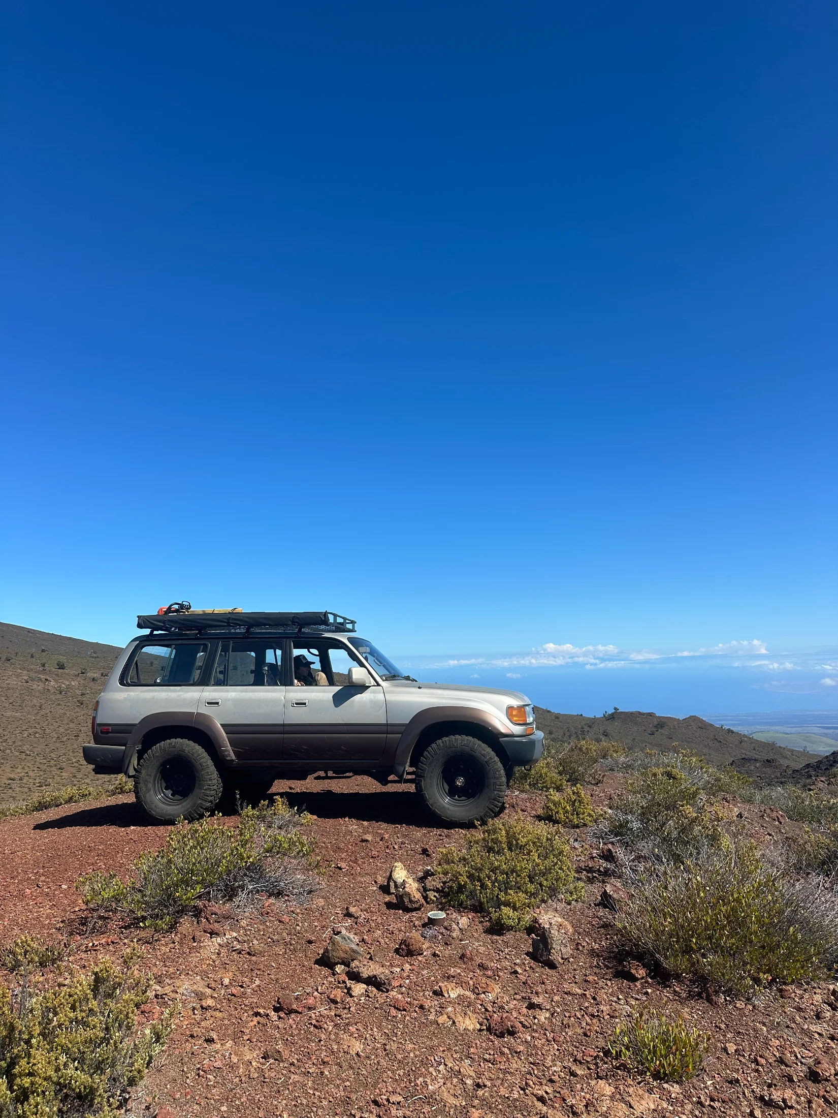

I have a '92 with a 3fe, 230k miles.
Mods: Desmogged
35" tires
Rear locker
3" OME lift
Got her set up for camping for two, aluminum roof rack, sleeping in the back - need some good mattress recs for the back area.
Located on the Big Island, if there's anyone on here located on island HMU!
Not unhappy with the power that she has, all the 3fe hate seems misguided and snobby.

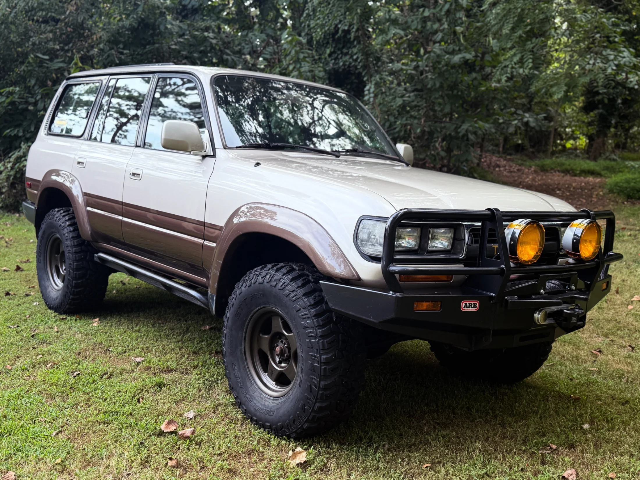

Nice looking rig. FWIW, I am running 315’s & 4.88 gears- speedo is pretty spot-on, & am very happy with the combo. Would love to copy @Marco Lau with equipment setup.
Time and money… 😥🤟
Nice dude, got to be one of the best color combos done by Toyota. Nice front bar set up too, I'm planning to do the same to mine soon.
