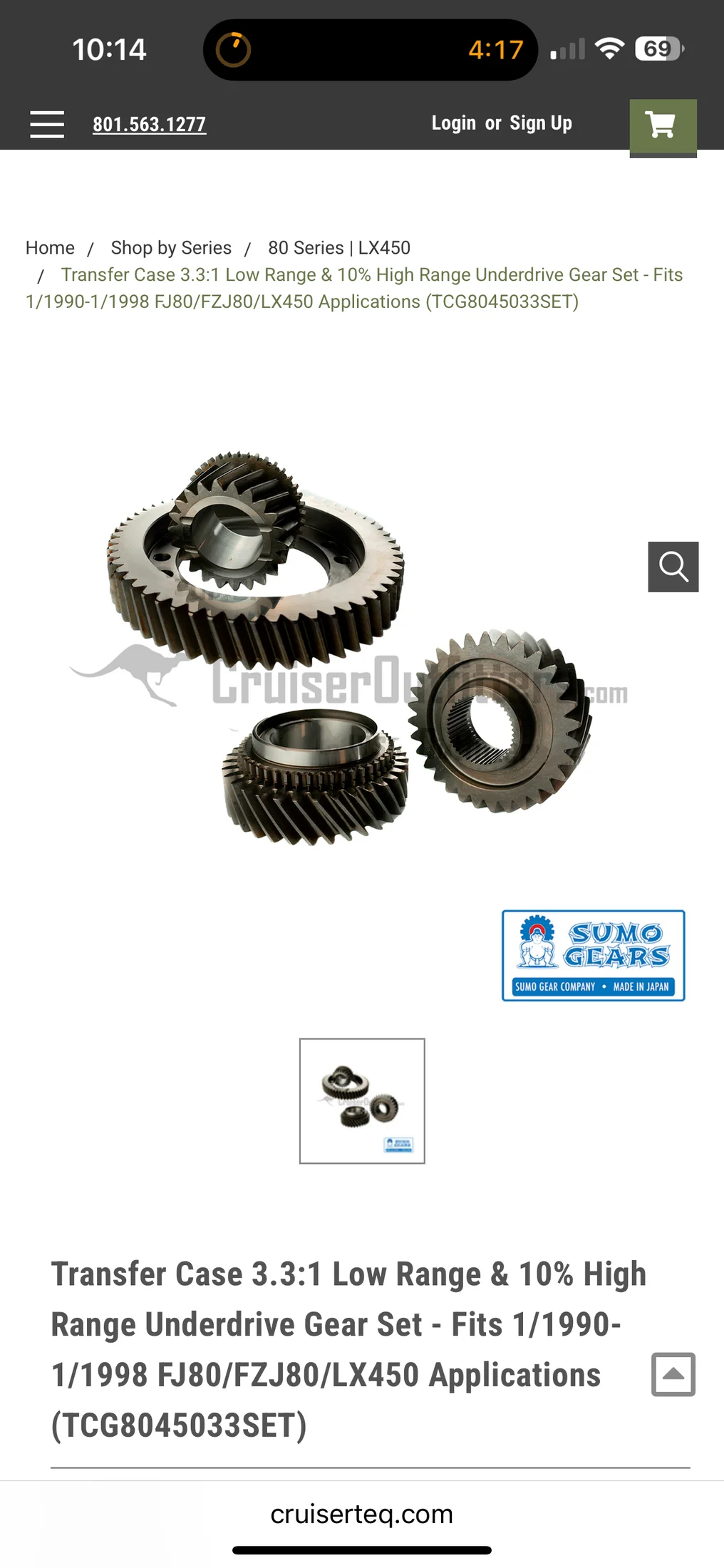

What would your recommendation be for regearing the transfer case? Thanks

As far as I know there is only one gearset for transfer cases, oem low range is 2.49:1 and the reduction gearset takes it to 3.11:1 which is a 25% reduction. I've read on the forums that this is about the same a 4.56 gears in the diffs. The hf2a is a simple thing, gear driven and relatively easy to work on. I didn't do the high range gear, but I should have.
I did the Sumo low range and part time at the same time on top of the 4.88 gearing in my 3rd. This combo is perhaps the best upgrade for regearing close to 5.29 with the strength of the 4.88 gear.

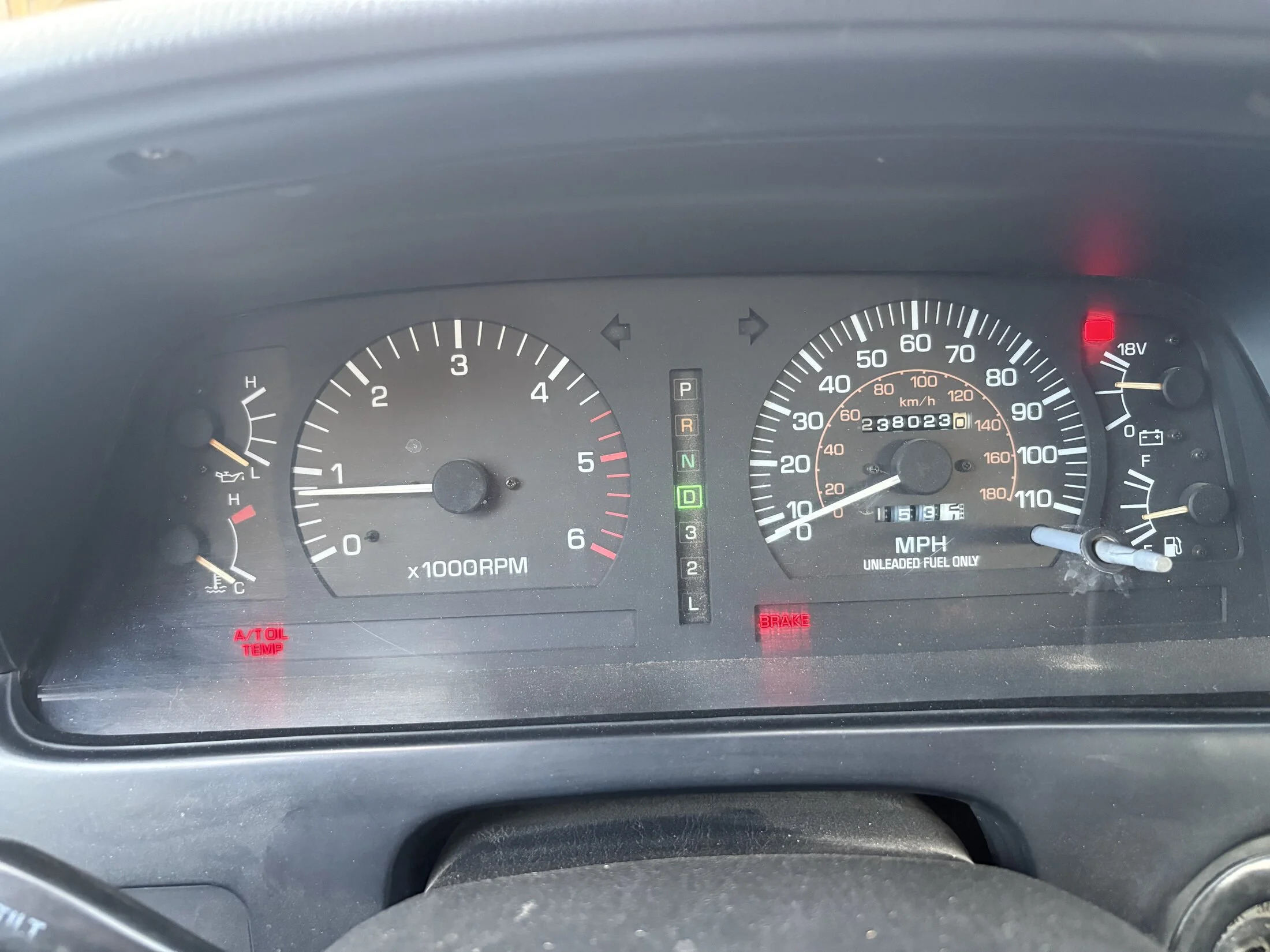

Brake is not on, vehicle just started… wiring?flashing on and off as I drive. Very intermittent.
Where should I start looking for a loose connection if it is electrical?
These are 3 of the 4 lights that come on when I turn the key to acc but havent started it yet, the last one being check engine light which on mine was burned out. Before I replaced it it looked like this. Maybe the truck doesnt know its on yet for some reason

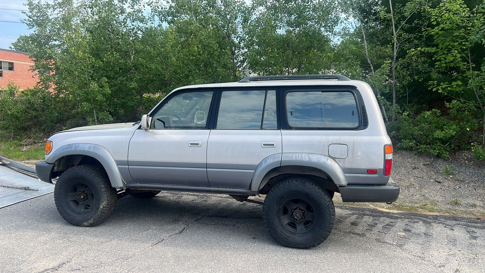

I just became the owner of a 92 LC. Currently in he process of removing the radiator, repacing the head gasket and wil be doing a de-smog. 156k miles. The previous owner let the LC slide on maintainence for a while. I'll be catching that up over the next several months. Then plan on a 2 to 3 in lift. and I want to install a part time kit with locking hubs also.

Welcome. That is a fine looking 92

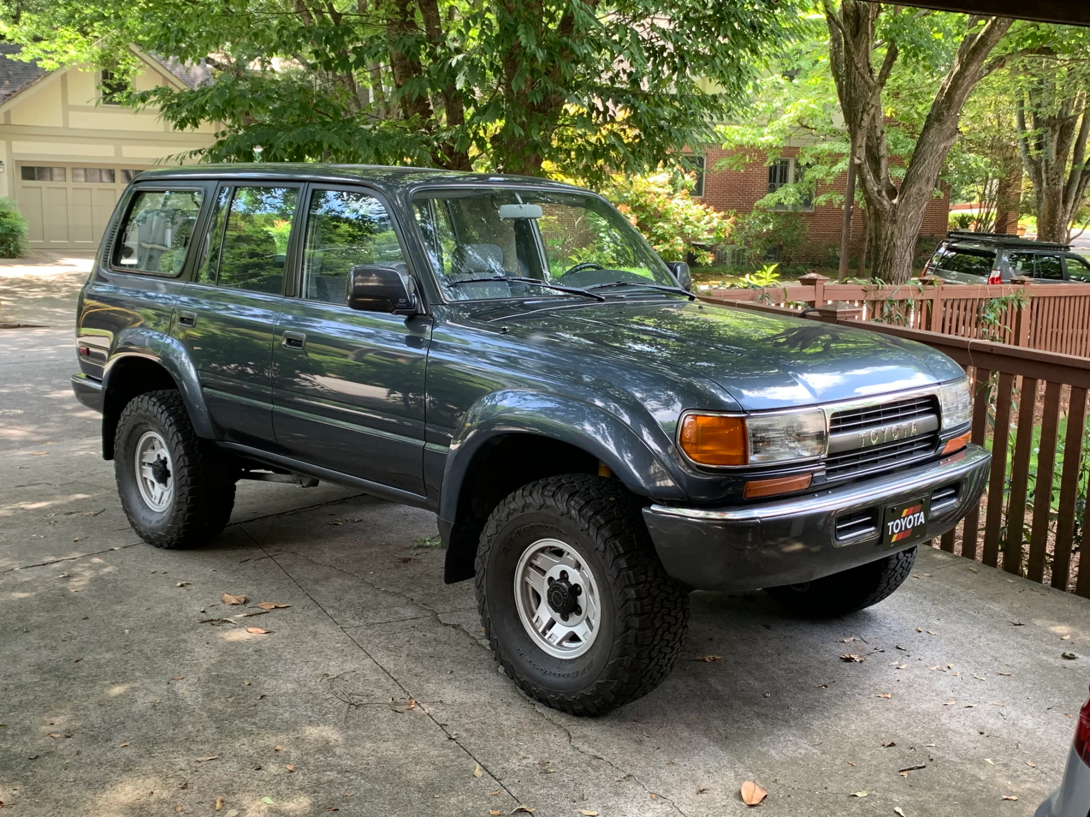

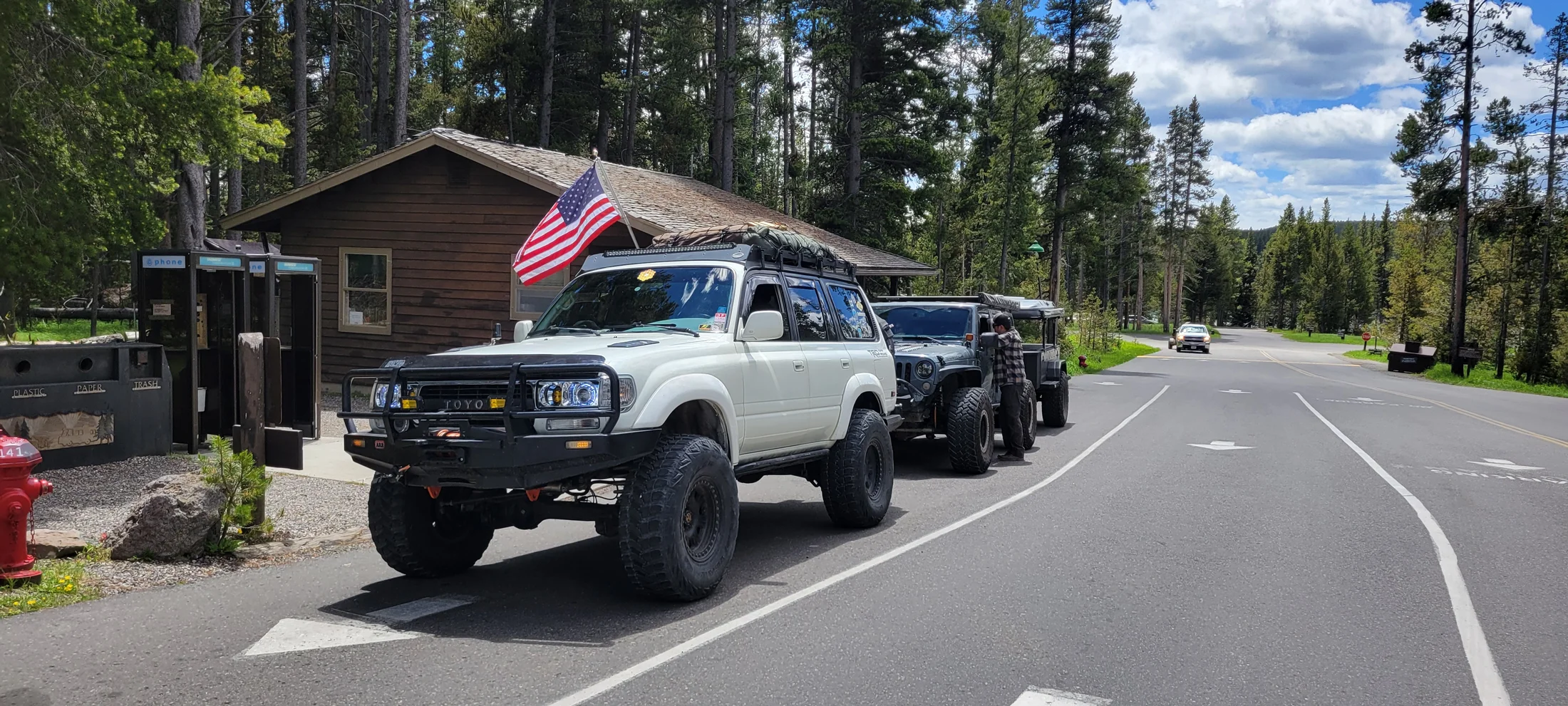

My 92 with a 3.5" lift and part time kit.

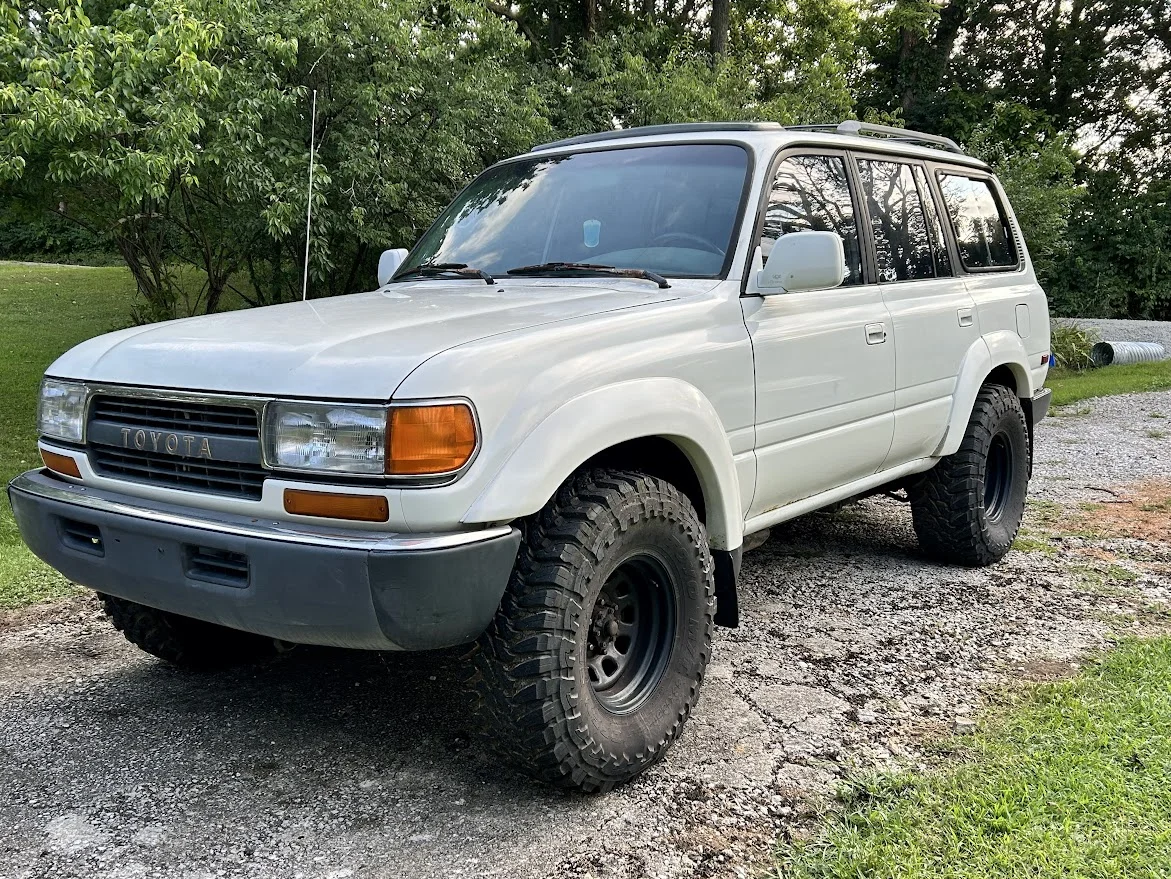

My (now sold) 92- miss it, sniff, sniff

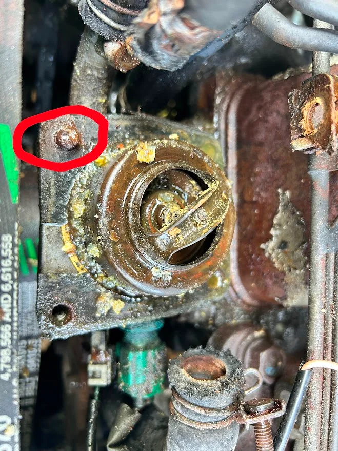

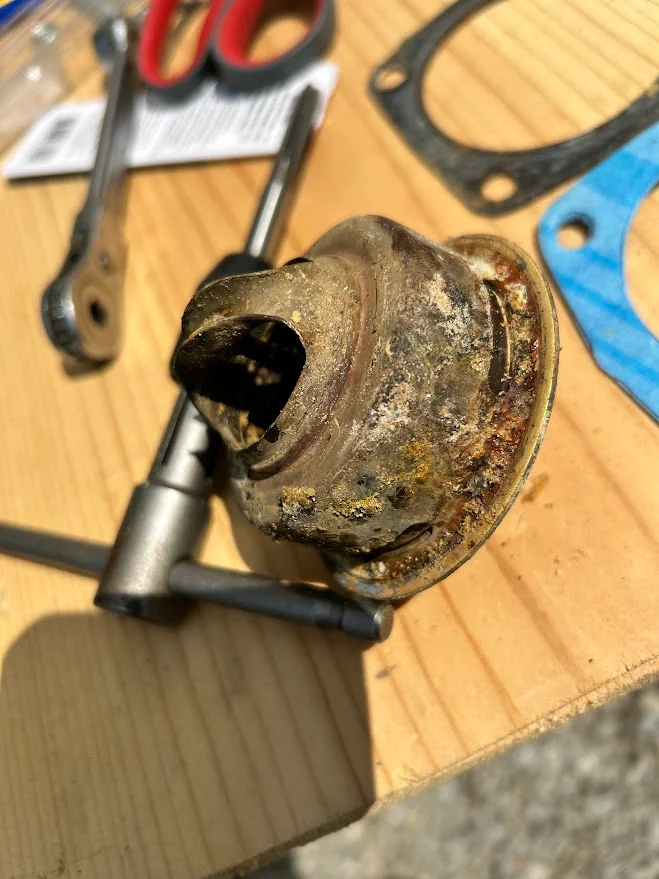

After chuch, I decided to drain the coolant, remove the thermostat and do a flush or two on the cooling system.
You know what they say about a 30 minute job? All is well until you break off a bolt. Also I found a mess. Spent all afternoon cleaning a flushing. I started with a CLR, ran the engine for 15 minutes. Drained, flushed. Then 3 more flush cycles using mixture of TIDE / Borax. I added a 50/50 mix of green anti freeze.
The broken bolt. I attempted to weld a nut on the "nub" 4 times, no go. Had to go to NAPA to get a Tap. Drilled it out, picked out the pieces of the bolt, then re-tapped the hole. Turned out good. Had to use a hardware store bolt for now. I'll order 4 new bolts for long term. It's all got to come out anyway when the head comes off.
