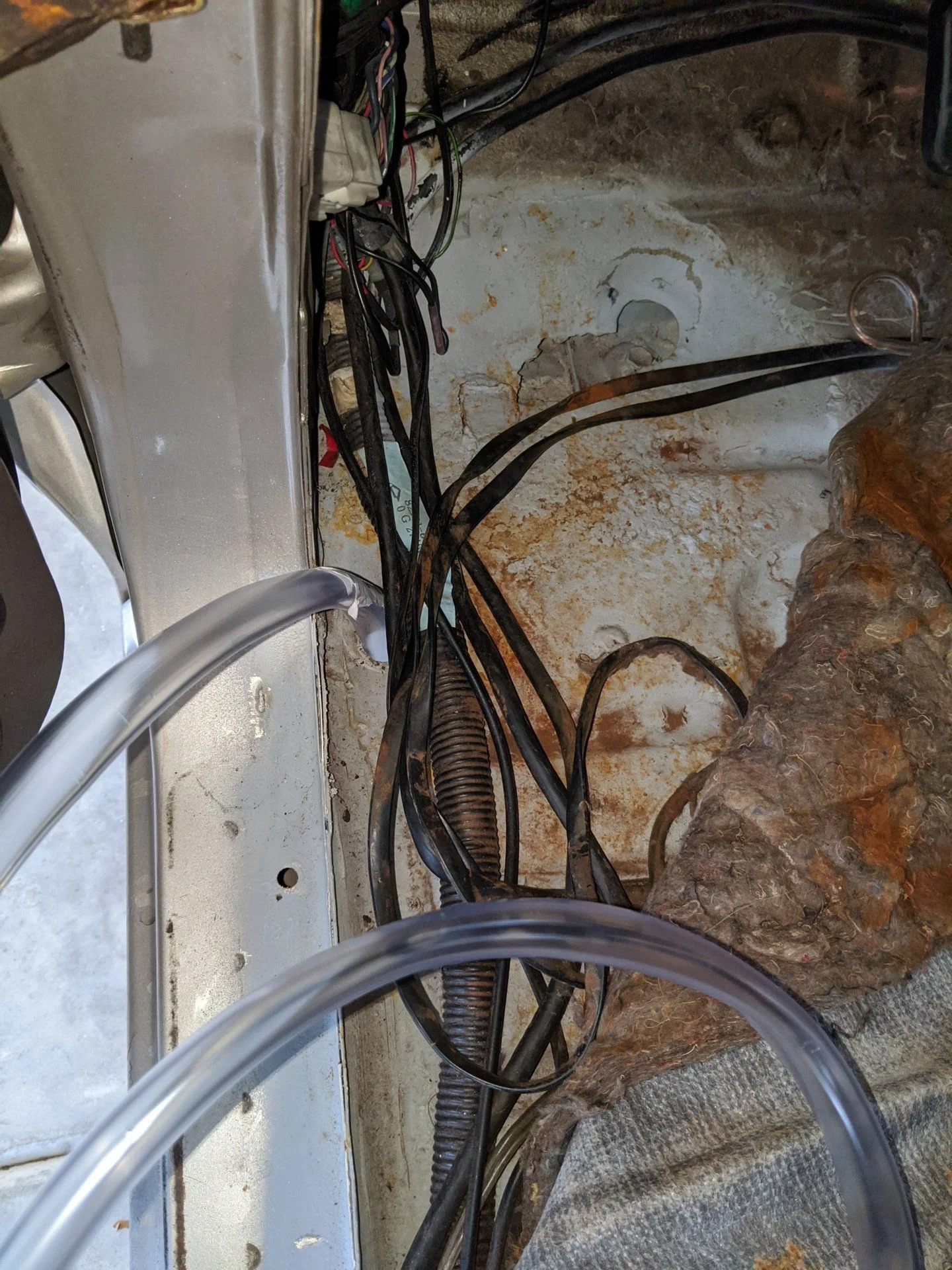

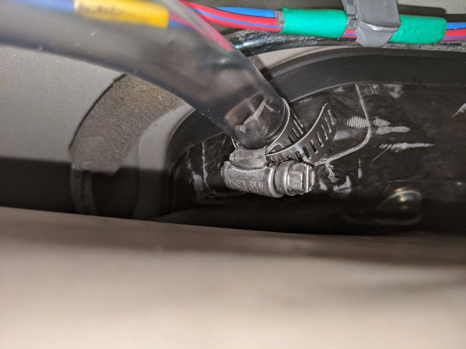

Also, big news!! Found the reason the sunroof was leaking, took matters into my own hands, pulled back the headliner just enough and found a missing drain line. In its place someone had shoved a earplug and duck taped it in. Fashioned a new drain line and perfecto. Sunroof, leak all good!

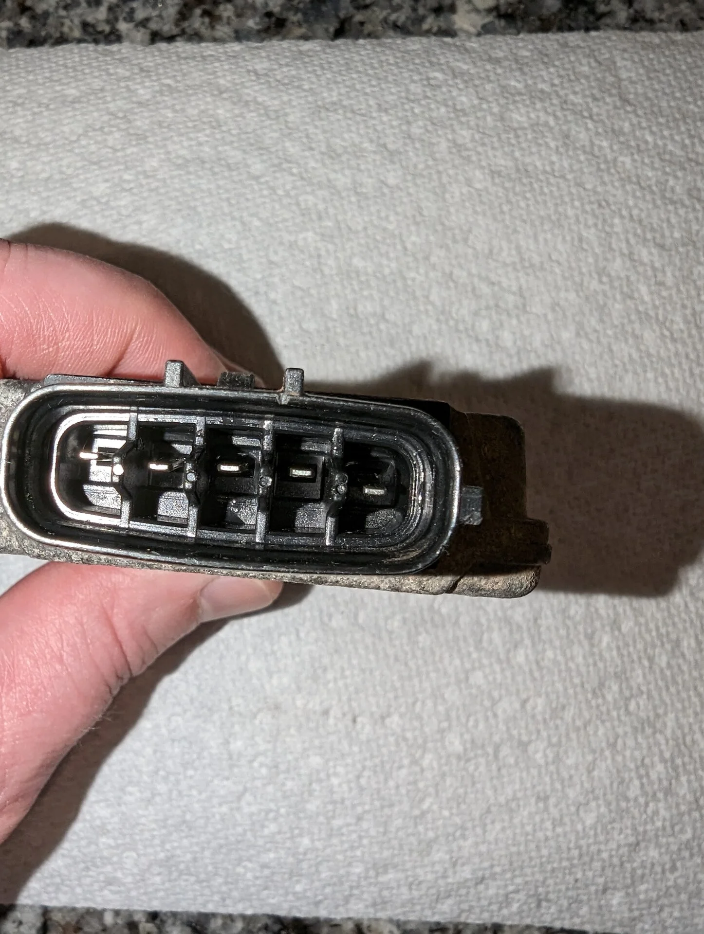

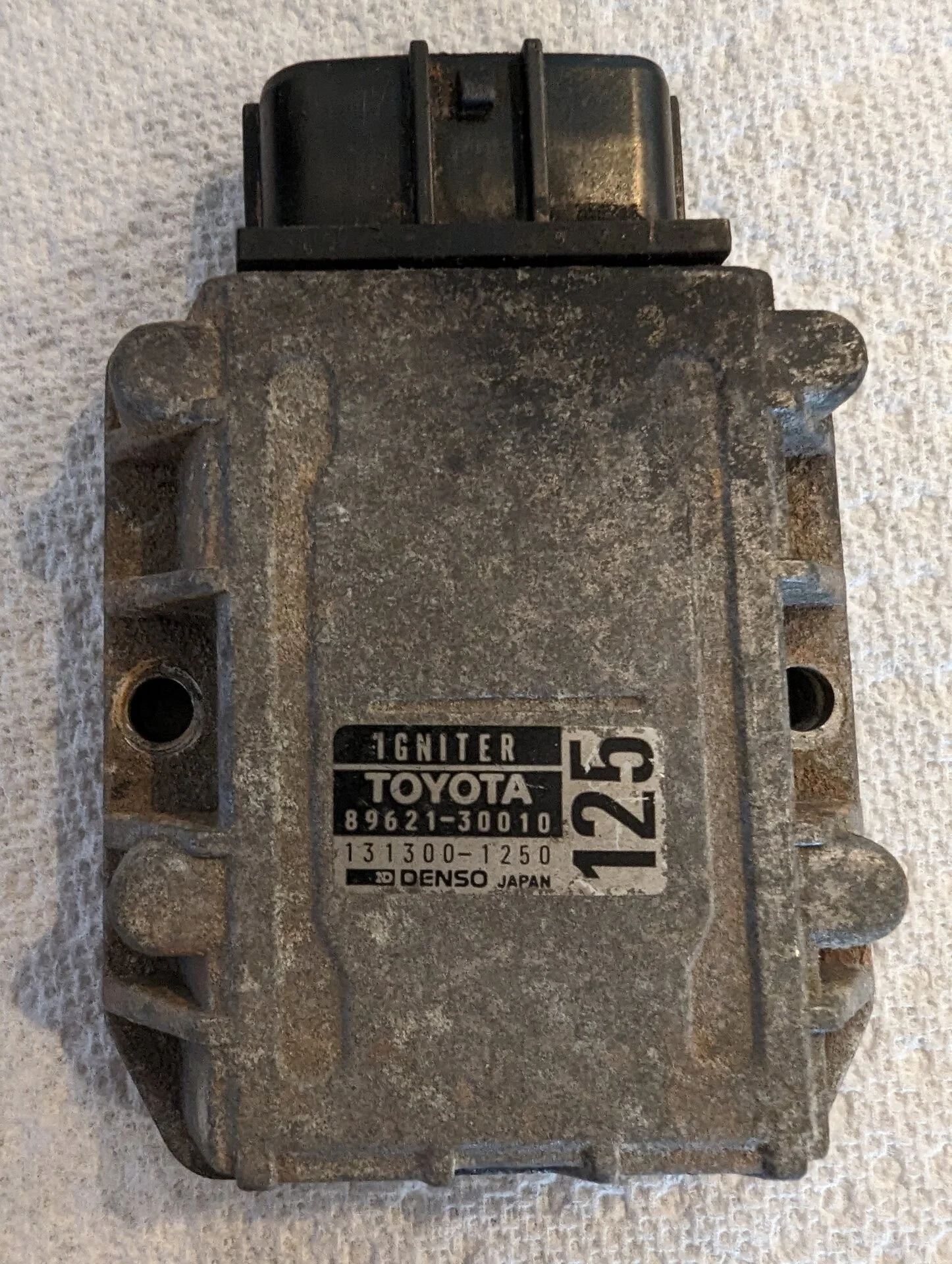

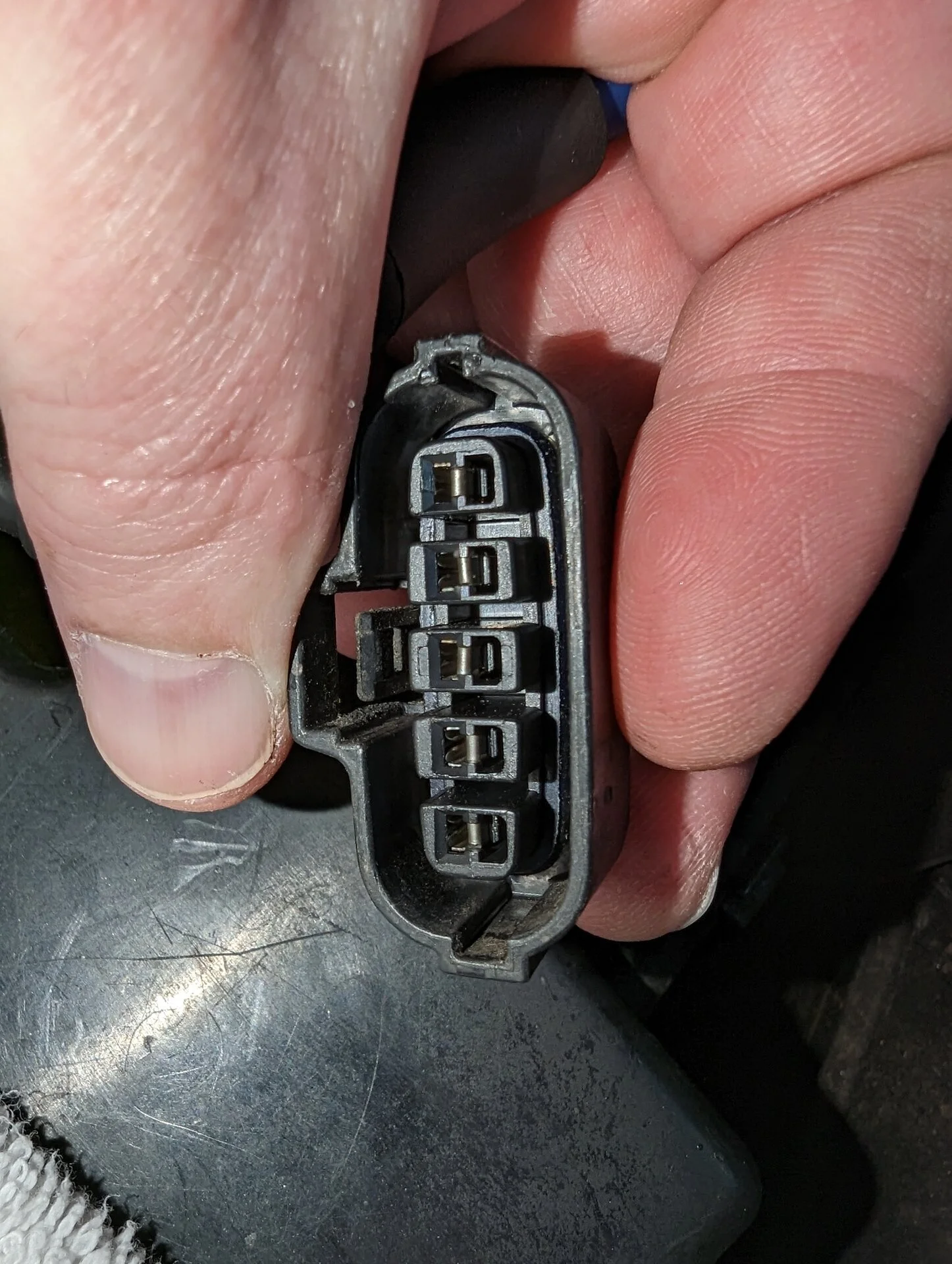

Soo here's my lastest and greatest. Everything's been great expect the igniter module stops working when it gets hot. The parts listed as replacements and the interwebs are nothing but lies, fakes, or phonies. Tried a couple and the distributor got zero on the meter. So I figured, works when cold not when hot (IE engine bay is hot, will not start) so @orion suggested resistance, which I totally concur. Pulled the part, cleaned wire connection and igniter put it back together and now even cold it will not work. Meter coming off the coil doesn't even budge. Assuming it's the igniter module and not the wiring harness, does anyone know where I can find one? Cruiser Corp and a few others all said no go or didn't even call me back. Does anyone see anything out of place here? I know I might have bent a couple of the connectors cleaning. I bent them back straight before I put it back together. Thanks y'all!
