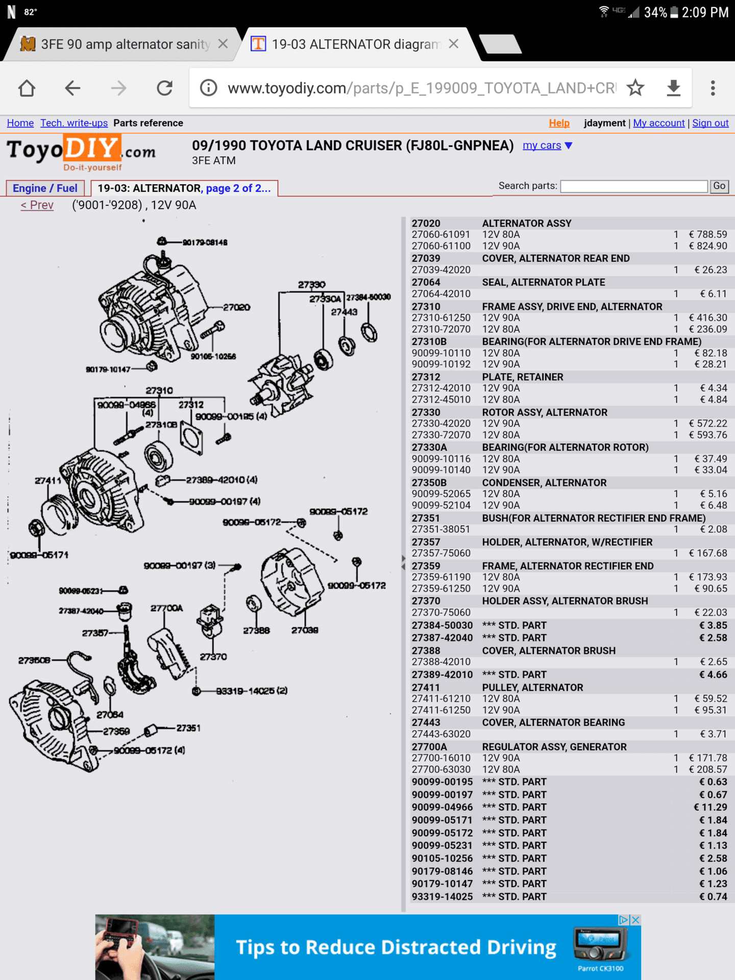

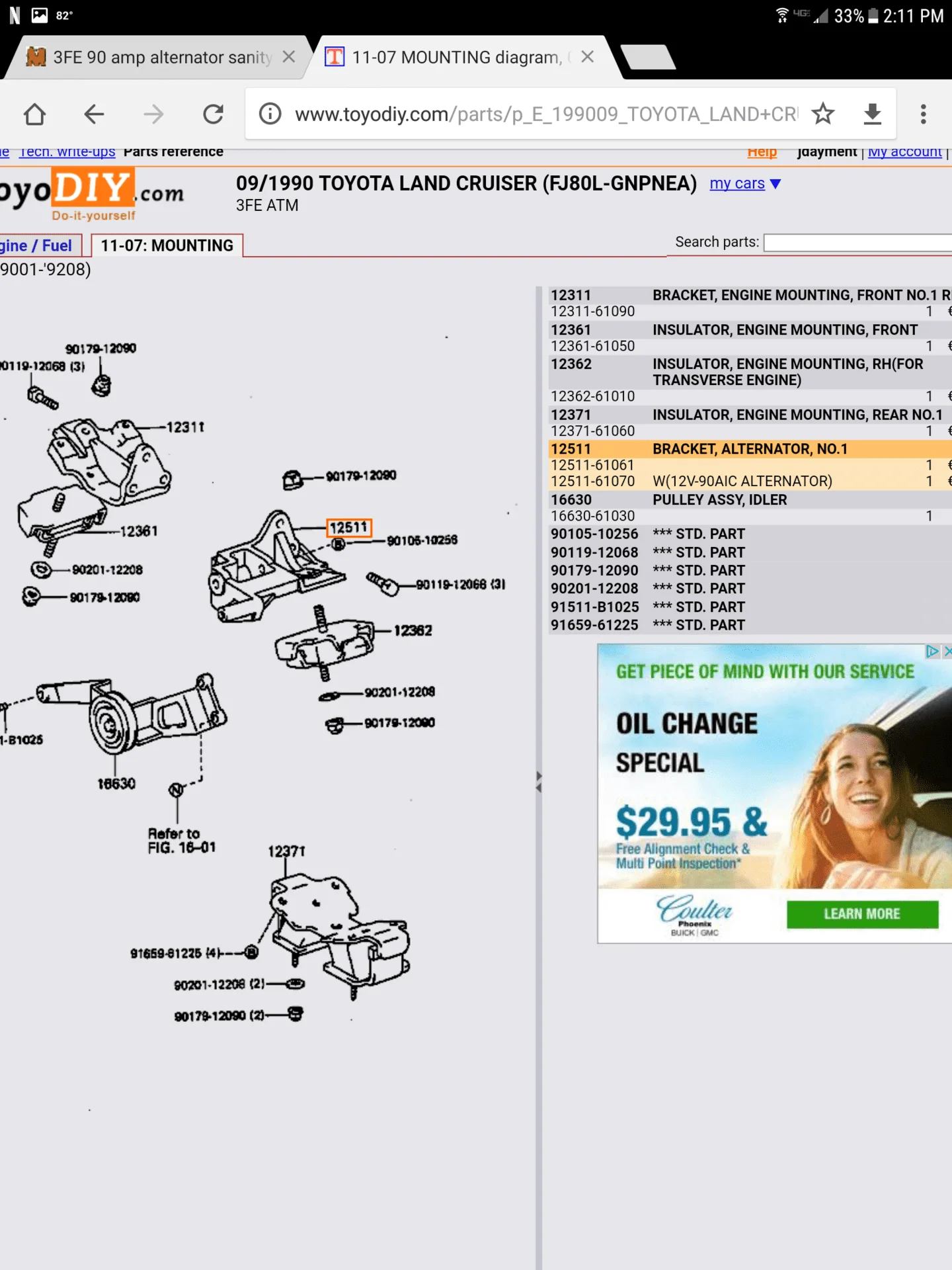

I was wondering the same thing saw this pop up as well. There is a Toyota part number for a 90 amp for the 3FE there is also a separate part number for the 90 amp bracket here they are.

Modifying the mounting ear on the 90 amp isn't technically hard, but you have to make sure the contact faces on both the mounting ears sit flush against the mount or you can crack the modified ear as the earlier posts indicate.

To be clear, all US spec 1991 FJ80s had an 80 amp alternator with an external fan. This carried over into many 1992 US spec FJ80s, but at some point the US spec changed to a 90 amp unit with an internal fan. The mounts are different between the 2 units so this is not a direct bolt in "upgrade". Personally, I never had the need or desire to go down this road, but that's me.
One issue, if you only want to use OEM/DENSO parts, is the standard 3FE 80amp alternator is discontinued I believe. Only the 90 amp survives.
