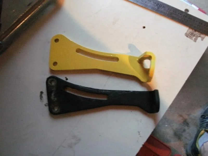

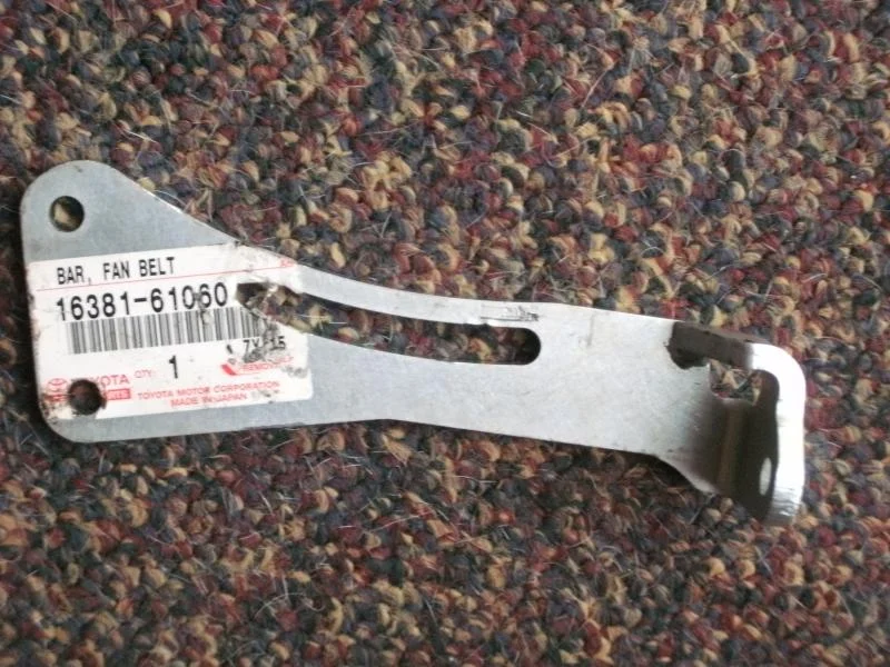

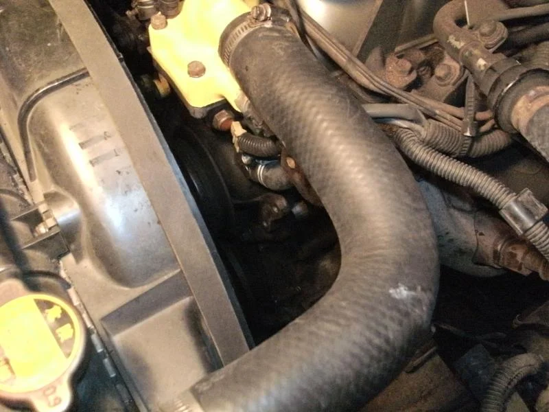

So I have the $21.07 bracket from the dealer, this bracket is for the 90 amp alternator, and the part number is 16381-61060. As you can see from the first pictures, the bracket is slightly different from the original one used with the 80 amp alt. However, I still could not get the 90 amp alternator to fit at the lower mounting point. This mounting point is part of the DS engine mount, so is there also a different engine mount used for the 90 amp?
Has anyone successfully bolted on the 90 amp(part number 27060-61100-84) without grinding the alt. to fit? Try as I might, I couldn't find the hole and get the bolt in. In the end I just put the 18 year old cruddy 80 amp alt back in and put everything back together. I think when I try to replace the water pump, I'll give the new alt. another try, since there will be a lot more room to work in and inspect/see whats going on, and where to grind.

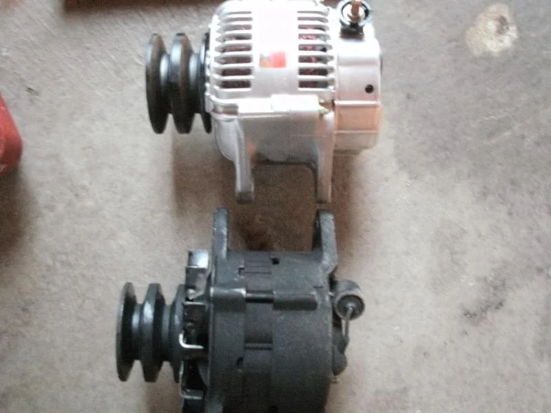

Some more pics.
The first one shows where the new bracket bolts on, but this isn't the problem.

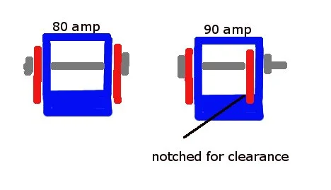

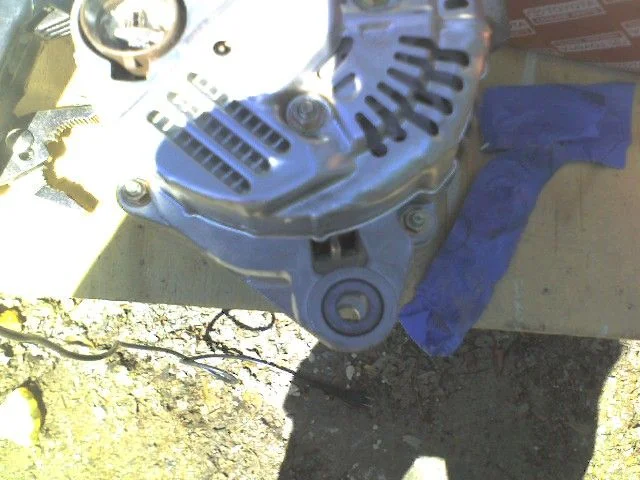

The second pic shows the difference in the 80 amp and 90 amp lower mounting points.
I have wondered what the different bracket really was, that will fit a little better once you grind the tab and bolt it in, but the original works fine too. IIRC the bottom mounting point was part of the engine mount or something substantial. I would just go ahead and grind it, it is very easy. Just put masking tape over the openings in the alternator to keep the shavings out.

Something I forgot to mention in the other thread...
If you put the 90 amp in place and wiggle it around trying to get it to seat, the bracket in the truck will scratch the mounting tab on the alternator so you can see exactly where you need to grind it. the hole in the wiring connector has to be enlarged a little bit also.

I don't have any detailed pics, it is difficult to get a good picture of the alternator in the truck. You can't get replacement brushes for the stock 80 amp. It is easy to tell the difference, external fan - 80 amp. Internal fan - aftermarket replacement(most likely) or 90 amp.

I only ordered the 90 amp because I thought that was what I had to begin with. Since I had it and needed to drive the truck I ground the tab and bolted it in. It is not a lot of effort really, but I think you are right that it is not a huge upgrade. It would be interesting to see what the 90 amp actually puts out if the 80 amp puts out 86, I would assume it would be over 90. The 90 amp is noticeably larger than the 80 amp. d

16381-61060 Fan belt adjuster bar (List $25)

I think I'll follow in Bhmmapping footsteps and use the grinder on the alternators soft aluminum housing. I forgot to shoot a picture of the two alt. with their front mounting tabs lined up. When I did this, it appeared that the belts chanels lined up. Is that the case with yours Bhmmapping, when mounted the belts all line up? Thanks for the picture of your ground alt, I could practically print it out and tape it to mine and grind away.

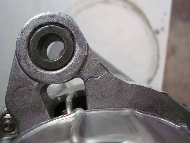

So everything was going well, had the alt ground and fitted, adjusted the belt, went to tighten the lower alt bolt, and snapped the alt housing. Basically just took $300 and tossed it out the window. The housing/mount/bolt weren't even all the way tight yet.
So ticked off at myself for being a complete failure, was looking forward to putting 90 amped in my sig line. Now? Any ideas at fixing this one. Should I say screw it and just put it back in and bolt her up? Most of it is still together and may hold but I hate to think what would happen if the alt broke loose. Should I put the 80 amp back in and hope it lasts another 18 years, even though its been giving me the lights for 2 years now? Duck tape it, Jb weld, my smith and wesson 500 mag and a bottle of jack? AAAAAHHHHHHHH:bang:

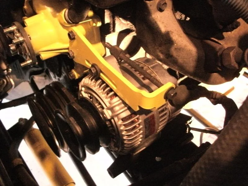

90 amped
So, with not a whole lot of input, I decided to just bolt it back in and fire the 90 amped meat wagon up. All is fine, the belts line up, putting out great voltage at idle. Its a success for now, and hopefully it will stay that way.
When adjusting the amp to fit, I also loosened up the mount that is attached to the water pump on one end and the adjusting bar(part # 16381-61060) on the other end. I also left the adjusting bar slightly loose giving me more play, bolted it to the amp, then snugged everything up. The alt is adjustable, and its a done deal for now. Thanks again bhmmapping for the template.
