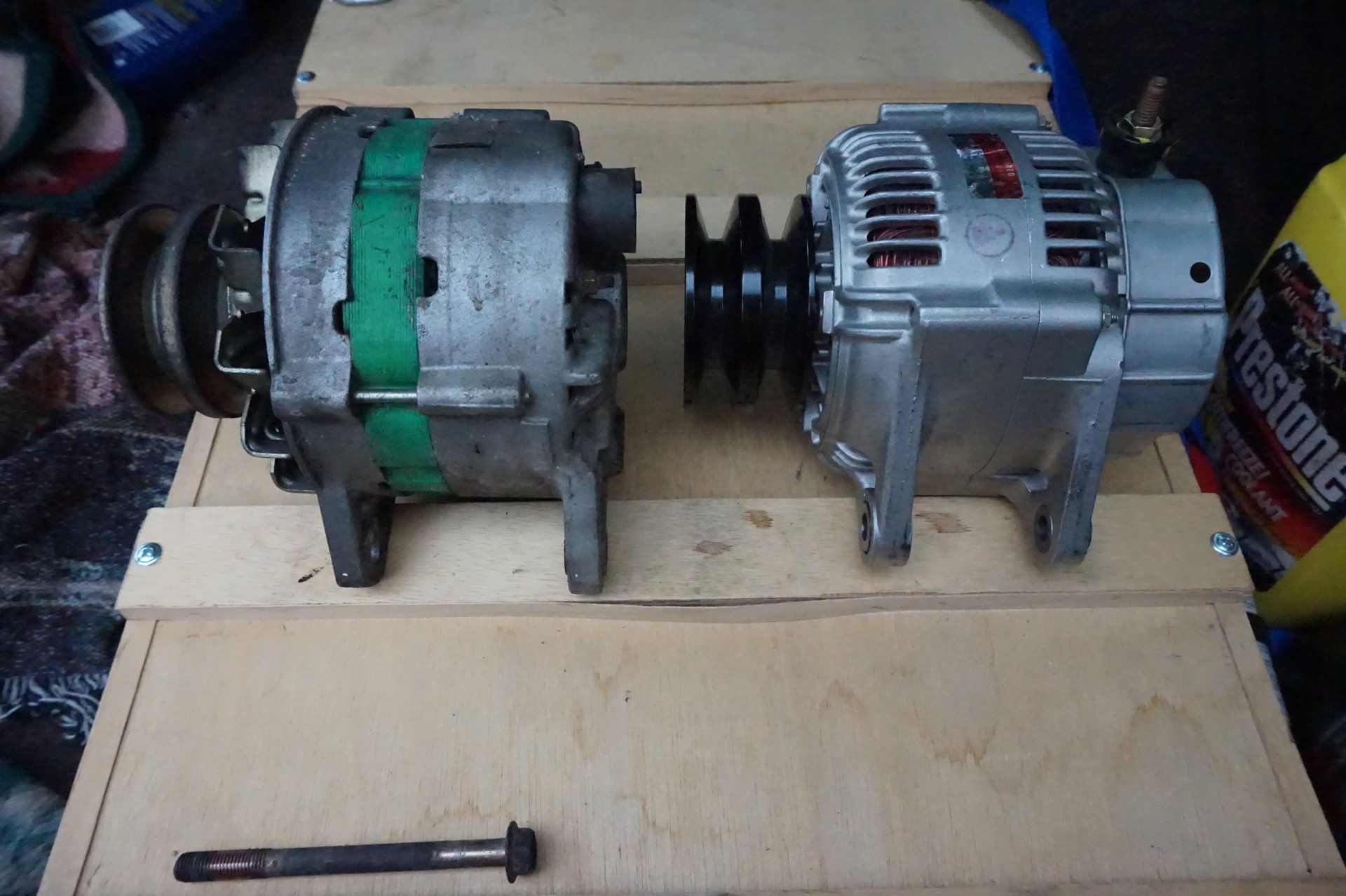

The 90 amp alternator is on the right and the 80 amp is on the left.

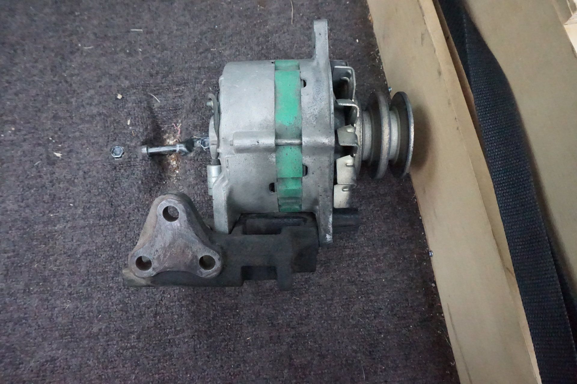

Here is a picture of the 80 amp alternator and the engine mount out of the vehicle to give you and idea of what needs to be changed.

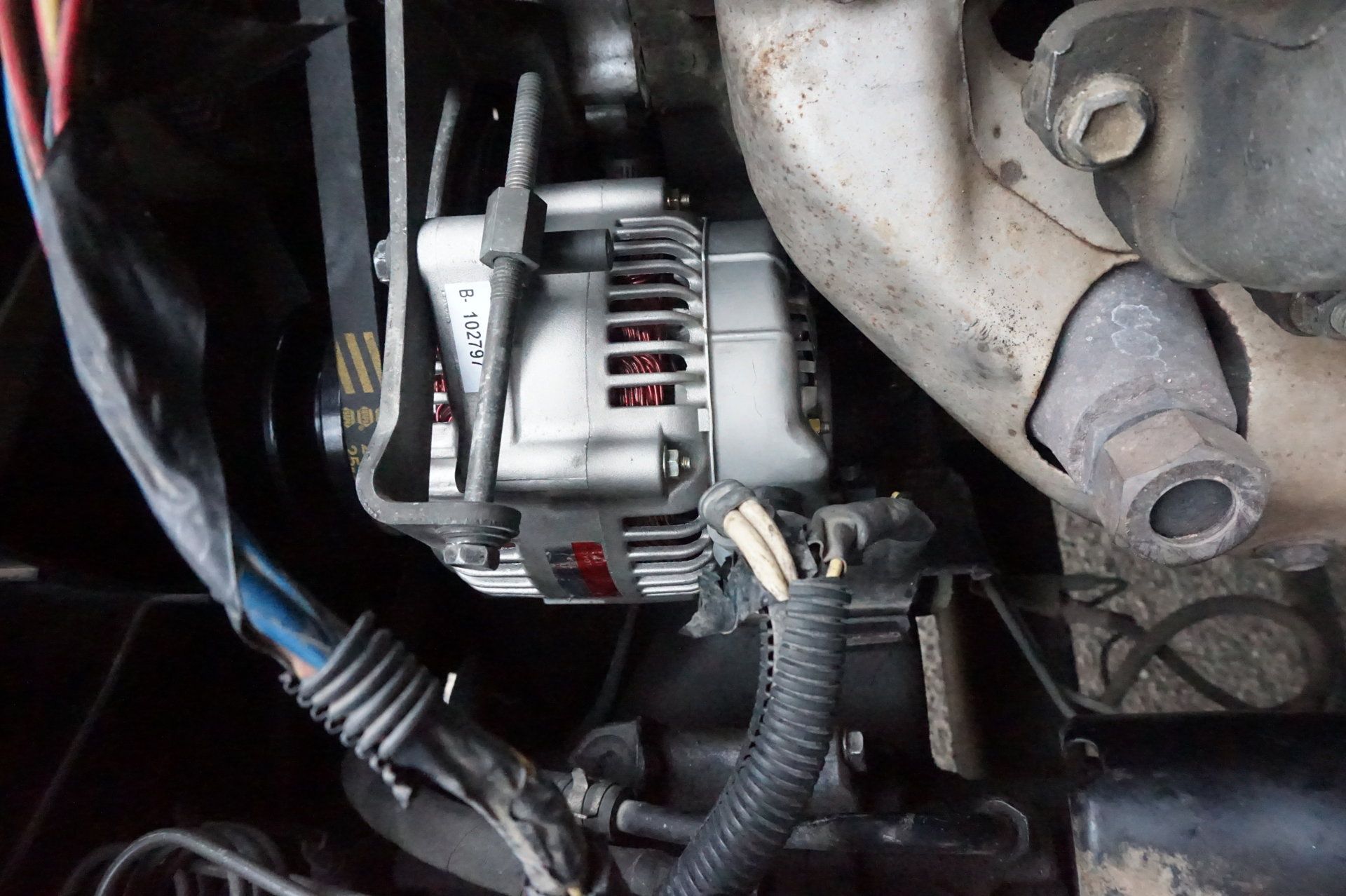

This last picture is a 90 amp in the truck.

The 90 amp alternator is on the right and the 80 amp is on the left.View attachment 1575026
Here is a picture of the 80 amp alternator and the engine mount out of the vehicle to give you and idea of what needs to be changed.View attachment 1575027

I'm not sure if anyone needs this, but here is a picture of the 80 amp mount. To change them out you will need to remover three 17mm bolts and one 17mm nut.
