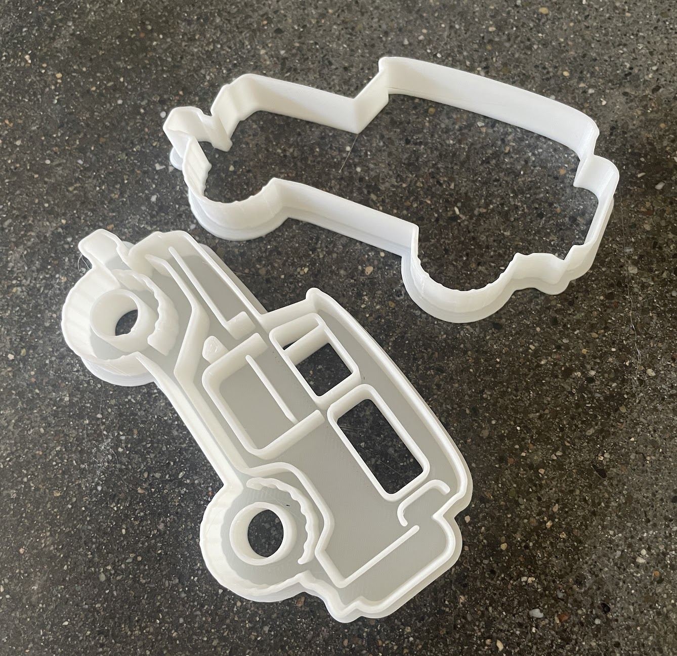

Cookie Cutters:
Files:
I haven't tried these yet, But the outline only one should work with no problem. Detailed ones I'm not sure about.

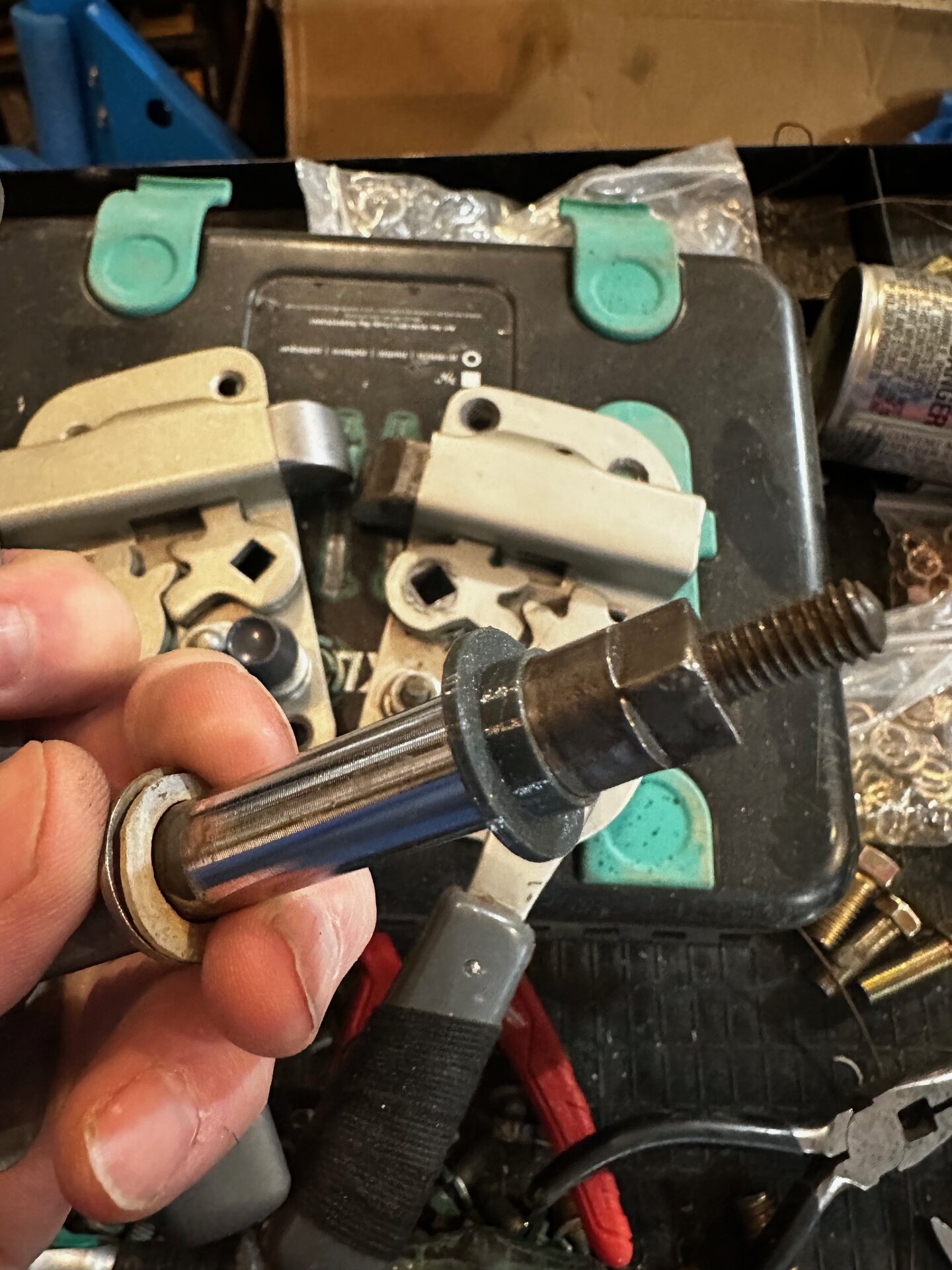

Printed door handle grommet to eliminate movement of the handle. My assumption is that over the years the handle and the hole through the door gets worn from use.
Handle shaft OD 12.1 mm
Door hole ID 13.5 mm
Printed with PETG Filament

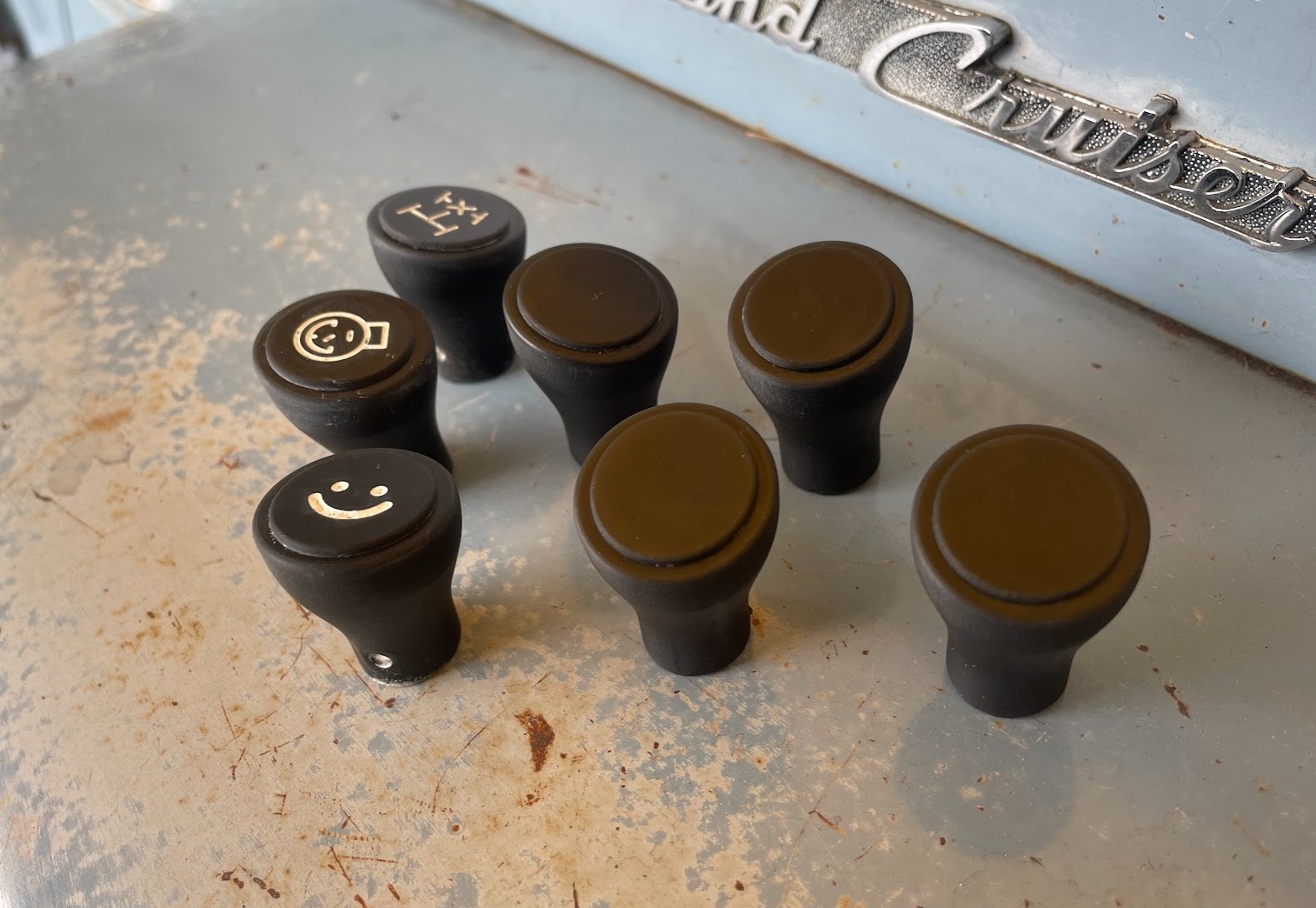

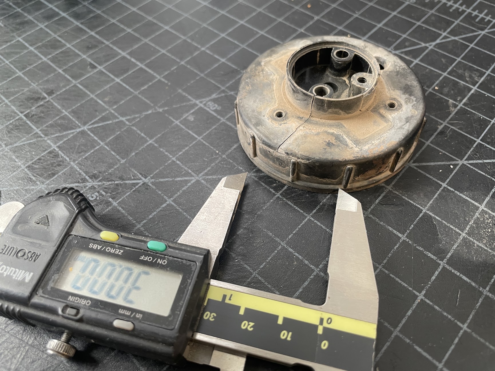

Thanks to @EWheeler I've got an early style washer cap to reference the model. Will be making a normal cap version For those who have stabbed in a replacement motor and a reproduction version for those lucky enough to have the guts of the old mechanism.
There is a gasket inside the lid. My guess is a bead of RTV silicone the channel would work.
Print the oring? I've had success with it
