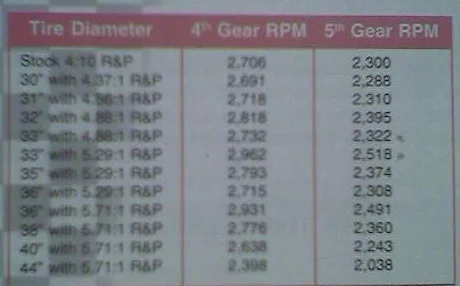

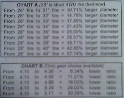

There is no way you get 7 mpg with your truck as is. I have a 350 in my fj40 with 35s. The engine is pushing 300 hp and I stay on it a lot. I get 9mpg at least.
Are you converting the mileage due to your oversize tires? FYI, if you don't have the speedometer corrected for larger tires, when the odometer says that you have gone 100 miles, you have actually driven more than 100 miles.
fyi- my speedometer is spot on with my actual mph. and yes i have averaged it out and i get somewere around 9 or 8 mpg
I guess its the fact you dont have any solid info posted on your rig, or that you have 37's on it or what (all I could find)
But I dont buy it. :confused:
attachment.php
attachment.php
you want to dump 8 grand in your rig to get you to 38's ? :confused::confused:
whats going on here? :confused:
What diff gears do you have?
What size tires do you have?
alright i have a limited slip with from what i remember 529's in the rear. i have 37x12.5x15 superswampers with a 3.slow under the hood. i have mx-6 shoxs in the rear and an older procomp shock in the front. i also have 529's in the front differential. i have put on manual hubs, ummm what else do you wanna know? iput a warn front bumper on the front with a 6k lb warn winch. it has 6 explorer procomp lights. i changed the rear outer seals on both sides. i greased both cv's and changed the boots. i actually had to build the brackets for the warn bumper because they dont make brackets for a 3 inch body. it has a 4 inch superlift suspension and 3 inch body. i put a flex-a-light electric fan and since they don't make a complete cold air intake for it so all i have is the k&n filter. i have changed the alternator and starter and put a kinetic audio battery. i really do not think that there is anything else i can tell you about it other that the audio that is inside of it but thats just irrelivant.
