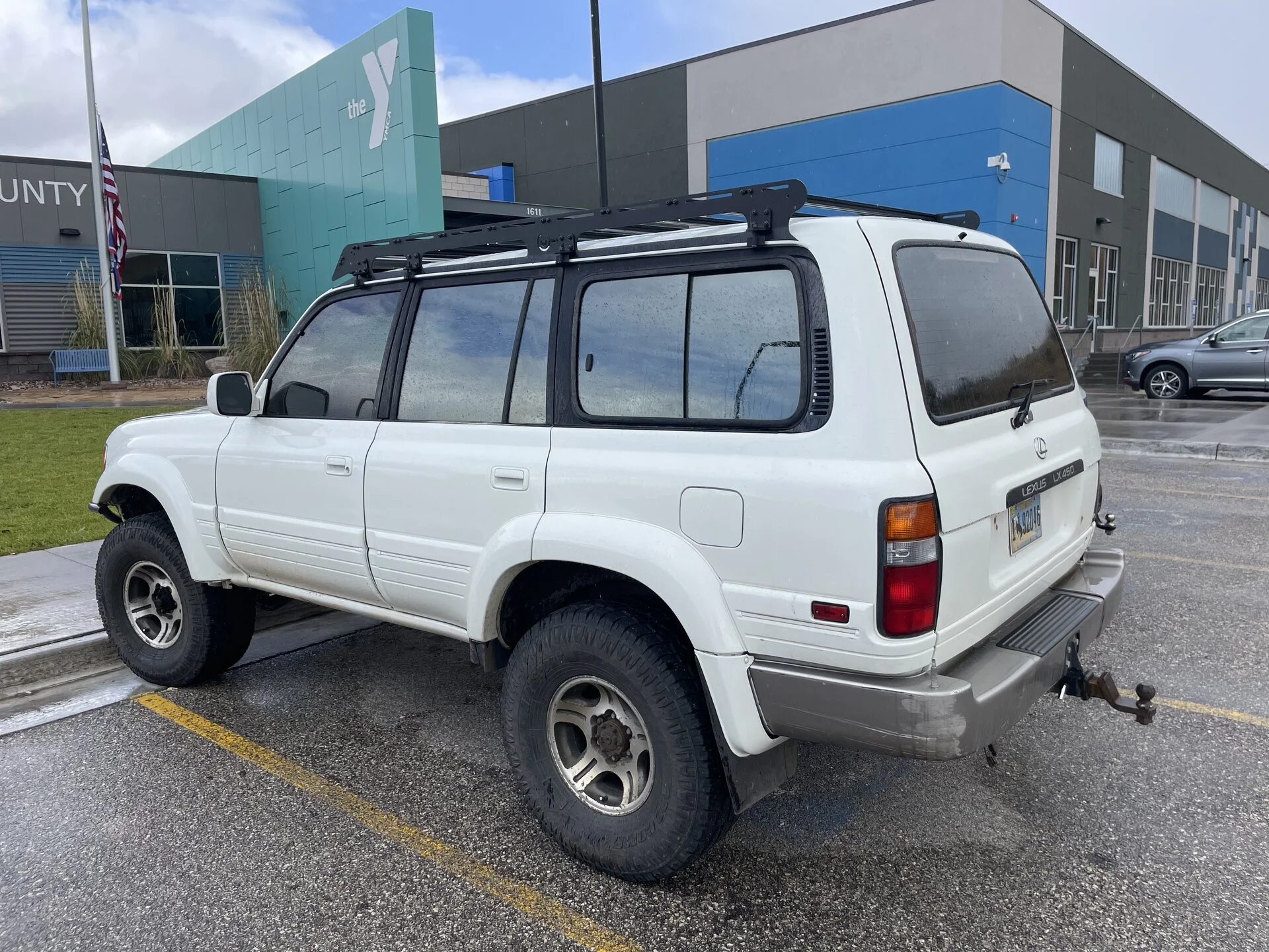

I can’t really find any snow tires for 16 inch rim. At least none that are the size that I want. Currently I’m running 315/75 r16.
I think running a standard size tire with a lift would look kind of strange. I put in some pictures for reference. Am I gonna have to import some from Sweden or something?
You may have to go with a 33” or add studs to a studdable AT like the General Grabber ATx. There are some good performing ATs put there (Falkens, especially) but they’re not going to perform like a true winter/snow tire. Tire selections in 16s are getting more and more limited, especially above 33”.

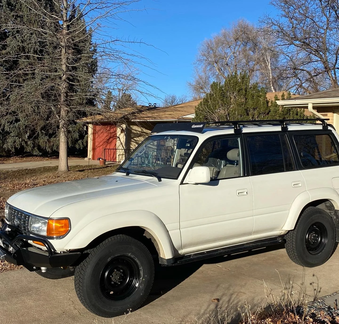

I’m going to look into the Nokian tires. I had some Blizzack dm v2 on the other cruiser, and I swear by them. Daily driver though, I want some thing with soft compound so that I can grip the snow with good sipping.
I don't think you will be disappointed if you can find them. They work so well on my commuter that I often joke that if I put them on my Cruiser or GX460 they would be completely unstoppable in the winter.
