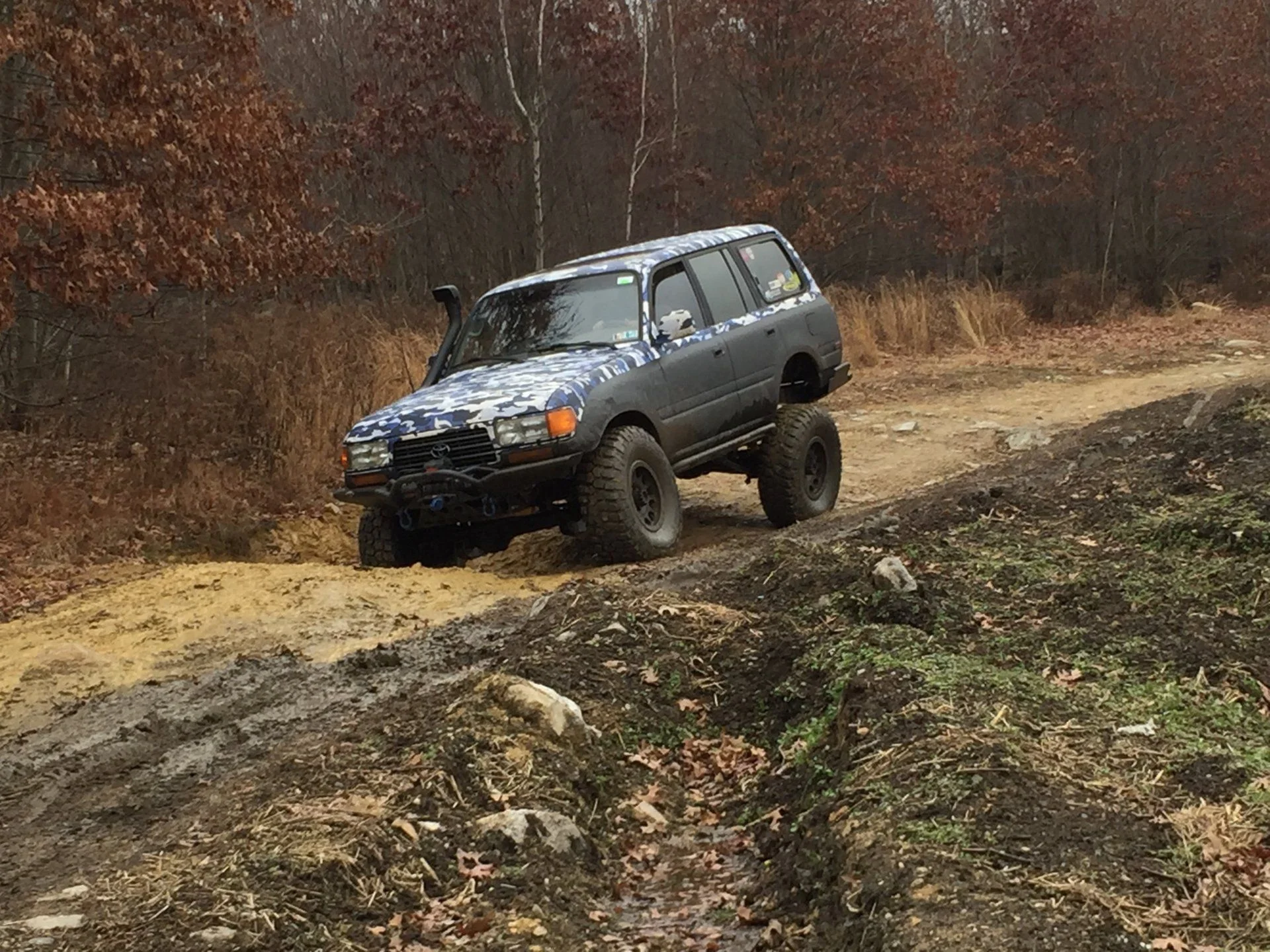

Just springs (2.5” with 1” spacers on all four corners), regular OME shocks (not L’s), 37s and no caster correction. This truck did fine at the hammers; worked a little more than mine did, but still got through everything. He also removed the front sway bar, which I’ve found isn’t as noticeable on stock radius arms as the front is using the axle housing as a sway bar (hence a lot of the cracking of mounts and housings I mentioned).
Pictured on the first waterfall on Clawhammer.
Again, mine got through everything a little easier but we were surprised at how well a barebones 80 with limited travel did.

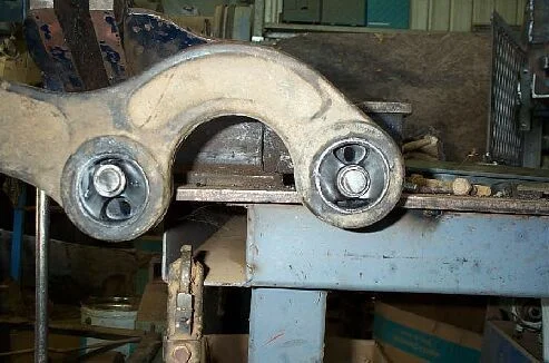

The Superflex arms work by applying more leverage to the bushings. As a result they flex easier than stock, but do still bind as any radius arm setup will.
