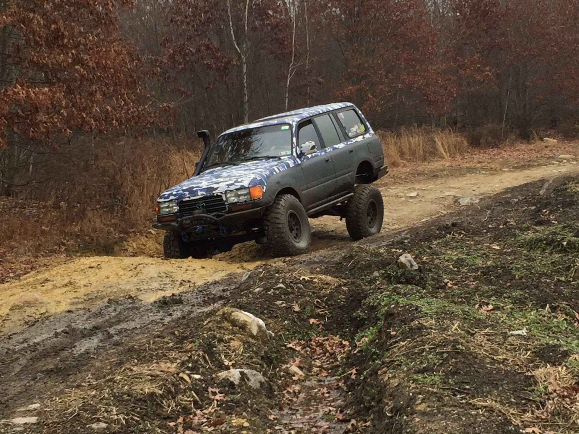

@Calidevildoc ... Come up to Rausch Creek with some of the Keystone Cruiser people and do some trails and ride in different setups (2nd Saturday of every month). I don't think anyone has a 3-linked 80 series, but you can see what trucks with lifts and different sized tires ride like and are capable of doing.
Sweet, thanks for the info. I am stationed out here on the East coast, but travel back to California a lot for work, so my Tacoma is here and my Land Cruiser is in Cali. I've taken the tacoma to Rausch plenty of times, as well as AOAA, which is a neat park as well. My Tacoma does well at Rausch, it has a 3" lift and is on 33" mud tires, but the 4x4 and rear locker helps lots.
