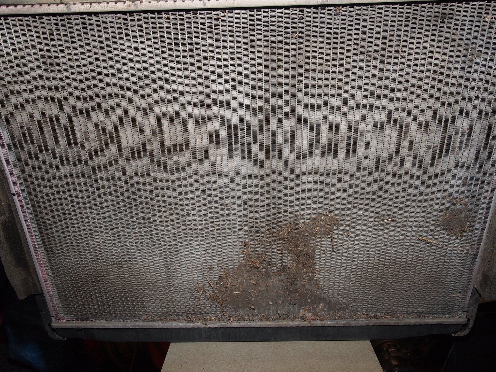

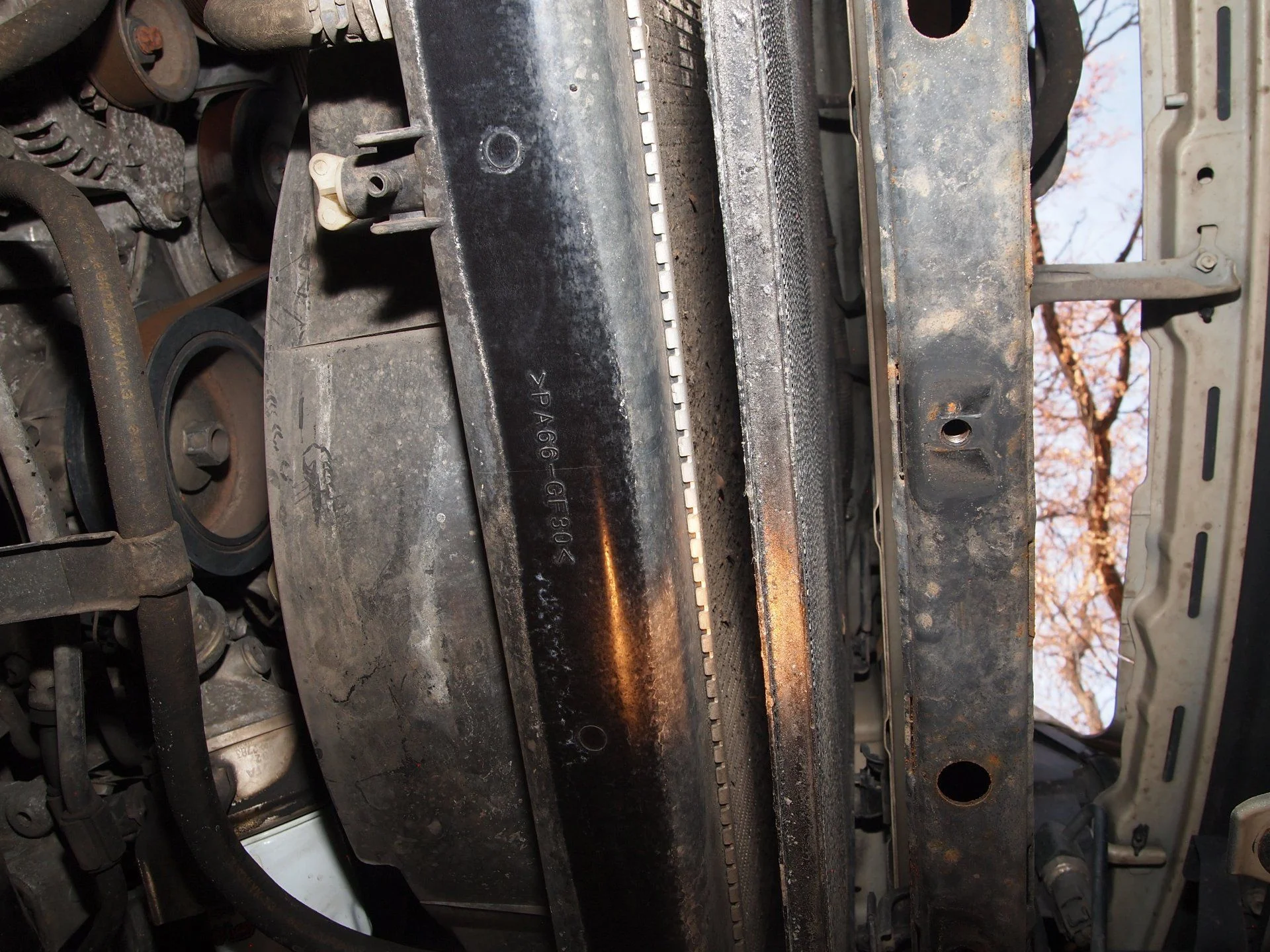

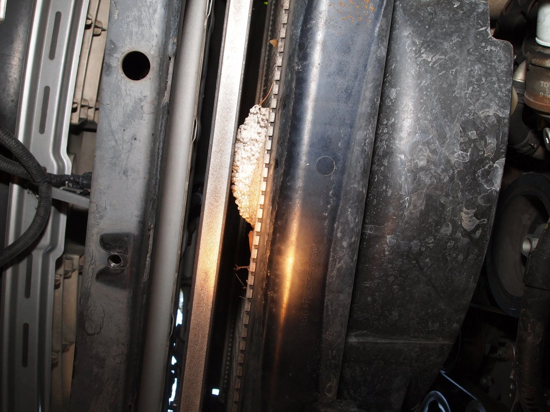

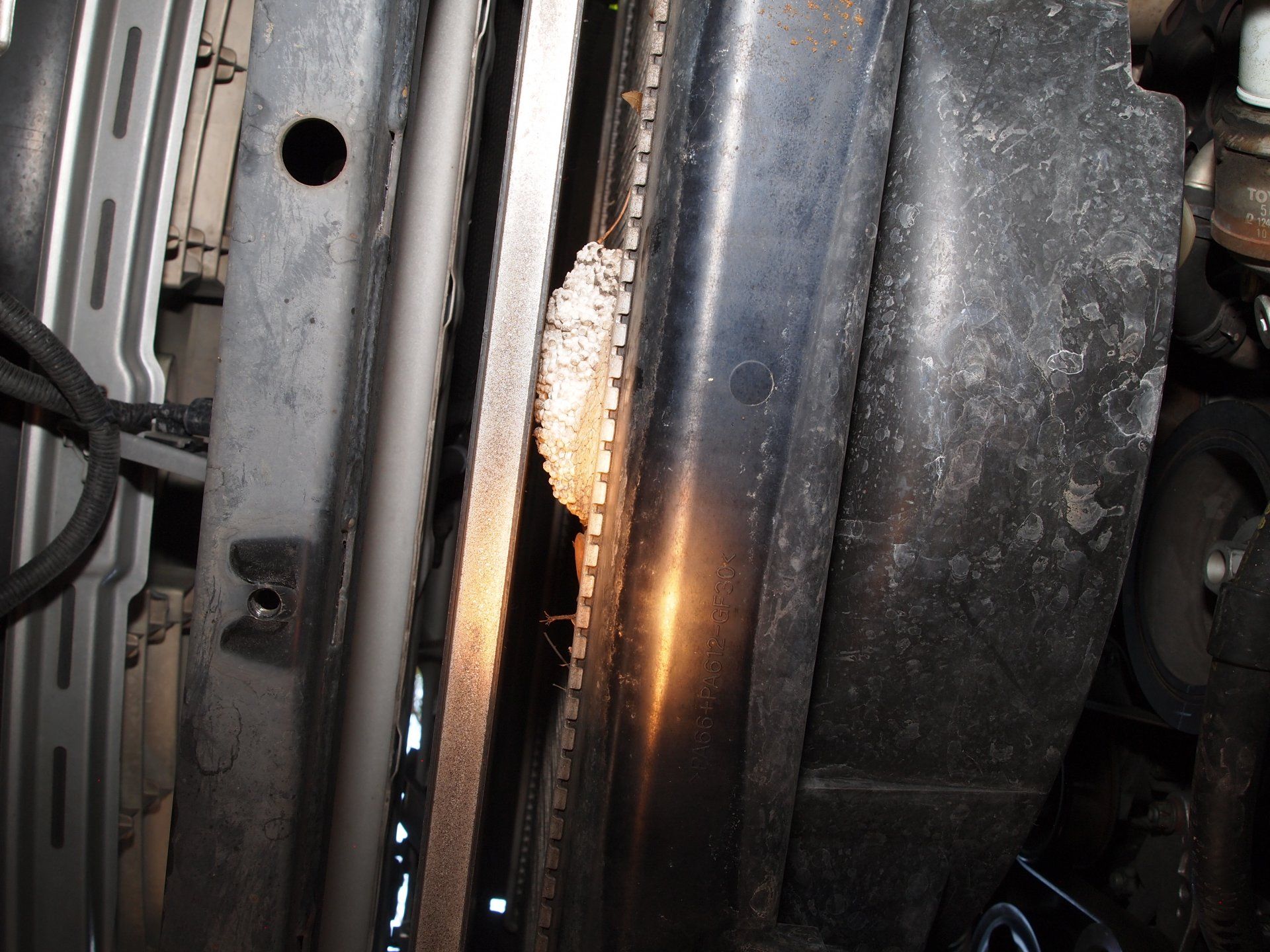

Didn't read the whole thread, but make sure your radiator is clean. I had a customer come in for a timing belt in a extremely clean 2006 LX with 180k for a timing belt. Radiator looked great on the back side. Once I pulled it, it looked like this. The condesor being sandwiched against the front of the radiator can really trap grime. You can't even get to this section with a hose because of the fan shroud.
r42JCC0WqtIa5KwRQmVCGTgoV3uDY-cLTc1bKLq5kh9IHluNZttpxIvFMHYy44wlxR1qRndzALj-yKOonOf613Y9M6ukzizkEh4vV9Tov1z-e0vGOS5go8HPqeHbZCTSfnT5tVT3v8s=s0
I see the same, time and time again. I now regularly clean radiator as I clean engine before timing belt job. As part of coolant system service. Sometimes hours of HP washing, come back again and again from all angles. Even after all that washing, I find they (all 3 radiators) need more cleaning after I pull the engine radiator.
Even with skid on, a flashlight will reveal the cloggs.
I've even found styrofoam between them, with full skids on and all foam. I suppose standing in high water and floated in.
