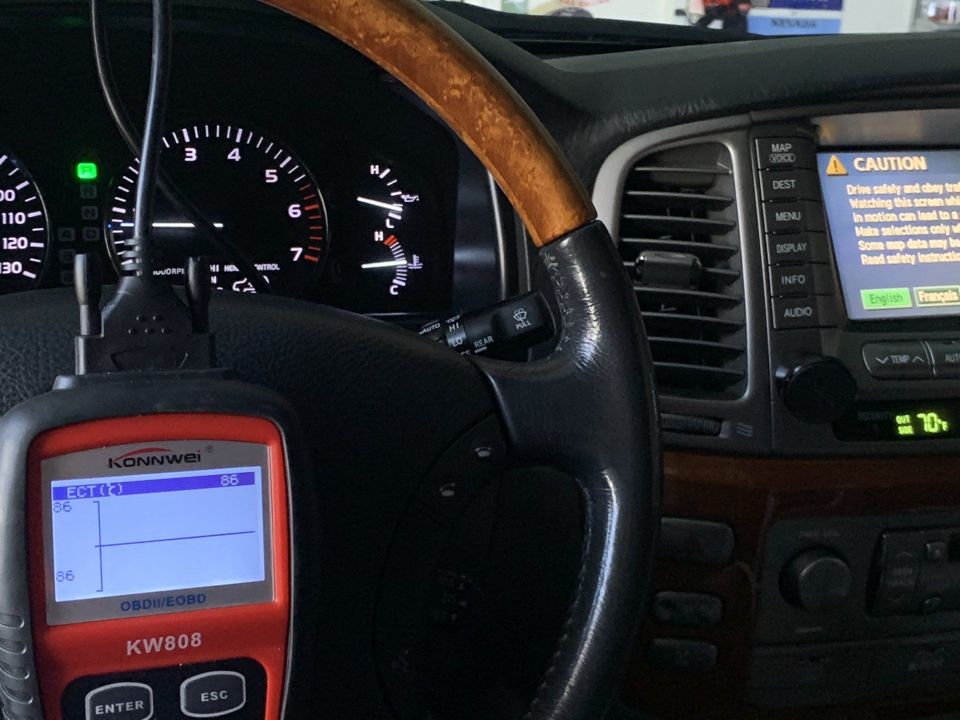

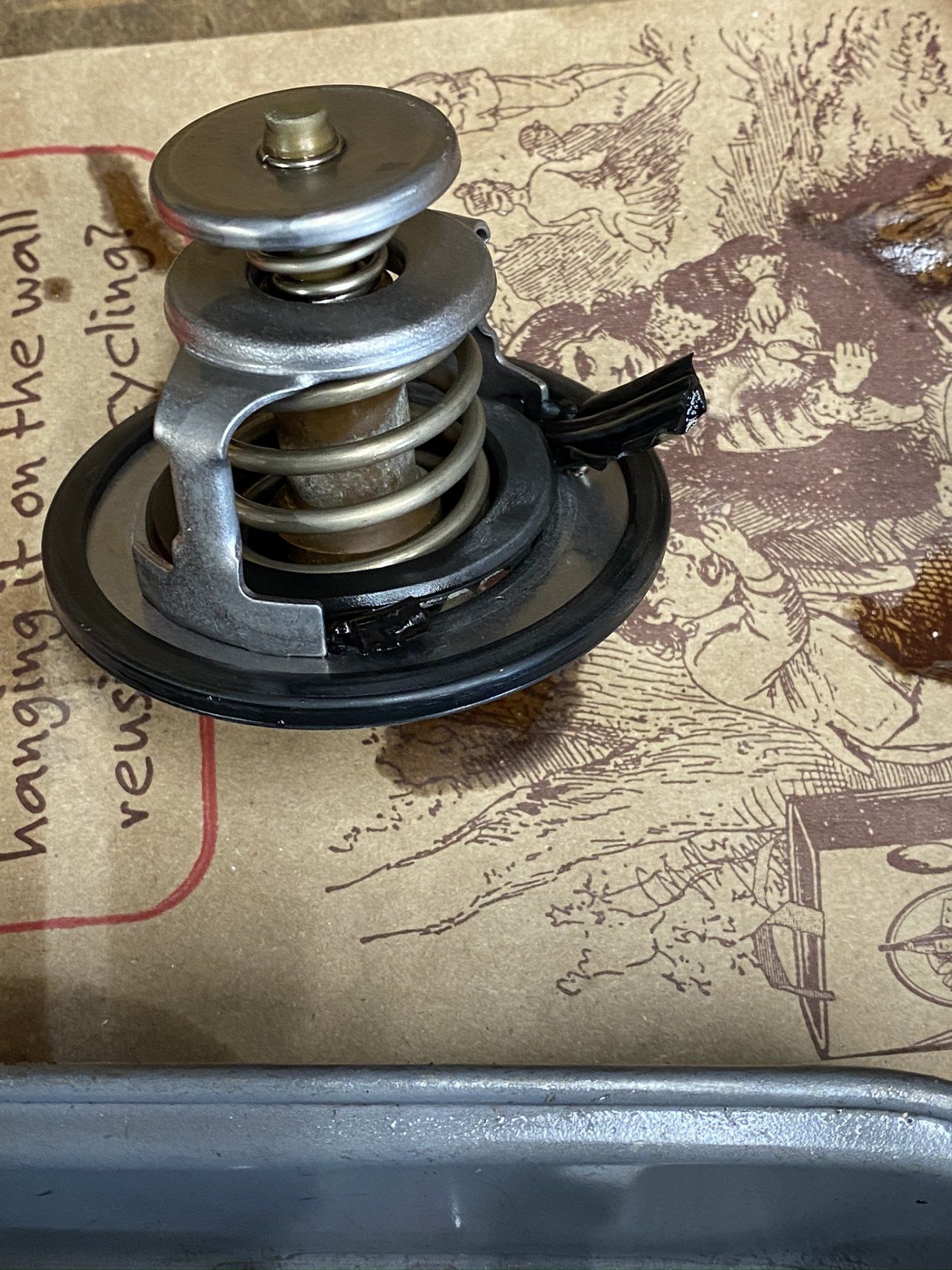

Sharing for a 2UZFE VVTi after 90k mile service.
86°C or 186.8°F operating temps on outside temps of 72°F (highest) and 70°F (lowest) with 5% Las Vegas air humidity.
• new oem thermostat & thermostat gasket
• new water pump, aisin
• new water pump gasket, oem
• new water pipe o-ring gaskets, oem
• new fan clutch, aisin
• new fan clutch bracket, aisin
• new pulleys and v-belt, aisins/continental
• new 3.4 gallon coolant, oem
• new rad hoses 1&2, oem
• new engine oil and oil filter, 0W16/oem
Planning to change the rad cap soon just to make sure cooling system is venting correctly per spec. Did not change the radiator it seems to be in good condition still a few dings here and there but no leak.
I haven’t used the AC yet, but I will share soon the temps when front and rear AC is on and hopefully with the new rad cap installed as well.
Fwiw my ect prior to the service was 92°C on the exact same internal and external conditions.
