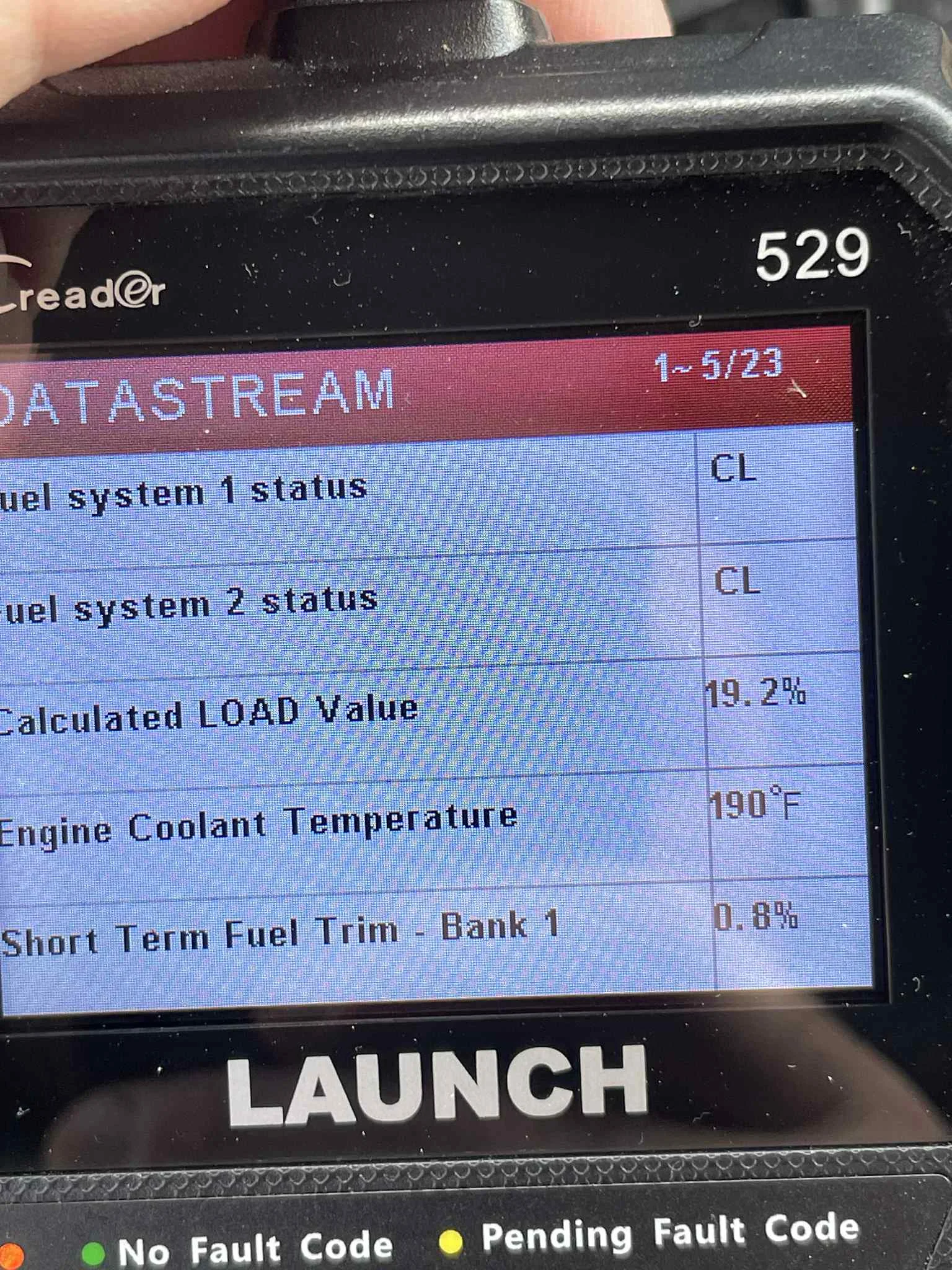

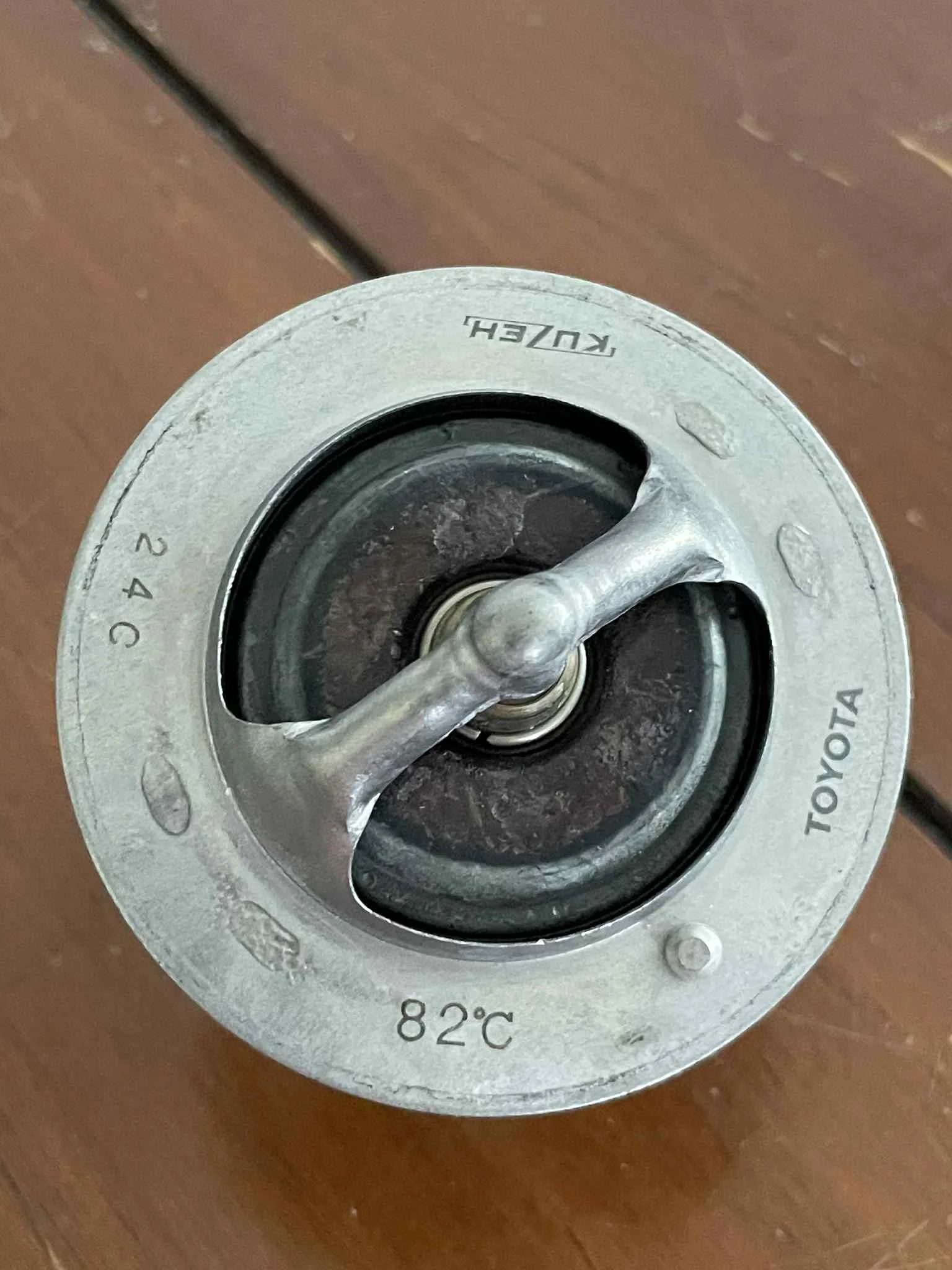

It's still very hot here in Arizona but I have finally gotten the engine temps down to a reasonable number! The problem was a faulty OEM Thermostat that was purchased in 2024, barely a year old. Maybe the plunger wasn't extending enough to cool it down, I'm not sure. But the OEM Tstat purchased from Bell Lexus was running my engine at 204F. Engine temps would climb up to 215 and even higher just slowing down to make a turn or park in a parking lot.
Anyways, the thermostat I just put in was a MotoRad 170F Fail safe from Amazon. I don't really like the design in comparison to the OEM but it is functioning appropriately! Right now my 100 can Idle at 190F ECT with the Ambient temp 105F and Ac blowing 49F out of the vents! In Park with the idle bumped up to 1500rpm it would go a bit lower!

Have not done any hills or mid day traffic. But the other thermostat would never go this low. Not even if it was raining and 70F out. It basically was at 203 all the time until it climbed up to 217F
@Wagoncruzer I had a new OEM thermostat several years ago that had similar symptoms. Put the old one (which had only been in for a few years previously) back in and temps went back to normal. Last year when I did my t-belt and WP service, I put another new OEM thermostat in and had no issues.
@94SRUNNER I would definitely prefer OEM as that is what I most always go with when getting replacement parts. I would try another or get a lower temp OEM. I heard there were different temps available but couldn’t find it. Even the standard one would be fine if it stays at 195F.
