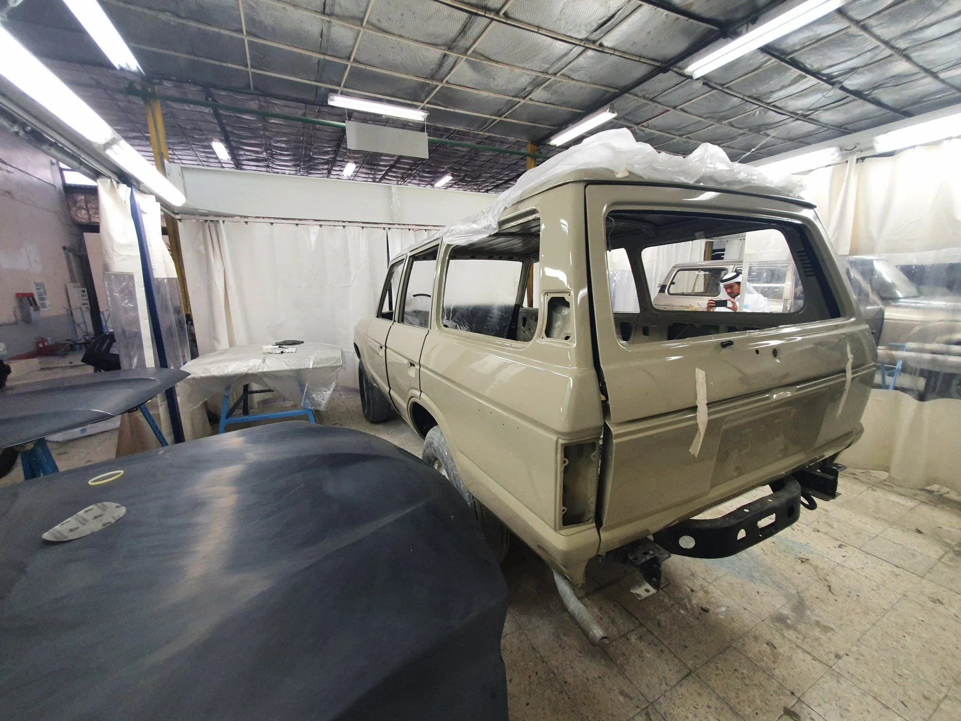

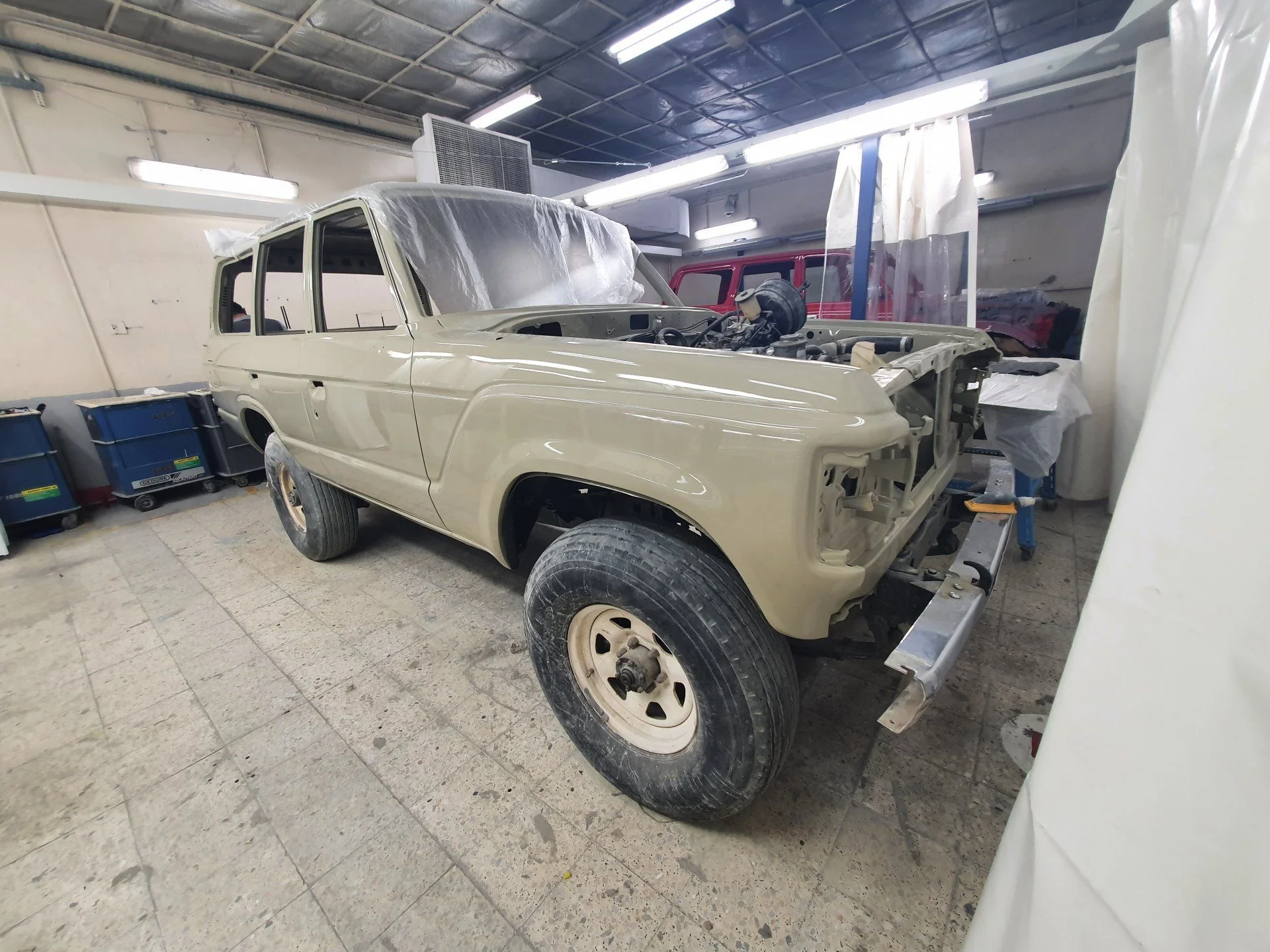

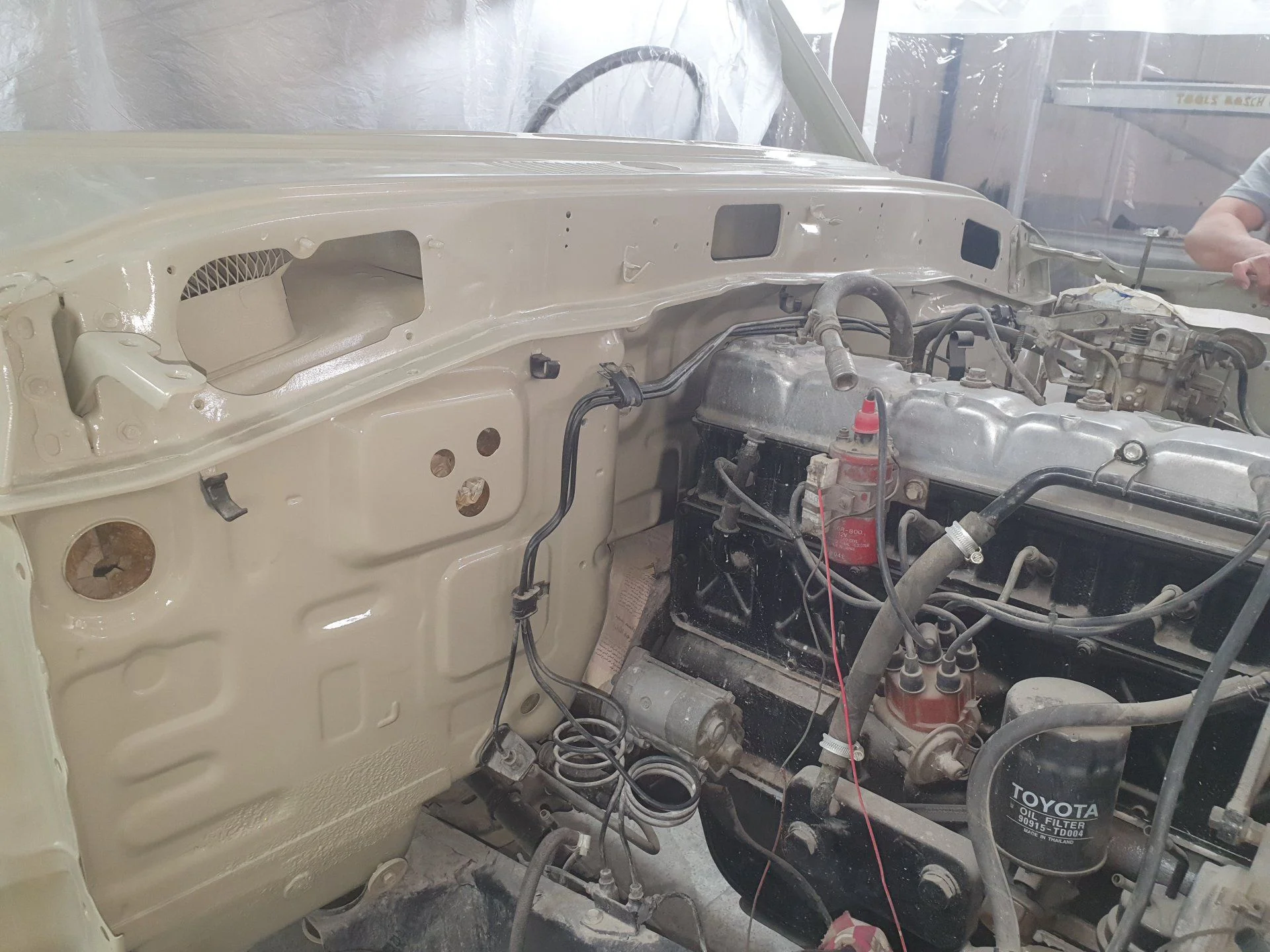

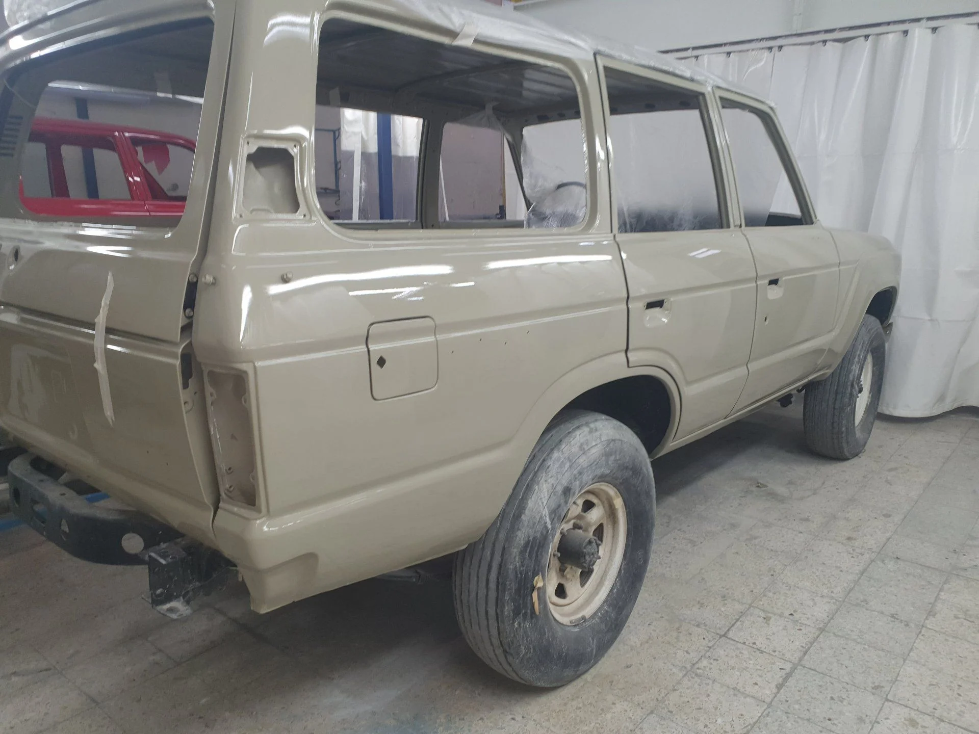

I've started doing restoration for 1984 FJ60.
I've don't full sandplasting for both body & chassi.
The car All most ready to go for the second step to go ahead with engine.
I have 2UZ-FE V8 engine from 1998 VX-R 5 speed manual transmission.
I'm thinking to go ahead to put the 2UZ-FE V8 with H55f 5 speed transmission on the FJ60.
I would like to know if 2UZ-FE V8 fit properly to H55f or its complicated and need more work & parts.
Dose the 2UZ-FE V8 engine also fit on FJ60 chassi properly or i need to do something more?
