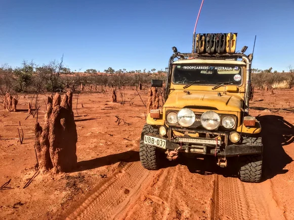

One of my 2Hs in its element, the end of the Canning Stock Route in Australia.. 2000klms on goat tracks, over 900 sand dunes, 12 days of driving and one fuel stop.
